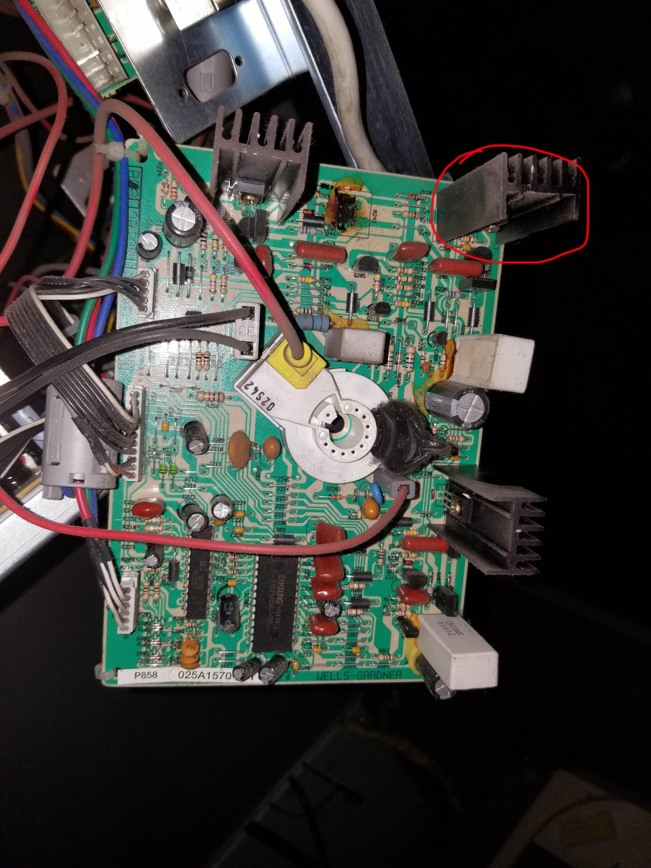

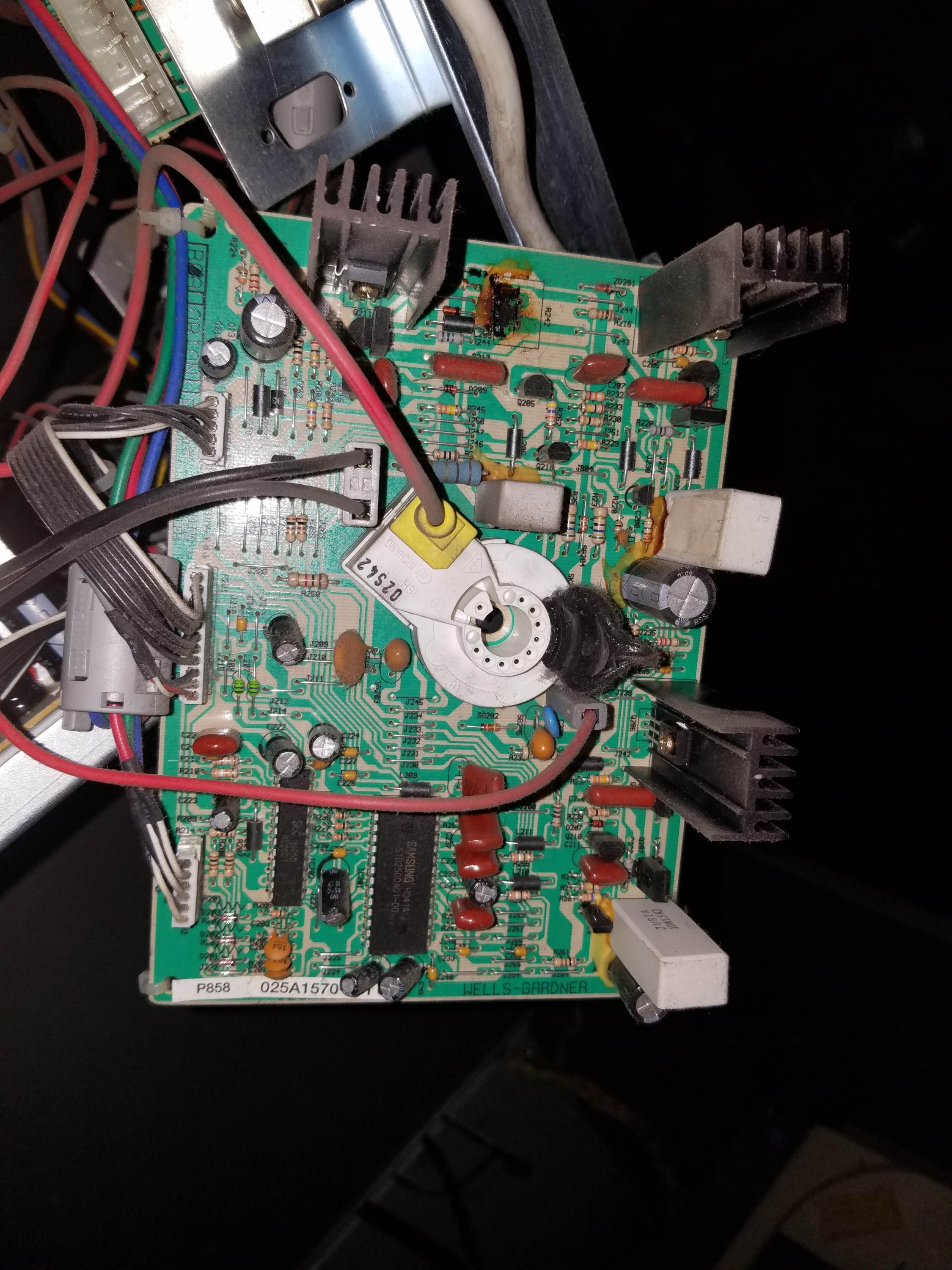

    Hello all. I just Bought a Sega Sports Jam Arcade Machine with the intent on fixing it, and maybe later converting to a mame machine. I have done many in the past The sound is heard, but the CRT monitor does not turn on @ boot. When i took the back monitor cover off the machine I found a white ceramic resistor that was just laying in the metal monitor cover. After inspecting a minute I noticed r242 was missing from the neck board, and a black spot was left behind. My question is: should I just order a replacement resistor, or should I further investigate to find out what caused the resistor to fail (and/or fall off). I am just wondering if someone could point me in the right direction of what to check for? The monitor is a WGM2792-U0TS29K, the neck board is a p858. Resistor is 10w 1.5k . I will attach pic of neck board...

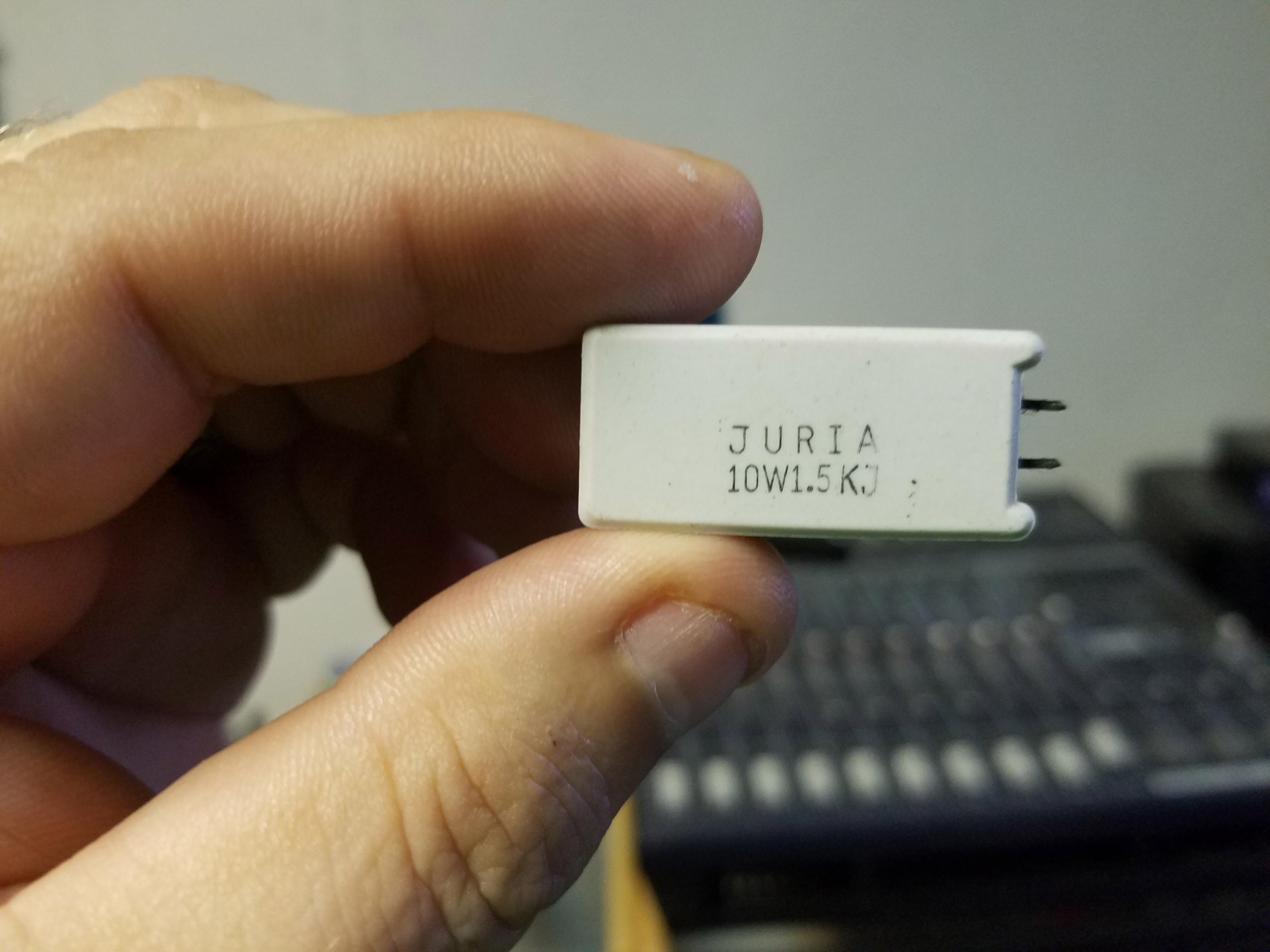

    One more thing, someone suggested it fell off because of a cold solder joint. I tested the resistor (pic attached), its reading 1.333K Ohms. Is it within tolerance to reuse?

      Re: WGM2792 Arcade Monitor Resistor Burn Off On Neck Board *Need Help*
      dont mame it, it's waste of a real machine.
      the board has no heat marks, so it probably just fell out from cracked soldering.
      put it back and check the rest of the joints - specially on large parts.

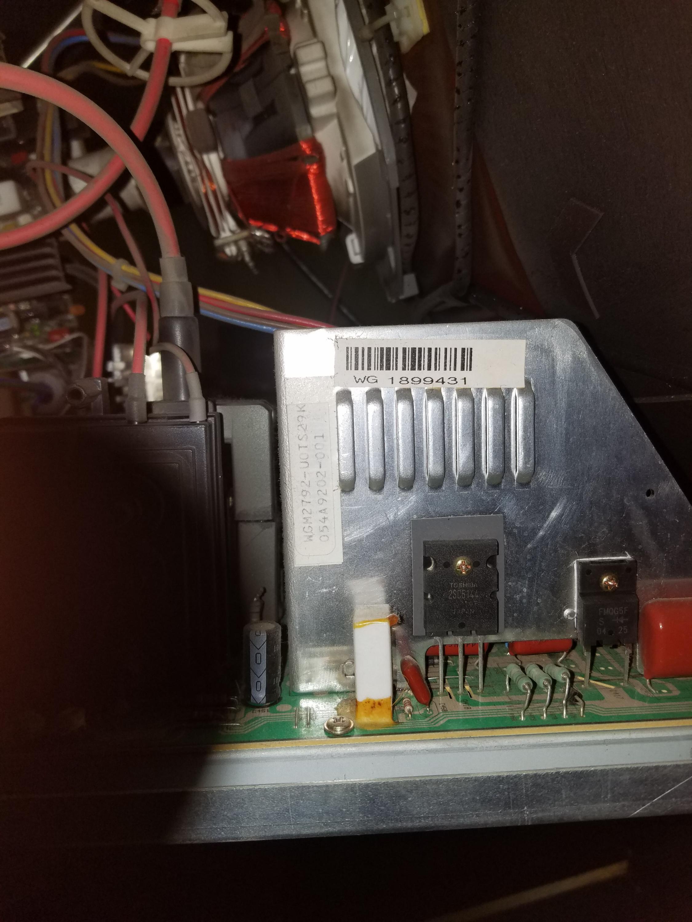

      can you foto the factory sticker with the monitor details on it?
      as it's NAOMI based, you would be better getting a NET-DIMM board and loading games from a raspbery pi or a pc as a multi-game cab
      then you can put all this on it.

        • 30979
        yes, it's probably fine.
        strange though, naomi systems usually use a japanese monitor.

            never seen that model number before.
            you know it may be medium-res right?
                      That is one of the drive transistors for the crt, (my guess is green) I suspect it is shorted and the extra current through the resistor melted the solder and it fell off.
                        check between the transistor leg for shorts, although i suspect you have other problems - the heater is not related to gun-drive.

                                  The Transitor is a c3502e. it appears that it is a npn type from the data sheet i found online. E C B.
                                  I get .682 base to emmiter, and .679 base to collector.
                                  emmiter to base and collector to base shows open. from what I can tell its good.

                                      Do you have the any of the voltages on P203? +8 volts is for the heaters, if you don't have it, check back to the power supply on D811 and R858

                                        Yes, I have +8.63v dc at 203, also 12.3v, and 69v but still no glow?
