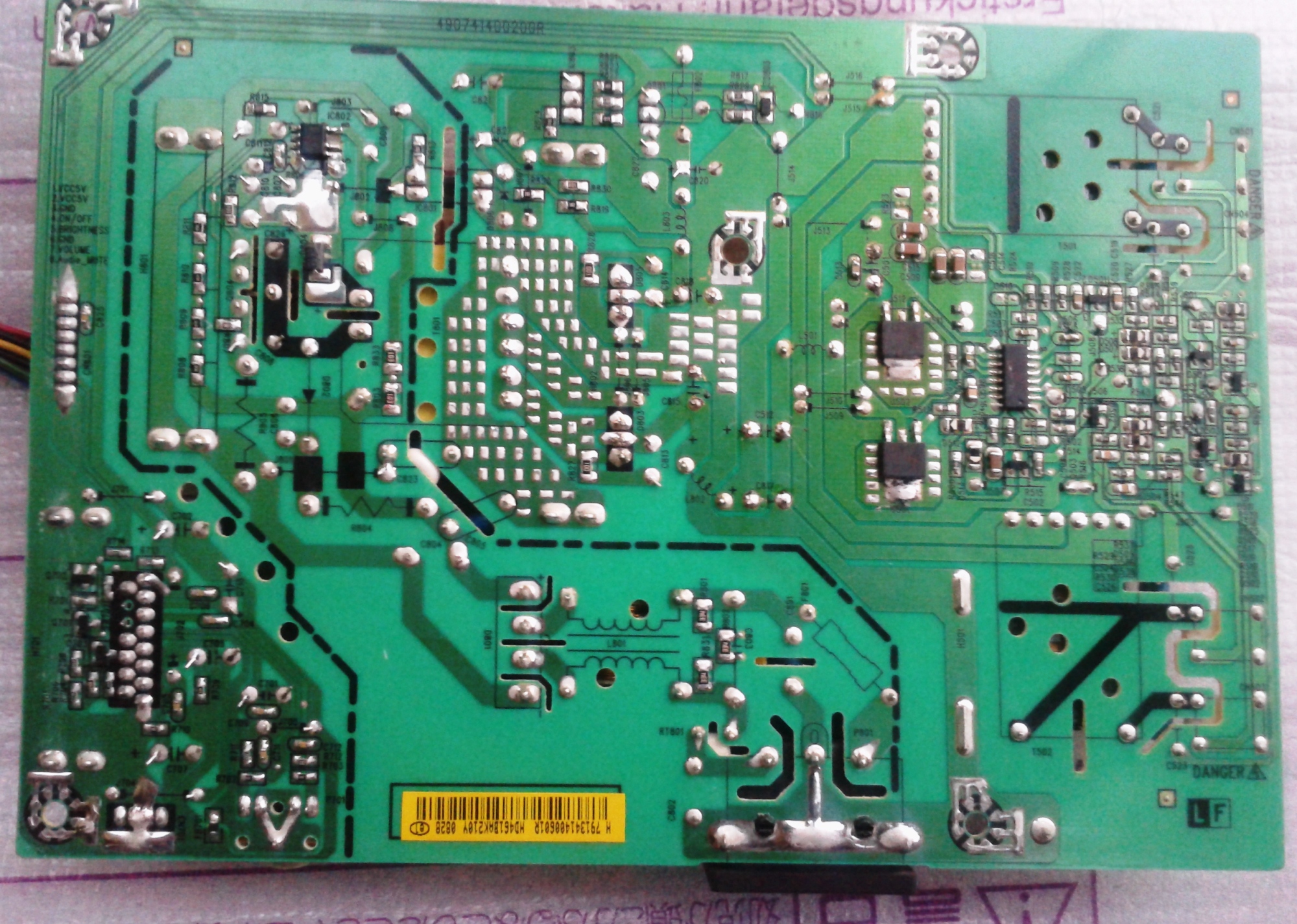

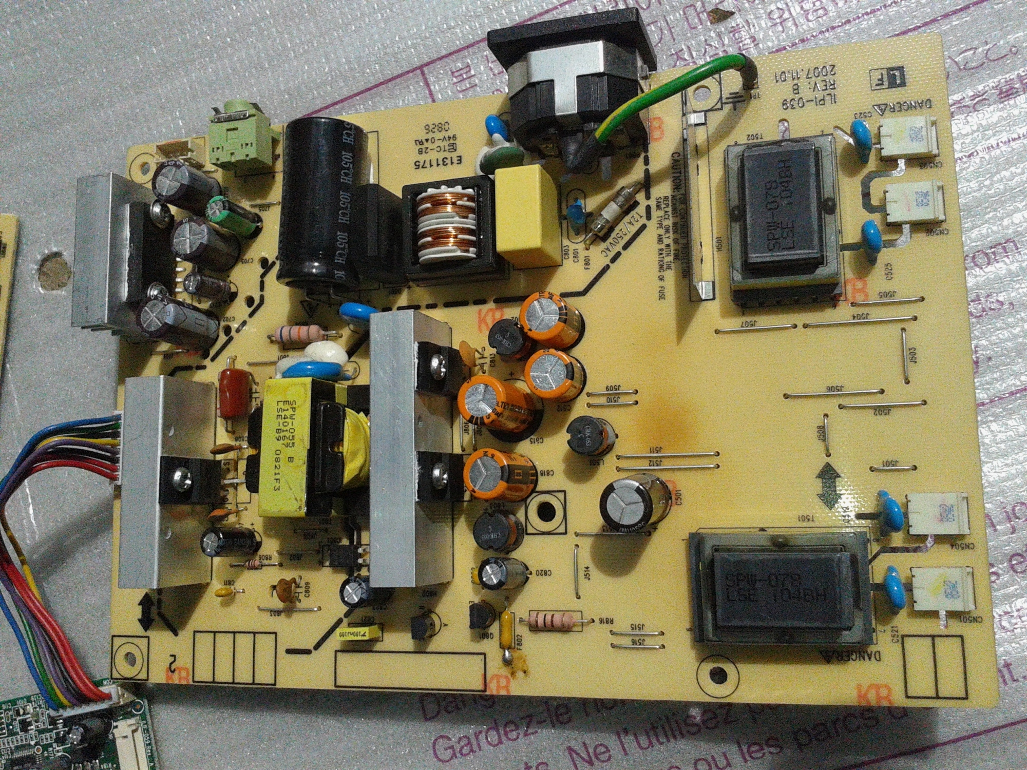

      There is some scorching showing on the board - can we have a picture of the back.
      If it is not a bulb problem then I would change all the caps except the BIG one
      with Good Quality low ESR caps - panasonic or nichicon if you can get them.

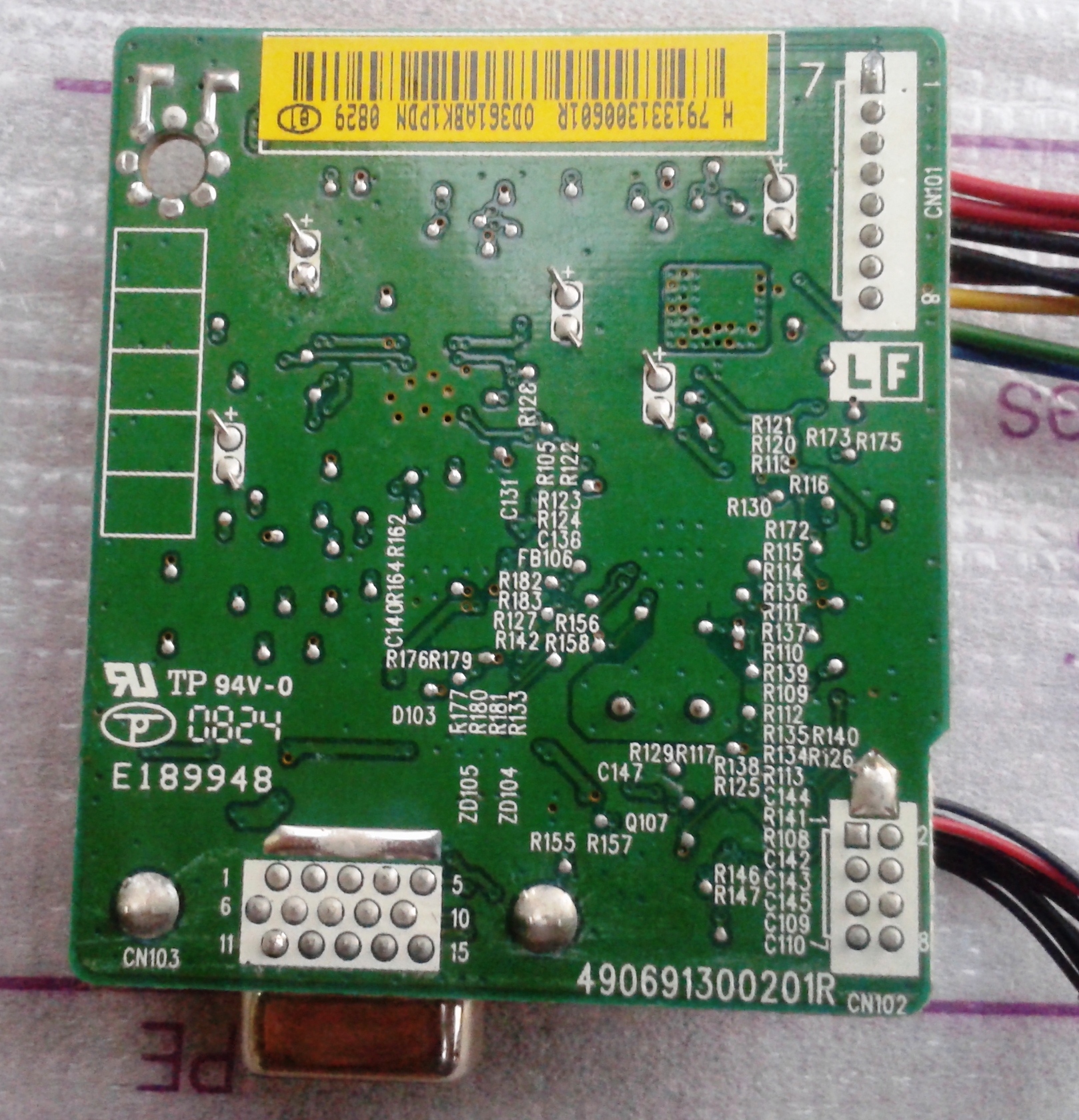

        Re: Viewsonic 19" Flashing backlight and no display.

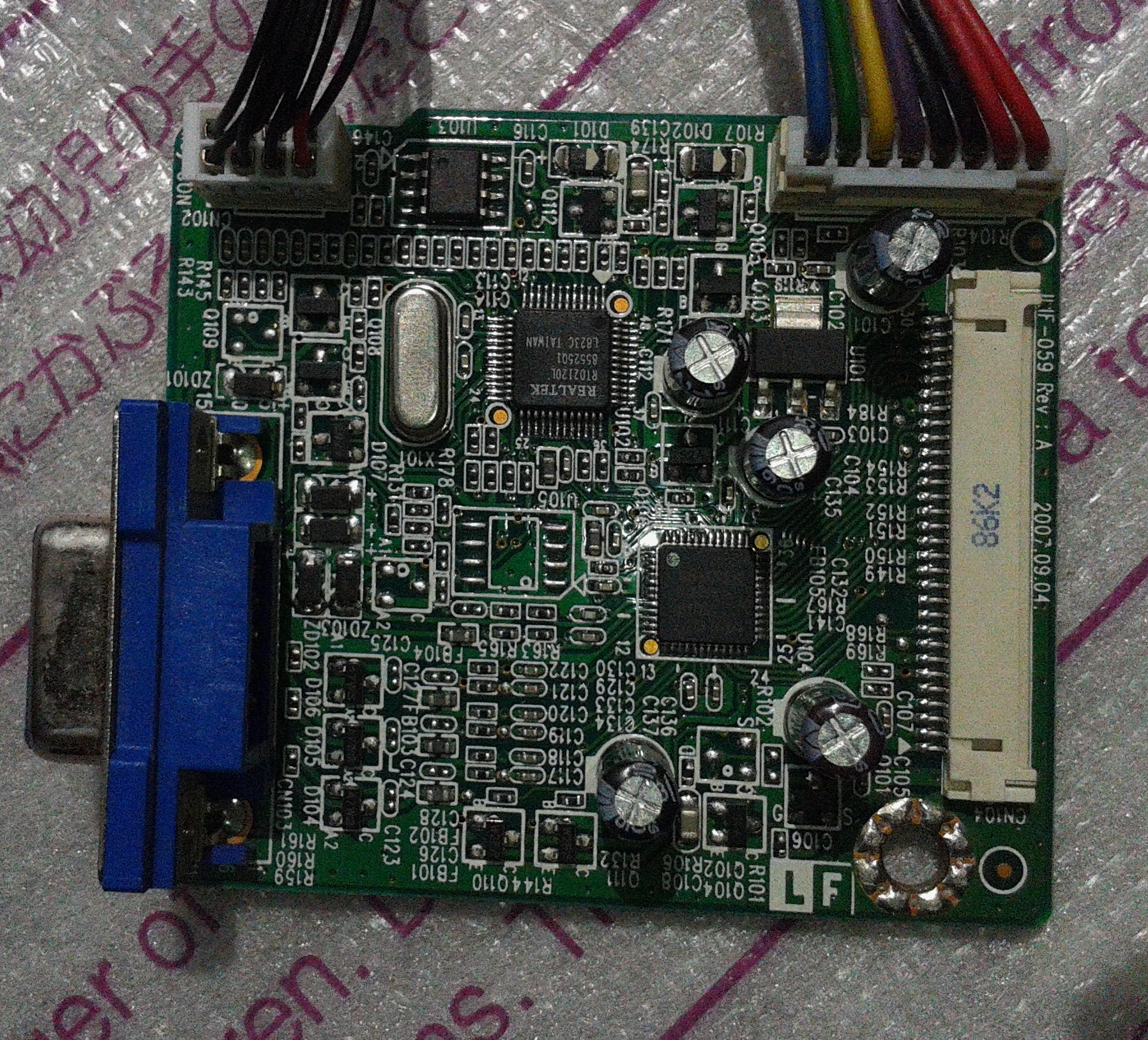

        All caps expect for the big one had already been replaced. I have attached pictures of backside of the board.

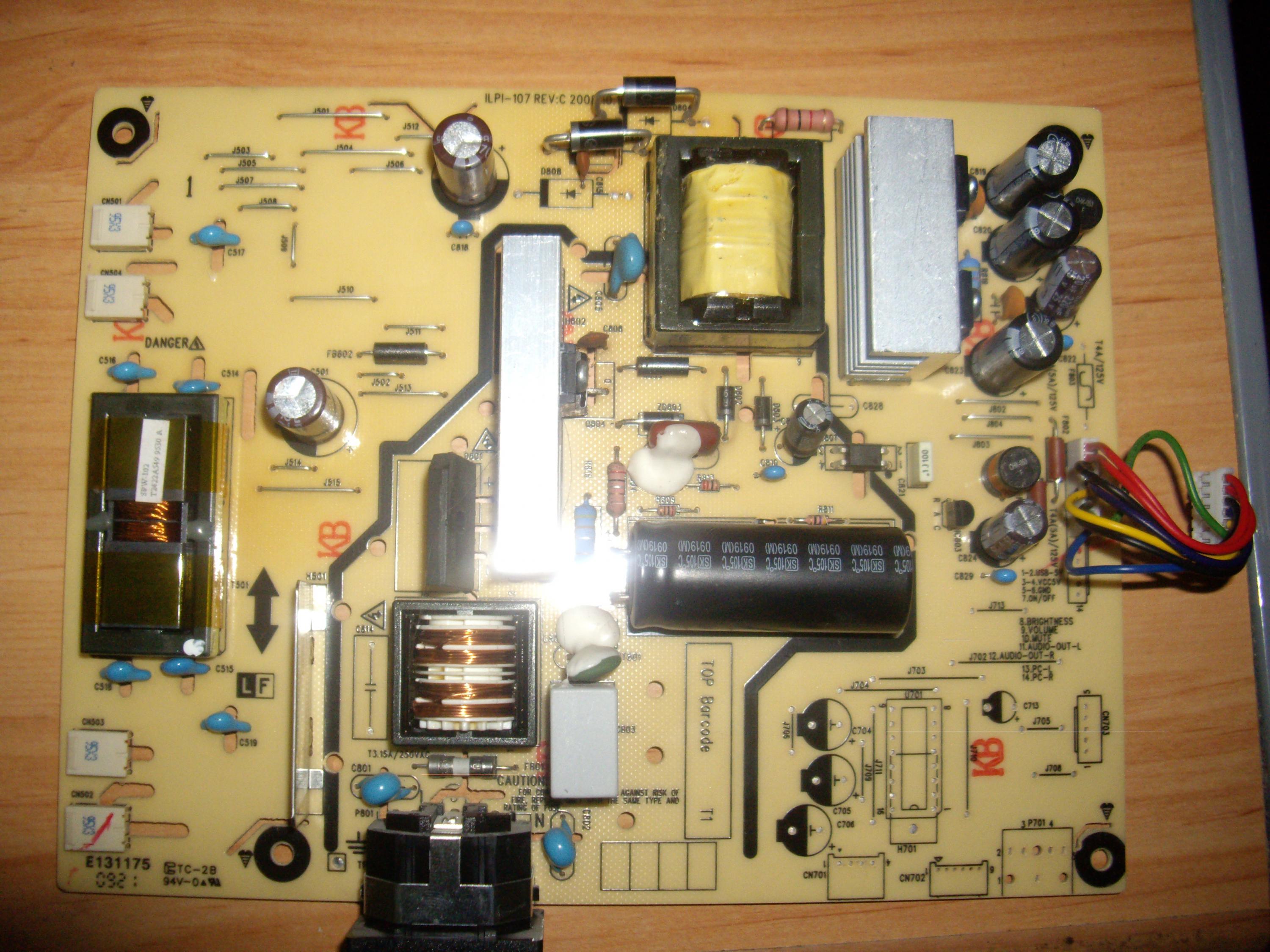

          Hi, I'm having a similar problem, actually it's exactly the same except that there IS (barely) visible picture under bright light. I've checked both power and input boards and no visible damage, for me that is. I can't post pictures today but I'll try to do so tomorrow.
          @OP, did you end up fixing your problem?

            (sorry, can't seem to find the edit button) Forgot to mention, it's a Viewsonic VX2260WM

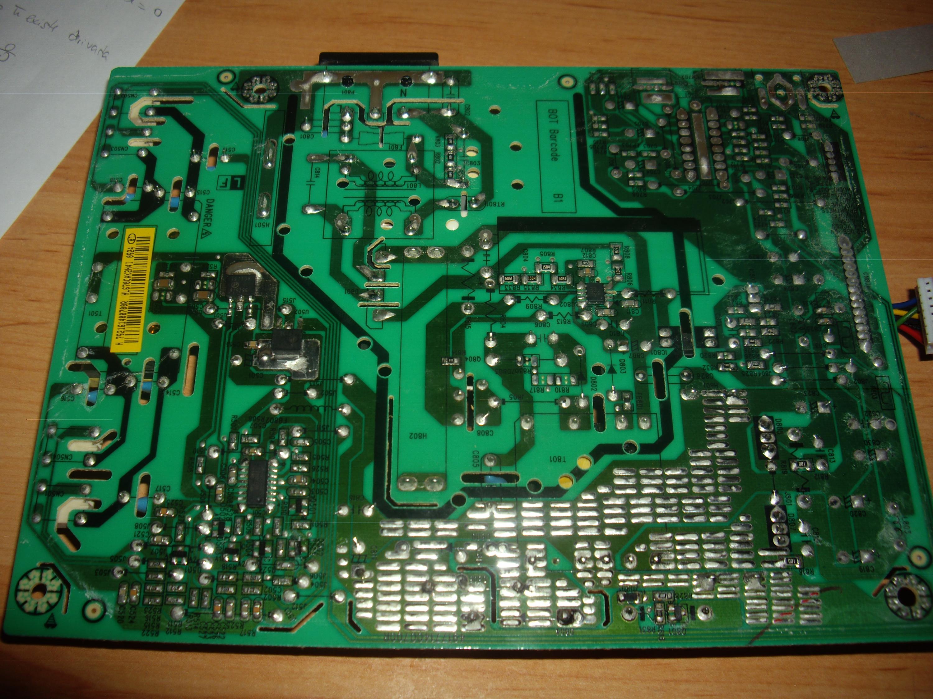

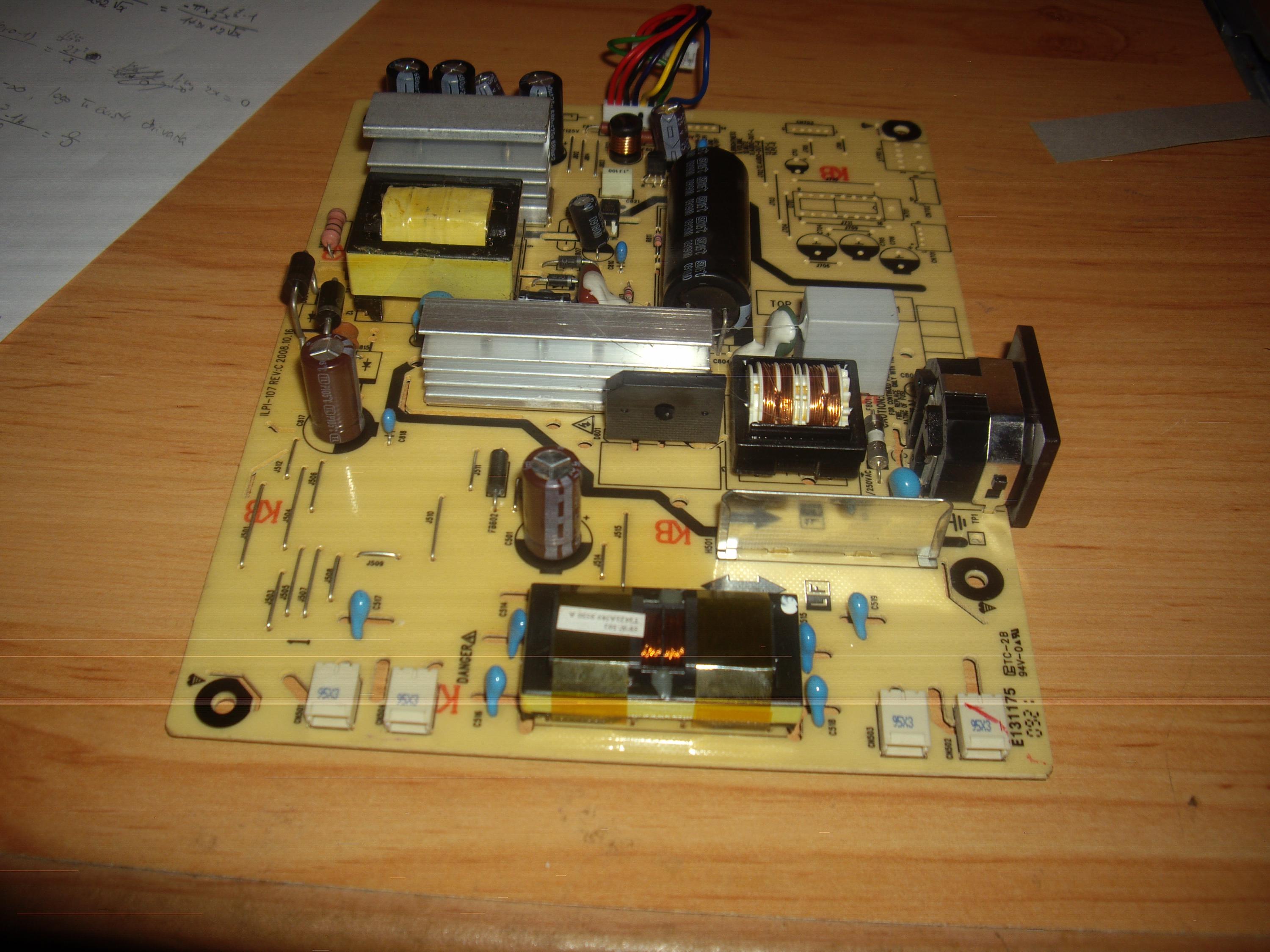

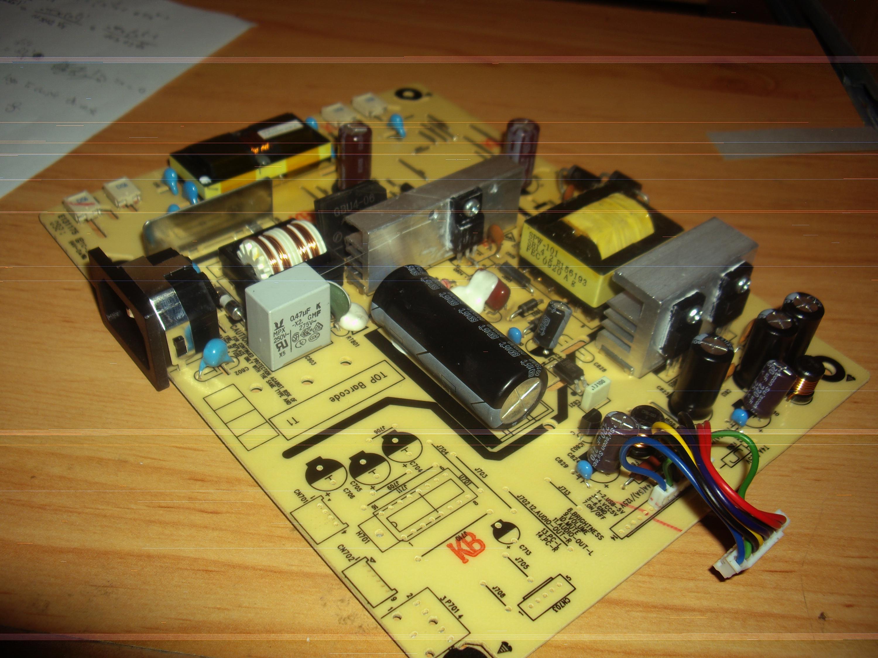

              sorry for the triplepost. the pics are here.
              Also I should add, the hissing seems most intense at the top corners of the panel
                Hissing from top corner sounds to me like arcing from high voltage, this can be due to bad wire connection at the end of the lamp.
