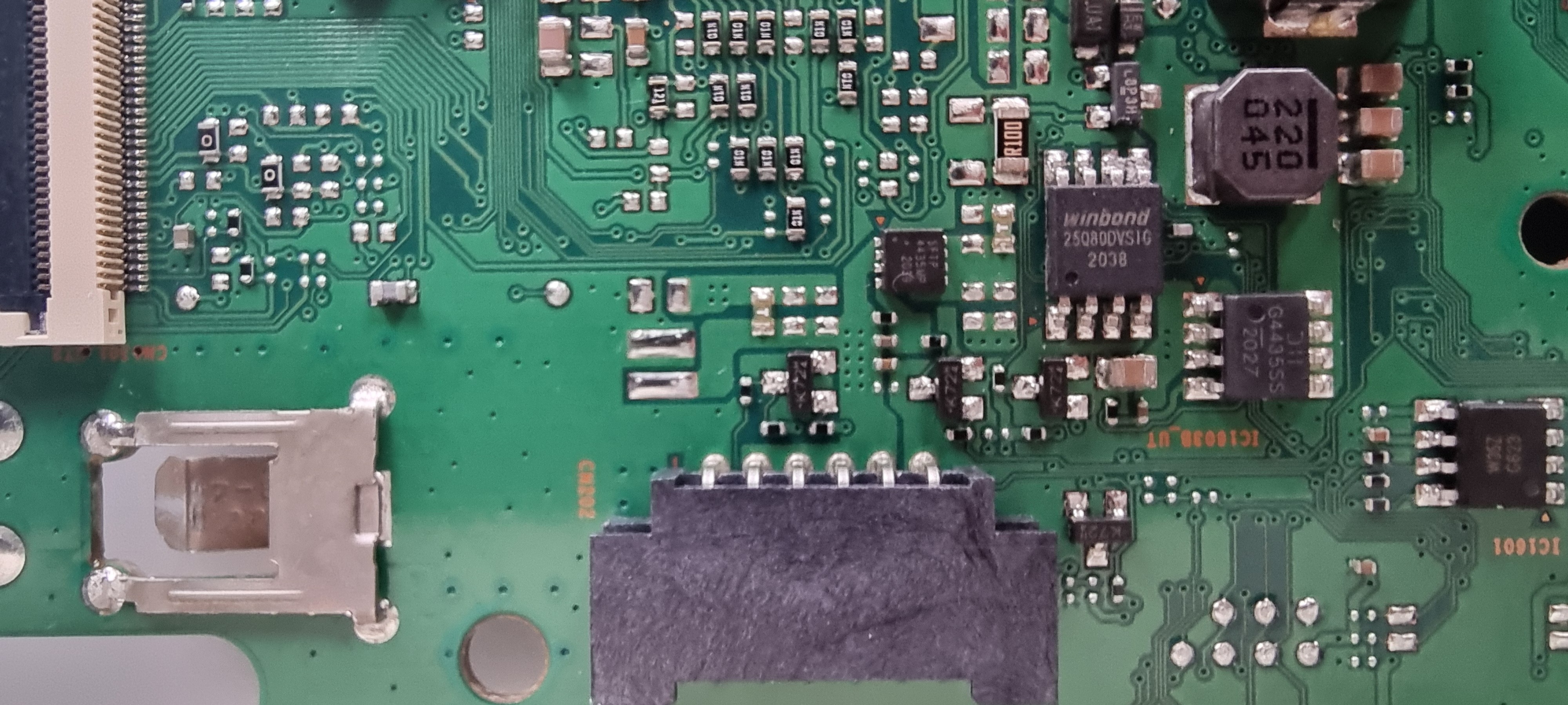

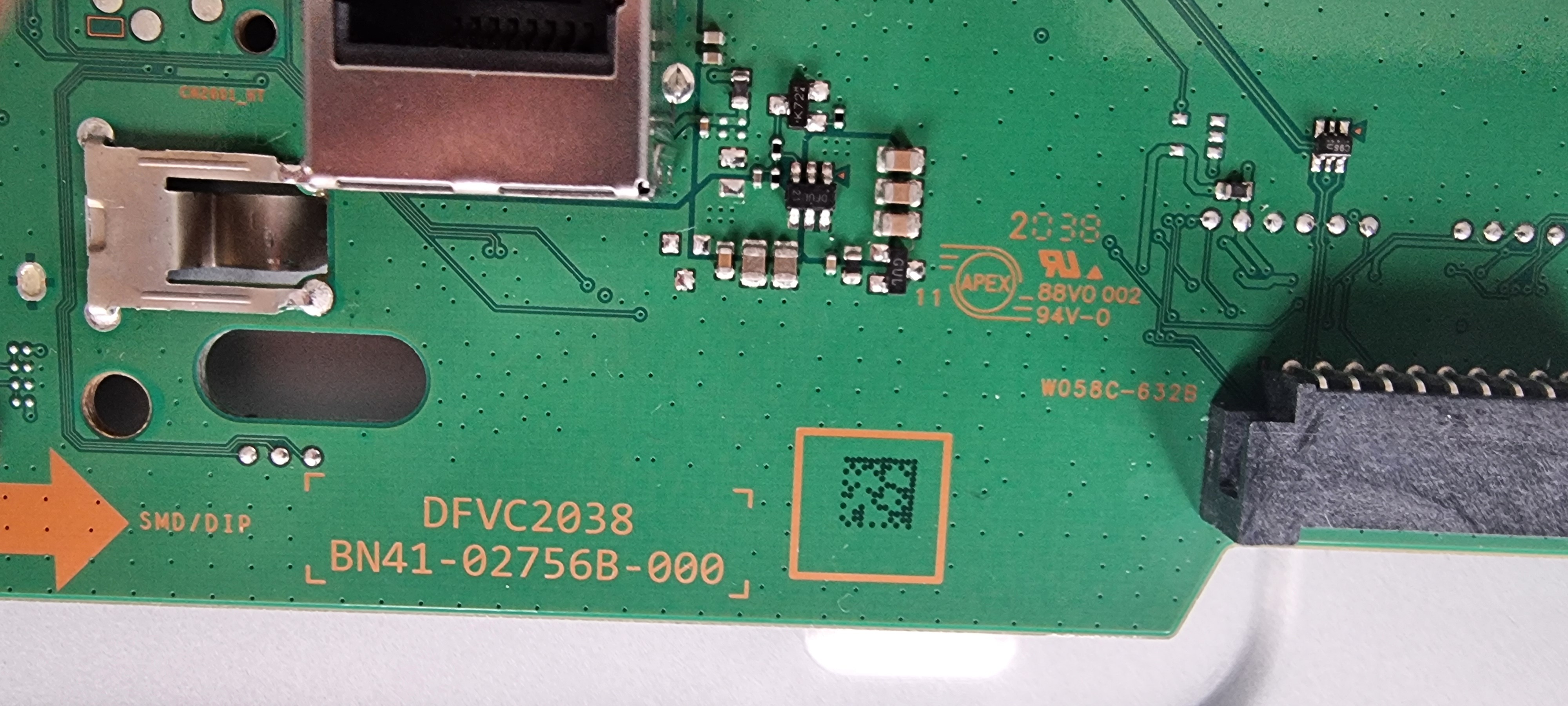

    Hello Community!
    CASE DETAILS
    Promblem Signs: Backlight on 1 sec off 7sec > repeat && Red standby light: 1blink, off 3 sec, 2 blinks, off 5 secs, 2 blinks, off 3 sec, restart cycle
    13V present on powerboard output. Backlight continues flashing after removing cables to pannel one at a time and even with both disconnected. NOTE: backlight STOPs flashing and remains on when connector between powerboard and mainboard (note Tcon built in) is disconnected.
    Tried inserting firmware on USB and left it in for a few hours, but no change

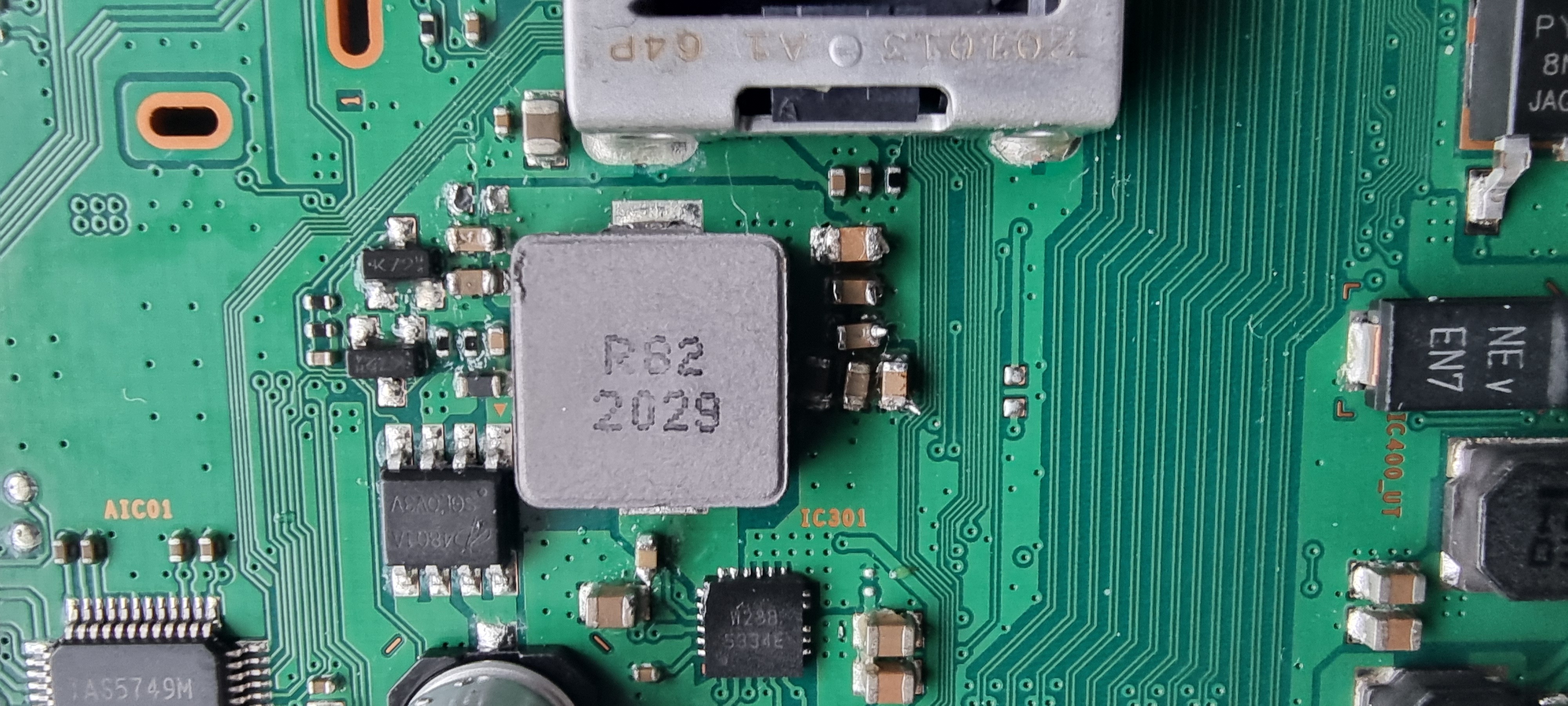

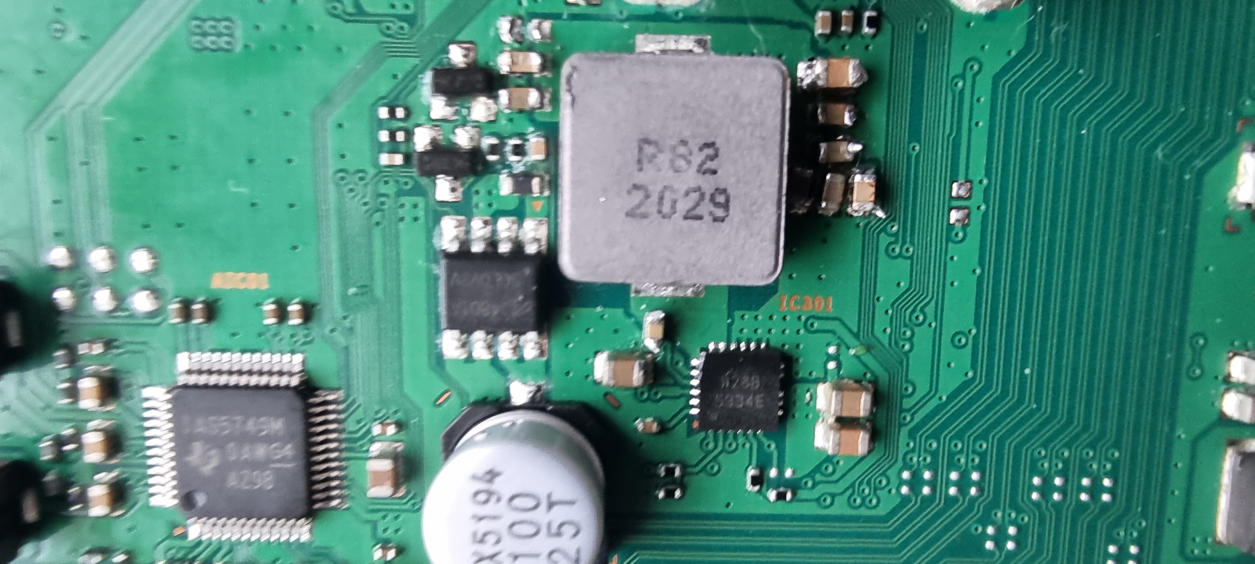

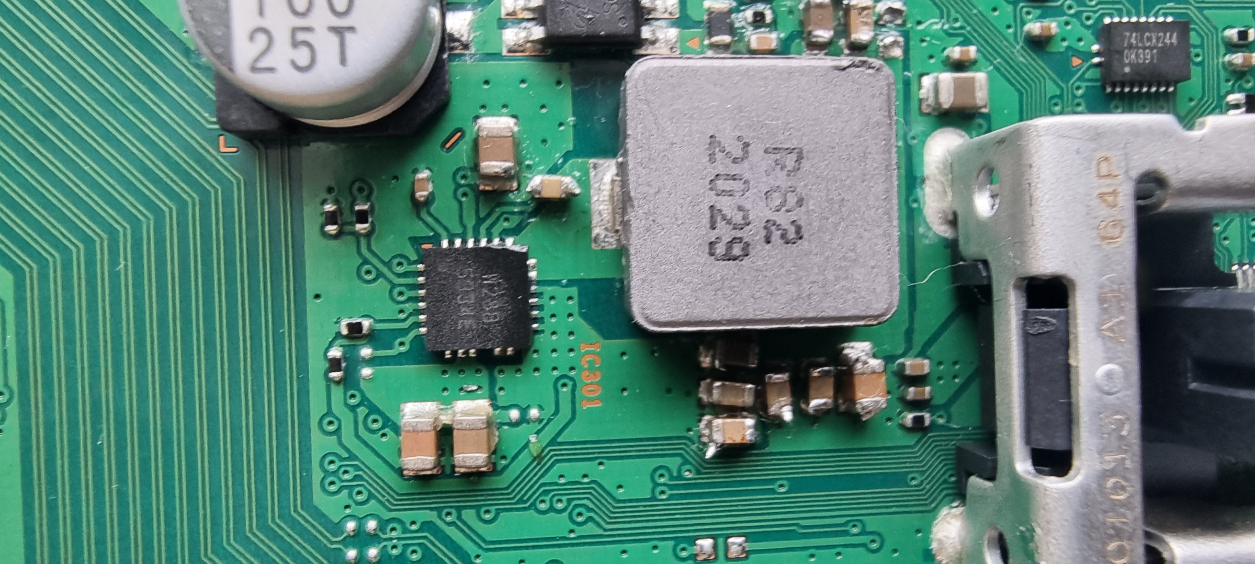

    ??Potential issue: I note the coil and surrounding (messy as I removed/reinstalled them all) caps in image XXX have a 0.6ohm resistance to ground. I injected volage and the most the board drew was 0.6amps, nothing seemed to get hot. Removed all connecting caps, but the coil had the same resistance to ground. I thought of removing the closest IC but the caps connected to it are all okay and it didn't get hot under the IR camera when I injected 1-3 volts.
    UNIT DETAILS

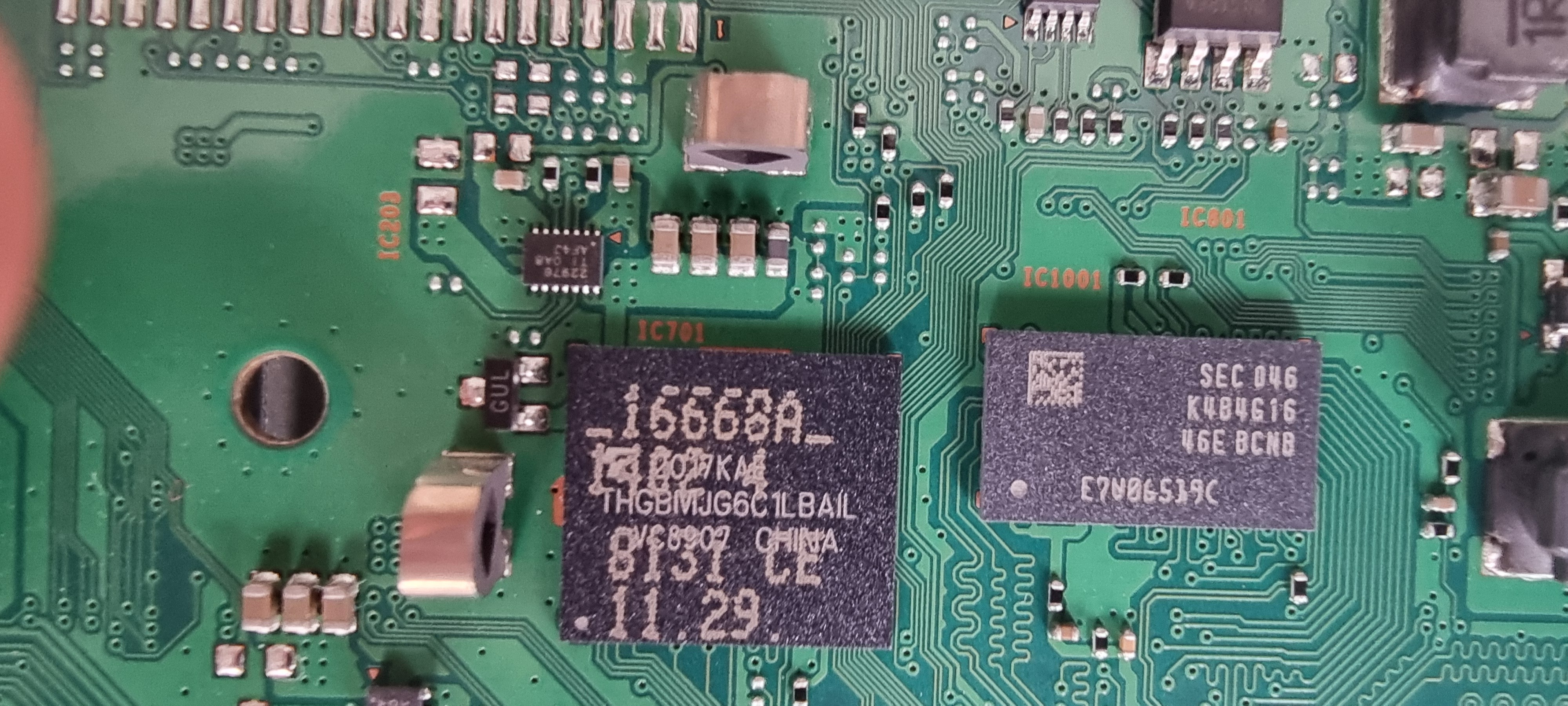

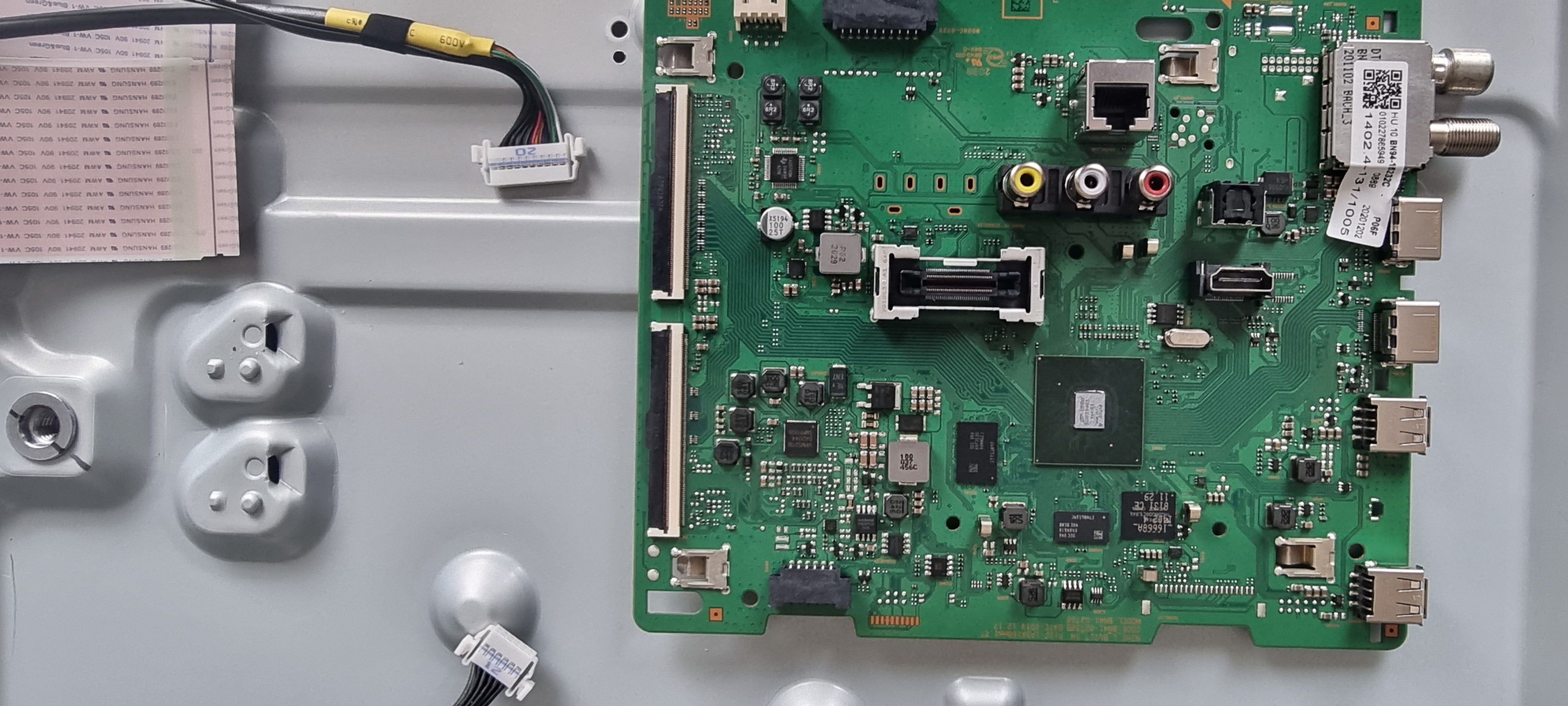

    Model: Samsung QE55Q60TAUXXU

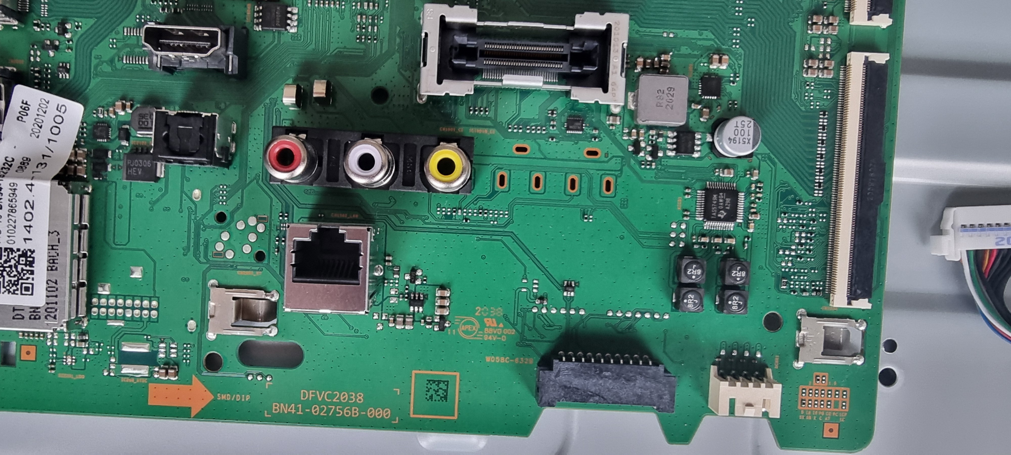

    Mainboard & Tcon (combo board): DFVC2038 BN41-02756B-000 DATE: 2019.12.17
    eMMC: THGBMJG6C1LBAIL

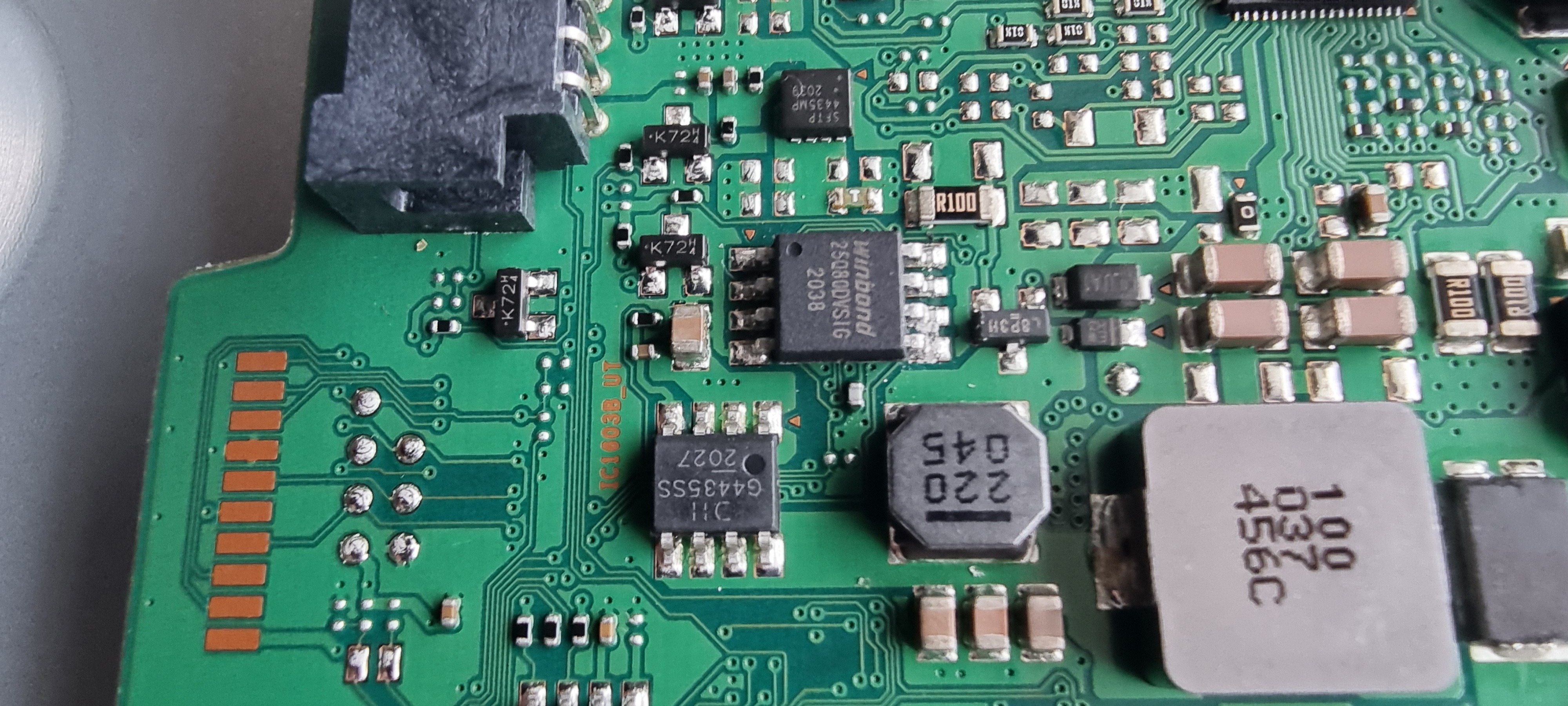

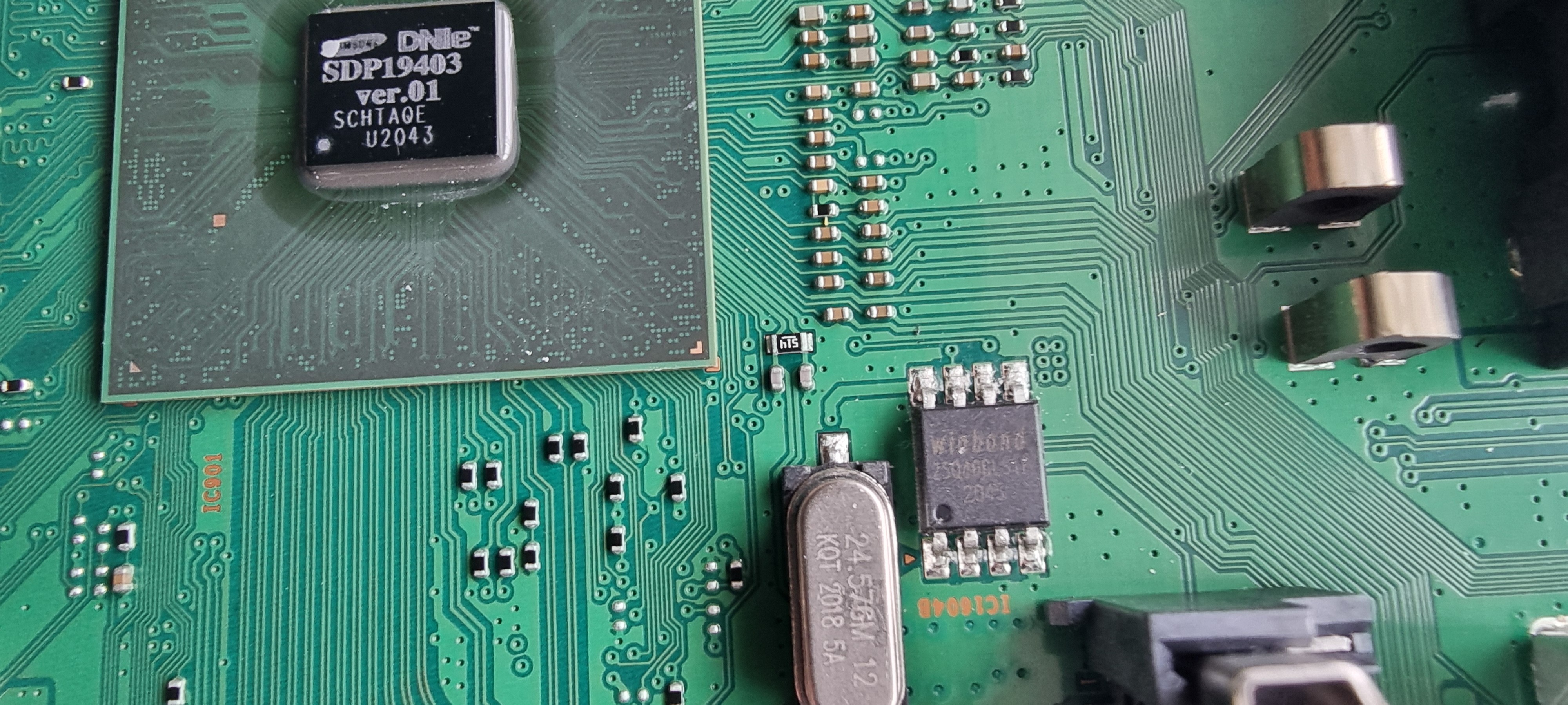

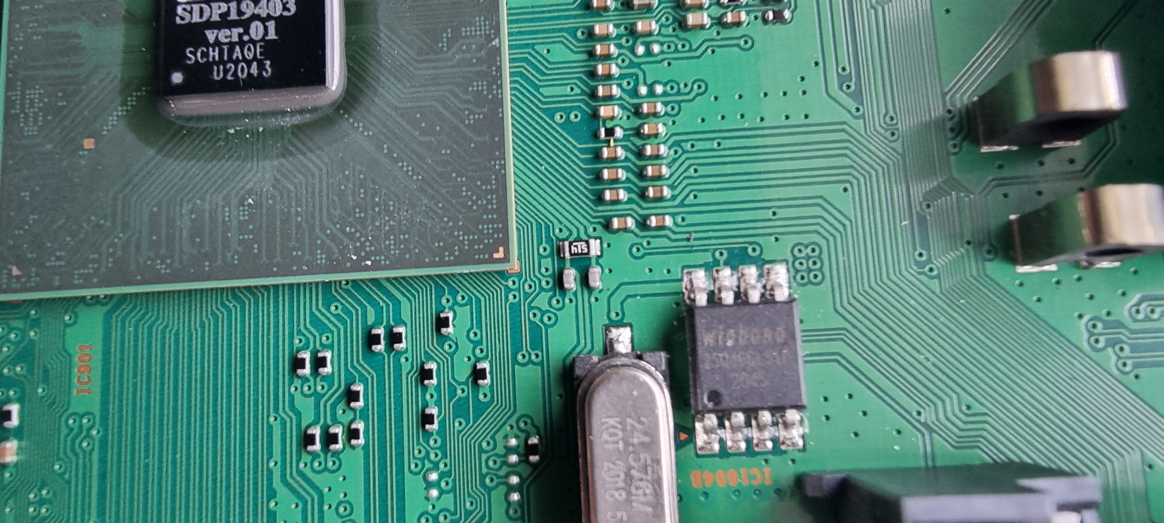

    Bios (Flash memory): Winbond 25Q80DVSIG AND Winbond 25Q40CL (next to GPU)
    I've got a RT809H programmer with 158 adapters but just now learning about flashing and how to use it.
    QUESTIONS:
    1. If its a memory corruption issue, which IC do I flash eMMC, Winbond 25Q80DVSIG OR Winbond 25Q40CL (next to GPU) and what do I flash onto the IC?
    2. For future reference, how do you tell which memory IC needs flashing or something is wrong with it?
    3. I've also been seeing some videos about JTAG and eMMC. Is this generally a method for fixing the eMMC without removing it from the board?​
    4. Are you ment to hold the power button down on the remote for a specific time (or some other input) after inserting a USB with the firmware?
    Research is ongoing, as I'm trying to move from simply replacing to repairing boards if possible
    Thanks in advance for sharing your knowledge and experiences!

        Thanks Cap! I'm checking your post now. Apologies, I've added the photos. I should have done the first time around. Image ending 12206 has the coil that reads 0.6ohms to ground and all the messy caps around that I removed, but coil still showed 0.6 after the were all off the board. Voltage injection under IR didn't show anything remarkable :/

          One more thing, how do you deduce what to flash?
            That’s how it should be, this coil sits on the ground to convert negative voltage relative to ground for T-CON and it’s called VOFF = VGL = VGOFF = VEEG = -5V to -9V, if they knew, they wouldn’t have to unsolder these in vain capacitors!
            • learnmore
              • Mar 2022
              • 100
              • England
              Noted Lotas, thank you on sooo many levels! First not a short I guess and second 0.6ohm may not necessarily mean shorted power rail for injection

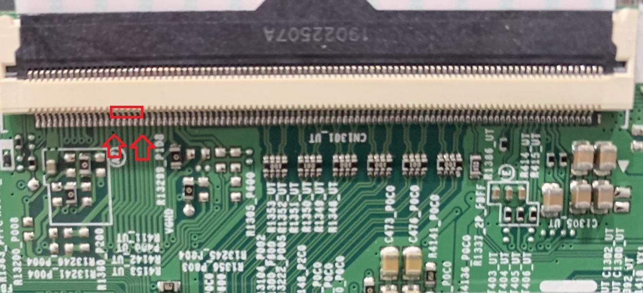

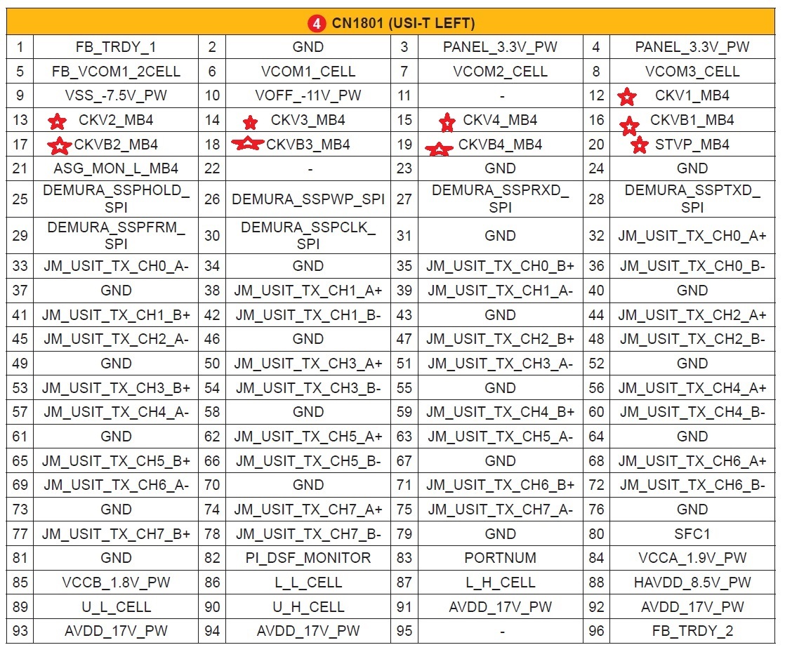

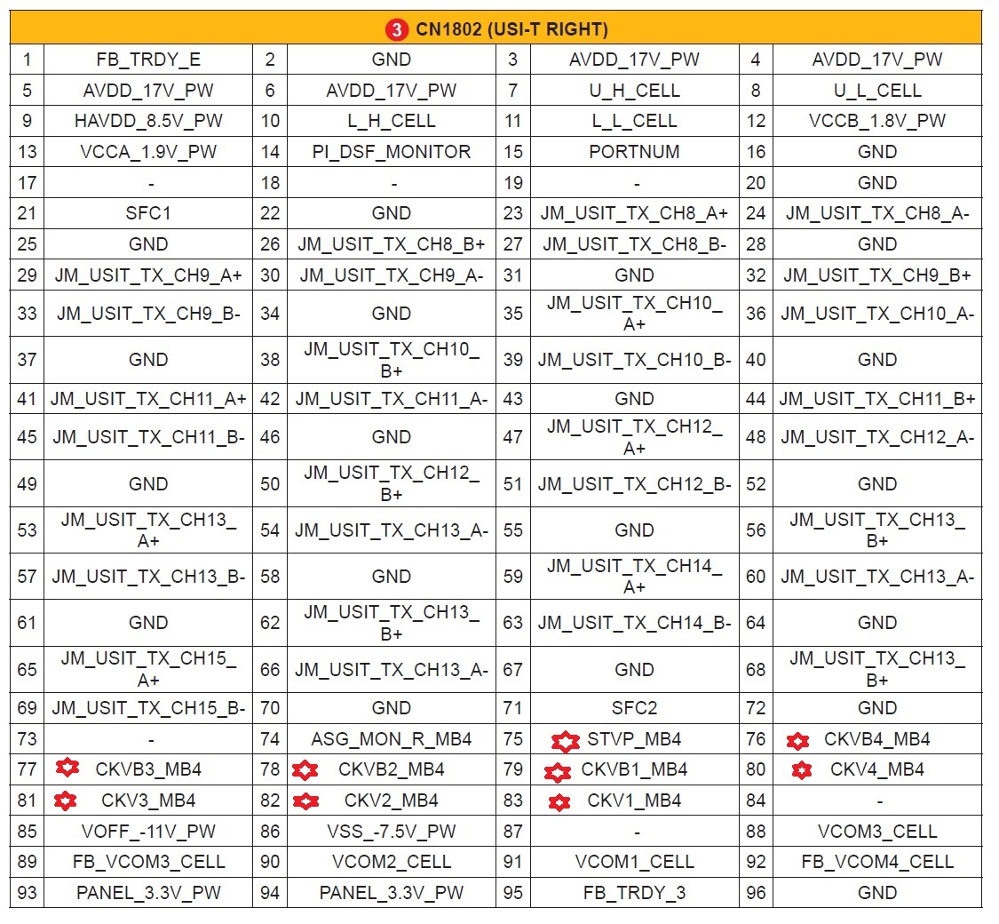

                      also i do have the diagram at samsungs threats remarked which CLK pins need to mask at the top LVDS.

                        Ah, I failed to add the jumper before testing without each LVDS. Lotas, so I'm not a total robot what does this jumper do or better yet where can I learn about it?
                          Yes please, Diah. If you mean a diagram with which pins to tape off please share, I've done it before with trial and error and those thin lines can be a pain.

                                if you search the forum of samsung TU / NU / MU /RU you will find it..
                                for example this what i found in my profile but i cant tell to which serie it belong

                                    Hey Diah,
                                    I've been searching the Samsung forums using various keywords but yet to find the post about blocking the clock lines. Whenever you can spare a minute, please help me find it.
                                    • Diah
                                      • Feb 2013
                                      • 6466
ID:	3227996 Click image for larger version
Name:	USI-T Right.jpg
