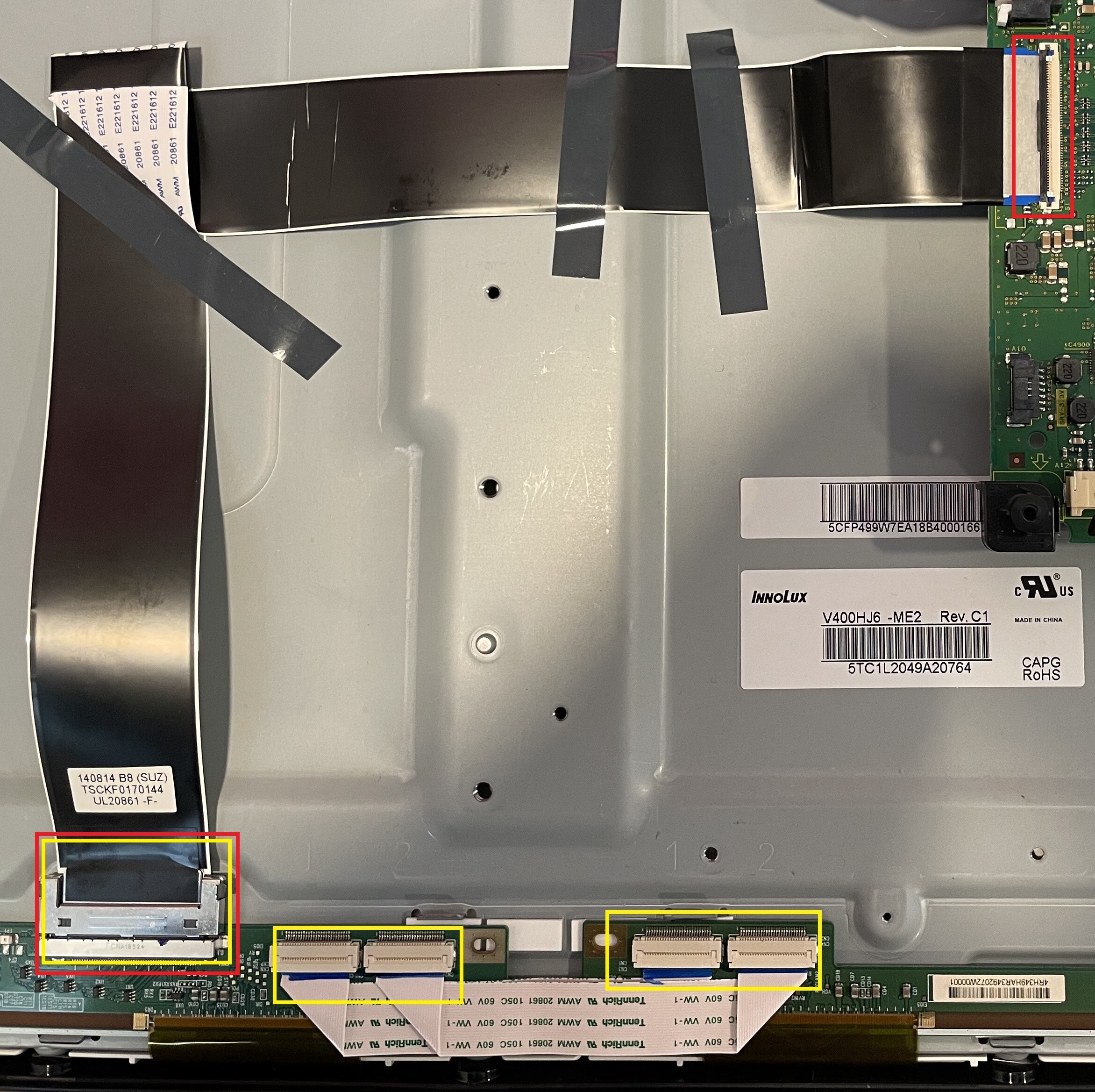

        Thank you for the reply. I am in process of checking the panel board for obvious issues, therefore it has been partially disassembled. But I have connected it back to show the critical connections (not speakers or indicator light). Thanks. Please see the photos. Thanks.

          under good magnifier check the contact pins of the LVDS cable at main boards side
          the one to panel with red and yellow mark need to check if there any cut at the cable side..
          the other U ribbon on panel buffer boards ( yellow ) check the contact pins too.

            I just checked all connection cable contact pins with a jeweler loop and I don't see any problem areas. The cable does has 2 bends/crimps in it that you can see from the photo. I suspect it was always like that but it is possible it got crimped when I had the TV dismantled and laying for weeks waiting for replacement LED shipment to arrive. Is there a way I can verify there are no breaks in the cable using a meter? Are those bends/crimps common or does it look like I made a mistake? Thanks.

              Here are the photos of the crimped/bent cable.
              • Diah
                • Feb 2013
                • 6499
                the crimped/bent cable.are normal,way to use for changing cable direction.
                you can try just disconnect the 2 on the right side of the U ribbon ( yellow mark ) and turn on the tv,, see if the screen will display half picture

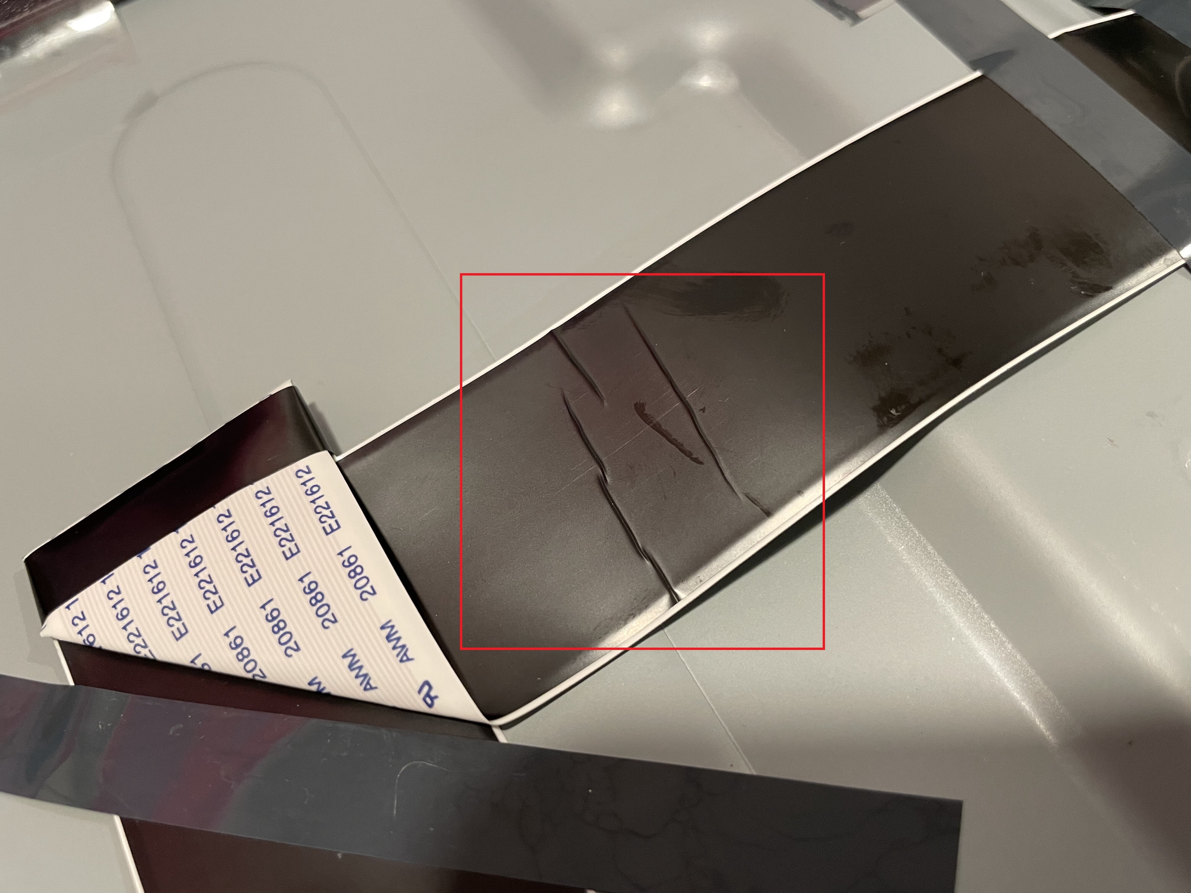

                  this look for me Damage at LVDS
