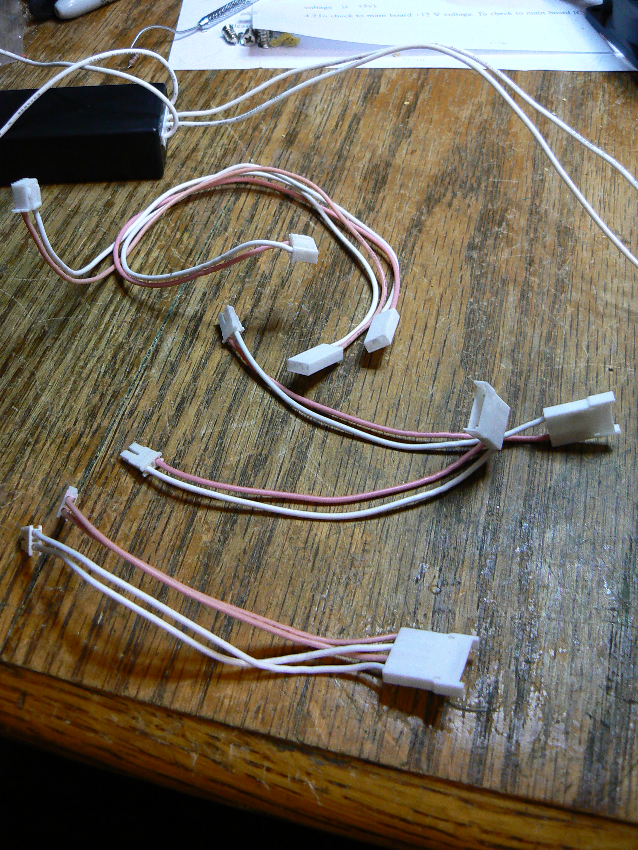

      I picked up two devices off of Ebay to test CCFL lamps and I find them very handy. I will attach a picture with both of them in it. I like the larger black one better because it will drive larger bulbs and it came with more connectors. Budm's device is good to have around to test the inverter itself but I have found being able to directly test the CCFL's to save a lot of time and trouble. This may especially be true if you are unfortunate enough to have two blown CCFL's at the same time. The black one cost me $8 shipping included and took about two weeks too arrive. This device may not be everyone's cup of tea but I find it extremely useful. Even if I find obviously bad caps I still check the bulbs before doing any work because some monitors are not worth the effort of replacing the CCFL's IMO. It is quite frustrating to recap a power board and still have two seconds to black because of a burnt CCFL.

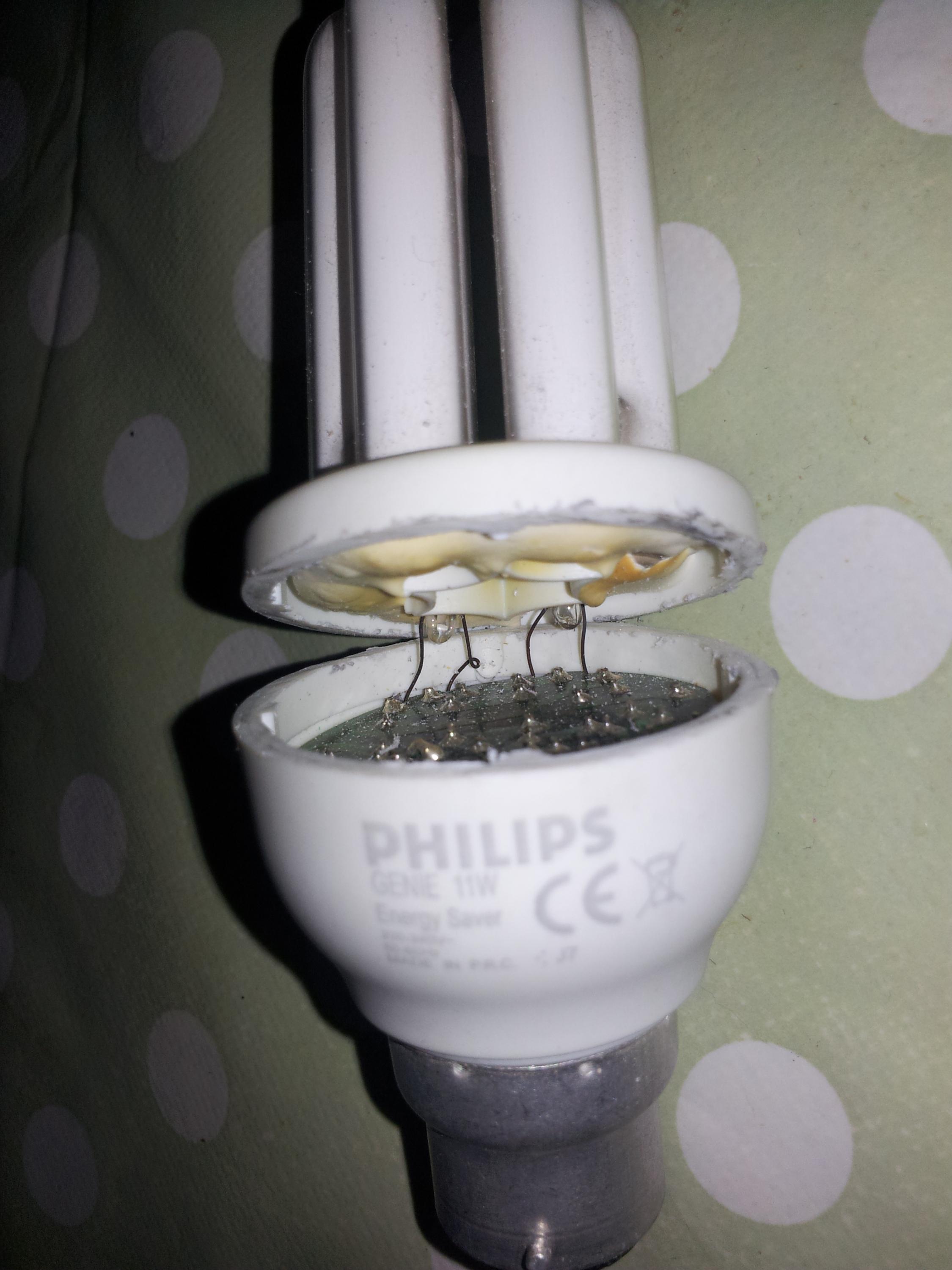

                Decided to hack a Philips 11w Genie Energy Saver bulb for inverter lamp testing, is this one suitable?
                Guess I'll soon enough find out!
                I noticed that your inverter b/d is slightly different to mine, where your blue and black wires go to the inverter would imply supply and return on the one connecter whereas other inverter b/d's (like the one I'm currently using) have the 'gnd' pin on a 2 pin connector at the bottom of the inverter b/d.
                  Re: Inverter tester using old CFL
                  There is no polarity on the lamp connections to the board, as long as the wires are connected to the two pins of the socket that will be fine. This inverter board is for the TV so the ground return is on the small connector at the bottom right in the pictures, the two pin on the white connectors are for two lamps. If you look at the spec sheet of the panel, it will show how the lamps are arranged inside the panel.

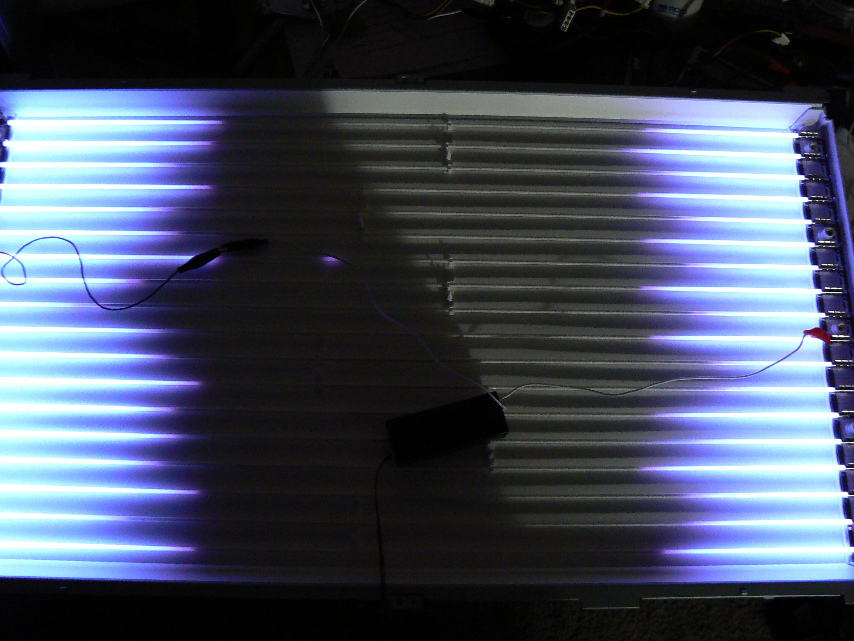

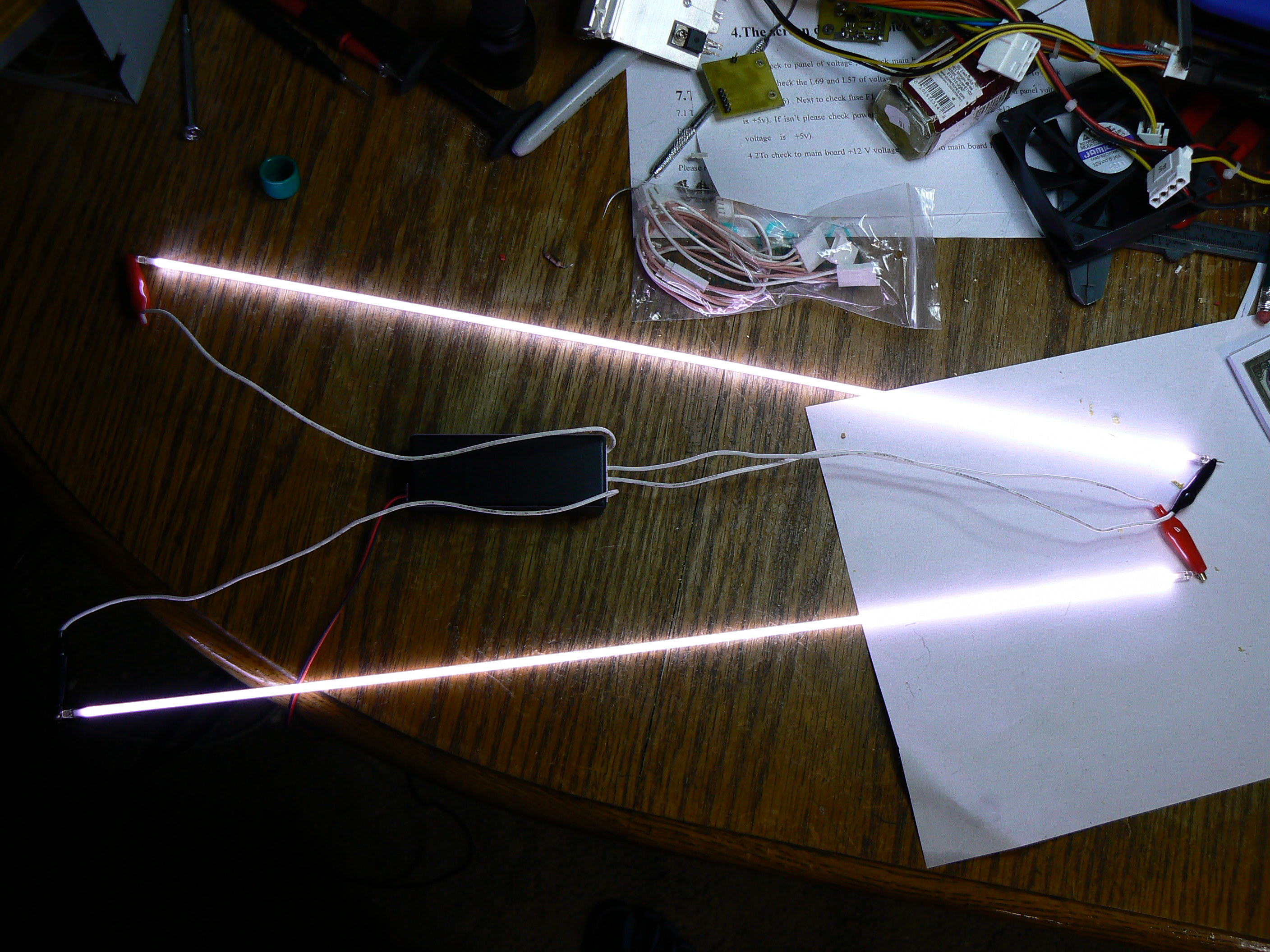

                              LDSisHere,
                              thank you for confirming my choice of the black tester over the blue one. Just ordered it from HK.
                              In the 4th picture all 18 CCFLs appear to be dark in the middle. Do you know why this is happening?
                                The tester is made to drive one or two CCFL bulbs at a time. The 18 are part of a 32in TV where all the bulbs were wired in parallel. The center not being lit is not important as it is due to lack of power. The important thing is that they are uniform and all lit, if one was bad it would stand out. I was just wanting to show what it could do when pushed beyond it's design limits. I would also not do this for very long as it could damage the driver.

                                  The reason I asked is I am seeing exactly the same in my Dell 2408WFPb:
                                  https://www.badcaps.net/forum/showpo...7&postcount=19
                                  The curved portions of the U-shaped lamps in the left side of my monitor are equidistant from their pins and they sometimes remain dark whereas the right side of the monitor where their straight ends are located ignites just fine. The fact that all 7 of them are doing this simultaneously leads me to believe that the problem might lay upstream. Perhaps the CCLFs are not getting enough power? If yes, then what common element might be responsible for this?
                                    #37
                                    Not enough voltage to drive the lamp is what I have seen when lamps are not fully lit.

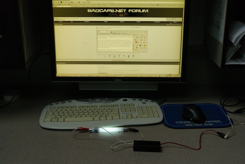

                                        Budm wrote in another thread:
                                        Originally posted by budm
                                        Thanks for the follow up. So what kind of 5W CFL lamp did you use? T5 type?
                                        Yes, I scavenged a 4W T5 bulb from an old Coleman Powermate. I should've gotten 6 more of those along with 7 pairs of alligator clips. The monitor that I was troubleshooting had problems in two inverters at the same time. That's why this single bulb when connected to them one by one would still result in the two seconds to black.
                                        Since we are on this subject.
                                        A while ago I took apart a non-working fluorescent bulb with a spiral tube like in the OP. The bulb was merely a week old and the tube looked brand new w/o any dark spots, so naturally I suspected the electronics. The circuit was comprised of several discreet components and I tested every one that had a p-n junction - they all checked out fine. Next I took apart an identical brand new bulb - fortunately this particular type had the easy to open snap-in cases. I swapped out the tubes with the electronics. After that they both lit up fine.
                                        In this particular bulb (picked up on HD sale: $2.97 per pack of 4, Soft White 2,700K) the spiral tube pins are simply inserted into the two pre-tinned eyelets in the PCB. The pins on this tube were dark of oxidation. My guess is the pins gradually lost contact with the soft tin in the eyelets and the bulb stopped working. I scraped the pins with a knife, reinserted the tube into the circuit and the bulb fired right up. In the hindsight I should've taken apart 3 or 4 dead ones that I had tossed into trash a few weeks ago. I bet they were fine as well.
                                        Yesterday I finally received that $8 CCFL tester from China. Below is a picture of the 4W T5 bulb connected to this tester in front of the newly repaired Dell monitor.
