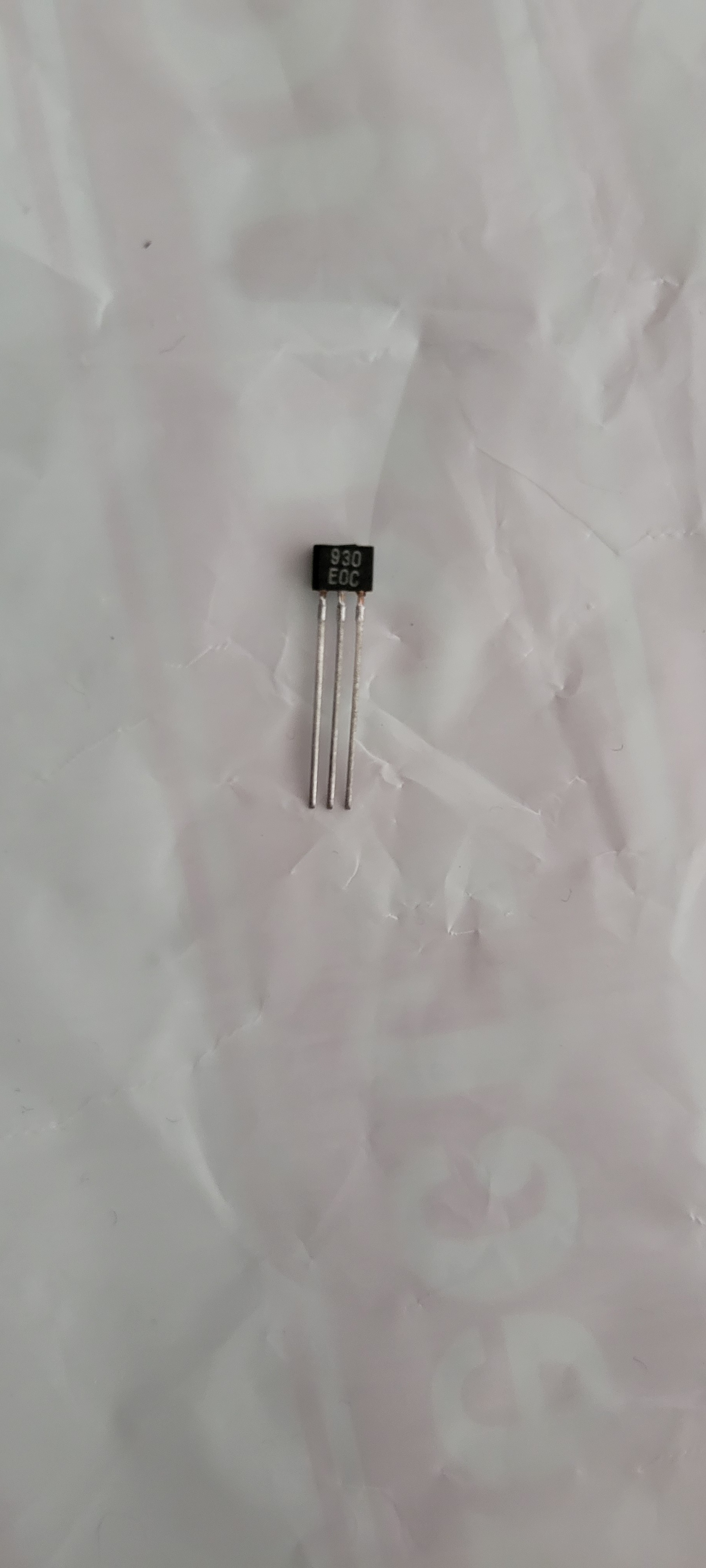

                OK, this is the C930 that I was able to find. Will it match for Q1, should I go with the replacement?
                Also, how to check which pin is E and which is C? I know I can determine the base, it should have positive to negative probe voltage drop of ~0.7V to both C and E. There should be no flow between C and E. But how will I know which one is which?
                This transistor is flat on both sides.

                  #168
                  If it's the same model as the old one, it should be the same pinout.
                  The text marking should be on the same side.
                  So just put it in the same way around as the original one, with the text facing the same way.
                  Otherwise, you can check with the datasheet, which will tell you the pinout.
                  In the datasheet stj posted, you can see the pinout.
                  Yes the case is flat on both sides but there is a bevel edge on one side, that is how you can reference the pinout.

                    #169
                    This radio is driving me crazy. I found 2SC930 transistors. But the ones soldered at Q1 and Q2 are 2SC1675. Thinking that they are interchangeable, since the manual offers one, I went for it. And - the radio doesn't sound any different even with C930 soldered.
                    I also tested the removed one, 2SC1675, it seems OK. Voltage drop is about 756mV from B to C and 761mV from B to E. This appears normal, right?
                    I wouldn't be surprised if yet another original component turned out to be fine. What a bunch of dead ends this radio is throwing at us! 🙁
