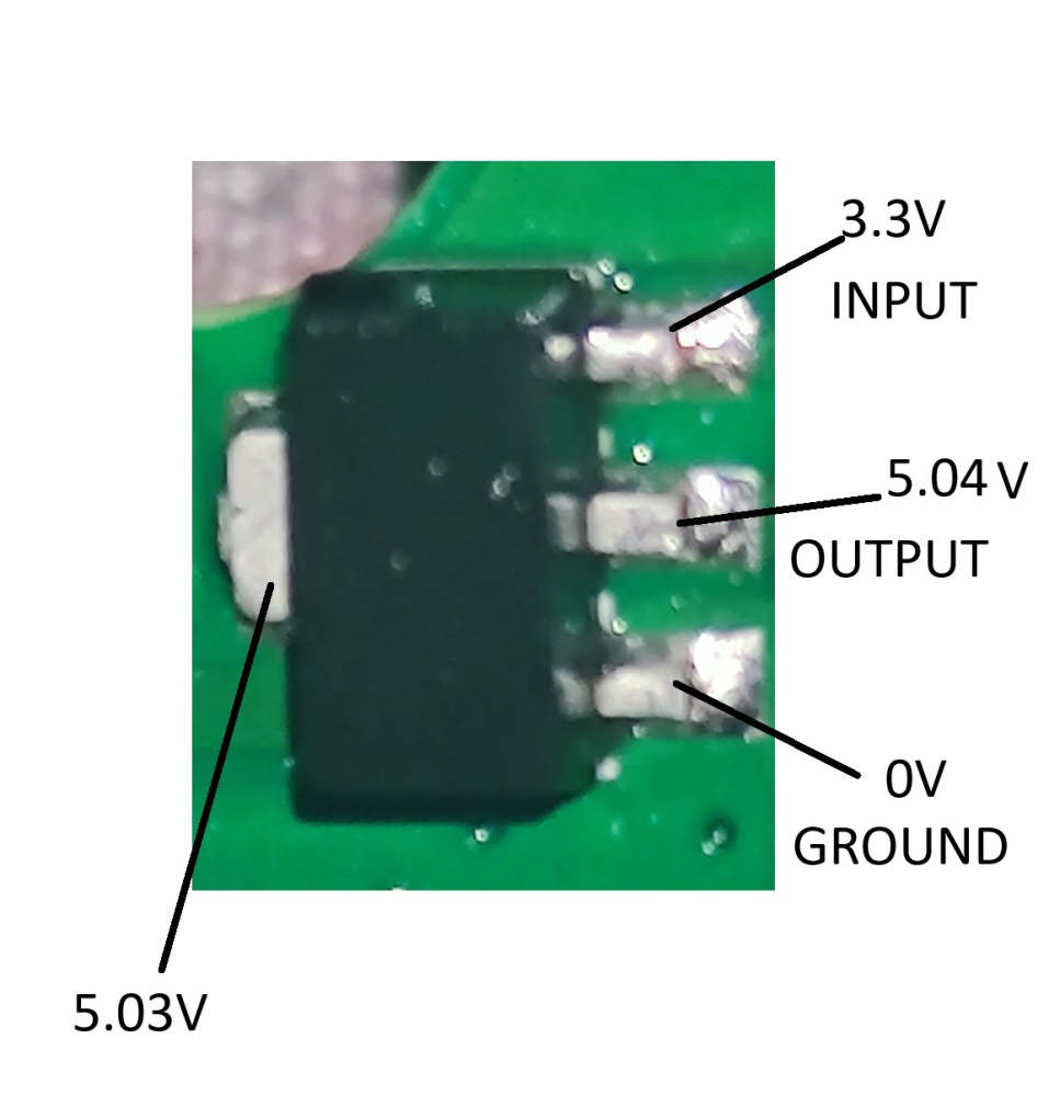

    • Measured voltages around an initially suspected AMS1117-3.3 (SOT-223 package):
      • Pin 1 (GND): 0V
      • Pin 2 (VOUT): 3.3V
      • Pin 3 (VIN): 3.33V
      • Tab (Metal Plate): 5.03V (unexpected)

    • After careful analysis, realized that the component thought to be an AMS1117-3.3 is actually a TPS61221 Boost Converter.
      • TPS61221 behavior: Boosts ~3.3V input to fixed 5V output (matches the observed 5.04V).
      • Conclusion: This component is working as intended.

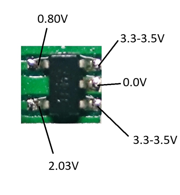

    4.2 SOT-23-5 Analysis
    • Probed SOT-23-5 pins:
      • Pin 2 (Top-right) and Pin 4 (Bottom-right): Both show 3.3–3.5V.
      • Continuity testing between these pins and Winbond VCC (Pin 8) gave a strong beep.
      • Conclusion: SOT-23-5 output is directly tied to Winbond Flash VCC.
          Pin 1 (GND): 0V
          Pin 2 (VOUT): 3.3V
          Pin 3 (VIN): 3.33V
          pin2 is conected internally to the tab, so that makes no sense

            Originally posted by stj
            What I thought as LDO is actually a booster converter TPS61221. The below one.
            Click image for larger version  Name:	image.png Views:	0 Size:	378.4 KB ID:	3624426
            Below is the SOT that has direct continuity with W25Q32JVSIQ (Pin 8)
            Click image for larger version  Name:	image.png Views:	0 Size:	150.2 KB ID:	3624440
