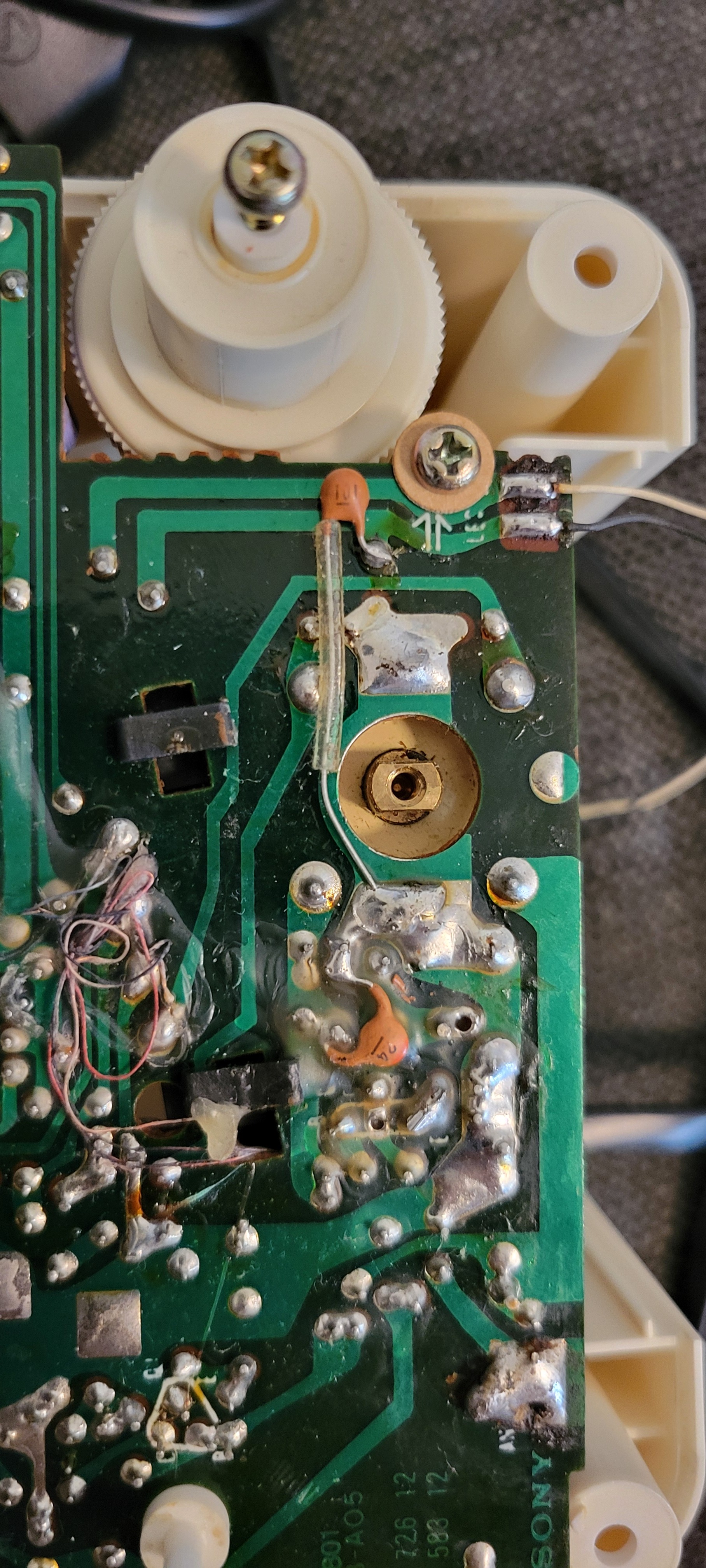

                #147
                Originally posted by Agent24
                No point really looking into that unless you have reason to suspect it, probably it's okay, and even if it's not, good luck finding another one anyway.
                I speak too soon - you can get them all over AliExpress... https://www.aliexpress.com/item/1005006274906905.html
                Did you check the D5/D6 diodes in the FM detector circuit? We already know the VD1220 diodes have a habit of going bad. I don't know for the others.
                They are a 1T26 germanium type and should show about 0.3v drop when tested with a multimeter in diode mode.
                Testing C24 in circuit probably isn't going to tell you much. Desolder it and check it out of circuit, or replace it.
                I tested VD1220 and I would say it is OK. It has a 1.16V drop, but that is within its specs (1.12-1.20V). Plus, while it was removed from the circuit, there was no sound in either mode. So it is safe to assume that if it provides normal volume for AM, then it should do the same for FM.
                Now, D5 has a 0.38 voltage drop, and D6 0.37. So, that's another dead end, I guess.
                R12 measures 0.97K and it really is a 1k resistor, even though the manual suggests a 2.1K one here.
                Now, I attached a probe with a clip to the ANT pad to serve as an antenna. The volume increases, BUT, even though FM is still quiter than AM, it is now loud enough to hear a constant background buzzing noise in both AM and FM modes. You know the one which sounds like an AC unfiltered power, or when a rectfying filter cap goes bad. Only this one is affected by the volume change.
                • UserXP
                  • Apr 2012
                  • 441
                  • Serbia
                  #148
                  Ignore the previous test, the original antenna wire provides the most stable reception, so I using ut now (the volume is still low).
                  also, I removed C24. It measures 10.0nF, but it took like almost two seconds to reach the value in gradual increments, and then it stabilized. Without this cap, no sound is produced.
                  Can I temporarily introduce a different cap of this type and see how it affects the volume (if it would), or does the test reveal that C24 is actually fine?

                      #150

                        #151

                          #152
                          Couple more things you can do with what you got. You can check L1 isn’t open and T3. Maybe touch up their solder. But for the rest you need different gear.
                          Will do. In the meantime, I did some additional checking on the working unit. Visually, it is identical, except it has original capacitors. But, I removed the tunning drum wheel. There are two small capacitors soldered onto the board. The faulty unit doesn't have those. I took a picture.
                          Then, I unsoldered its antenna wire. The working unit was still receiving radio signal at almost the same strength as with the antenna wire soldered. The faulty unit can't do that.
                          The main voltage is 13.3-14.8 volts DC, slightly lower than on the faulty unit. But the volume is crisp and prominent even on lower settings.
                          Are the two extra capacitors with ratings 101 and 24 somehow involved in the volume or reception?
                          • UserXP
                            • Apr 2012
                            • 441
                            • Serbia
                            #153
                            CapLeaker, OK, I checked L1, it is OK. I also reflowed the solder points on T3. It didn't make a difference. I also tried touching different solder point pads. Touching Q2's pins caused to switch to a near station frequency.
                            This is getting tedious... 😔
                            Hmmm... here is a thought; provided nobody messed with the trimmers and pots on the board... is it possible that replacing the capacitors alone has somehow influenced the alignment, maybe due to different resistance of the new caps or current flow or whatever?
                            I haven't discarded the old caps. Most of the small ones measured fine, but the bigger ones were bad.

                              #154
                              This radio doesn’t have an RF amp stage. There is the oscillator and the mixer. The mixer heterodynes the frequency you tuned in to a single frequency 10.7 MHz called the IF. The IF is steady regardless of what you have on the dial. So if the mixer would be dead, no heterodyne, nothing would be on the IF. So Q1 gotta be good and working, unless it has no hfe (gain),

                                #155
                                Nah, I don’t think the cap swap did it. But it could be that an adjustable inductor lost a wire and thus is open. Old ceramic trimmer caps are an issue too, but I don’t want you to mess with that, because other wise you might end up with nothing since you don’t have any RF repair gear.
                                  • 31190
                                  #156
                                  swap Q1 and Q2
                                  see if it changes at all
                                  i still think Q1 is vulnerable to damage from static or spikes on the antenna and it could have poor HFE (gain)

                                    #157
                                    Originally posted by stj
                                    swap Q1 and Q2
                                    Q2 is the oscillator… the RF goes though the base of Q1 (mixer). On the older radios there would have been actually an RF amp stage first, but this thing doesn’t have that. It just 2 IF amps, one before and after the 10.7 MHz CF. From there it’s just a couple of transformers, the detector and everything is audio from there on. Either it is misaligned, Q1 doesn’t have any gain, or IC1 has a bad IF amp on one of the two, or the two transformers T3 & T4.
                                    Q1 and Q2 have the same part number… so yes, might work or it’s going to be dead.

                                      #158
                                      Thanks, Stj and CapLeaker. So, you don't think it's Q2. But, if I am to remove it and it turns out to be bad, I'd have to have a replacement part as there is no point in swapping them as I'd be still left with a faulty one in the circuit... Removing Q2 is something I don't how I'll manage to do. It is immersed in some kind of hardened paste. Can I buy a few 2SC930 transistors and just put the leads of the new one onto the pads where the existing Q2 is soldered? If the old one was bad, would the new one in parallel "take over"? This would save me the trouble of actually removing Q2 if it wouldn't be necessary - but, I am willing to try here whatever you guys suggest.
                                      However, Q1 wouldn't be too difficult to remove.

                                        #159
                                        I think stj meant to swap Q1 and Q2 around. The RF path goes through Q1.
                                        No you can’t treat transistors, diodes or even sometimes caps like that. This only works if a component is open. But if a cap is short and you put a good cap parallel to is, you still got a short. So no… who ever thought you that trick, is only for old electrolytic capacitors used.and nothing much else.
                                        i suppose you could double up a working diode that way, but it has to be a matched diode. You just can’t double up things randomly… not a good idea.
                                          • 31190
                                          #160
                                          2sc930 is not made anymore,
                                          the datasheet lists a substitute although i'm confident of finding a newer substitute.
