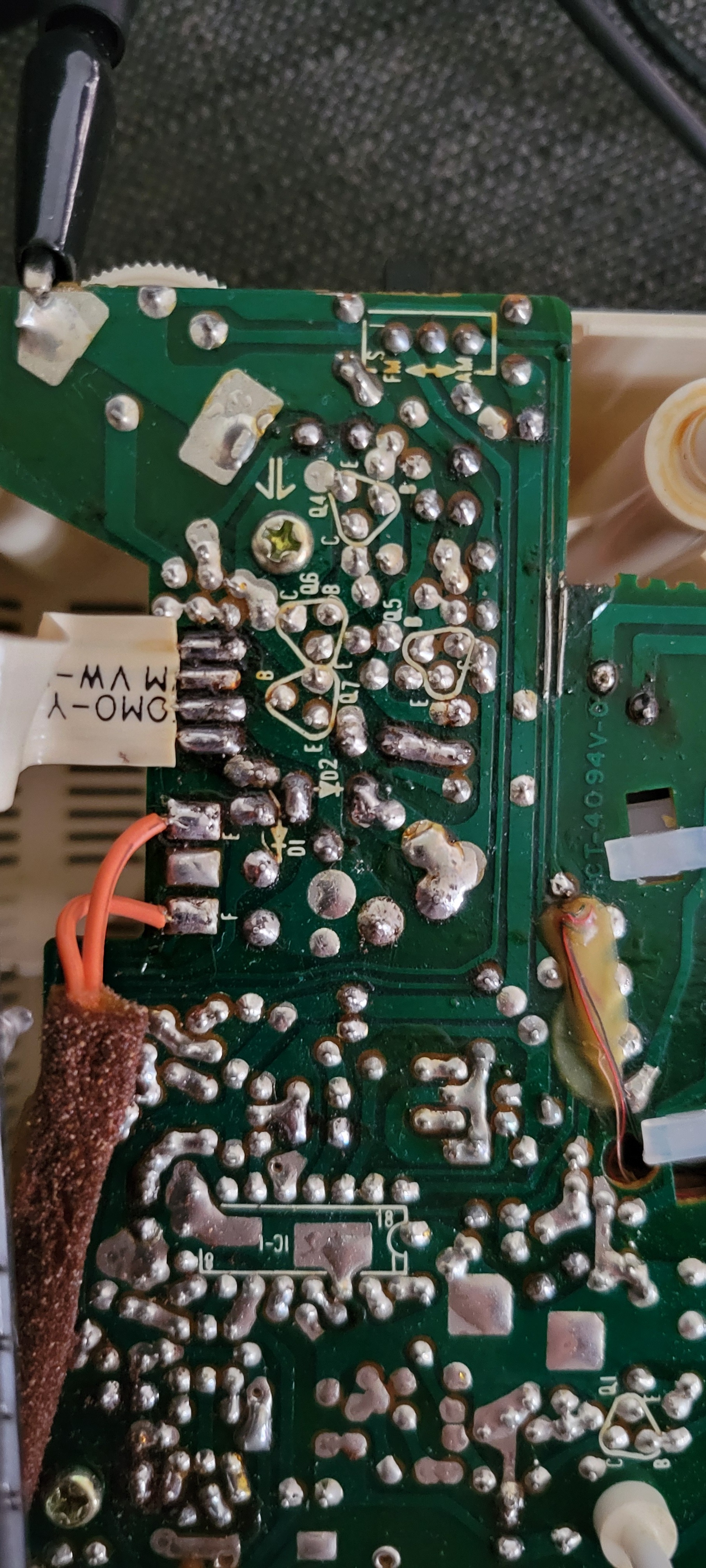

              Already done that. I visually checked each cap. Also, I took pictures of the top of the board with the old and with the new caps and compared the two. All negative stripes are oriented the same way in both images.

                      I did some additional measurements. I measured voltages on the transistors Q4, Q5, Q6 and Q7 (in volts). The C12L manual I currently have has two models covered: UK (with FM, MW and LW bands), and AEP (only FM and AM bands, like mine).
                      Q4 voltages:
                      E = 0.00
                      B = 0.62
                      C = 3.07
                      Q5 voltages:
                      E = 3.67
                      B = 4.27
                      C = 7.44
                      Voltages here are also less than in the manual.
                      Q6 voltages:
                      E = 3.67 (manual suggests 6.8)
                      B = 3.06 (manual suggests 6.2)
                      ​​​​​C = 0.00
                      Something appears to be drpping the voltage here by 3.2V.
                      Q7 voltages:
                      E = -0.18
                      B = 0.64
                      ​​​​​​​C = 0.00

                        Update: I removed both 1N4001 diodes from the board and they both passed the test, 0.590V in bias, 0.L. reading in reverse, which indicates they are OK. I then tested D4, which is a VD1220, it measured 1.2V in both ways with reversed probes, which I also think is normal for this old type of diode. The two 5.1V (1S1555) zener diodes also tested OK. I then removed a small 1nF capacitor which was in paralel with D2. It also passed the testing. I powered on the board without it and the power was still the same.
                        Then I disconnected the flat ribbon cable - and only got around 0.6V on outputs where 2.56 and 7.56 used to be with the ribbon cable connected.
                        i also noticed that, when increasing the volume quickly, it hits a random place on its pot where the sound completely mutes for a second or so with a slight "pop" sound from the speaker. It stays like that for a second and then the sound reappears with the same slight pop sound. It is as if when increasing the volume fast the circuit experienced a lack of already low voltage, insufficient to momentarilly increase the volume but needs that little time to "recharge" to continue.
                        I am at a loss what else to try. Something is draining the voltage, nothing gets hot. In some areas the voltage should be around 13.5 to 14V, yet only 7.5 is there. If the radio is off from the AC power for a while, that voltage turns on at around 6.9-7.1V upon plugging AC back in, and as it stays on, it increases to 7.5 and just stays there.
                        Any ideas what else to try? I can't really understand the rectification circuit on this board if it is dependent on the small function board and which section. Please guide me with detailed steps so I can follow. Thanks in advance, guys.

                              Update: I desoldered VD1220 and measured it then. It gives 1.16V one way, and 0.L. reading the other way. According to the specs, the voltage for these old diodes is 1.2 volts. So this old diode appears to be working within specs?
                              But when soldered onto the board, it measures 1.2V in diode mode on both ends (depending on the probes orientation, it just displays + or - 1.2v on the multimeter).

                                  Yes, I did. On one end, the display is attached with two orange wires to the main board, E and F. These provide the voltage for the display illumination (the Bright switch, H and L positions). When these two wires are unsoldered, the display does not turn on, the radio function is still there and the voltages on the main board remain the same (7.56V highest)
                                  When the ribbon cabble is unsoldered, the voltage drops to 0.61V (where initially maximum 7.56V was) and even 0.18V where the output for the low brightness can be checked (previously 2.56V with the ribbon cable soldered).
                                  I am not sure what on the function board is involved in the rectification circuit, because without it, the voltage drops significantly. The ribbon cable is attached directly to the power transformer output: first ouput tap (1), 6VAC tap (3) and 12VAC tap (4). I think that pin (2) is the one activating the radio by the rotary function switch or the chip in certain modes.
                                  Powering the radio on while D4 was out of the curcuit resulted in the absence of any kind of sound on either AM or FM band.
                                  Yes, I have the same service manual, but the layout of some components is just slightly different on my board. All the components are there, but the traces and solder pads are somewhat different for some. I am awaiting the original C12W service manual, maybe it will have the same layout as that of my board. I don't know what else to try to get those normal voltages.

                                          Yes, it is number (2) pad in the manual, but on the board it is B (they are printed as A, B, C and D on the board:
                                          A= PT0 (frequency signal for time counter)
                                          B= Base of Q7
                                          C= PT1 6VAC
                                          D= PT2 12VAC
                                          That B, or (2) pad comes from the rotary switch and OKI chip. The way I see it, but could be wrong, the rotary switch distributes the voltage it receives through the Bright switch, L or H setting (two orange wires, E and F pads on the board). E pad is ground, F pad provides the positive ~4.5 (L setting) or ~13.5 volts (H setting). So the 11-13.5 voltage (pink trace in the manual) must already be provided from the main board in order for this to work as intended.
                                          The voltage from the rotary switch's On position is then divided through R102 (4.7K) and passed to Q7, likely to turn the radio circuit on. Which it does, but the FM stations are very low in volume even on maximum volume knob setting. The AM only has crackling sound, but it increases normally with volume, it just can't pick up anything as there are no AM band stations here where I live.
                                          Still, the positive voltage should be the same on all positions of the rotary switch where the hand joins the pink pad with function pads, even at Off position, and work with the VFD at the same level regardless of the rotary switch position.
                                          Something is "eating away" those ~4 volts, making the voltage 7.56 instead of 12-13.5V.
                                          The signal reception on FM is great and can tune to many stations and the sound has no distortion - except it is very low in volume.
                                          So, it is safe to assume that the volume knob works, since it increases the volume for AM normally, but veeery gradually for FM until it is heard in just low volume at max.
