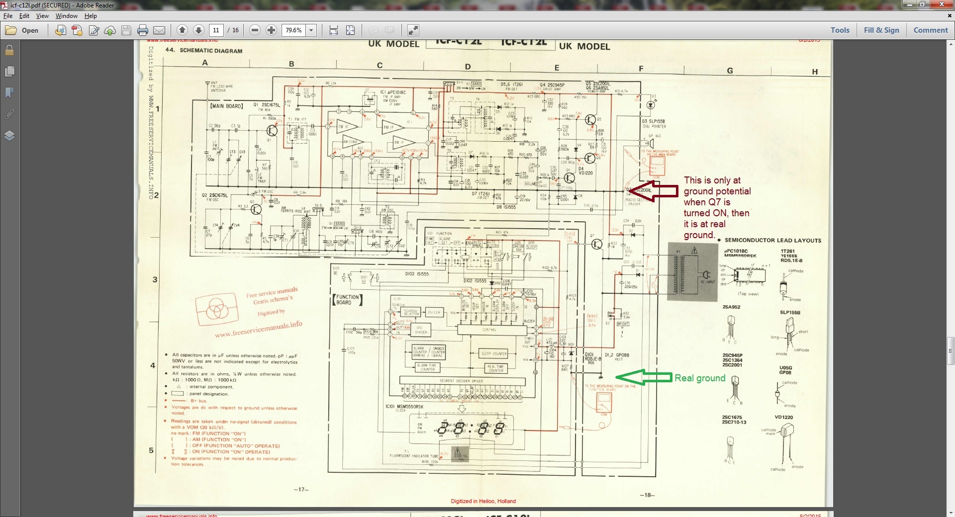

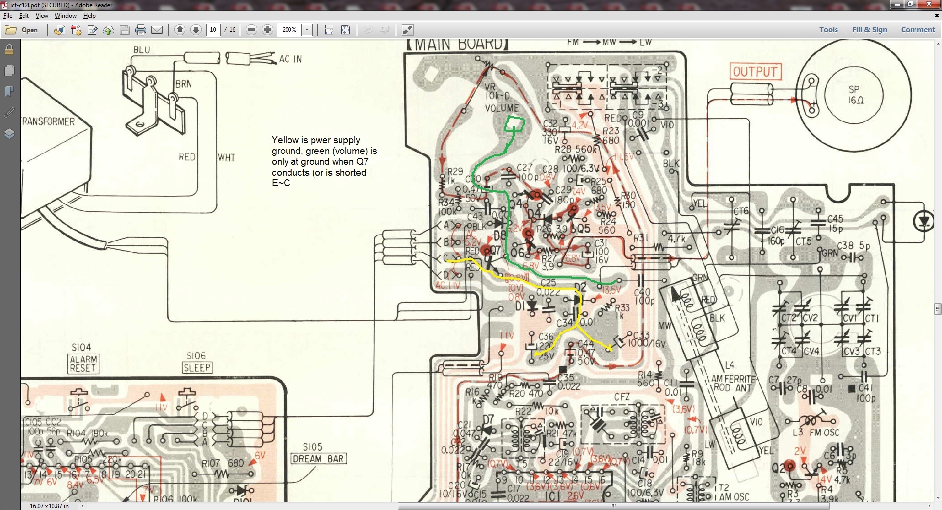

                    #69
                    If you have your negative meter lead where the vom picture (Q7) shows, try check your dc voltages with your negative lead on the negative of C33 or C36, if the voltages are correct, I suspect a fault with Q7 or it is not being turned on, it connects the power supply negative to the radio/amp section.
                    Place your meter negative on C36 negative and check voltage on Q7 base and collector (emitter should be same as your ground)
                    I suspect Q7 is either not being turned on (0.8v on base) or Q7 could be open (bad) If you have 0.8v on the base of Q7 and anv voltage on Q7 collector, try shoring Q7 emitter to collector and see if radio works.
                    On this clock radio, they switch the ground circuit for the radio/amp section (except for Q2 circuit which is connected to chassis ground and not switched ground)
                    The easiest place to attach the black probe clip is at the top left corner where the volume knob metal body is soldered to the board, or the FM/AM switch housing as it is also soldered in contact to the same pathway.
                    This is why you are getting weird dc readings, if the radio (Q7) is not turned on that ground is floating above the actual ground.

                          • R_J
                            • Jun 2012
                            • 9588
                            #73
                            As far as I recall there was almost nothing on Q7's E B and C.
                            Q7 emitter is at power supply ground, the base needs to be turned on to connect the radio/amp ground (Q7 collector) to power supply ground, If his ground probe was on the volume control ground, it would be floating and not at power supply ground
                            If Q7 is not conducting, the volume control ground point is NOT at ground potential, Q7 is the only path to power supply/chassis ground

                              • R_J
                                • Jun 2012
                                • 9588
                                #75
                                That explains weird voltage readings on the radio side. But does not explain the weird voltage reading on the clock or display side whatever comes from D1. I feel like
                                If the meter is not on power supply ground, you will not get proper voltages, to get the correct voltage on D1 you must connect the meter ACROSS C36, if the meter ground is on the volume ground, who knows what voltage it might read.

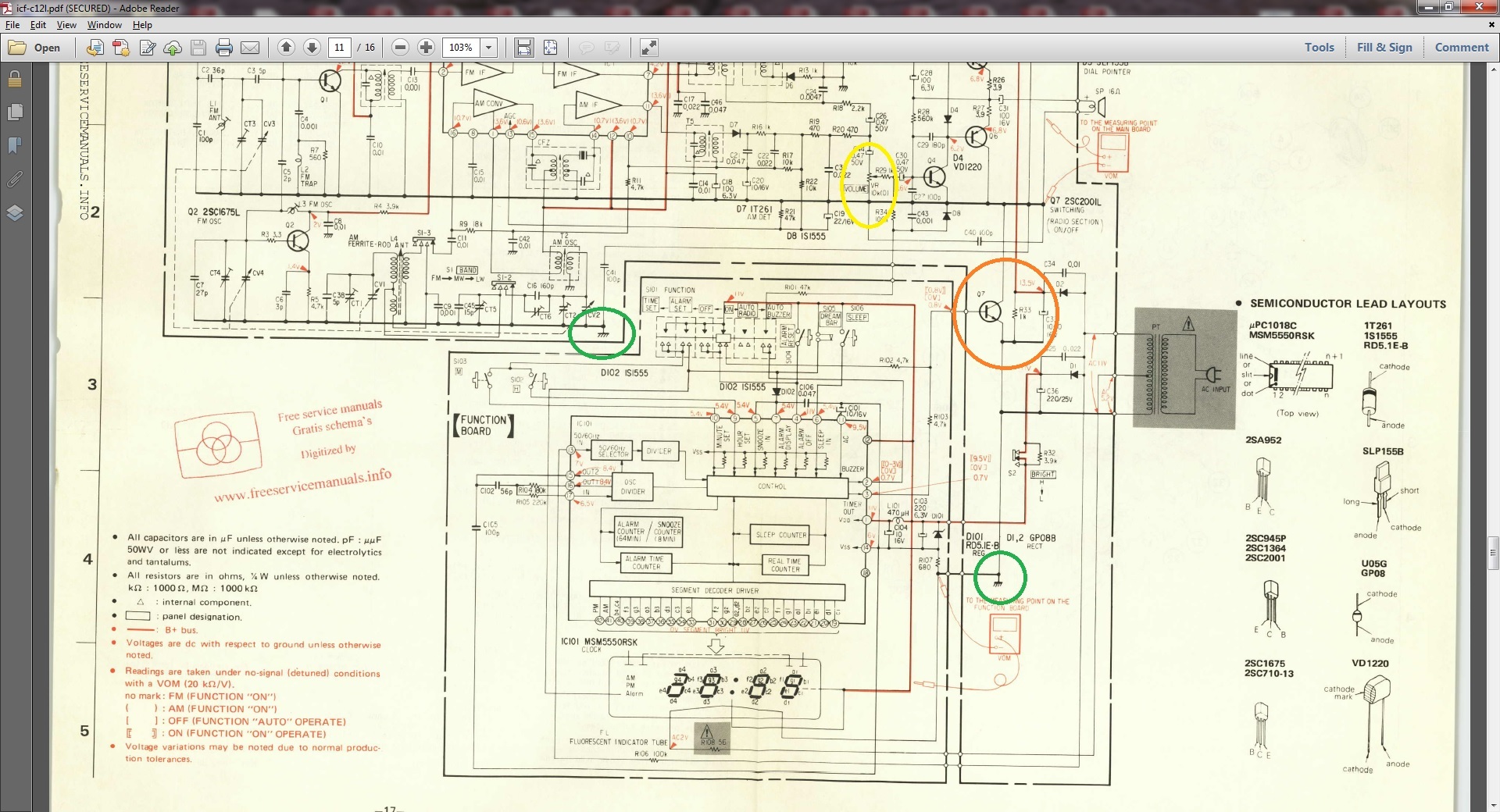

                                  • R_J
                                    • Jun 2012
                                    • 9588
                                    #77
                                    If the radio is turned ON, on the working unit, then Q7 is conducting, connecting the volume ground to power supply ground, then the voltages would be correct using volume ground, if the unit was in the OFF state Q7 would be open, and I suspect the voltages would be weird as well.
                                    The non-working unit may have a switch problem or Q7 may just be open, there are two ways to turn on Q7 one via R103 from the controller and one via R102 from the on/off switch

                                      • UserXP
                                        • Apr 2012
                                        • 441
                                        • Serbia
                                        #79
                                        @R_J
                                        i did what you suggested:
                                        I turned the radio on. It produces sound from, but in very low volume.
                                        i put my black (negative) probe on the negative end of C36 and here are the readings by the red (positive) probe on Q7:
                                        B = 670.8mV
                                        C = 018.2mV
                                        E = 0.000mV
                                        I then kept the black probe on C36 negative and touched the ground with the positive (the ground indicated by the arrow in the manual) and got the same reading as on Q7's C pad (018.2mV).
                                        is this how you wanted me to test, did I do it correctly?
                                        By the way, using the same probing method you suggested but this time when the radio is turned Off, Q7 readings are: B = -1.1V (but it is dancing, going up and down, not stable)
                                        C = 7.1V
                                        E = 0.00V
