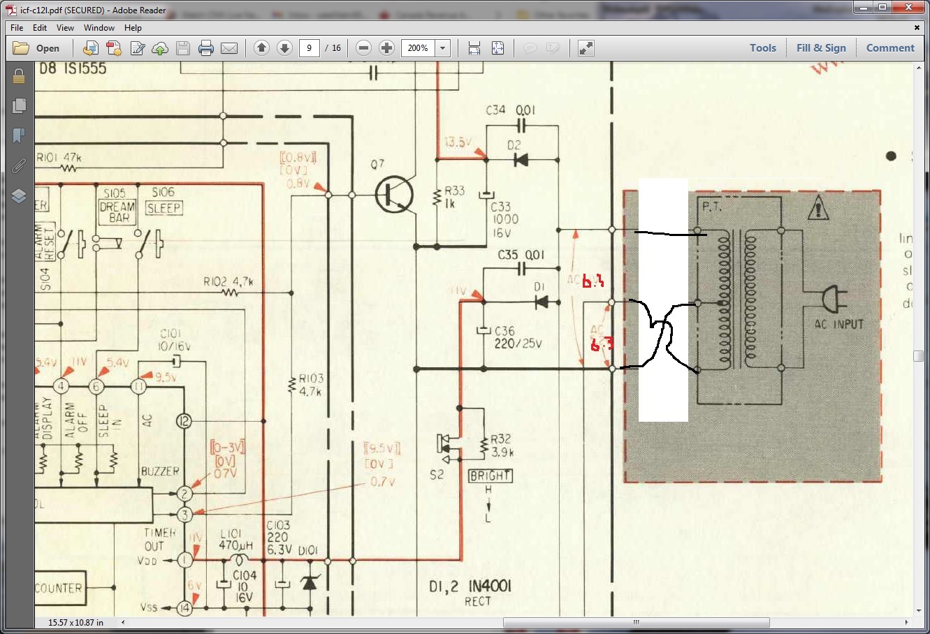

                  Yes, I have already posted about the AC output, but here it is again.
                  The transformer has 3 taps: 1, 2 and 3:
                  The voltage between 1 and 2 is 6VAC
                  The voltage between 2 and 3 is 6VAC
                  The voltage between 1 and 3 is 12VAC
                  This is the same in the working unit.
                  OK, I did what you suggested. When negative probe is on negative of C36 and positive probe on transformer output tap 1, it reads 6VAC. On tap 2 it reads 0VAC. On tap 3 it reads 6VAC.
                  Now here is for the diodes:
                  black probe on C36 negative side, D1 anode reads 6VAC.
                  black probe on C36 negative side, D2 anode reads also 6VAC.

                    The transformer is wired to the board wrong. It looks like the center tap is connected to C36 ground and one of the red wires is connected to the d1,D2 anodes. The center tap should be connected to R108 and the two red wires are connected between C36 ground and D1.D2 anodes supplying them with the 11VAC they need to produce the 12~13vDC
                    Those transformer numbers don,t tell me much but 1 and 3 need to be connected between C36 negative and D1 anode
                    Which wire is the black lead, 1,2 or 3 ?
                    You must have the center tap connected to C36 negative to get those voltages and that is not right

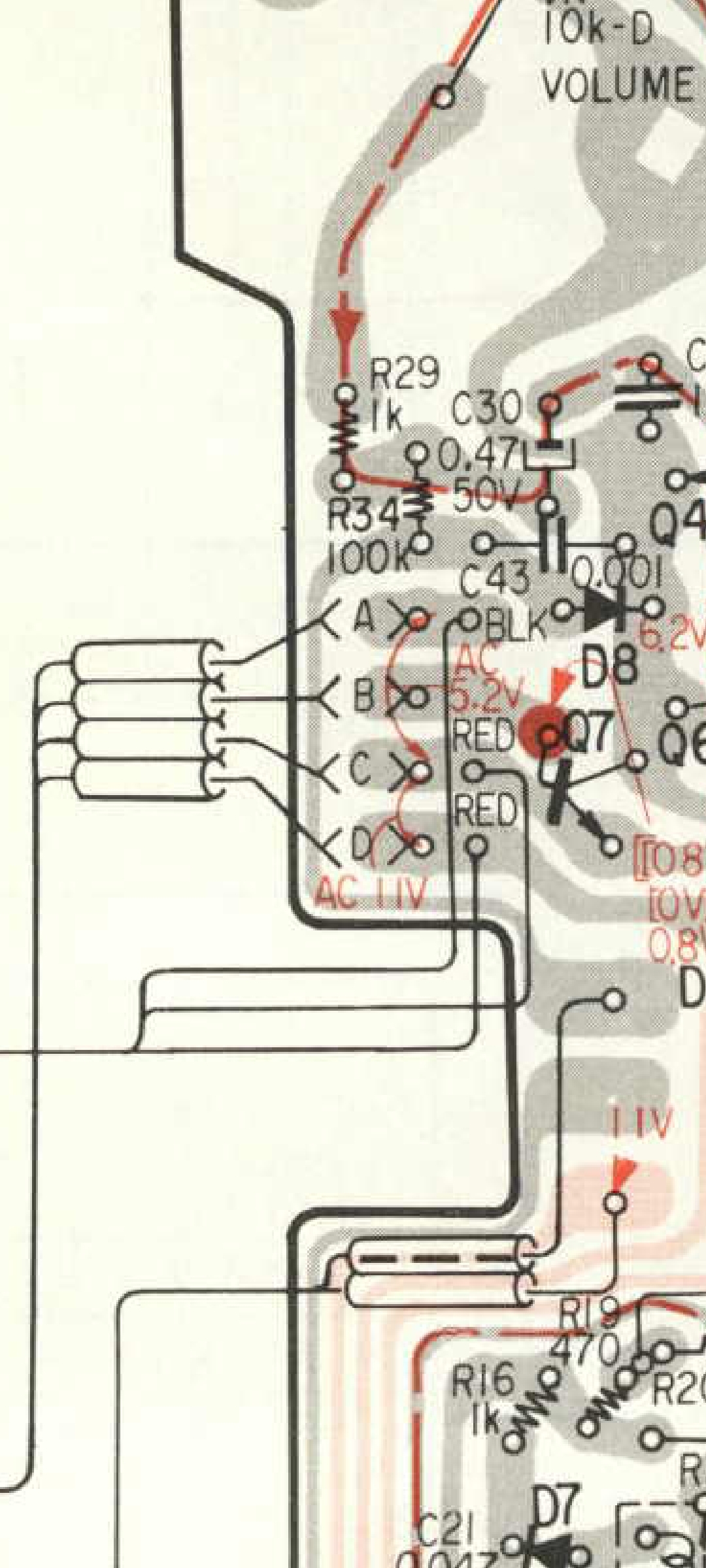

                      But, in the manual, look at where the transformer is connected: pads A, C andD (B is not connected to the PT).
                      The red line-arrow between A and C shows 5.2AC. And a "continued" red line-arrow between A and D say 11AC. The outputs on my board are soldered exactly like that, only the TP obviously has two 6VAC, not two 5.2VAC output. Plus when I measure those contacts I get the same reading order as in the manual.
                      (as I described in my previous post).
                      Or do you suggest I should switch the wires soldered on points C and D?
                      If we are wrong, we could seriously overvolt a 6VAC circuit on the function board, hm?

                        The only way to get what you measured it to have the transformer connected like this, which is wrong, someone must have changed that transformer and connected it wrong
                        I do not see any pads numbered 1,2,3,4, I do see A,B,C,D on the main board layout
                        Post a picture of the transformer wires and how they are soldered to the main board

                          Yes, it depends on the diagram you are looking at, the UK model has numbers and the AEP model has letters.
                          So, you think the first output wire (let's call it zero) goes on pad A, the center tap wire (6VAC) should go on pad D, and the third wire (the second 6VAC) should go on pad 3 and deliver combined 12VAC there?

                            R_J, you may be on to sommething here! I just noticed the board layout of my radio matches that of the AEP model, not the UK model.
                            The power input really seems to be 0-12-6VAC between pads 1, 3 and 4!
                            This radio shows signs that it has been repaired before, so maybe the PT really IS connected wrongly!

                              Finally something that does make sense to me. Somebody used the center tap as ground. That definitely would cut all power in half.
