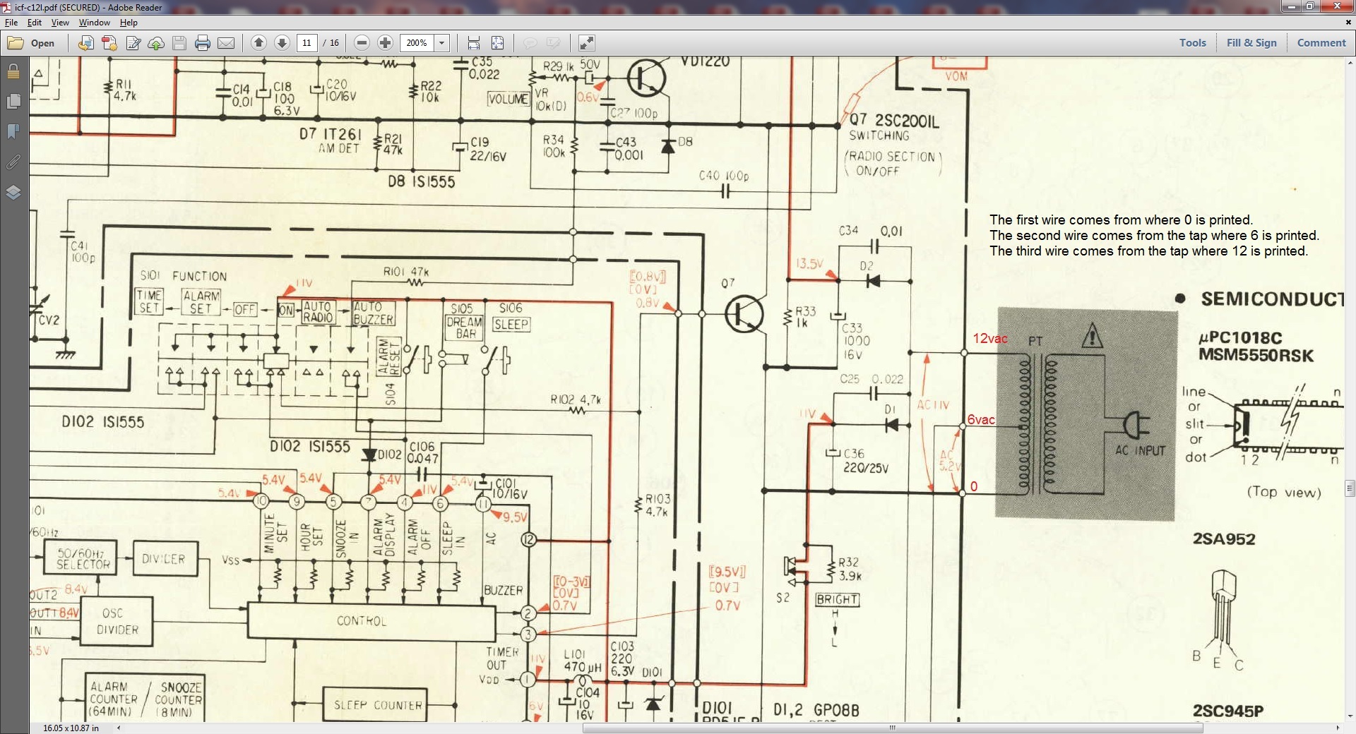

    R_J, I put the wires like you suggested, but I haven't attached the ribbon cable. I plugged the AC in and I, be prepared, still have only 7.64V.
    The two anodes of D1 and D2 are connected by a trace on the board. I followed your advice with the C36 cap, but I get 6.1VAC on both anodes.
    In DC mode, the C36 area reads 7.64V on the black probe.
    This is without the function board attached.
    Does this sound normal?
    The way I drew it in post 91 is NOT THE WAY to have it connected, That is the WRONG way and that is why you are getting the WRONG voltages
    How many times do I need to ask for the pictures?
    You have it connected WRONG again and are now supplying 12vac to the filament instead of 6vac

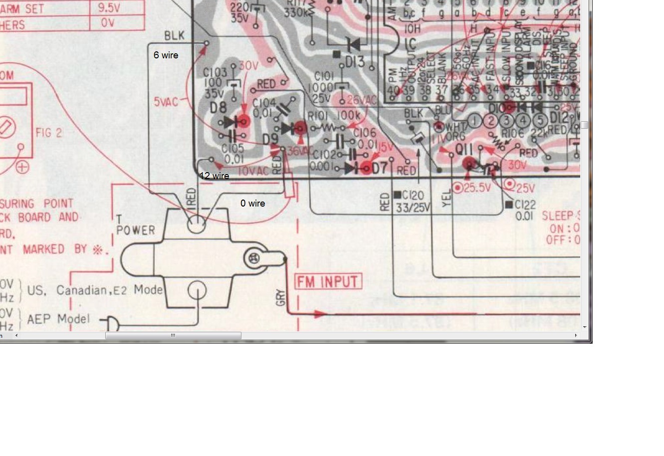

      Originally posted by UserXP
      Can you help me with how to wire the PT?
      It has three orange wires coming out.
      The first wire comes from where 0 is printed.
      The second wire comes from the tap where 6 is printed.
      The third wire comes from the tap where 12 is printed.
      There is a sticker on the coils housing and this where the numbers are printed, right above each of the taps. The TP says it is 230VAC, 50Hz, 6VA.
      0 is the center tap
      6 supplies 6vac (referenced to center tap)
      12 supplies 12vac (referenced to center tap)
      So the 0 wire connects to Capacitor's negative , the 12vac connects to the diodes anode, the 6vac connects to the resistor that feeds the display filament

        Originally posted by R_J
        0 is the center tap
        I really appriciate your help and I do apologize, but I'm doing the best I can. 😥 It is very difficult to take photos of components-side-up with everything connected because the wires from the PT are tight in length, the PT is mounted to the case and two speaker wires are also tight in length and the speaker is glued to the case. All this makes it very difficult to turn the board components side up because the cables restrict movement.
        All wires from the PT are like 3-wire orange ribbon cable, all identical. I now see that the cable must have twisted around its axis and ended on the board in the opposite way while moving it over, so I must have overseen it when I threaded the wires through holes, my fault. It is very tight and almost impossible to maneuver the wires through the three holes and not have them pulled out while turning the board again to solder.
        i hope the display is fine as it was on for maybe half a minute while I was measuring the voltages when I noticed the three bright heaters inside and immediately unplugged the AC cable. It is quite late here now so I will recconect the wires tomorrow the way you illustrated. 😊

            R_J, I soldered it properly this time. 6VAC to the heater, Tap0 to capacitor negative and 12VAC to diode anode.
            You did it, you solved the puzzle!!! 😊 The voltages on D1 and D2 cathode ends are now 14.9-15V DC in Radio mode on. In radio Off it is the same.
            The bright switch now also works as intended, L illumination setting is now well visible and H setting is in very nicely lit cyan colour, just like on the working unit.
            This is all good news!

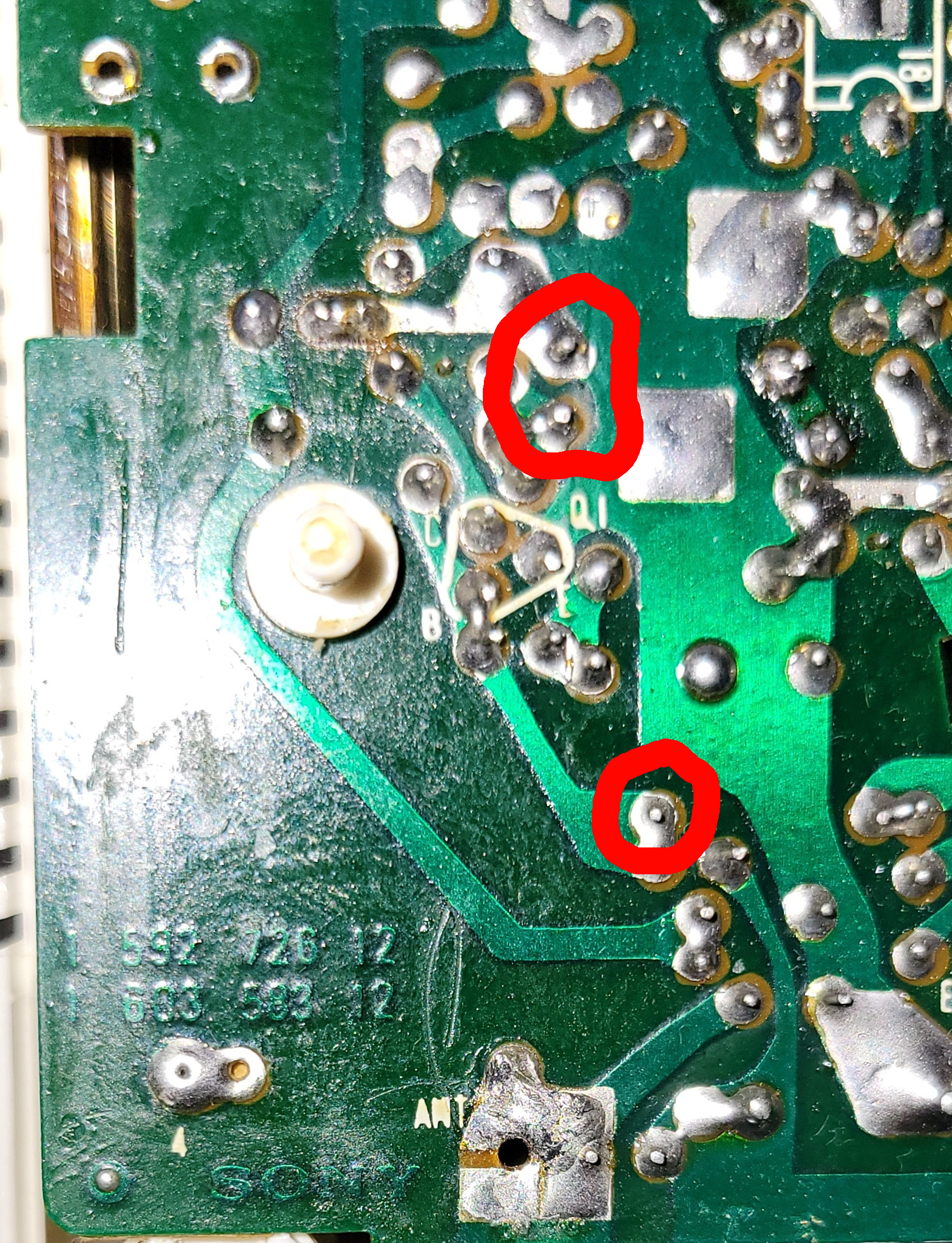

                    • 31190
                    #109
                    there are atleast 3 cracked solder joints in that picture.
                    almost there though

                              #114
                              fix the bad solder joints first
                                  almost there though
                                  I agree, some of those joints do look a bit suspicious.
                                  UserXP: The bad ones have a kind of ring around the lead, and aren't smooth all the way across
                                  There are some just up from where Q1 is marked on the underside that look like that.
                                  -David VanHorn
                                    I know, but some pads are not fully occupied with solder. I mean, the radius of the pad is bigger that the solder, making them look like there is a ring around the solder. When you suggested to check for the existence of cold solder joints, I tried pushing and wiggling each pad point with a cotton swab, it would surely have moved the desoldered pin enought to touch and make contact. None influenced the volume.
                                    BUT, to rule this cause out or confirm it, I will reflux and reflow each of the solder pads and see what happens.
                                    I will measure the voltages also and post back the results.

                                        these

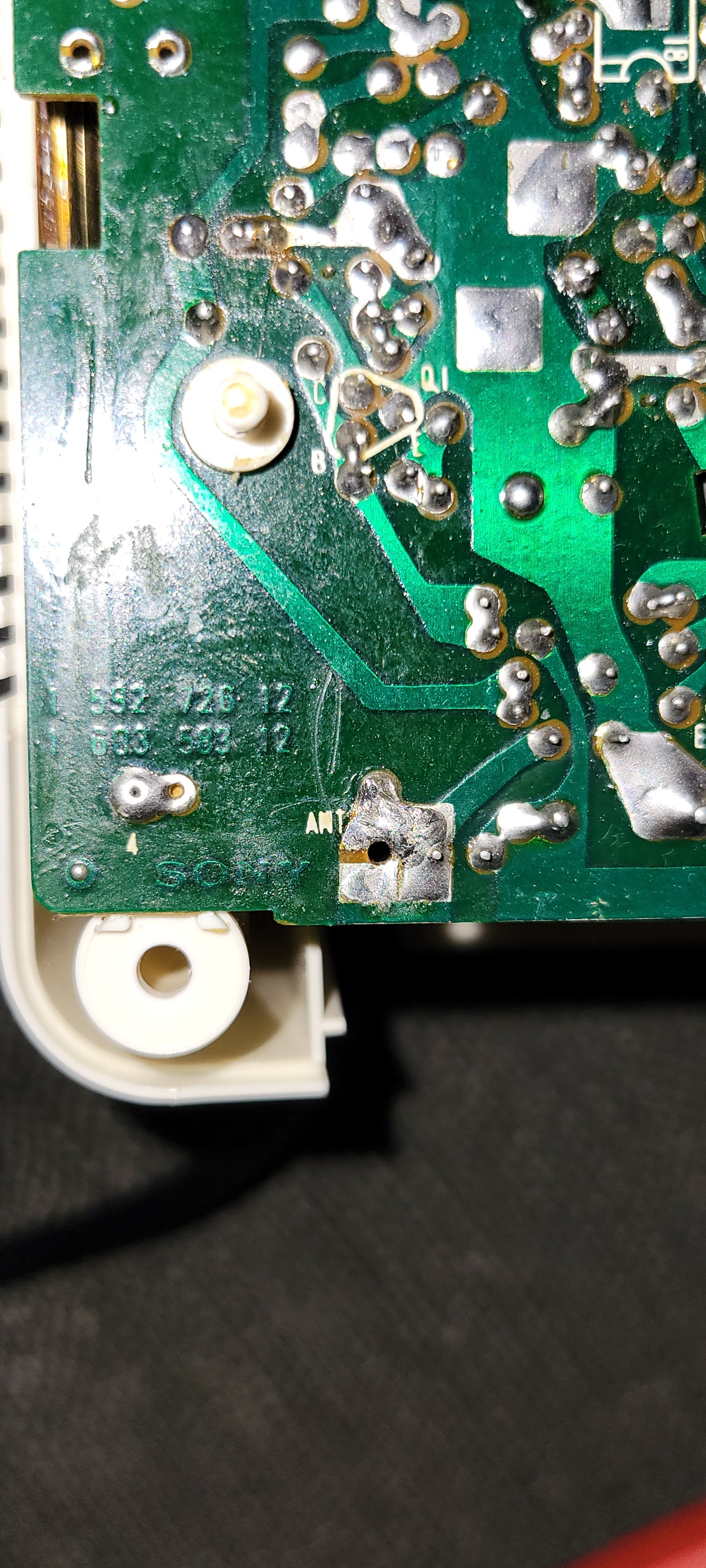

                                          these
                                          Click image for larger version  Name:	bad.jpg Views:	0 Size:	1.90 MB ID:	3703375
                                          OK, I added some solder on those and several other pads that had a thin layer of old solder around the leads.
                                          Then, I desoldered the volume knob pot and took it apart. It was full of dirt. I cleaned the slider contacts and the surface of the pot with contact cleaner spray. I put it back together and now I don't have those "gaps" of sound in random positions like it was before. So at least that is fixed.
                                          But after all this, the FM volume is still much lower than AM.
                                          I also noticed that, if I attach a wire or put a screwdriver on the antenna pad, the FM sound increases a bit, but it is still much quiter that it should be.
