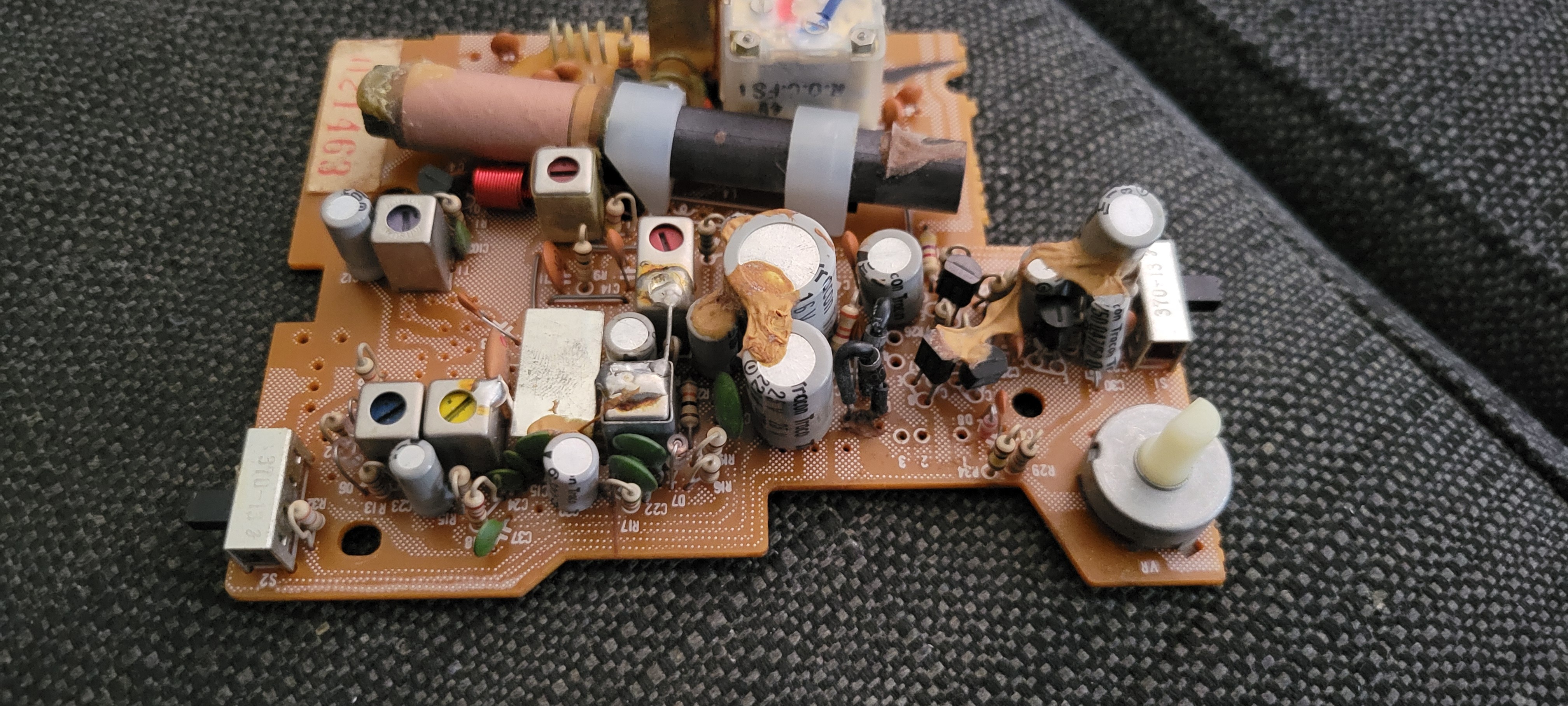

    Dear all,
    I have this old radio clock by Sony from the early 80s, I guess. The clock display works, but is dim, the function board appears to be OK - but the radio unit shows no signs of life. It doesn't produce a single noise, crack or anything from either FM or AM band. It's like it doesn't even power up.

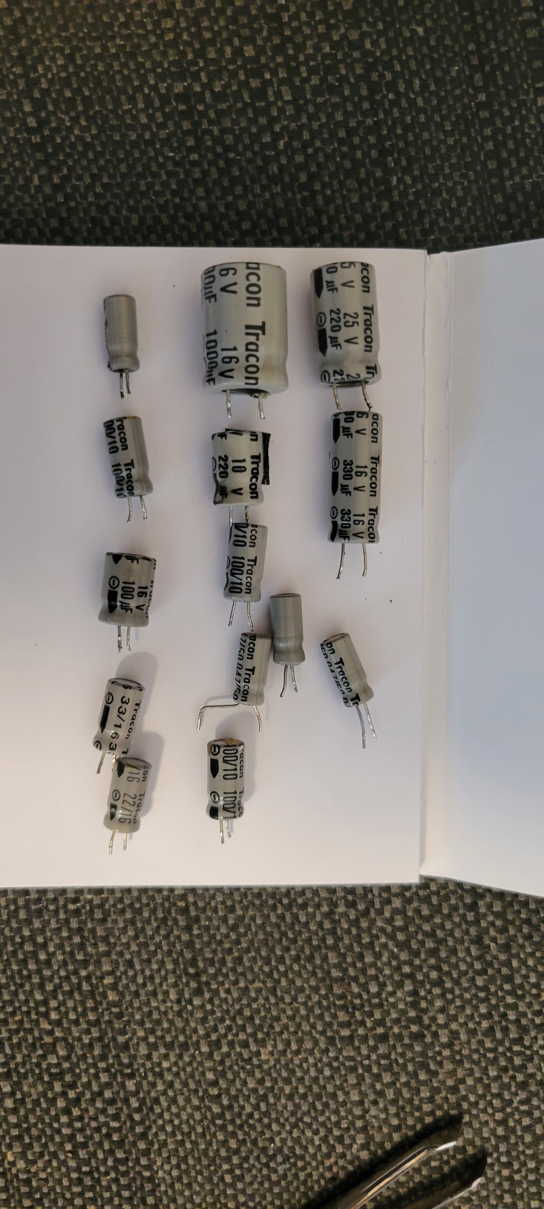

    i opened the radio and it is full of some TRACON gray capacitors. They only have their negative strip printed, voltage and capacitace markings - no series, no temperature marking, nothing else.
    My question is, do you know of this brand of capacitors and how bad are they? Also, can a failure of one or several of them cause the radio to not produce even the static noise, to be completely dead, or should I check something specific?
    i checked the speaker, it passes the continuity check. Also, the Buzzer function of the alarm works, but the radio doesn't turn on then either (whereas it should). Also, the buzzer sound is faint, and when switched the Bright switch is at Low position, the digits are barely visible, the sound pitches down and then disappears. When the Bright switch is returned to High position, the sound comes back. I have another clock of this model which works well, so I can easily compare the output and notice any differencies in operation.
    it is as if something is draining the voltage, depriving the radio/sound unit from power. I have attached the service manual, hopefully you will have some ideas.
    Thanks in advance, guys, all the best. 🙂

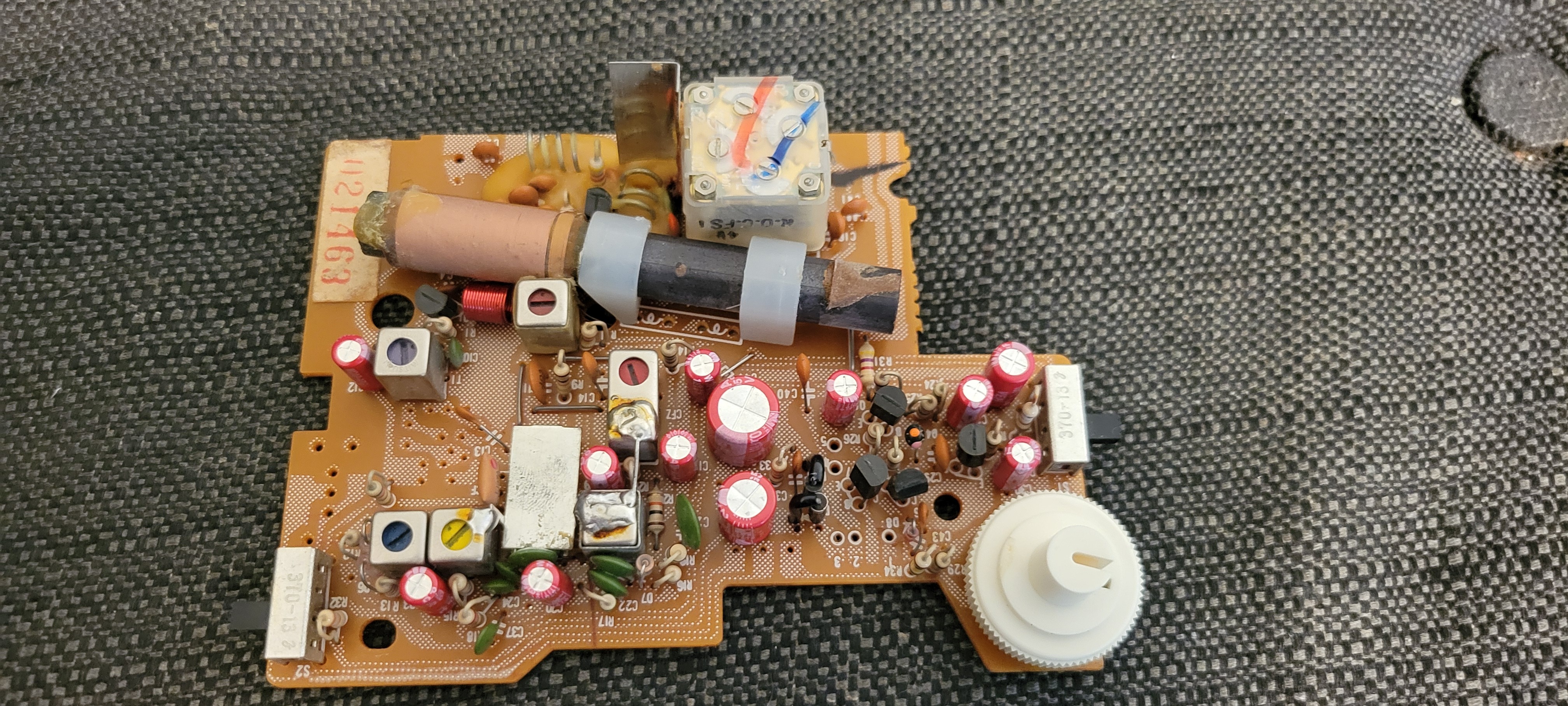

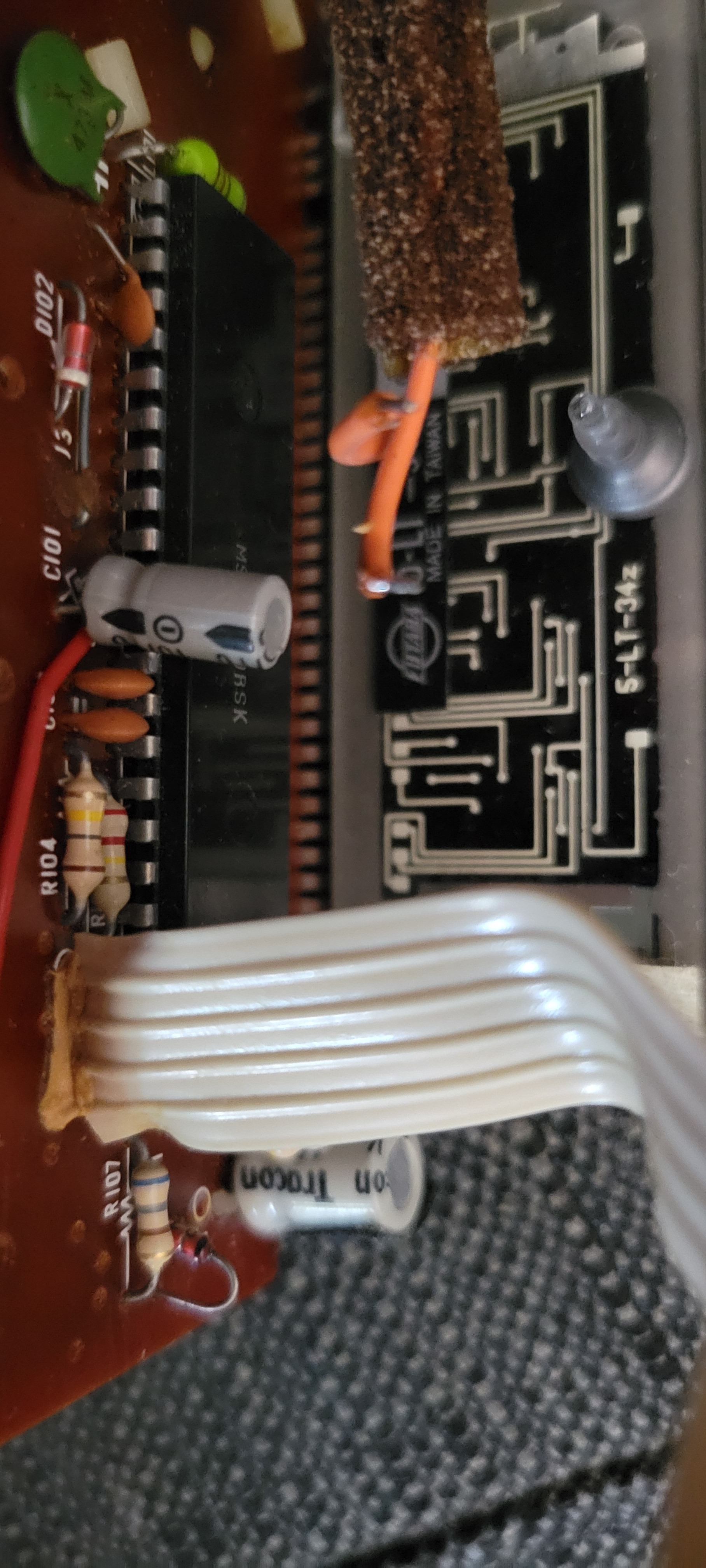

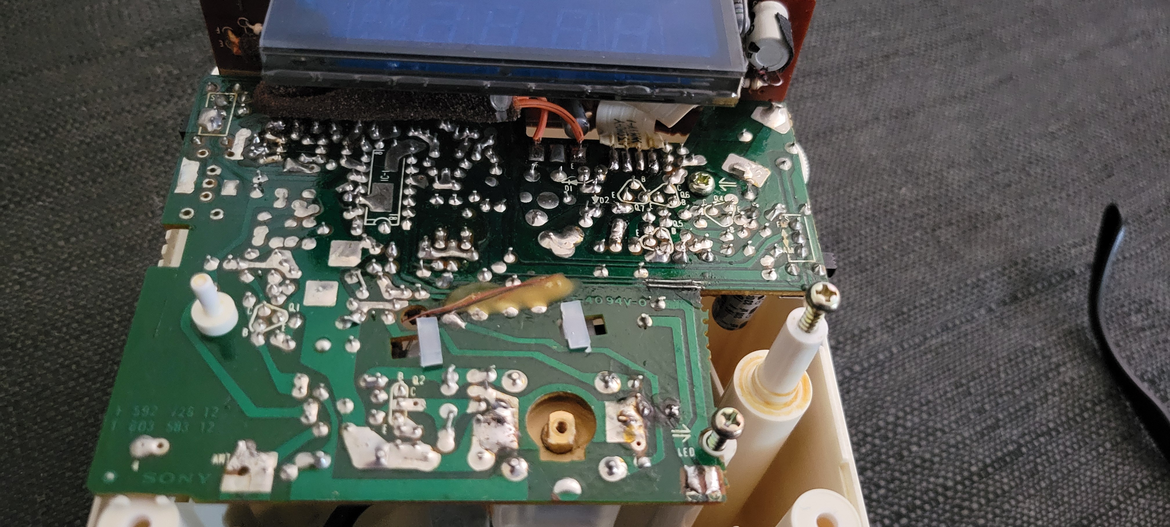

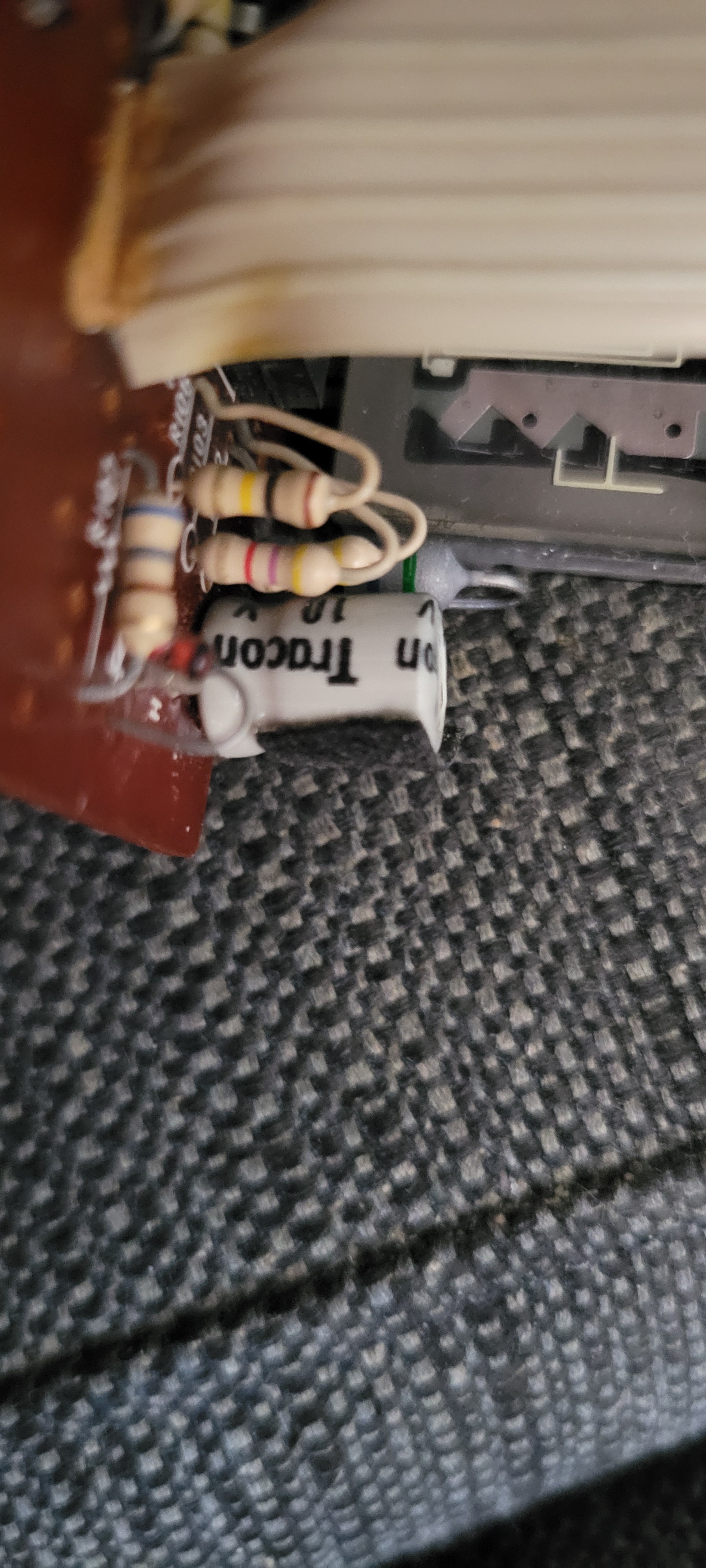

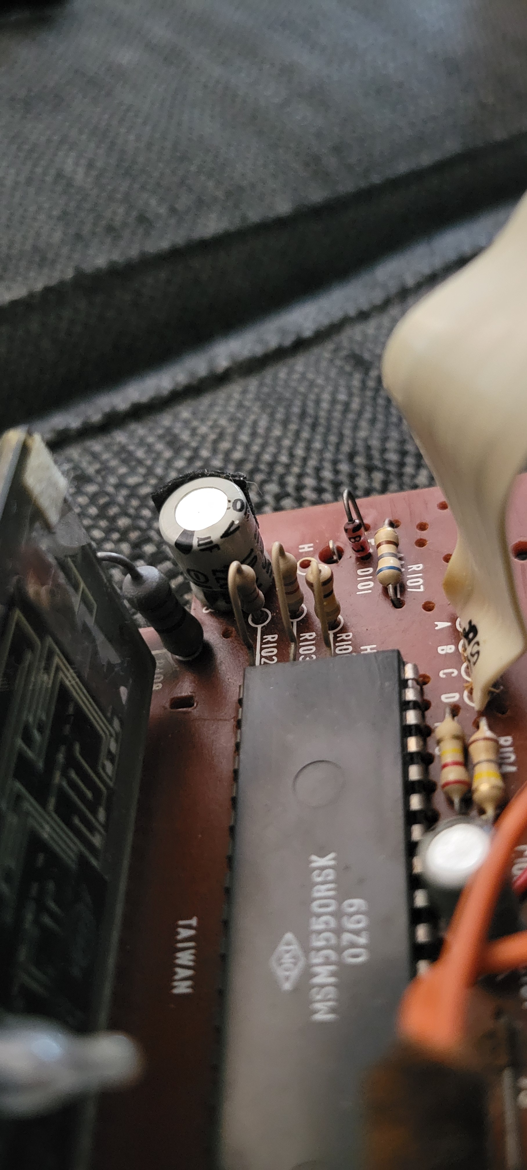

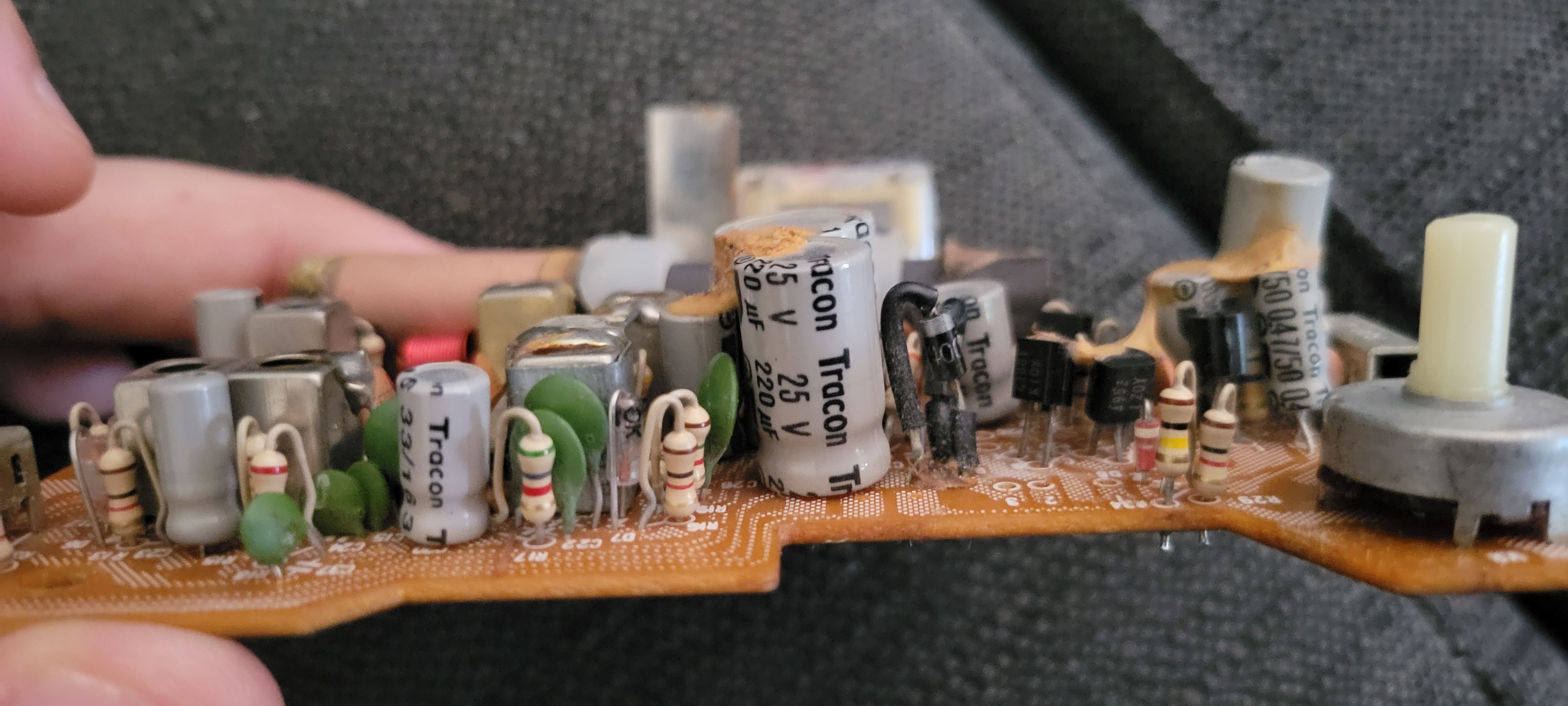

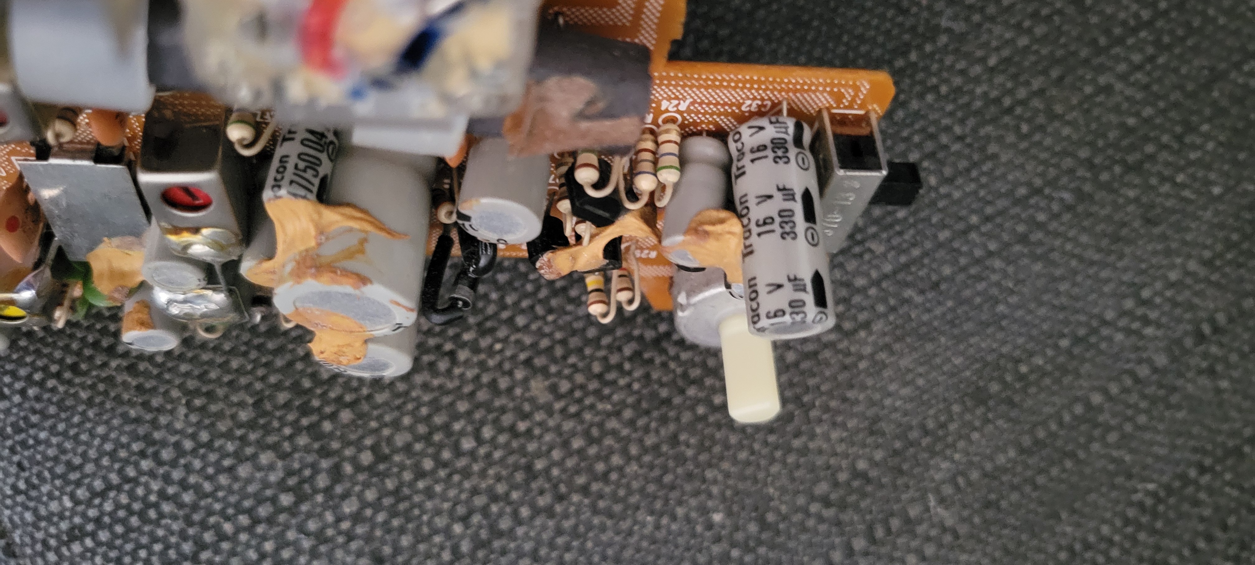

          Here are some images of the boards.

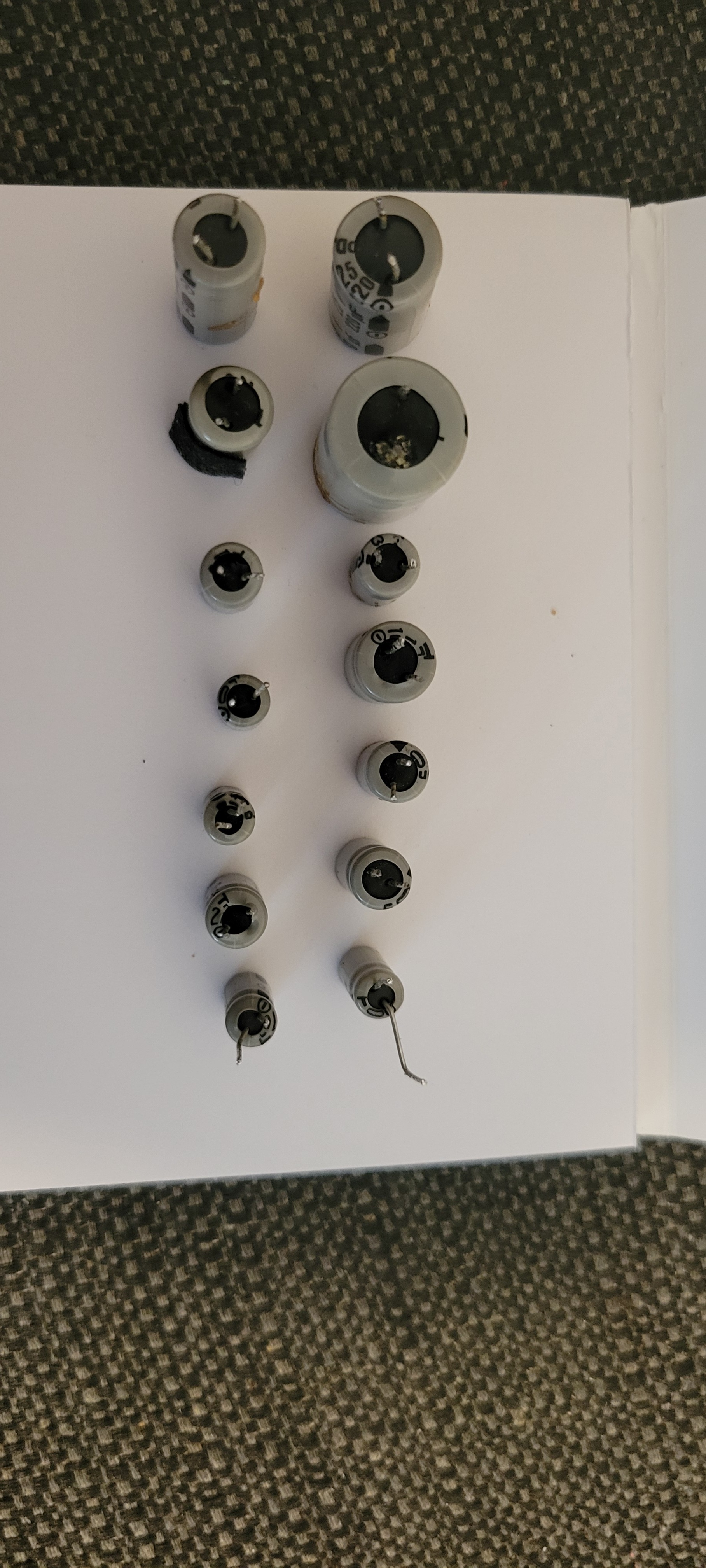

          I also removed these Tracon capacitors. They don't have any vent pattern on top, and the largest one (16V1000uF) may have bulged on the bottom and leaked (there is some white residue around its positive lead).

            are any of the caps bipolar (BP) ?
            it's common when you have a VFD display.
            • UserXP
              • Apr 2012
              • 344
              • Serbia
              No, I don't think so. All the capacitors I removed have the negative stripe marking, so they ought to be polar electrolytic caps.

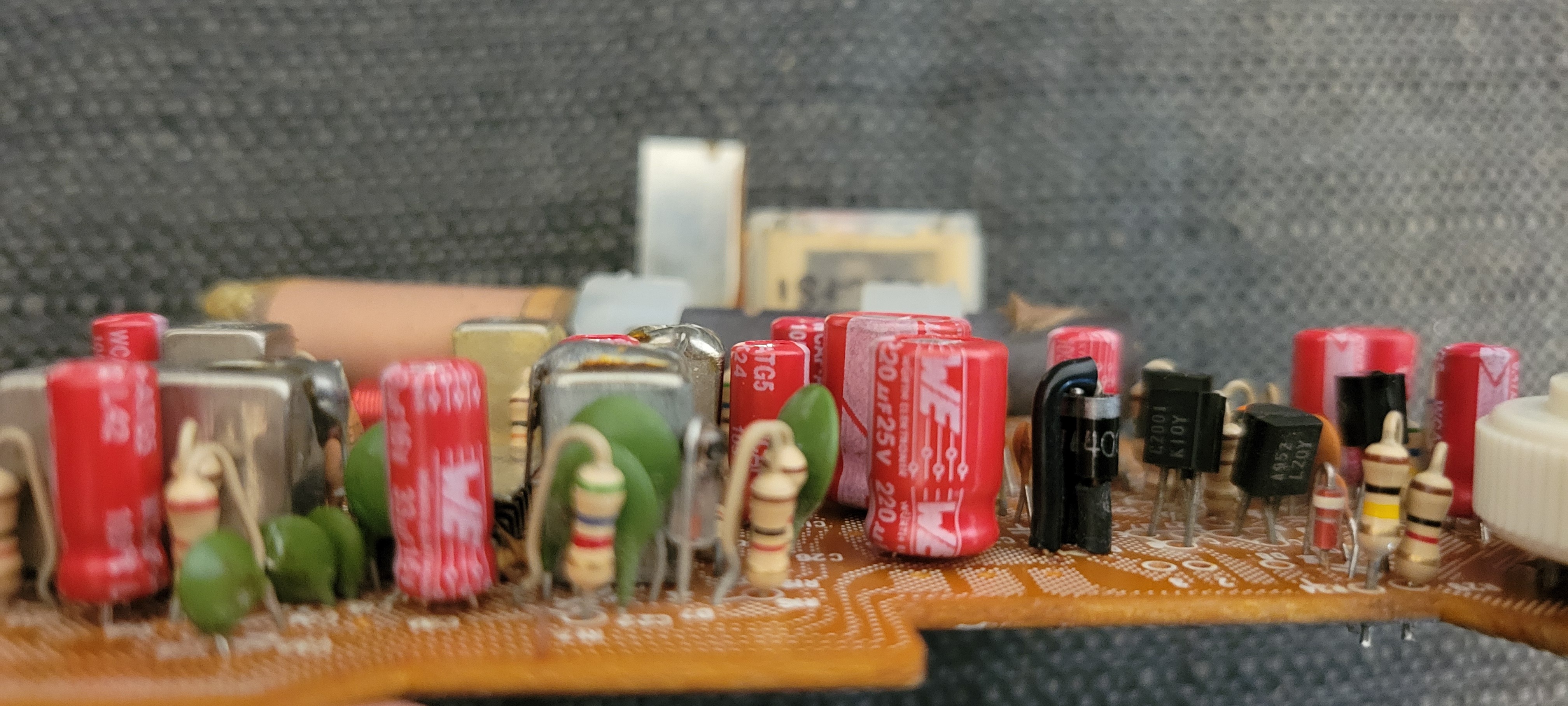

                  Well, I was pleasantly surprised today, as the replacement capacitors arrived. I am recapping the board now. Looking forward to seeing how it will turn out. Fingers crossed.
                  • UserXP
                    • Apr 2012
                    • 344
                    • Serbia
                    OK, people. The mystery deepens. I have replaced all the capacitors with brand new ones (WE, all are the same general purpose series, 2000 hours at 105°C) shown in the pictures. The only difference now is that the radio segment is no longer dead. The AM band has normal speaker loudness when increasing the volume knob, it just can't pick up any AM stations (as there aren't any). However, the FM band sort of works, I can tune a station and the sound is good - but very faint. I need to turn the volume knob to maximum just to be able to hear a station. So the volume knob works properly for AM, but not for FM band.
                    Also, the display still flickers and is faint.
                    I noticed with the working unit, when I unplug it from the wall, the display stays on for a second more before it fades and turns off. Also, if the radio was playing, the sound starts to fade and then disappears - all normal as the caps inside discharge.
                    On this problematic unit, the moment I unplug it from the wall, everything turns off immediatrely, as if there is a short or insufficient power. The caps are new, so they shouldn't cause this.
                    Any ideas on what to try next?
