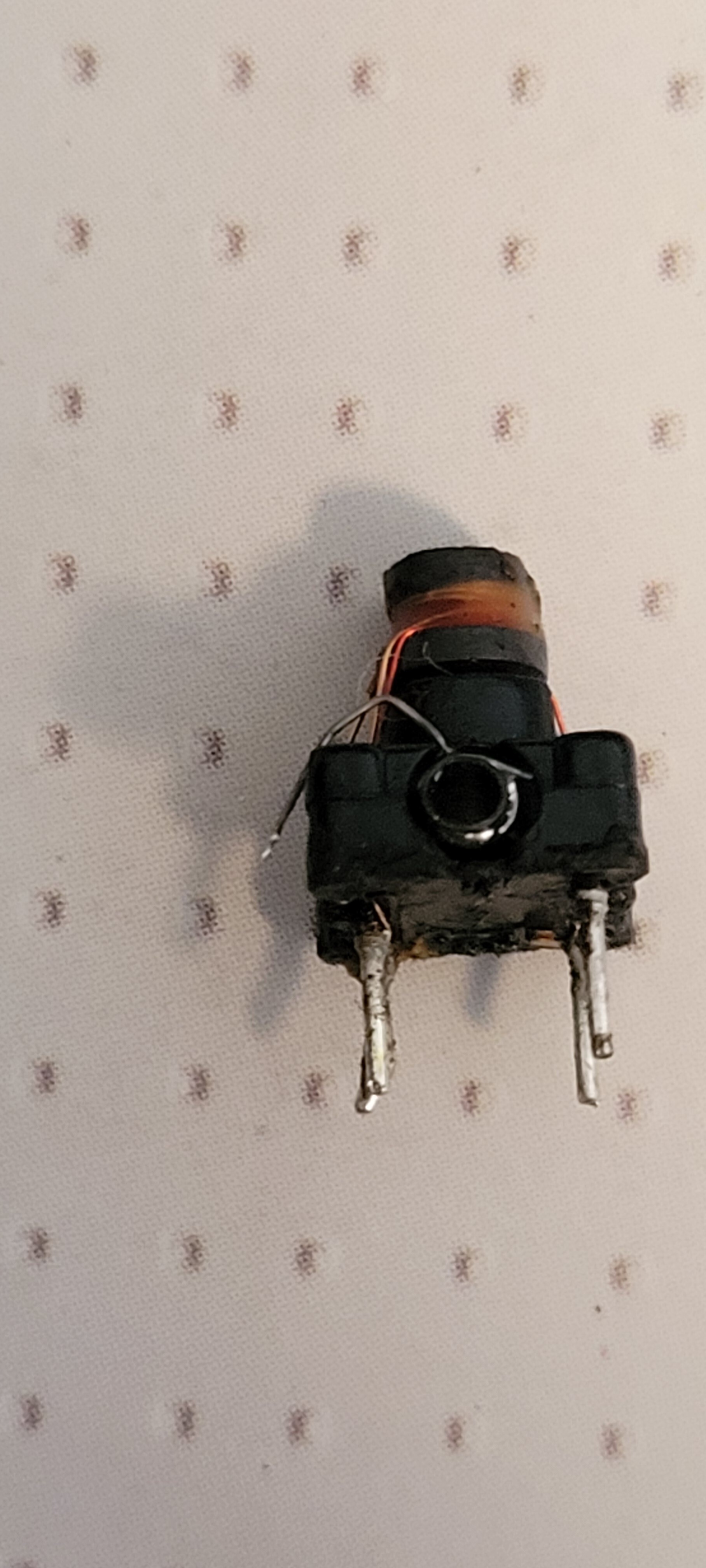

          Hello, guys. I have been quite busy for the past few weeks, so I didn't have much spare time to work on the radio. I did, however, manage to get in touch with the local radio club and they recommended visiting them as they have several members who deal with older pieces of electronics in the field of radio. But, I didn't have the time to do that as they are open only on two specific days per week after 7 pm, but I definitely intend to visit them as soon as possible.
          Now, and idea comes to my mind. If you remember, I replaced the original Tracon capacitors in this unit going with with the same ratings from the single same manufacturer (WE). I now have the idea, since I mended the damaged IF transformer and got promising results, that maybe I should go closer to the original caps. My other working unit has Rubycon CE W series (light blues sleeve) capacitors inside rated at 85°C. Do you know which modern Rubycon series is the closest equivalent of this exact series? I am thinking about ordering them if they are still produced in all the same ratings and go with the Japanese caps altogether. This will also provide me with proper spare caps for my other unit should I need to do any other replacements as well.
          Thanks as always for any info on this.

                Yes, that is true. In the service manual, all the capacitors have the same capacitance as the one printed on the caps -except for 16v33uF which is supposed to be 16v10uF. I first went with those ratings, but I will include a 16v10uF this time as per manual to see if it will make a difference. I've read that using caps with higher capacitance in radio/audio circuits can actually hinderv the frequency reception.

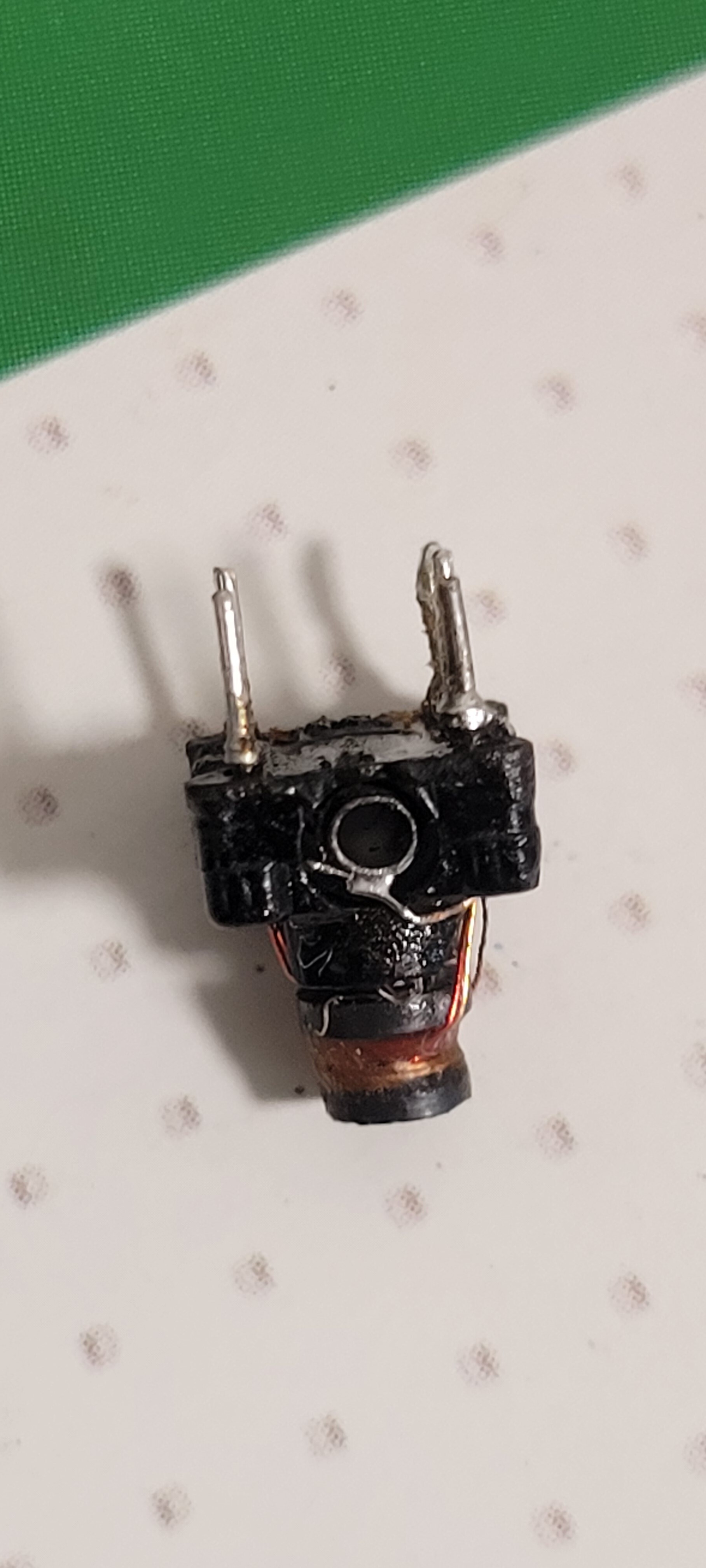

                Also, I have a question. When opening T4, I noticed that its internal cap looks like a coil actually, in the shape of a hollow tube. On each side the "wire" is simply straightened and goes to the lead where it's soldered. One of these ends was torn when the T4 suffered the damage in which it lost one of the pins and the ferrite coil contact.
                Now, i was thinking, by soldering an extension wire from that capacitor's end to the pin, it may have influenced the total capacitance of this internal capacitor. Would it be possible to measure the capacitance of this cap and possibly replace it by adding an external one soldered between the respective T4 pins?

                  Or, unwinding 3-4 turns of the cap's original wire just enough so it can reach the pin for being soldered onto (would this dramatically change that capacitor's performance)?
                  For the first suggestion, I would surely have to unsolder on end of the cap off the pin to attempt to measure its capacitance, if possible. Could then use an external cap?

                    Just the way they've connnected the wire to it, I'd say. I would leave it alone, if you damage it you don't know what the value is.
                    I think what you need to do is to get it aligned correctly now that you fixed the broken connection.
