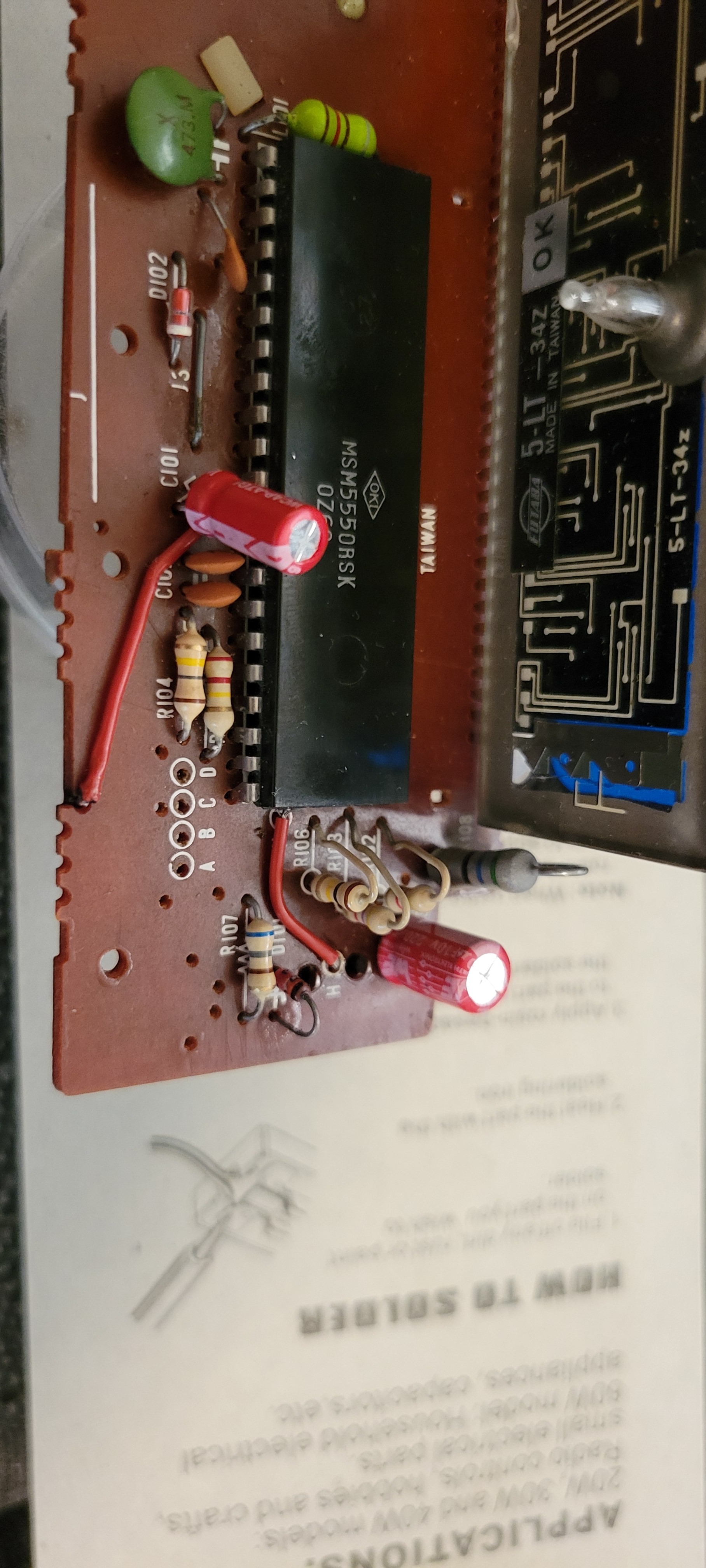

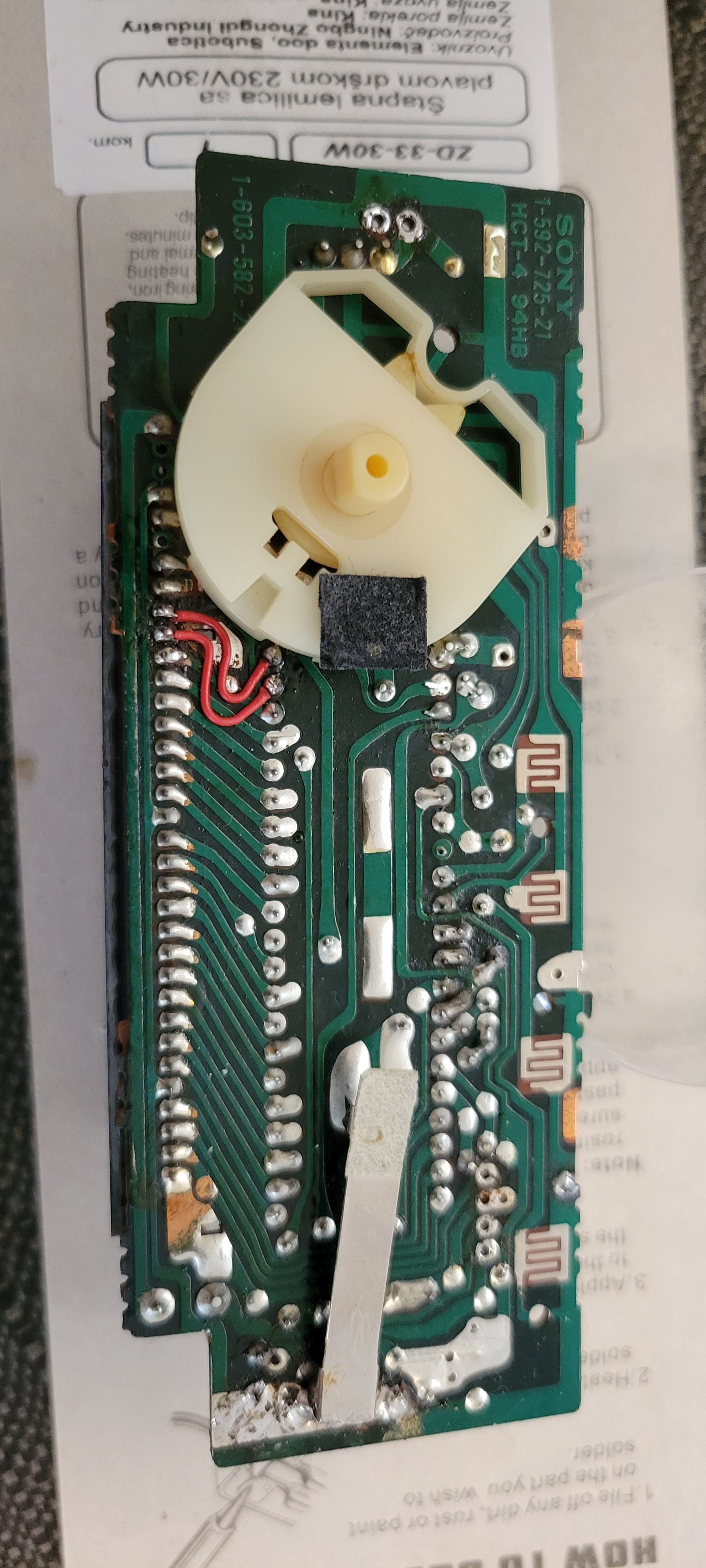

    In the meantime, I converted the display to 24h mode. Pins 41 and 42 power the AM and PM symbols on the display. So, I cut the traces near the solder pads where VFD pins for the two are, and used small jumper wires to connect pin 41 to the VFD pin for the lower segment of digit 1, and pin 42 for the rest of the segments which together with pin 40 form digit 2.
    i also connected the "H" joint for the chip, this should enable it to count the hours beyond 12 and up to 23 now. Hopefully, it will work.
    What do you think about this feat, does it look OK to you? 🙂
    Now, since the display board and its two quite rigid and tight cables are out of the way, is there a way to temporarily "jumstart" the radio without the function board? Do you think it's possible to feed Q7 a required voltage from the main board so it activates the radio? That way, if you suggest replacing or removing a component from the main board, its maneuvering should be a bit easier.

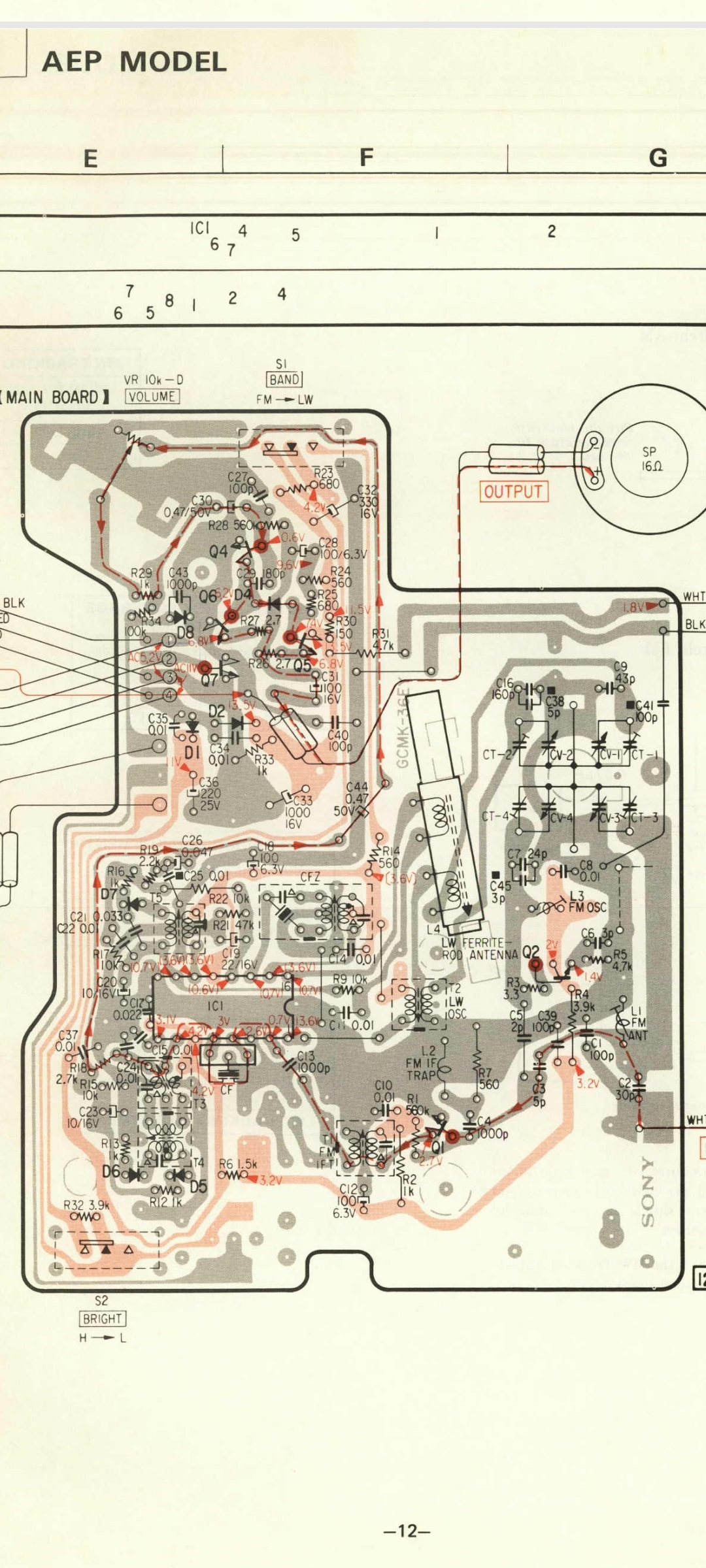

                        The only manual I have is for ICF-C12L. It is the same model by look, but inside the manual, the AEP version matches my radio the most when it comes to PCB layout. My radio is model ICF-C12W.
                        The image attached is for ICF-C12L AEP model, it has FM and LW setting, but the board layout is exactly like the one in my radio.

                            Yup, I saw the procedure in the manual and it is a multistep process of measuring voltages repeatedly in different tunning. That would be very complicated for me, so I really hope nobody touched those. Their tops look untouched and in similar positions like in the working unit's old photo, so I truly hope they are OK, especially since AM volume works fine.
                            Is the output sound coming out through IC01? Because, after that, it looks like it passes carrying sound from FM and AM equally through other components, through the volume knob, tranzistors and out through a capacitor. What can we try next?

                              #134
                              Not exactly, I believe the audio comes out of the FM detector circuit of T3, T4, D5, D6 etc.
                              Since you already checked voltage at IC1 Pin 7 and it looks probably okay, I don't know what else to say.
                              You could compare it with Pin 7 on the working unit, I suppose.
                              The schematic says 4.2v but you got 4.57v
                              I don't know if that's different enough to indicate a problem.
                              Unless there is some faulty part in the FM detector circuit, bad diode or capacitor maybe.
                              Measuring the diode drop on Q1 and Q2 won't tell you if it's degraded by ESD damage, generally.
                              The 0v reading (which would indicate a short circuit) across Base-Collector of Q2 is probably fine since you have R3 and L3 between those pins.
                              R3 is very low value of 3.3 Ohms, and the L3 will look like a short to DC as well.
                              -David VanHorn
