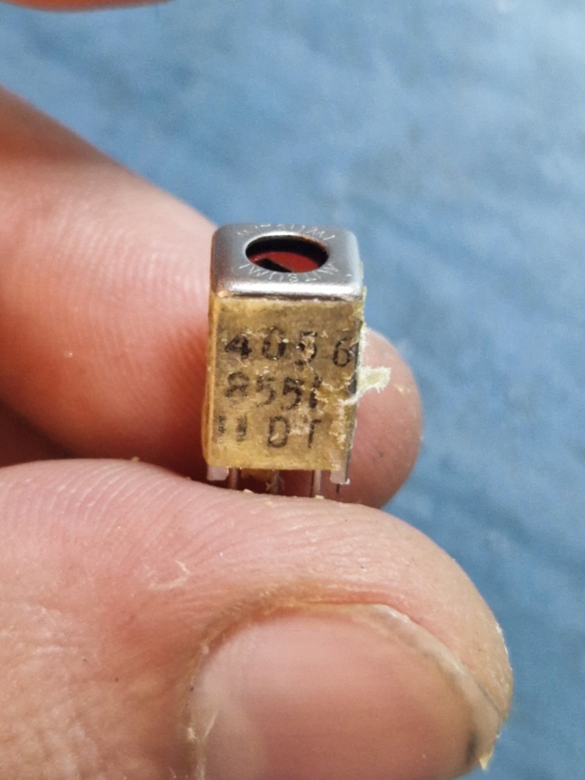

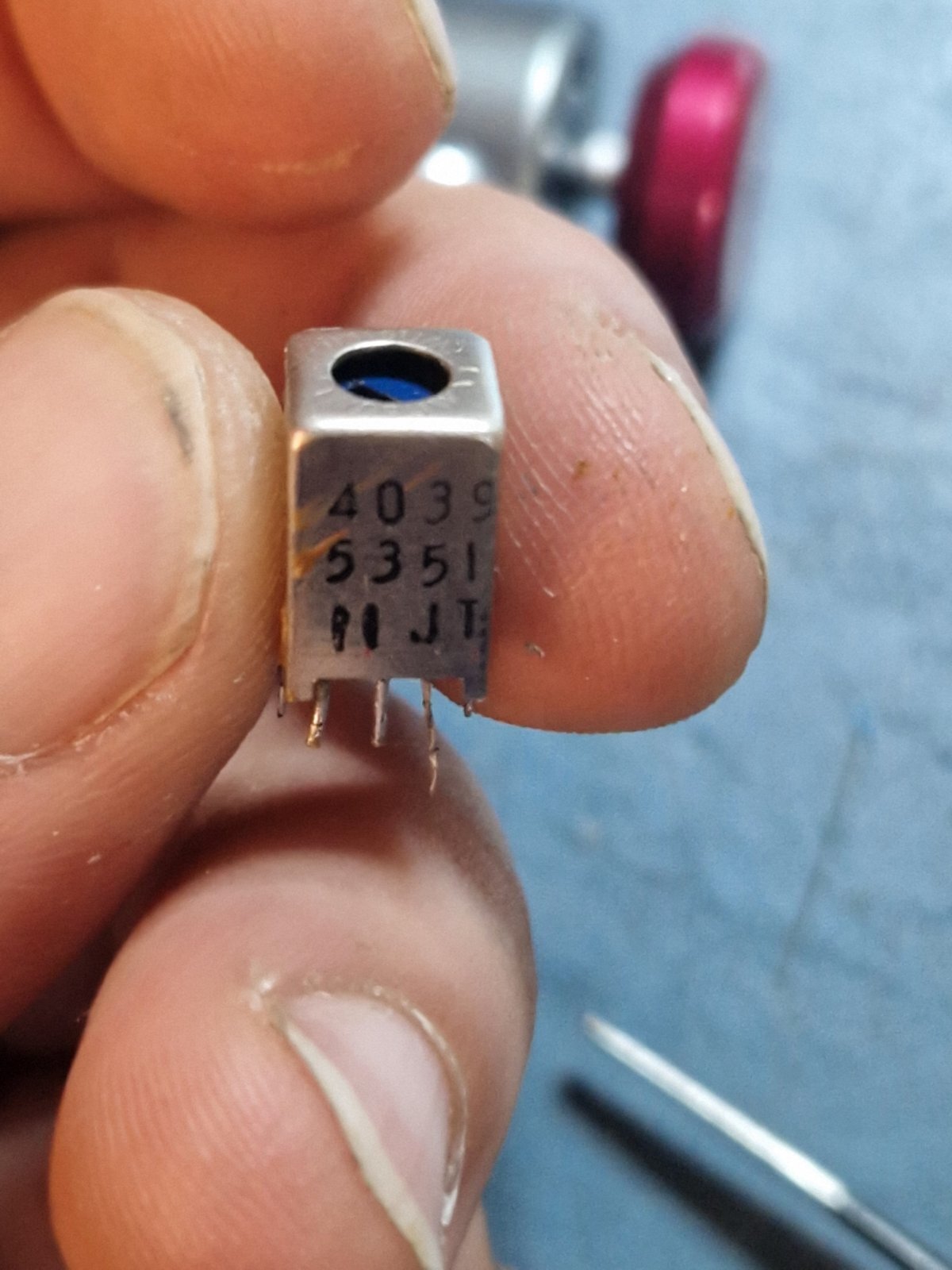

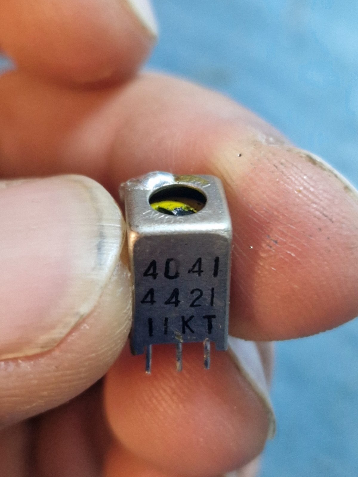

        I think I got the markings correctly and cross-referenced them with the codes in the service manual. Take a look and let me know if I got it right. Here are the full labels in the manual, the bold parts are numbers printed on the body of each respective transformer:
        T1: 1-405-685-00
        T3: 1-404-144-00
        T4: 1-403-953-00
        This still doesn't tell me their values and stuff, but maybe you will recognize the type of transformers and know an equivalent alternative.

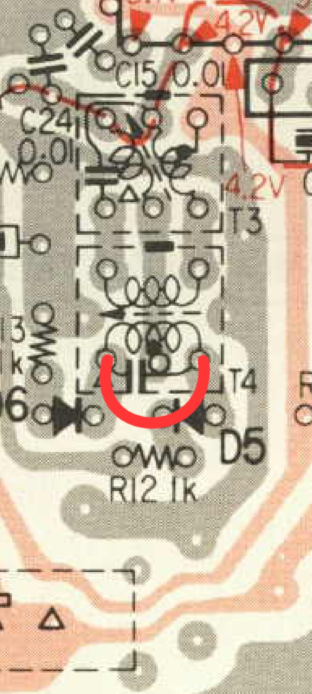

          Honestly I would start by verifying if the coils are actually bad or not.
          The ferrite cores should not fail unless exposed to very high temperatures, or are cracked, neither of which is likely to happen with the radio just sitting there.
          The schematic shows the internal layout of the coils.
          Since the pins aren't numbered in the schematic, you can work out which windings go to which pins by comparing the connections between each pin and the other components on the board. Will require a little circuit tracing but not too hard.
          Then you can verify the coils for continuity on each winding.
          If any are open circuit - check the windings where they connect to the pins - that's the most likely place they would probably break.
          If a break were not obvious to stop from outside, you could carefully take the can off the coil and see if you can spot a break in the wire to confirm.
          The internal capacitors do present an extra complication, they are not marked on the schematic as you say, but if you test for capacitance at the appropriate pins you should see something in the tens of pF, I believe.

              I checked the coil connection pads on T1, T3 and T4. All pass continuity check, but on T4, one coil passes, and the coil which is in parallel with the small internal cap doesn't show continuity, but I get a 25kohm reading berween its contacts (see the red line in the picture). I did this in-circuit, unpowered, but can this indicate anything substantial? Should I desolder T4 and attempt to open its can to inspect it inside? Do you think a fault in this area could weaken the signal strength/volume?

                T4 is the final coil with output into the detector circuit so yes, if you had a problem with that coil, I would say it could definitely cause a problem like you describe.
                And 25k ohm reading does sound too high to me. The winding could have a break somewhere.
                What reading do you get between that winding's center tap and the other pins? Is one side different to the other?
                Or are they both 25k?

                    OK, guys, here is the thing. As suggested by Agent24, I checked the center tap on T4, and here are the results:
                    The "lower" coil, which has a center tap, reads continuity between the center tap and the right one. But, between the center tap and the left pin, I get no continuity, only resistance. It dances between 17 and 50KΩ for a second or two and then settles at ~27KΩ. But when measured across the left and right pin, it settles at 24-25kΩ. It seems that something between the left pin and the center tap is bad, plus it now rules out the little capacitor as it is not even connected to the center tap.
                    Just for the sake of comparison, I then did the same check on T3 since it also has a center tap, just to see how it would behave - and all its coils read continuity with no problem between all respective pins, including between the center tap.
                    Does this measurement further indicate that T4 may have a damaged coil inside it?

                      yes. It’s a centre tap transformer with an open winding = broken winding or broken connection to a leg somewhere, since you read high resistance.

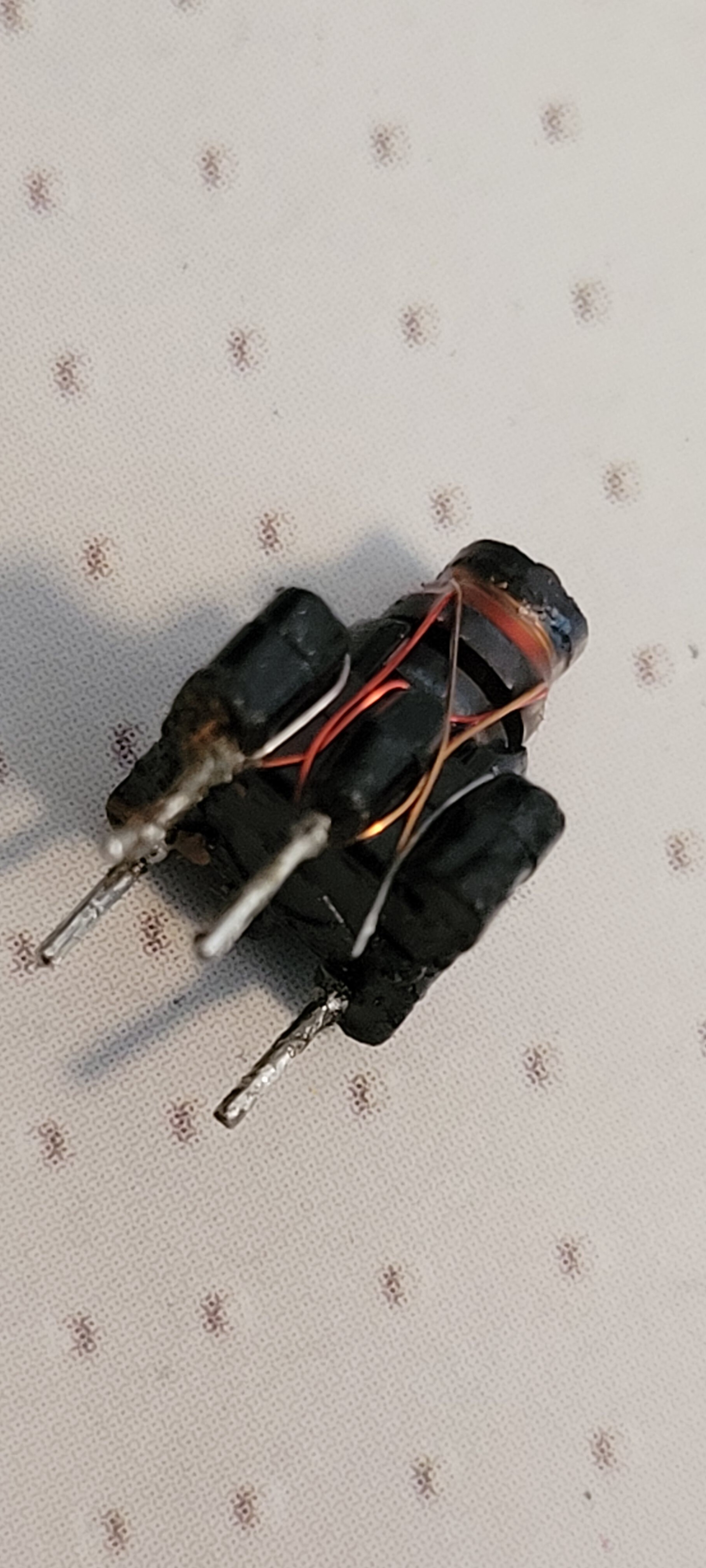

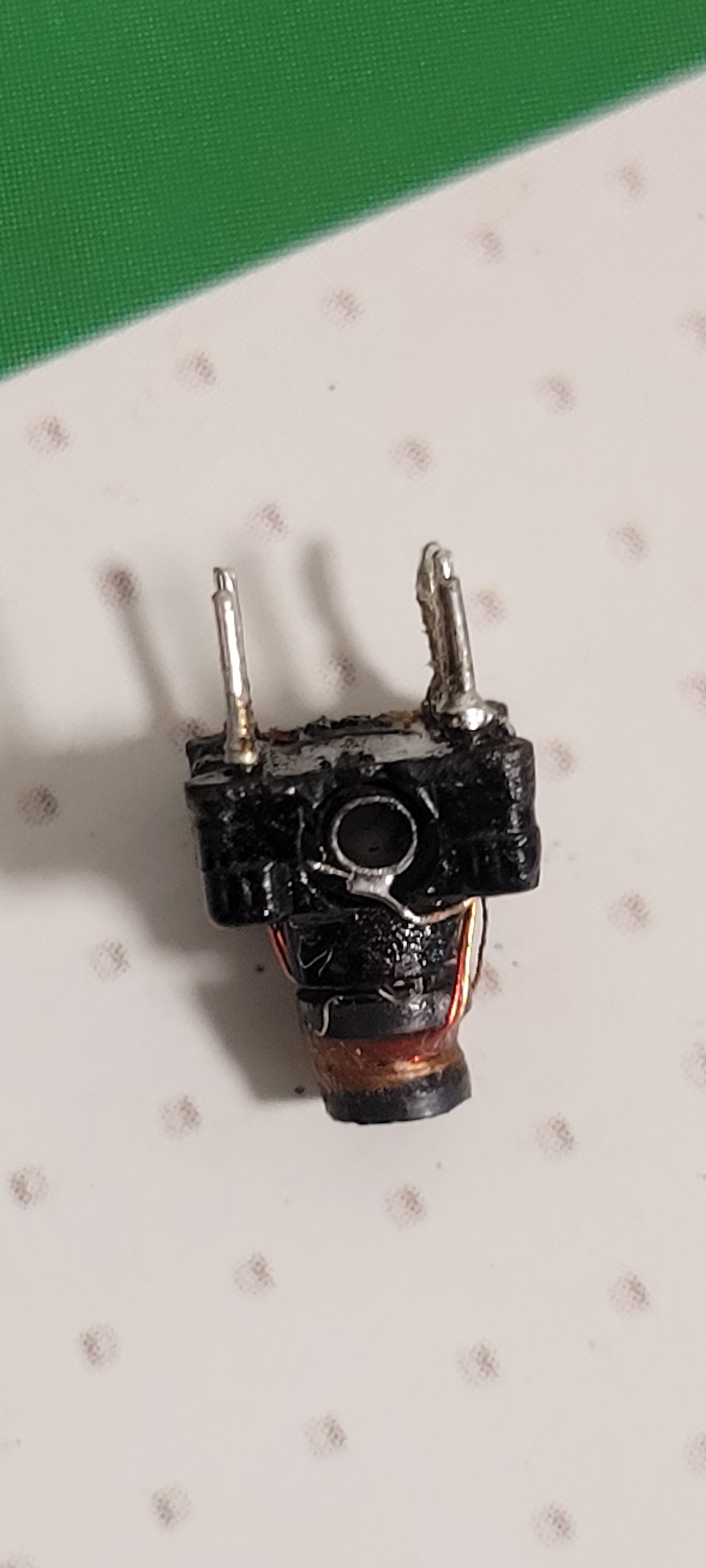

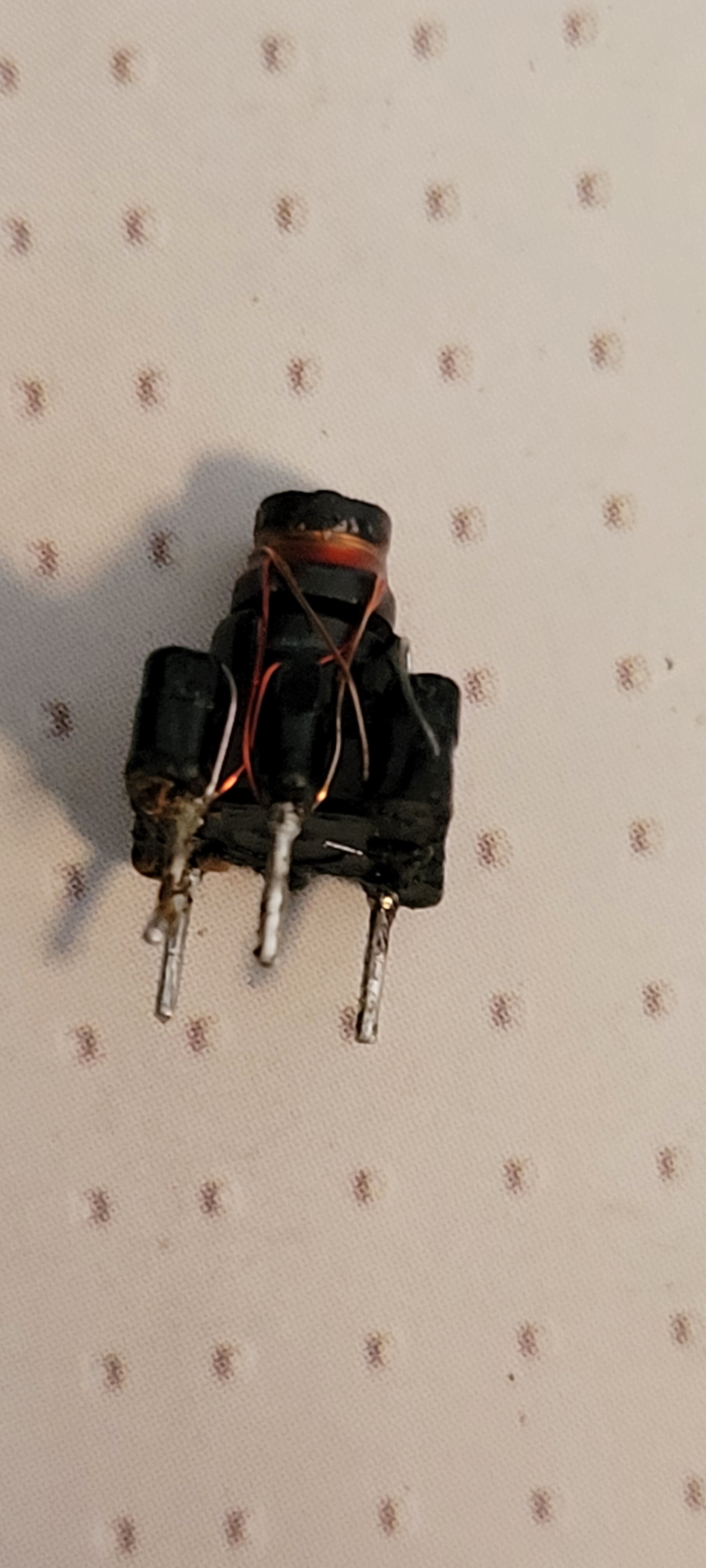

                        I desoldered and opened the can. Two wires are detached and the pin itself is completely missing, as if it wasn't in there to begin with as there are no flux, solder nor heat traces around its hole.
                        So, only one wire goes to the coil, the other one is just a bridge to the capacitor. I cut a fresh lead and it inserted into the hole firmly, which means the hole isn't cracked or something. I now just need to figure out how to extend the otherwise very thin and short wire to the pin and then to the capacitor end.

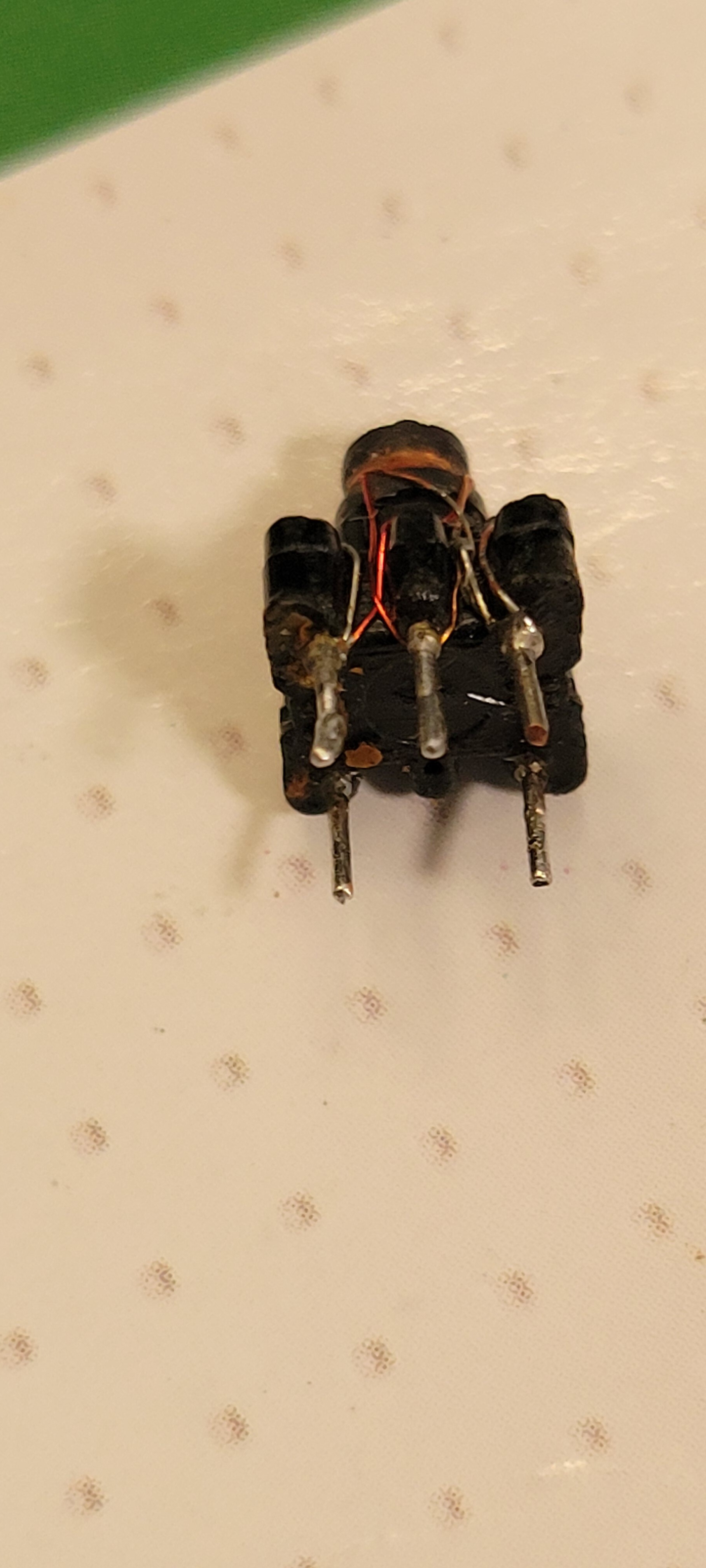

                          I have managed to mend the missing pin by using the same thickness lead of a resistor. I then used a string of copper wire for bridging the missing piece. I made very tigh latching hooks on the end of each wire and hooked them together tightly, then soldered. I then soldered the extended wire around the new pin and back up to the capacitor's end. It took me almost two hours to thread this and solder it, the think wires were a pain to deal with.
                          Now it reads continuity between all the pins, so that's a good sign for now.
                          I have no idea what the "cap" part inside is, it looks like a hollow spring coil and the multimeter can't even register it. I thought it was some kind of "snap-in" cylindrical capacitor, but it looks like a hollow tube made of wound up wire. I have barelly managed to solder the thin ends as they are of hair-like thickness.
                          i commend Mitsumi on making such a small and delicate component. No wonder it can easily get damaged. Take a look at the photos and please let me know if I should check anything else specifically before assemblying the can back on.

                            nice work, make sure you insulate it with some nail varnish or something befor you put the can back.
                            i suspect the "engineer" ripped that pin out while removing it before!

                                I managed to assemble the T4 and solder it in. It does influence the volume, I can tune it to a very narrow specific position when the FM volume is the highest. It is not as high as it is supposed to be - but seeing that turnig T4 influences the volume tells me all its pins are now in contact. Still, I am doing this while the radio is tuned to a station. The service guy obvously tried to set all the trimmers as they were all in different positions compared to the image I took before bringing the radio to him. So I am setting them randomly, stopping when volume/reception is best but likely not accurate.
