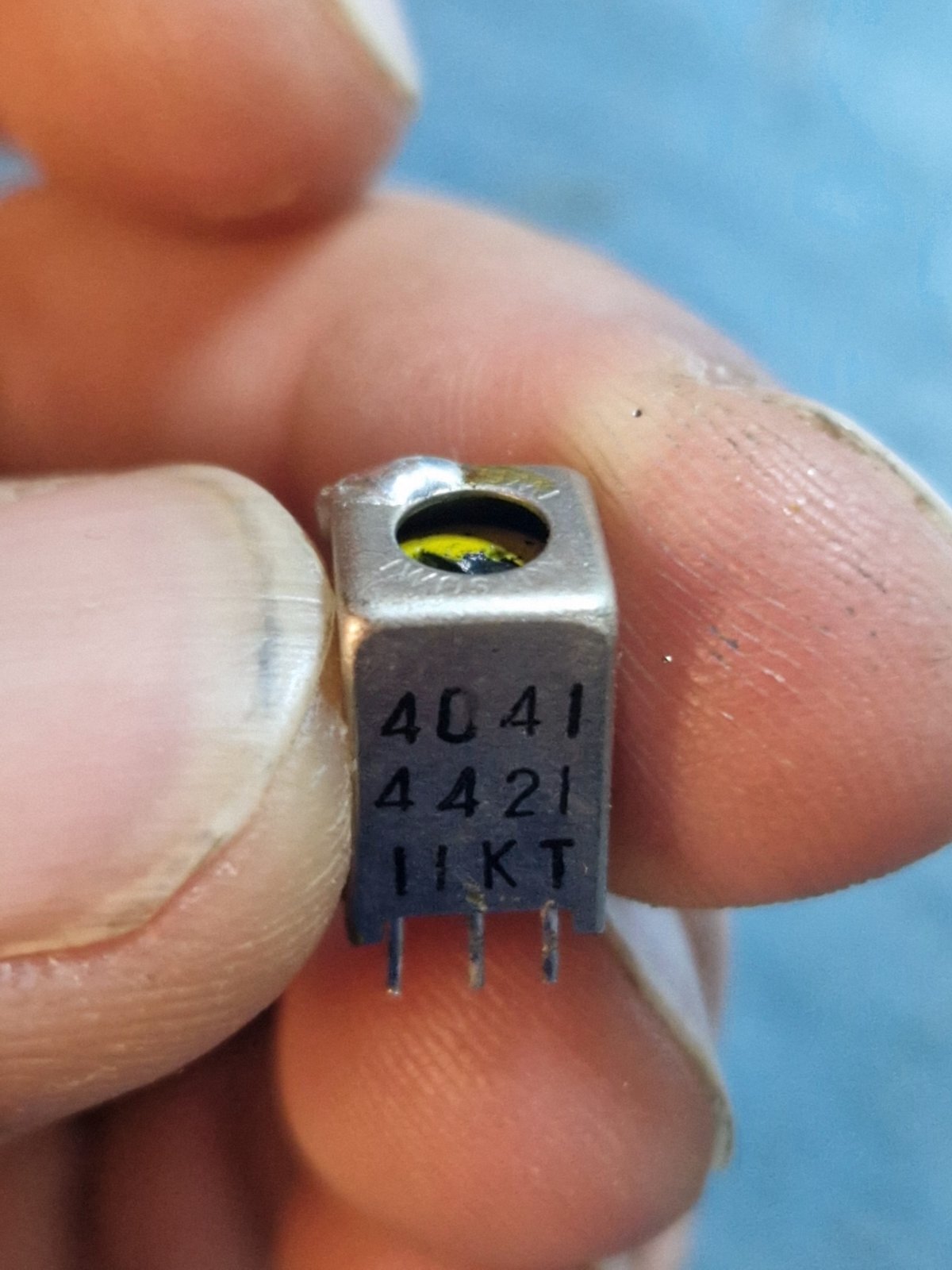

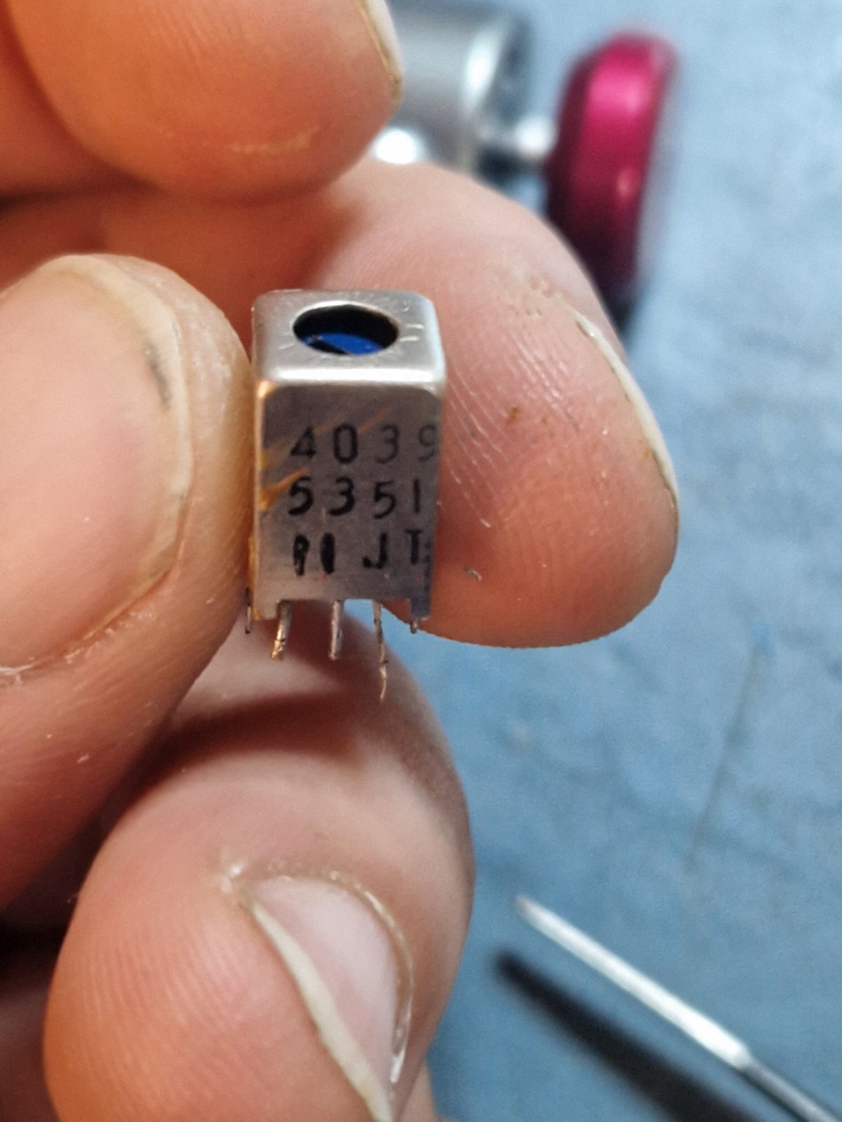

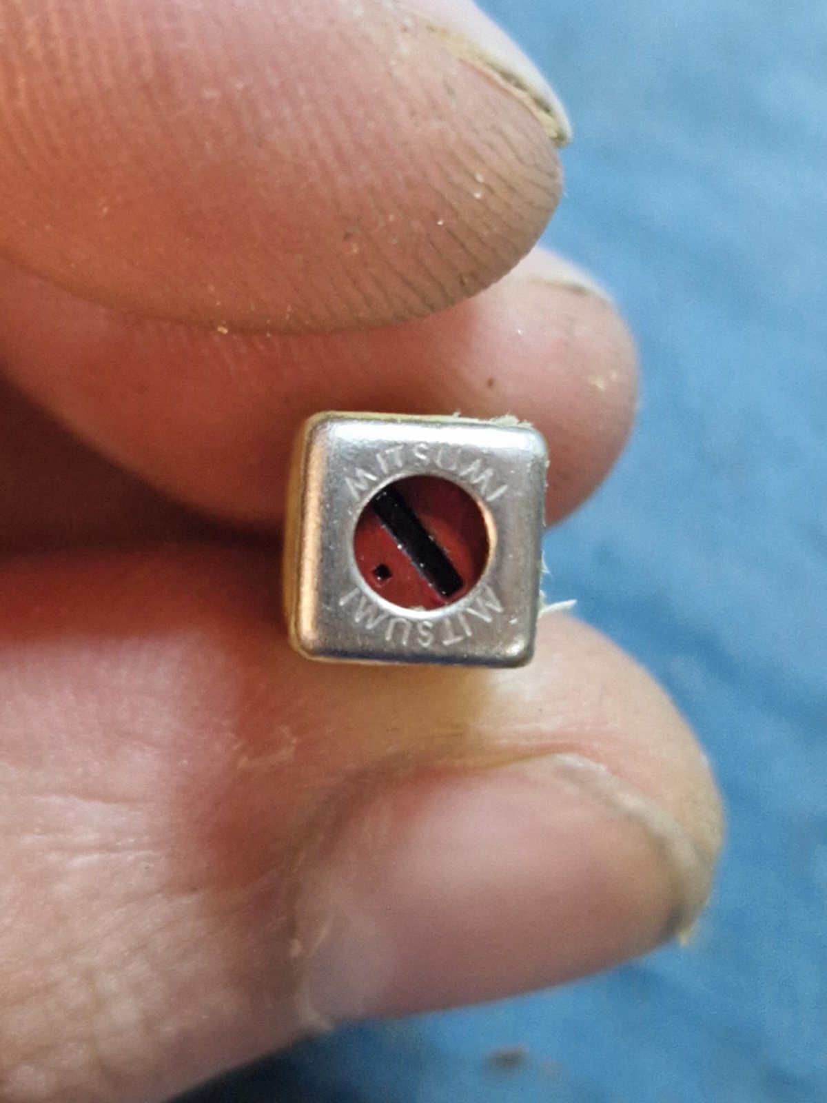

                    Hi, all.
                    Sorry for the long delay, but there were some things that needed to be done. In the meantime, the service guy has found the fault with the radio, but claims he cannot find spares due to age (which I believe is so), nor does he have a donor device with the same parts to take from, again, due to the age of the electronics at hand.
                    However, he removed these three suspected components and sent me the images. These are, I believe, the FM transformers and something you had also suspected to be at fault.
                    Could you take a look at the images and help me find equivalent replacements? Does the colour of the trimmer denote a specific value? There are some numbers on the side, but they may be proprietary. On some of them it says "Mitsumi". I found some yellow parts identical to the one in the images, so does it mean they would, for example, work as a replacement for the yellow one? Does the colour actually denote the same value for all brands?
                    Please advise and thanks.

                      Which ones are these or what did he take out? T1, T3 and T4 that I was talking about earlier? T1 is the IF transformer and T3 & 4 is the FM discriminator. Now which one is it? Can’t be all 3 of them, because the you could hear stations on FM.
                      Makes me ask if he does know this thing works? Again, if he has all the gear, he can pinpoint the exact faulty transformer.
                      Just waiting for stj to flip on that tech. lol.

                          Yes, those three. The fault seems to be at T3 and T4. I saw the video he showed me, wiggling or pressing their pots/leads impacts the volume to increase as a certain angle is hit while wiggling or pressing. Maybe something got detached inside them, I don't know what the device had suffered at previous owner's.
                          T1 is the darkish red looking one, close to Q1
                          T3 is the yellow one
                          T4 is the blue one (these two are next to each other and close to IC01).

                            Maybe you can get new ones like these
                            https://www.aliexpress.com/item/1005004483837060.html
                            I guess the wire could have broken inside due to old age/corrosion? It's very thin.

                              Yes, these things wires inside can break off. Some folks take them apart and fix em too. As for unobtainable replacements: I do have those problems too. What I end up doing is going through other radio gear roughly the same age. One time I needed a slug for an old 1975 radio. The one I had broke off inside. Anyway, I did find the exact same thing I needed in a Motorola Mitrec VHF receiver. Lesson one, is to find THE culprit, don’t change a whole whack, because of lack of parts. Lesson two is: There are parts around in different radios, just hard to find. Usually these parts should be roughly at the same place if you look at the schematic. Tricky part is to find a radio that has that exact part. Either you find a parts radio or start skimming through schematics.

                                We shall try and find equivalents. I guess it would be wise to have these in spare as one can never tell if, or when, any in the other unit may fail. I remember we had a few old FM radios which, if only we had know better, ended up being collected for recycling. They may have had these parts inside, but now it's all gone. I also wouldn't use a perfectly working unit as a donor device just so its part might fix this glitchy Sony radio.
                                The AliExpress link Agent24 sent seems to have various value transformers, and I shall have som assistance with which are the exact equivalents to the Sony ones. The number of pins also seems to be different. 😮‍💨

                                  There may be other sellers with different types, I also saw some which appeared to be kits so you could wind your own.
                                  Though at that point, it probably makes more sense to re-wind the originals. At least then you would know the turn counts.
                                  I think the schematic may show these, however, and also the value of the capacitor inside, in case those have failed too.

                                    Yeah... I've watched a video on that. But that sounds like a shot in the dark for me. I wouldn't know how to disassemble one, let alone repair it. And, the service manual only shows symbols for what's inside those small transformers (coil and capacitor symbols), but they are all marked only as "internal components" with no value whatsoever.
                                    So, my option is to buy the most similar ones and try with them.
                                    So, let's see, T1 is a 455Khz FM trap?
                                    T3 and T4 are likely 10.7Mhz IF, as they follow the ceramic filter at 10.7Mhz?
