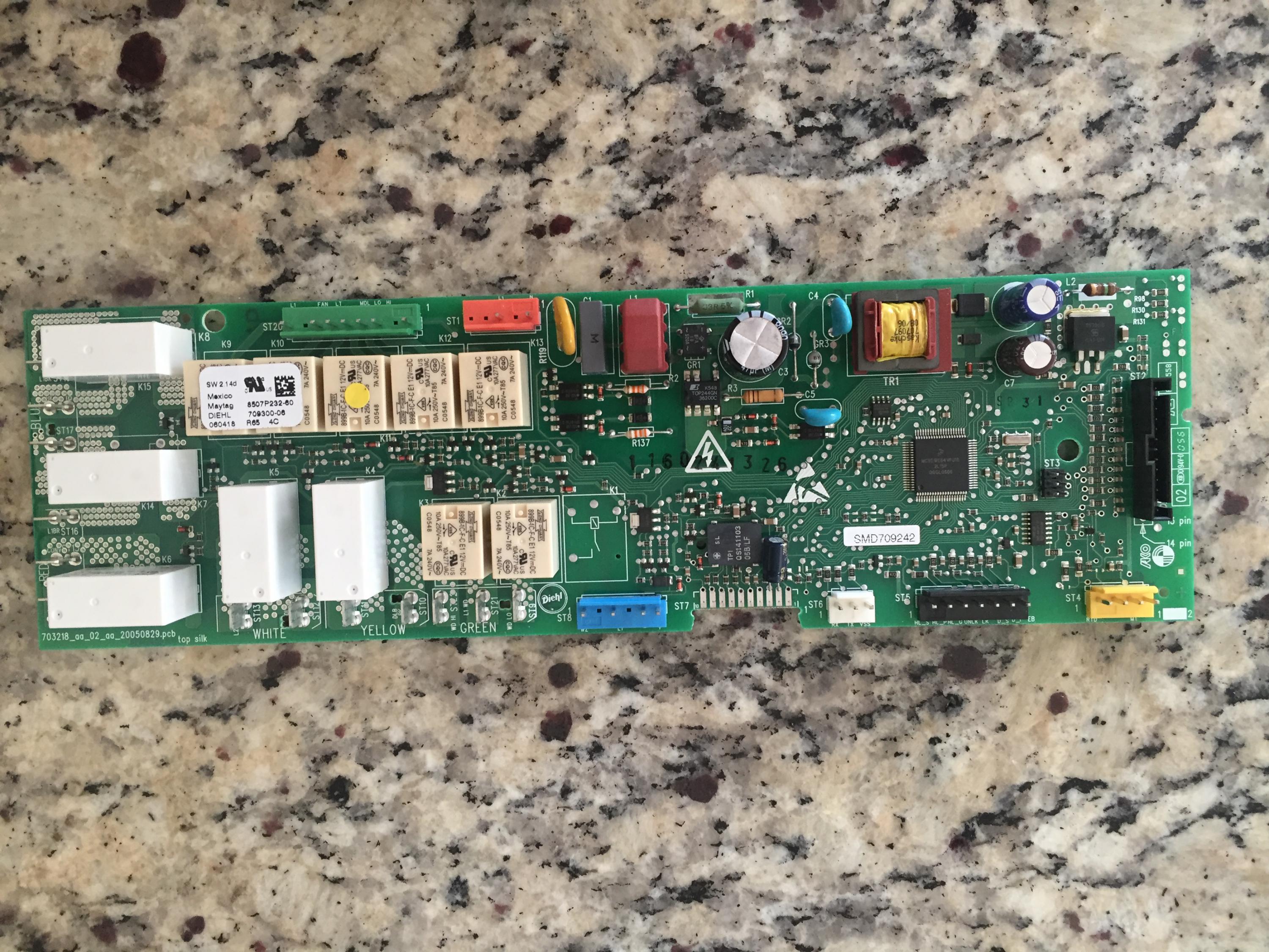

Dim Clock LCD on Jenn-Air wall oven
  • pbrabner
    • Dec 2014
    • 6
    #161
    Re: Dim Clock LCD on Jenn-Air wall oven
    Here is a photo of my display board. Model# JJW9530DDS. Which caps do I replace?
      All.
        I got the all part. What did the other comment mean?
          both of these. if not the display itself could be bad.

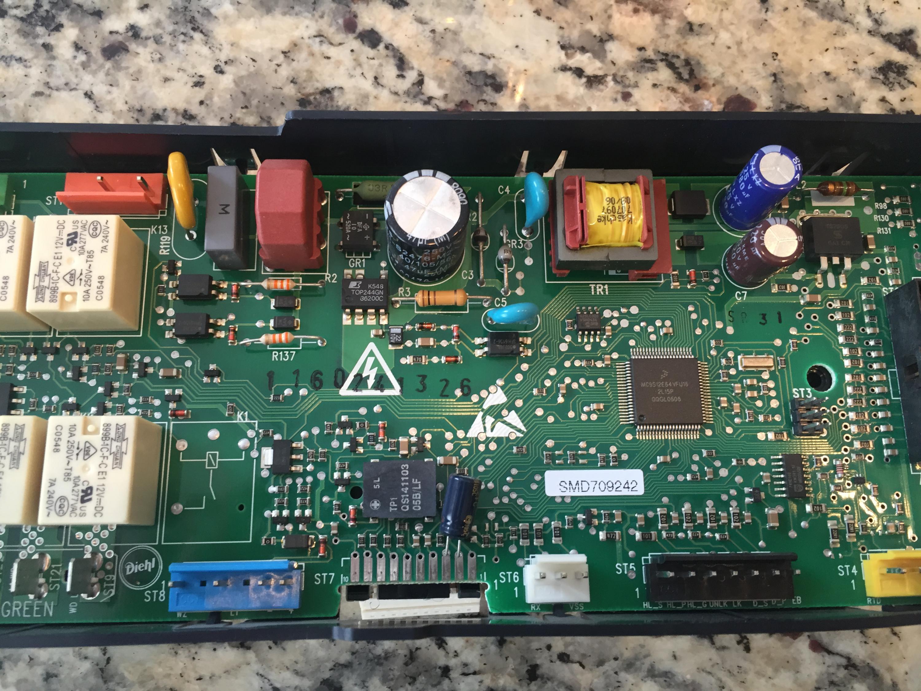

                            I ordered the parts for all the boards and now have the stove display is back. Two bad caps on the one board and resistors were used on two of the c3 slots for the other boards. I was surprised to see this but at least I will have a spare when the present board fails again.
                                      Check the capacitor on pins 2 and 3 of ST7.
                                        If the board is anywhere near heat, just replace all the caps. If they arent cooked yet, they will be soon. Caps are cheap.
                                        I did this for my oven this year. Oven was only a few years old too.
