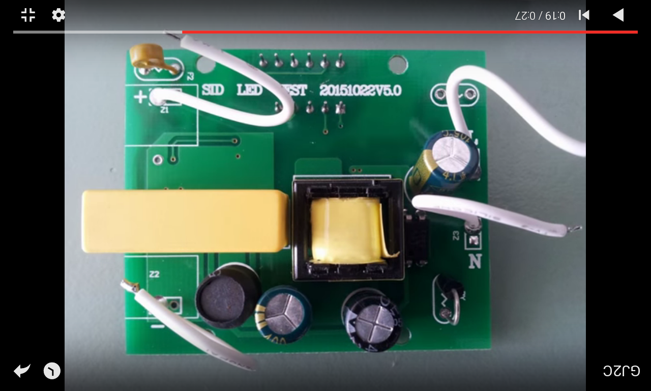

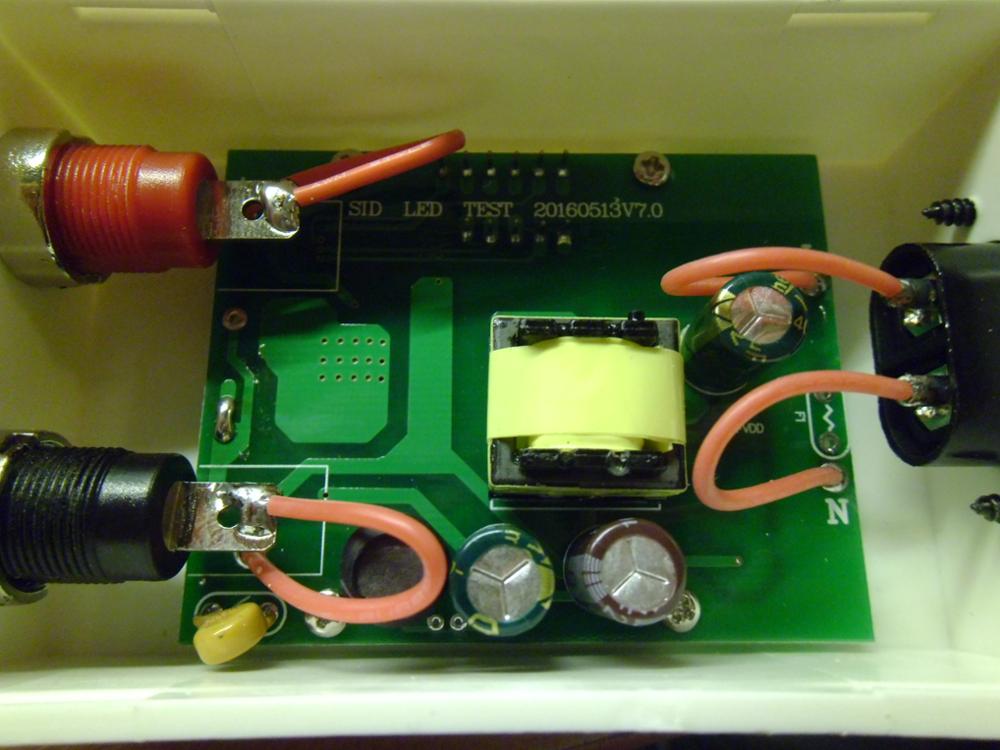

    Re: attempt to clone LED TV Backlight Tester
    Inside the Tester,Looks like this.
    Similar to this circuit.
      Can we see the straight shot of the bottom side of the board?
        I did not have this Tester.
        He has it
        cliff_hootarski : Got one and does exactly what it's supposed to do. Can test whole string or each LED individually. Just another tool in the arsenal.
        LED Tester - How to Test LED Backlighting - SID GJ2C LED TV Backlight Tester
        https://www.youtube.com/watch?v=4DS8_utsLPo
        Check at 3:23, the tester shows 293V DC when it touchs one led it drops down to 2.0v then goes up.
        Basically is a 300v 2.5ma current source, if more than 4ma the Tester shuts down and does soft start until it reaches 2.5ma

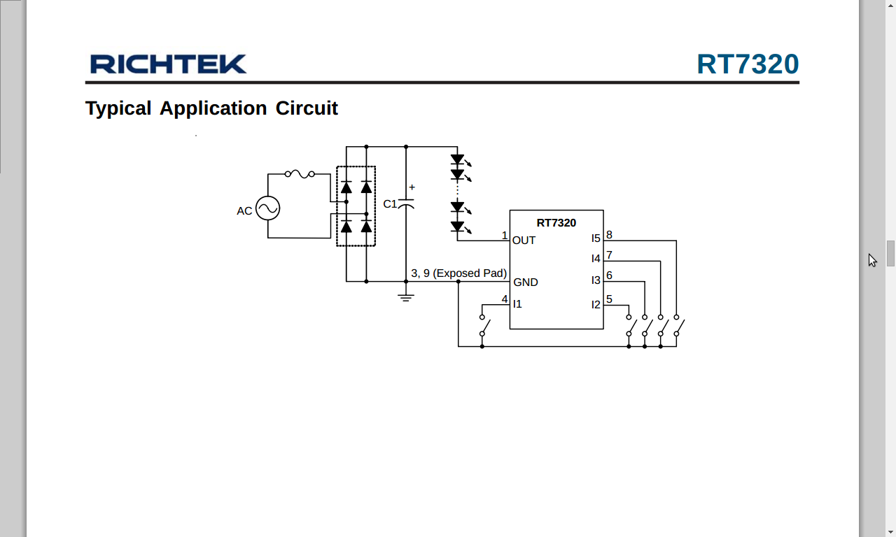

                            After a quick research in google i found the richtek RT7320, maybe with one of these and a boost converter is all you need.
                            • capwizard
                              • Jun 2016
                              • 1991

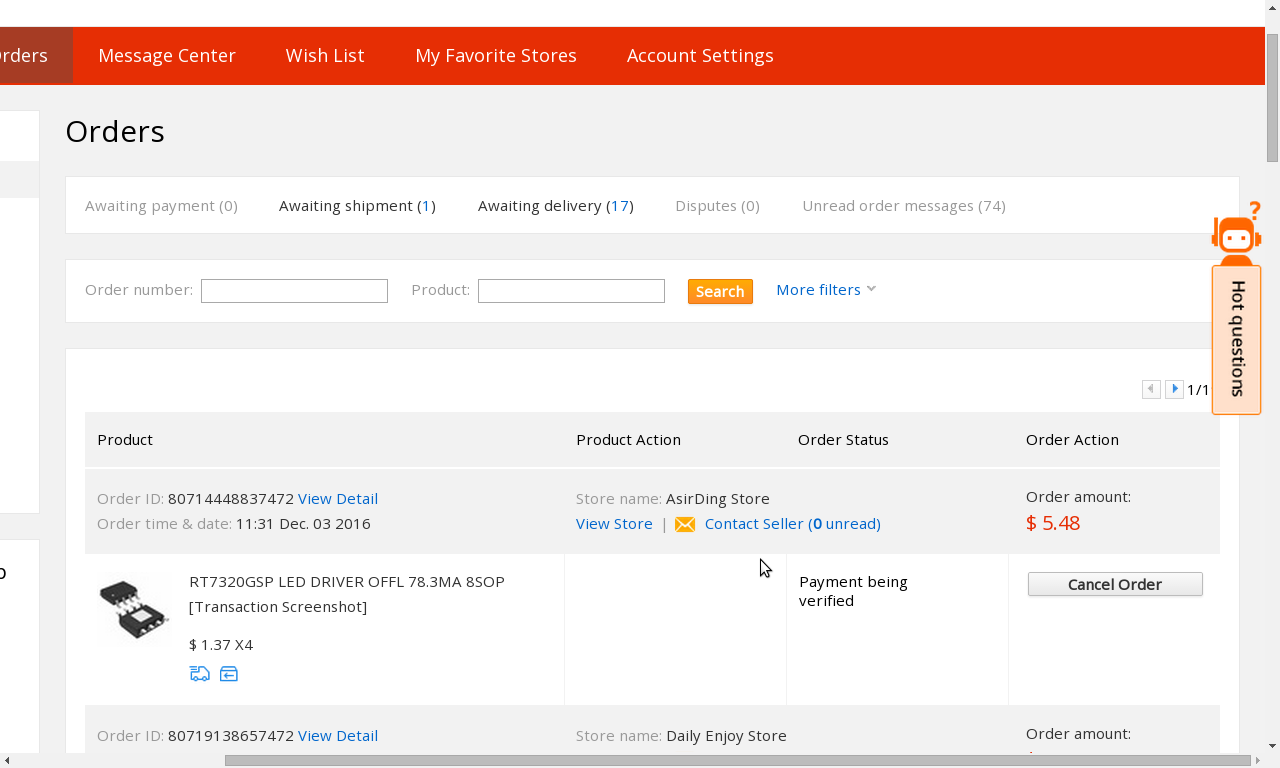

                              Muchas gracias compa.
                              richtek RT7320. Perfecto,exactamente lo que necesito.
                              I love the built in 2.8ma, 5.5ma, 10ma, 20ma, 40ma current switch. I will order from: http://www.digikey.com/product-detai...0-1-ND/4733241. I will post the result. Thanks aqain.
                              Programmable Regulated Current : 2.8mA to 78.3mA.
                              AC Input Voltage : 90 to 130VRMS or 200 to 240VRMS
                              Cant wait,so Ive ordered from Aliexpress. You make my day.

                                    Using RT7320 for testing LEDs (depends on how many LEDs there in the string) you will still need variable Voltage power supply otherwise it will exceed the power dissipation of the IC.
                                    The IC is just a higher Voltage low side (current sink) with built-in resistors for selectable constant current,
                                    Basic OPAMP+ MOSFET constant current power supply:
                                    https://cdn.badcaps-static.com/pdfs/...25bd060cc5.pdf
                                    http://www.daycounter.com/Circuits/C...nt-Servo.phtml
                                    https://cdn.badcaps-static.com/pdfs/...43730e4b17.pdf
