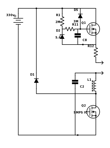

                        I have traced some of the circuitry, it makes better sense now.
                        With the test leads open, the Source of Q1 rises to the point where the G-S drops to threshold voltage of about 2.5v. Q1's channel resistance will be very high.
                        When the leads are connected to a load, very little current first flows through Q1, the current increases as C8 charges. Q1 eventually ends up with about 3v drop across it.
                        The current limiting is done by an unidentified SMPS IC that I have represented by Q2.
