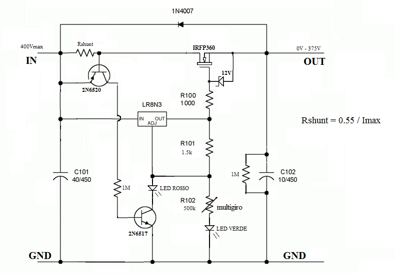

                Nice,it could supply up to 60V DC. But To test edge led tv strips ( 4 of them for 60" ) each needs 186v dc, then you will need that plus 10x 9v battery to test.

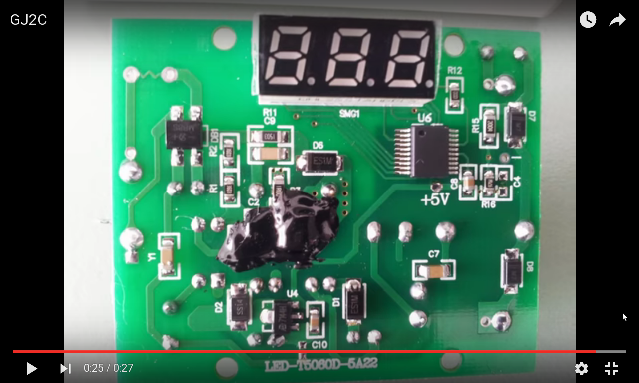

                              I did some tests on a GJ2C loaded with resistors from 470 ohms to 10K. The open circuit voltage is about 330v. When I connect a resistor, there is a brief spike of about 5ma then it settles briefly to 1ma then it ramps exponentially for 2 to 3 seconds to about 30ma.
                              The built in voltage meter is accurate.

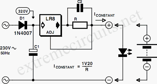

                                330v dc / 1.414= 233.38v AC. So SID GJ2C use a 1 : 1 isolation transformer but over 110v AC region they use 1 : 2 isolation transformer or ac doubler. SID GJ2C testing voltage is DC 330v / 3v LED = It can test 110 LEDs
                                " ......to about 30ma. " Current is too high for LEDs long time testing. 110 LEDs x 30ma = 3.300ma = 3.3A
                                "..........then it ramps exponentially for 2 to 3 seconds" In pic1 We can change C2 to 10uf - 100uf capacitor, give the circuit 2 - 3 seconds to charge to 1.2v for it to reach the current limited. ( I constant = 1.2v / R).

                                  The interesting areas of the PCB are covered with a very tough black epoxy. There appears to be a MOSFET in series with the output that does the fast current control. There is a large drum inductor which must be part of a Buck regulator on the isolated side also.
                                  The current ramps up in steps so must be controlled by the same micro-controller that does the voltage meter function.

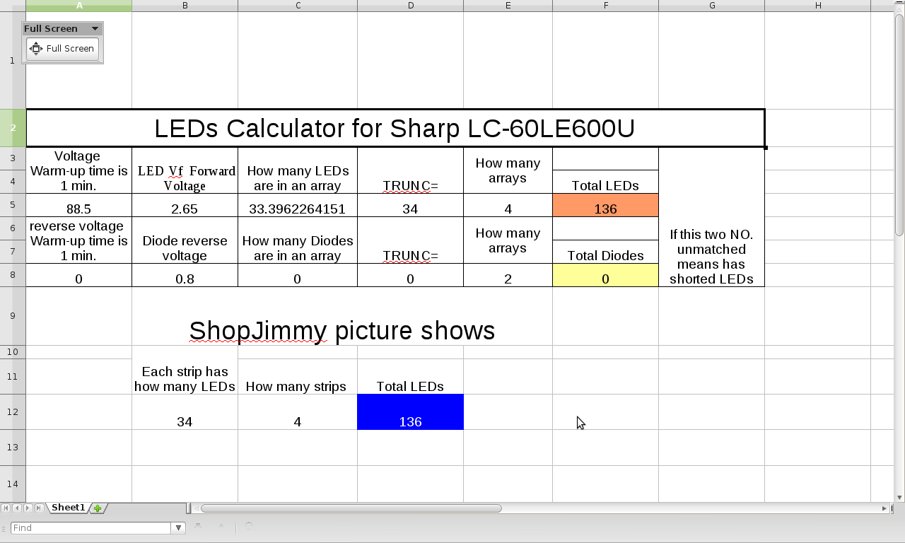

                                    The TV had 2 series groups of 40 LEDs each. The tester developed about 150v for the 40 series LEDs.

                                      "There appears to be a MOSFET in series with the output that does the fast current control. " My guess, it is the LR8 (HV version of LM317)?
                                      " a large drum inductor which must be part of a Buck regulator on the isolated side also." My guess, That is for smooth the output voltage?
                                      "The current ramps up in steps so must be controlled by the same micro-controller that does the voltage meter function." My guess, U6 only uses for voltage meter? The current ramps up using capacitor.

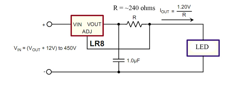

                                      PS: Why they use Epoxy because they don't want you to know it is so easy to built.
                                      The poormans LED tester current is at 6.8ma, with no ramps up current I can calculate LEDs characteristics. Pic2.
                                        That's wrong
                                        Current is 30mA no matters LED's number.
                                        110 Led's -> 330V
                                        330V x 0.03A (same 30mA as people say previous) = 9.9W
                                        Almost 10W,I think is a little too much for simple or single LR8K
                                        Also I don't see isolation transformer or 1:1.
                                        Could be live connected.
                                        Also for 110V line could be using some voltage doubler.
                                        That little transformer could be some part of SMPS that deliver power to microcontroller and 330V at 30mA or only for microcontroller and LED's voltage is from main line.
                                        More clear and detailed photos can be usefull to solve the mistery.

                                          You're right.....My bad, Constant current means all LEDs in series at 30ma.
                                          "Also I don't see isolation transformer or 1:1." This I just guess because I did not have this LED tester.
