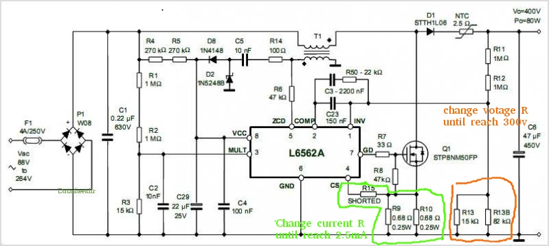

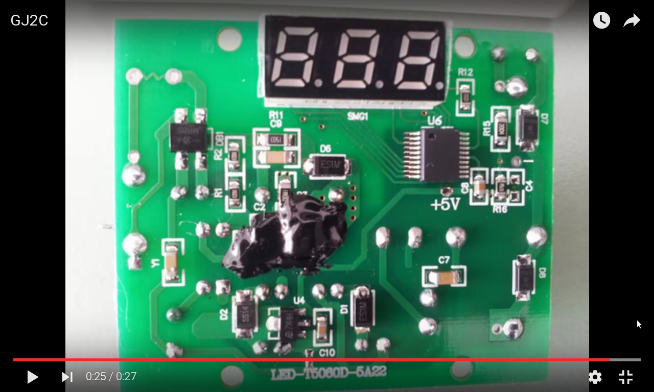

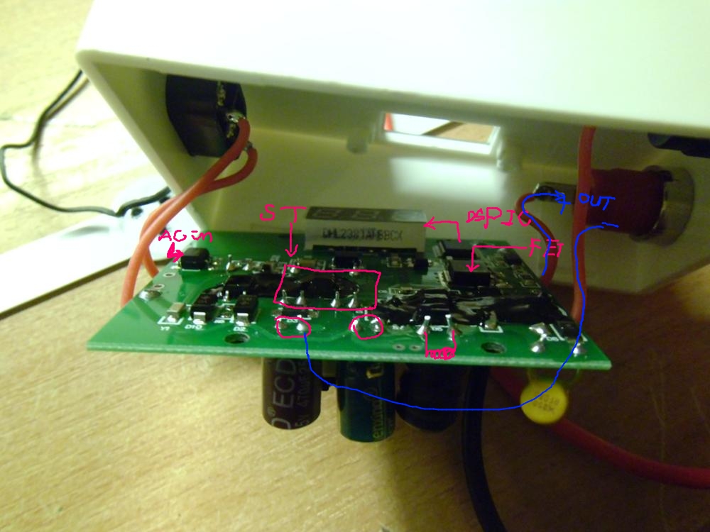

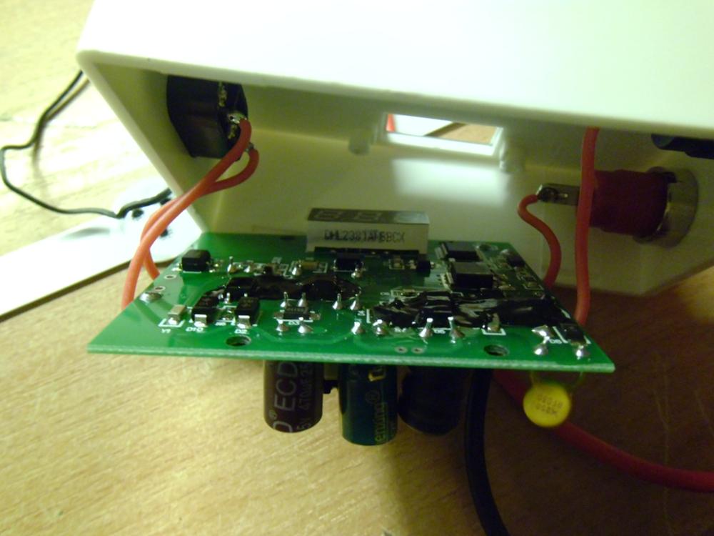

    Inside the Tester,Looks like this.
    Similar to this circuit.
    Transition-mode PFC controlle L6562A
    https://cdn.badcaps-static.com/pdfs/...8e89c6f9ca.pdf
      Re: attempt to clone LED TV Backlight Tester
      Can we see the straight shot of the bottom side of the board?

                L6562A PFC has voltage error amplifier and current error amplifier (comparator). (similar to TL494)
                Transition-mode PFC controller L6562A

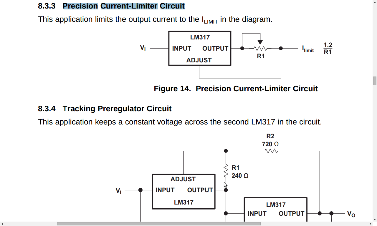

                        Special thank to BUDM:
                        You will need constant current source (to limit the max current to about 20mA) for testing power supply that can put out >102V (3.4V x 30 White) to test the whole string or you can test each LED by utself.
                        http://www.maximintegrated.com/app-n...ex.mvp/id/3256
                        You have to be real careful testing the LED strip without current limiter or constant current.
                        So have 5 LEDs on the strip and you apply 17.6V directly without any current limitter, and if one of the LED shorted out, then the current flowing through the string will be so high that can damage the good LEDs. I use power supply that I can adjust the current.
                        If you do not have one, you can use LM317 with heat sink as constant current source for driving LED.
                        You can easily do the experiment and measure DCA through your LED string with your 17.6V power supply, then short out one of the LED to see what happen to the current and then look at the spec of the LED for the current handling..

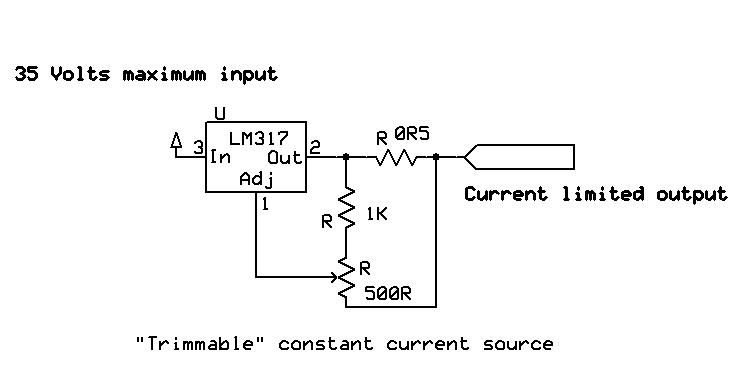

                          After 2 days breadboard with LM317, I still have problem with it.
                          The problems of LM317 are not not precision enough to do a TV LED TESTER job.
                          1: Good for fixed high current source (> 10ma) not a good current limiter. Maybe LM344 is batter.
                          2: LED is an active load - semiconductor device and can not consider as direct resistive load . I cant test one led then 10 leds because the LM317 act very unstable.
                          3: To stabilize the current, the input voltage must be at least the LM317 overhead voltage + Vref + combined Vf of all the LEDs and must of course be able to maintain that at the load current.
                          4: The LM317 is not a precision reference device, it will slightly change it's reference and regulation current as it waits rms up.
                          5: The current is decided by the voltage drop across the resistor, is it's value staying the same as it warms up?
                          6: The LM317 with the single series resistor between output and adjust input is actually a fixed current source, not a current limiter.
                          7: Maybe we focusing too much on the LM317. If we need a constant current we could use the LM334 which is a programmable current source for up to 10mA.
                          8: In Fig. 5 we have only a single LED yet the current remains 120mA. The load doesn't change the current from a constant current source in fact I could short out the output and maintain 120mA. Note the LM317 will get hot - and voltage not dropped by the load will be dropped by the pass transistor, LM317 etc. Don't go wild with a large Vcc powering a small voltage load.
                          http://www.bristolwatch.com/ccs/LM317.htm

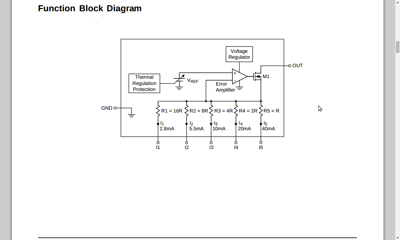

                            After a quick research in google i found the richtek RT7320, maybe with one of these and a boost converter is all you need.
                            • capwizard
                              • Jun 2016
                              • 1991
                              Muchas gracias compa.
                              richtek RT7320. Perfecto,exactamente lo que necesito.
                              I love the built in 2.8ma, 5.5ma, 10ma, 20ma, 40ma current switch. I will order from: http://www.digikey.com/product-detai...0-1-ND/4733241. I will post the result. Thanks aqain.
                              Programmable Regulated Current : 2.8mA to 78.3mA.
                              AC Input Voltage : 90 to 130VRMS or 200 to 240VRMS
                              Cant wait,so Ive ordered from Aliexpress. You make my day.

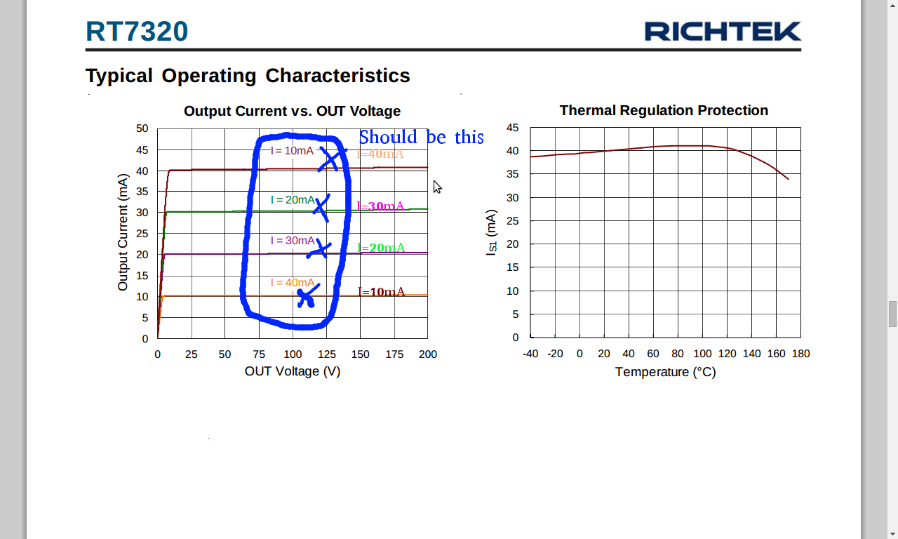

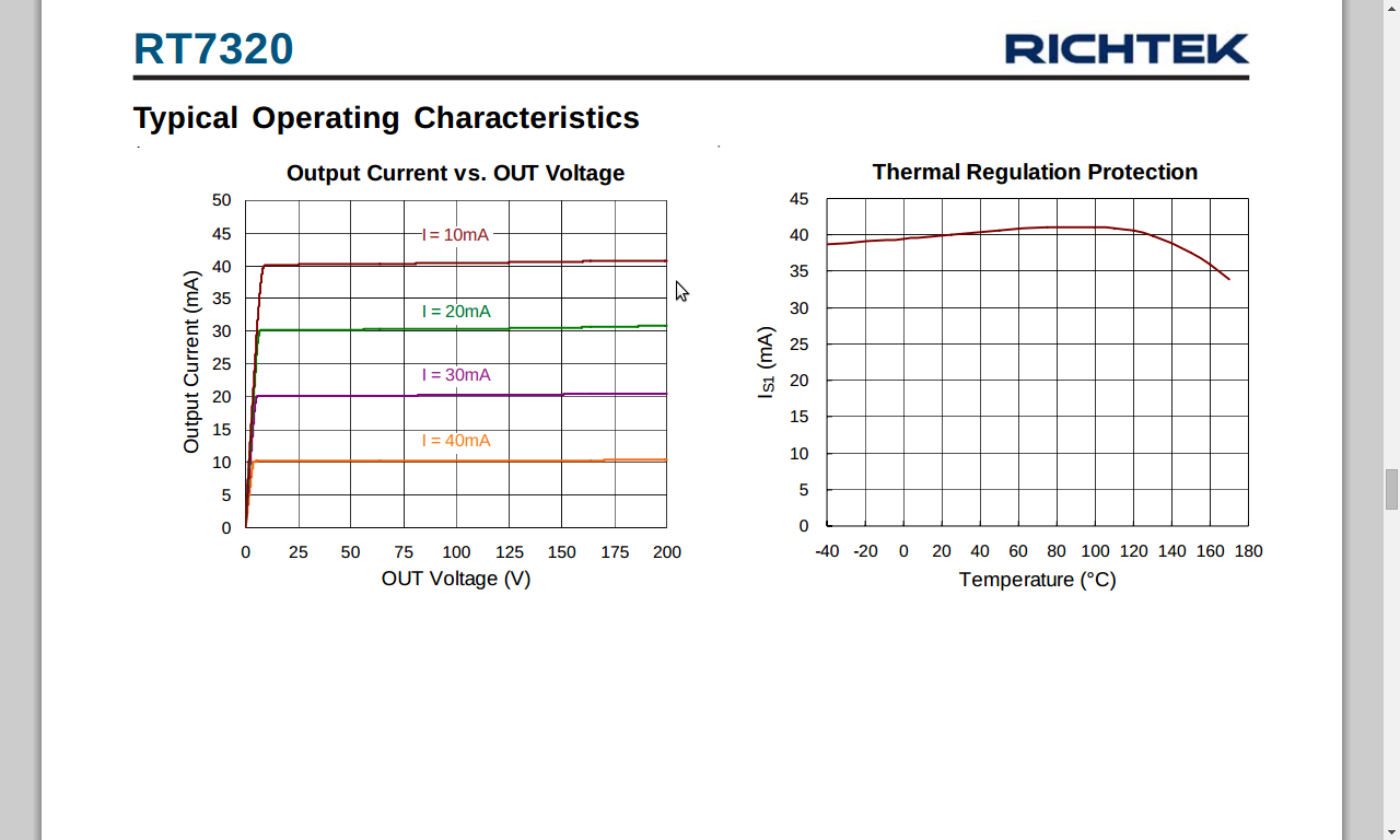

                                Ive found one mistake on the Richtek Technology company's product manual.
                                On page 6 Typical Operating Characteristics chart, Output Current vs. OUT Voltage, Output Current marks is wrong. Should I question about how good is their products? I hope not!
                                    Using RT7320 for testing LEDs (depends on how many LEDs there in the string) you will still need variable Voltage power supply otherwise it will exceed the power dissipation of the IC.
                                    The IC is just a higher Voltage low side (current sink) with built-in resistors for selectable constant current,
