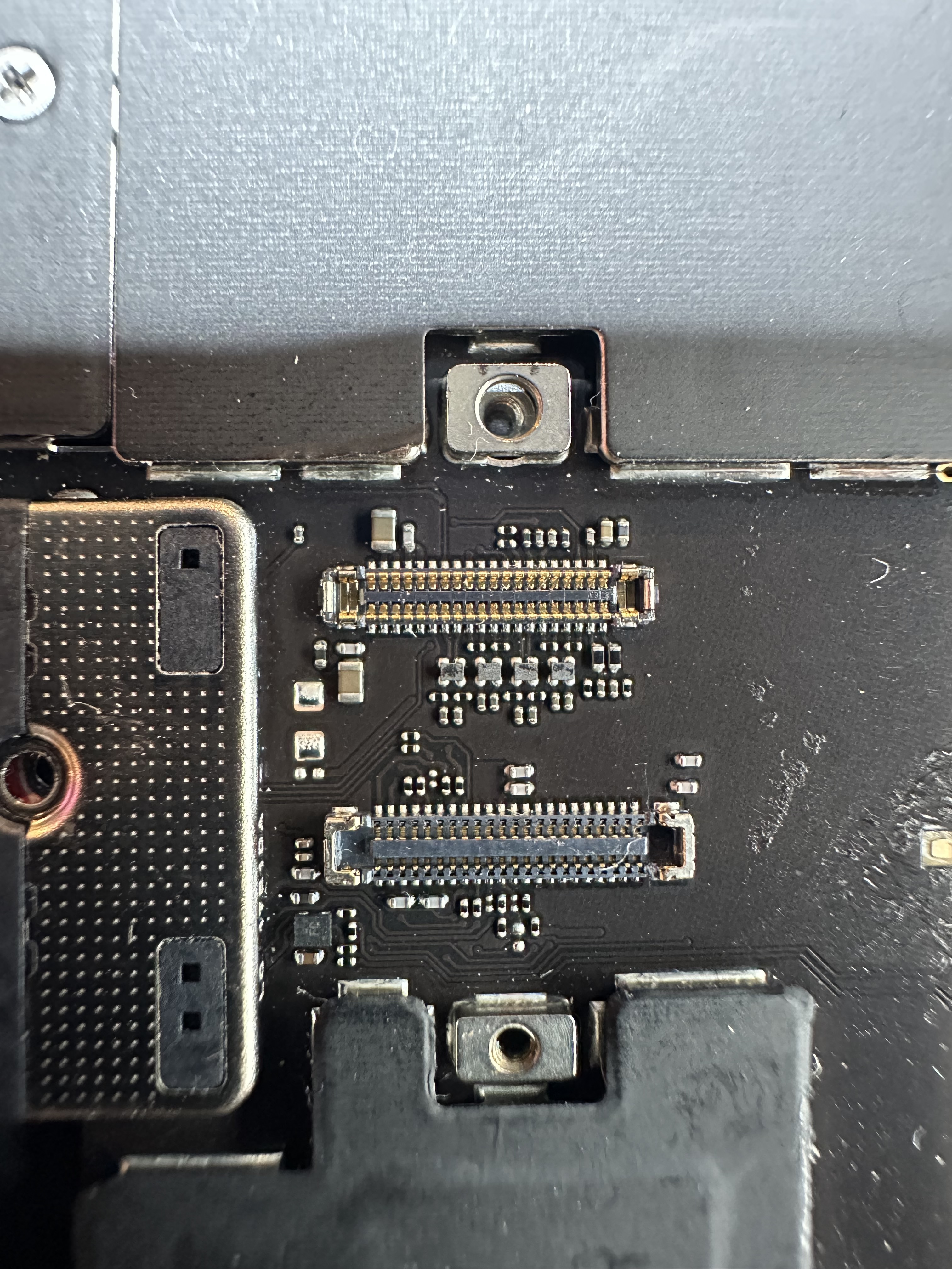

    Hello, got an iPad Pro A2378 12.9 5th gen with no backlight. Got another test unit without screen, tested the screen, still no backlight with the test unit.
    Figured out the backlight on the screen was bad, ordred a new backlight from mobilesentrix, *carefully replaced it* without damaging the lcd, oh well.
    Final result, issue is still there, the screen has no back lights. So i'm back to square one, with 3 hours less and 100$ out, issue still on the screen.
    The panel is still ok, i can see the apple in the middle of the screen when it kicks in, just no backlight.
    Anyone has a clue what else i can do other than spending 300ish on another screen ? I just don't get why it doesn't work having replaced the whole backlight of the panel.
    Thanks ! Vincent.
  • elecsoluces
    • May 2020
    • 66
    • France
    Backlight issue is a common problem on all ipad pro 12"9.
    It's a motherboard problem, check around fpc lcd you will find burnt ferrite bead.
    You can post a picture if you want help to locate it.
    Experience is needed to replace this component.

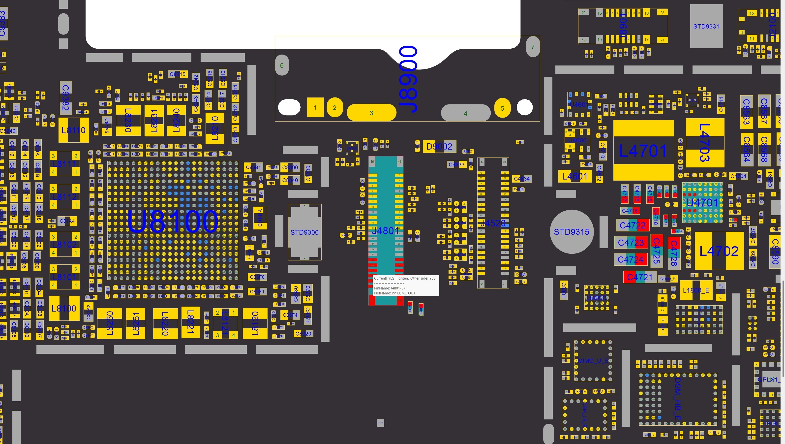

      Hi there, thanks for your reply. Here is a picture. Is that the area you are refering to ? I have no problem replacing parts, also i have access to ZXW. But i have the same issue on 2 boards ?

            It seems from ZXW that PP_LUME_OUT is missing, 0v there. Should that be enabled even if no lcd connected ?
