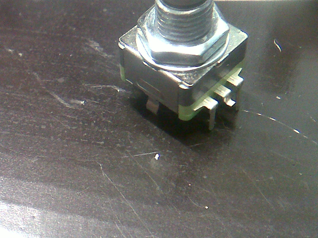

    so - rotary encoder time.
    get your rotary encoder and bend and trim the center pin so it sits on the top of the board - like this:

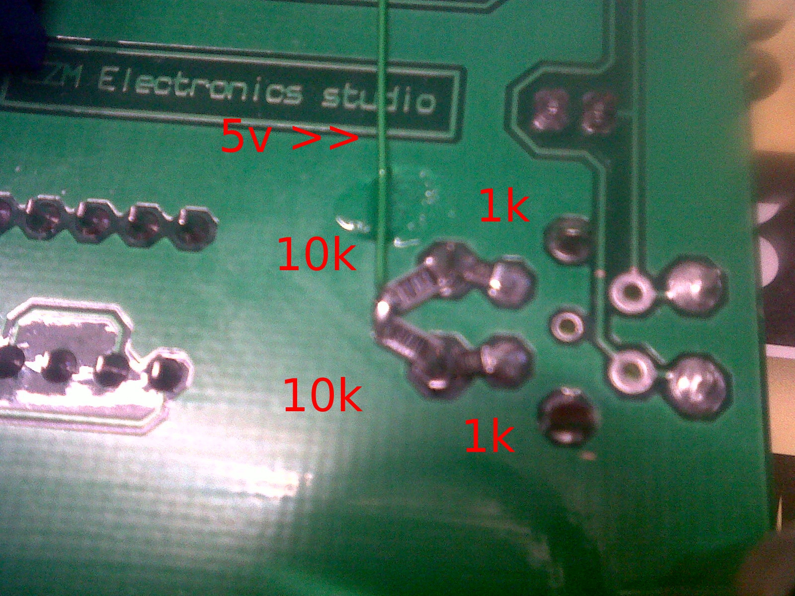

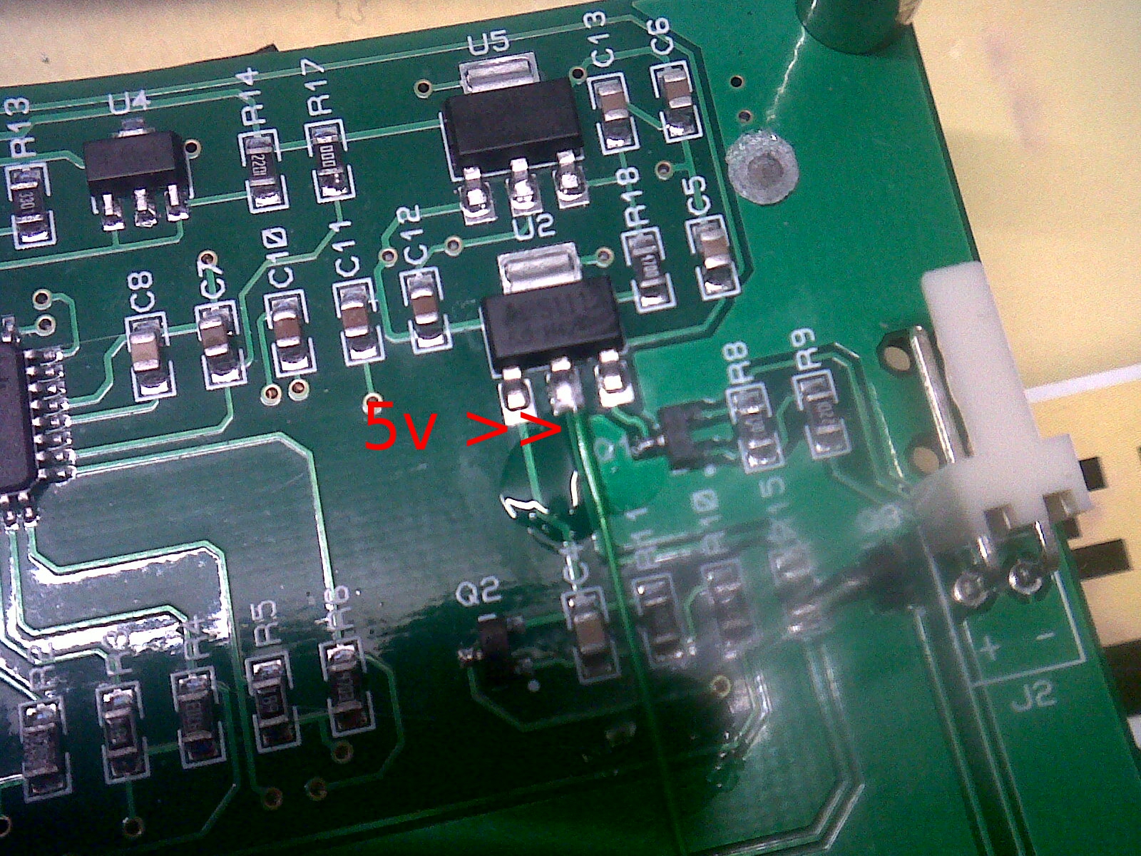

        next you need a pair of 1k resistors and a pair of 10k resistors and some thin wire.
        just to be clear, the place the 10k resistors join the wire is NOT connected to the pcb!

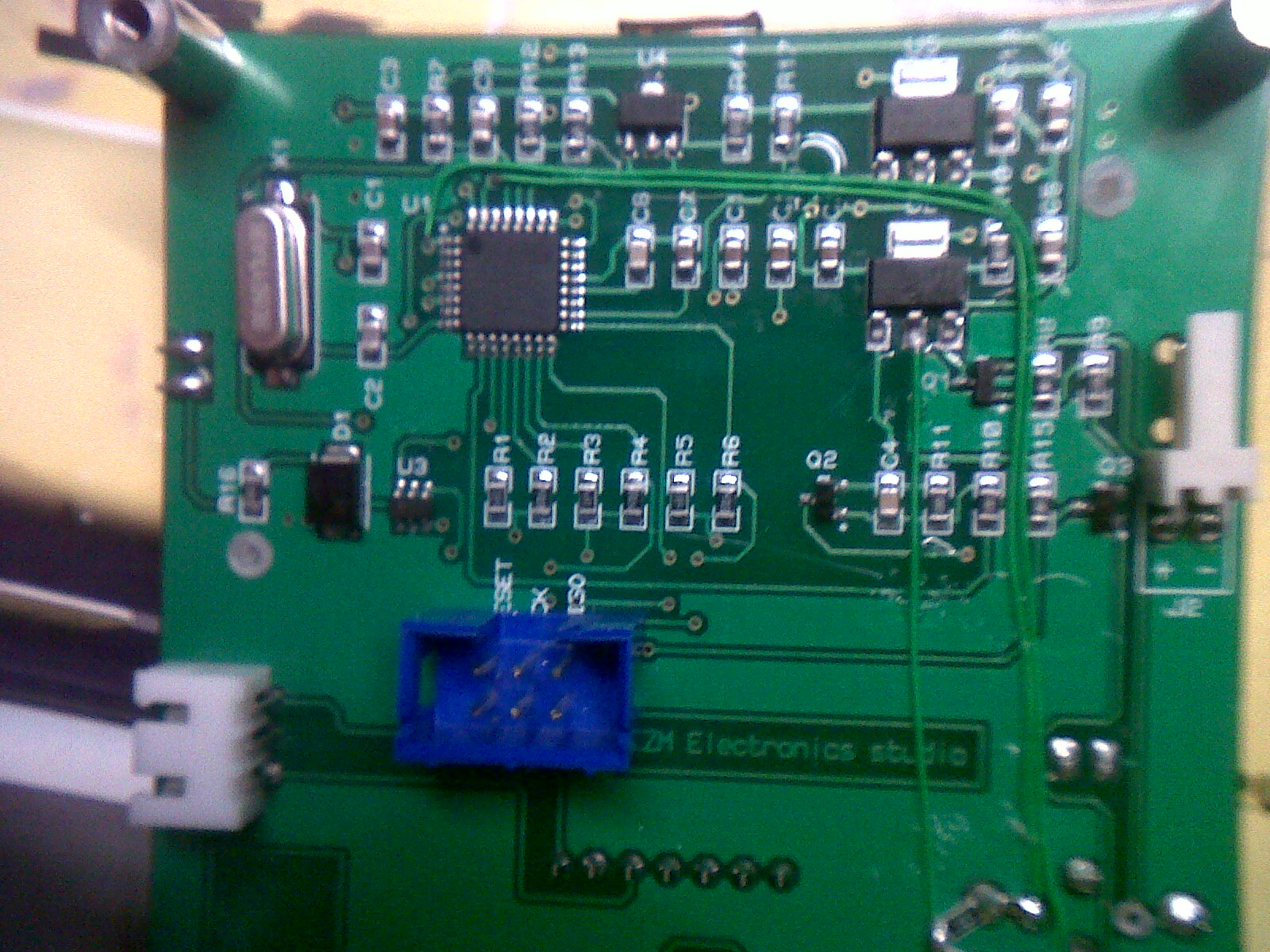

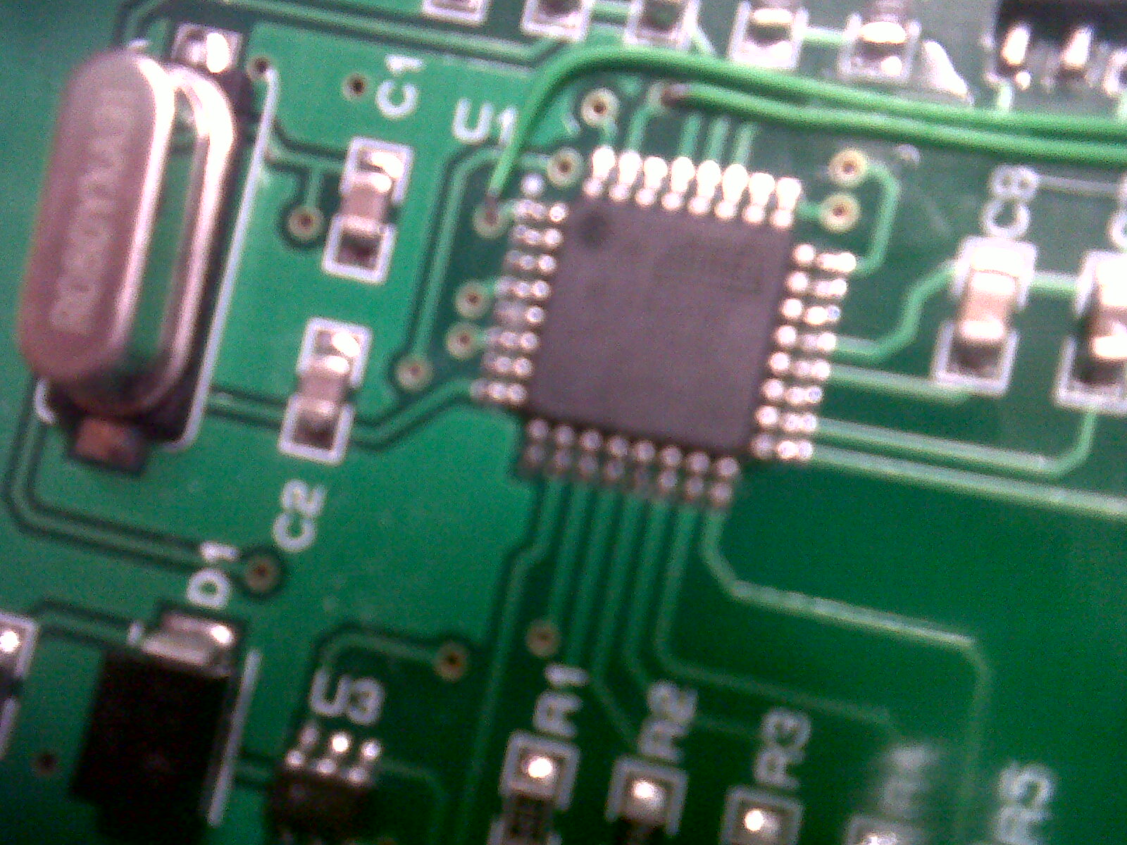

          Re: ESR meter upgrades
          next you need to link the 2 cpu pins to the resistors.
          WARNING - this is pro-soldering!
            • 30945
            if you do it clean, it should look like this:
