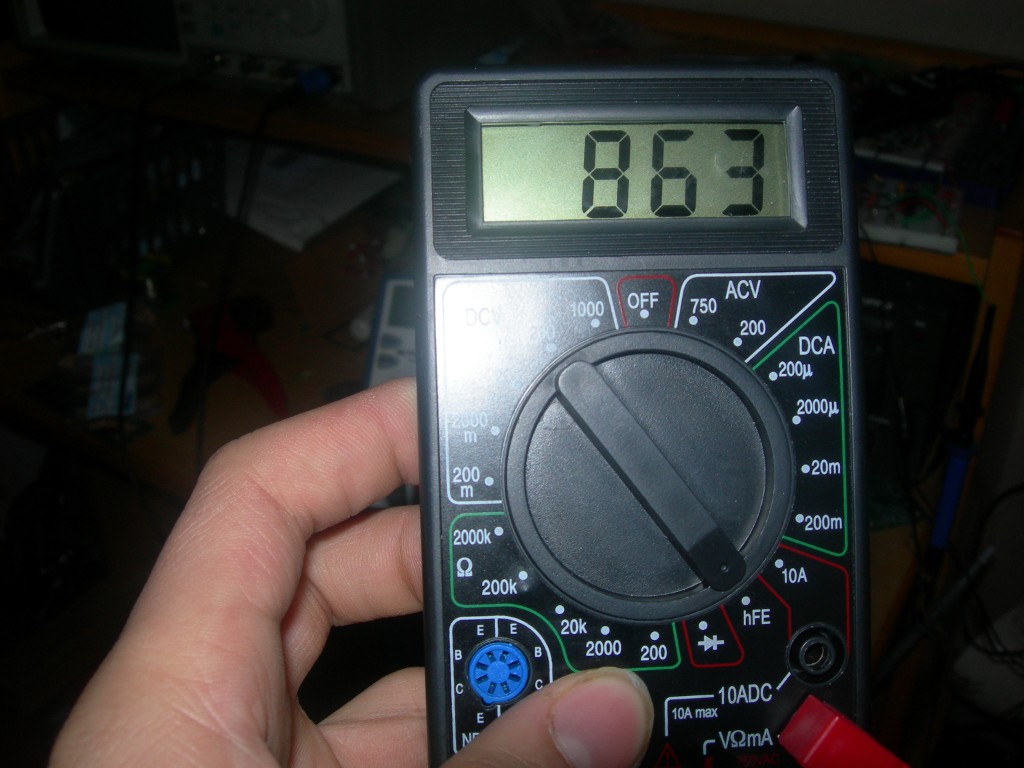

    As you know i own a number of meters for different purposes. The Uni-T UT60E and UT70A do the heavy lifting, but i often need a couple extra basic meters. One of them is a DT838 i bought this summer IIRC. I mainly bought it for the temperature and buzzer, as i already had two 830Bs.
    Well, since a couple weeks ago it started working erratically on resistance. More specifically, on the low ranges it reads in the hundreds of ohms even if there's a short, then it slowly counts down to the real value...
    I thought it was the battery so i replaced it today. Surprise surprise - exact same behavior. To make matters worse, the temperature range is busted too. It still measures voltages fine, but that's what i didn't need it for. On the other hand my two 830Bs still work great even though i've had them for years... but those two are both brand name (one Uni-T, one Mastech), while the 838 was the HongKongFlyApart, LLC version. But hey, it's only five bucks.

      Yes i did open it up, it only has a few SMD ceramic caps and a MKT 100 nF and that's it. They test good. Sounds more like a resistor that has shifted value, and they can't be measured in-circuit. For a $5 meter it isn't worth my time. I'll buy a $20 meter from Uni-T to replace it, as i currently have an extra temperature probe which i can't use on anything. To make matters worse the ICL7106 is in epoxied blob form, and it doesn't even respect the standard pinout. Too many cut corners to bother with it.

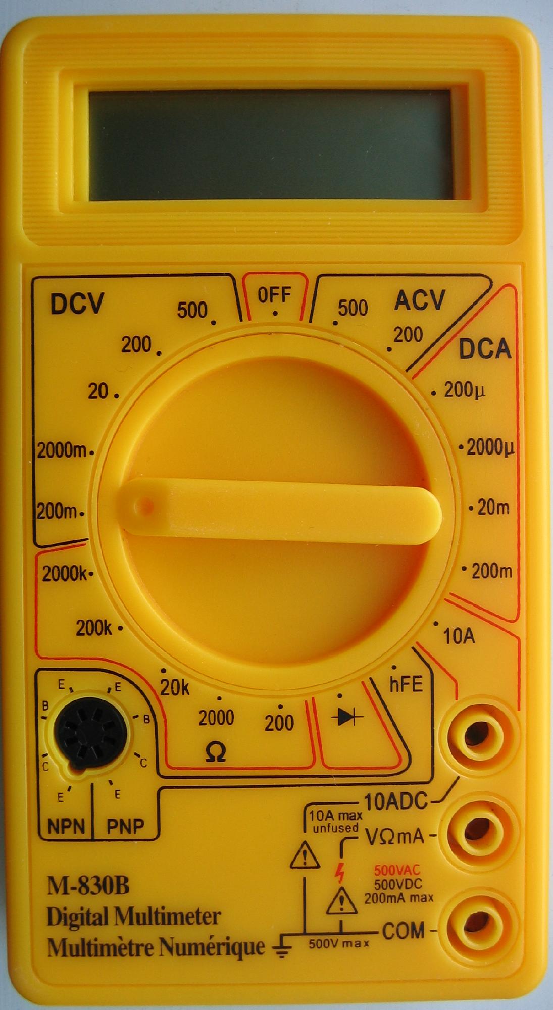

          I have a cheap HongKongFlyApart, LLC 830B variant (that's actually my only multimeter, lol), and when I short-circuit the probes on the 2000 Ohm setting, it shows 3 Ohms . New batteries will bring it down to 1 or 2 Ohms, but it's not worth it. So when I get 3 Ohms in a circuit on that setting, I know it's a short-circuit .
          On the 200 Ohm scale, it shows 0.9 to 2.7 Ohms, depending on how it feels. Most of the time, it's over 2 Ohms.
          Continuity/diode test shows pretty much the same numbers as the 2000 Ohm scale when the numbers get low.
          That multimeter has served me well for many repairs, though, so I will dismiss its flaws for now .
                  This is normal for the 830B and part of it is due to the crummy probes it comes with. With good probes it should read 0.6 to 0.9 ohms when shorted. I like my UT70A. It shows 0.0.

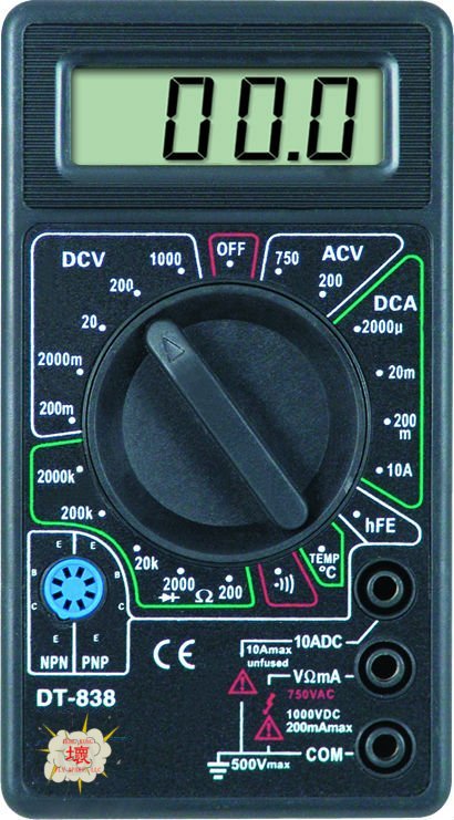

                                    ...while the 838 was the HongKongFlyApart, LLC version.

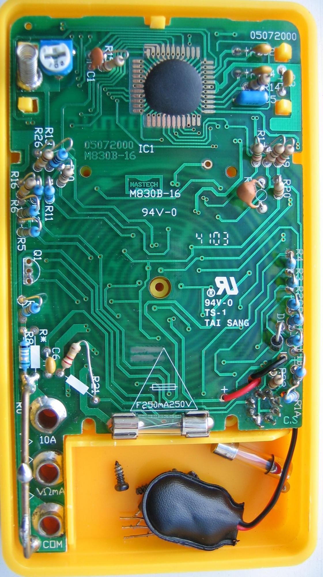

                                      Did it look like this? I got this one free, but not working.
                                      The fuse was blown, but changing the fuse did nothing. I found Q1 shorted in circuit and desoldered it only to find the IC good.
                                      I wouldn't mind fixing it just for educational purposes and using it to measure nimh batteries.
                                      Even though this was made in year 2000 with through hole components, I think it is much higher quality than the cheap 830B that I originally got off ebay. The soldering quality seems better and it is one solid pcb (not the patch job on the input jacks).
