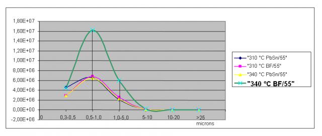

        OKI :

        Research has shown that the fumes and vapours emanating from lead-free solders may be more
        dangerous to workers and to the environment than those emitted by traditional lead containing
        solders. A study by the Danish Toxicology Centre assessed both the toxicity of lead and the metals

        Since lead-free processes require higher soldering temperatures, chemicals and materials are likely
        to become airborne in greater amounts than was the case with lead containing solders.So, it is
        likely that the use of lead-free solders will increase and not decrease evaporation from metals and

        The transition to lead-free soldering has reduced strain on the environment, but for the operator, the hand soldering process has become more dangerous. The lead in the solder is gone, but to get the solder wire to flow properly, substantially more flux must be used.
        The temperature needed to create a good solder joint using lead-free solder is also higher, causing a stronger reaction within the flux and creating more solder smoke with a greater number of particles. Lead-free soldering produces up to 250 % more particles between 0.5 and 1.0 microns in diameter, the size that is the most dangerous to inhale. In addition to particles, solder smoke can contain isocyanates, aldehydes, and other unhealthy substances.
        Lead-free soldering causes up to 250 % more particles in the breathing zone … roughly 20 million particles between 0.3 and 1.0 microns in diameter per cubic foot, or about 700 million particles per cubic meter.
        Standard lead-free 3% type ROL1 no-clean flux solder wire was melted continuously with a standard iron. The suction nozzle of a high efficiency fume extraction system was positioned near the tip of the iron. Just 90 minutes later, a nozzle-mounted net had captured a substantial amount of particulates.
        BEFORE --------AFTER 90 MINUTES OF LEAD-FREE SOLDERING
        This test distinctly shows the importance of using a fume extraction system, even when soldering only once in a while or for just a few hours a day. The captured particles are primarily condensed residues from flux. Without a filter system these particles will be partly inhaled by the operator with the remainder spread over the work object and workplace. In contrast, a proper filter system will eliminate not only the particles, but will also catch and eliminate dangerous gases created in the soldering process.

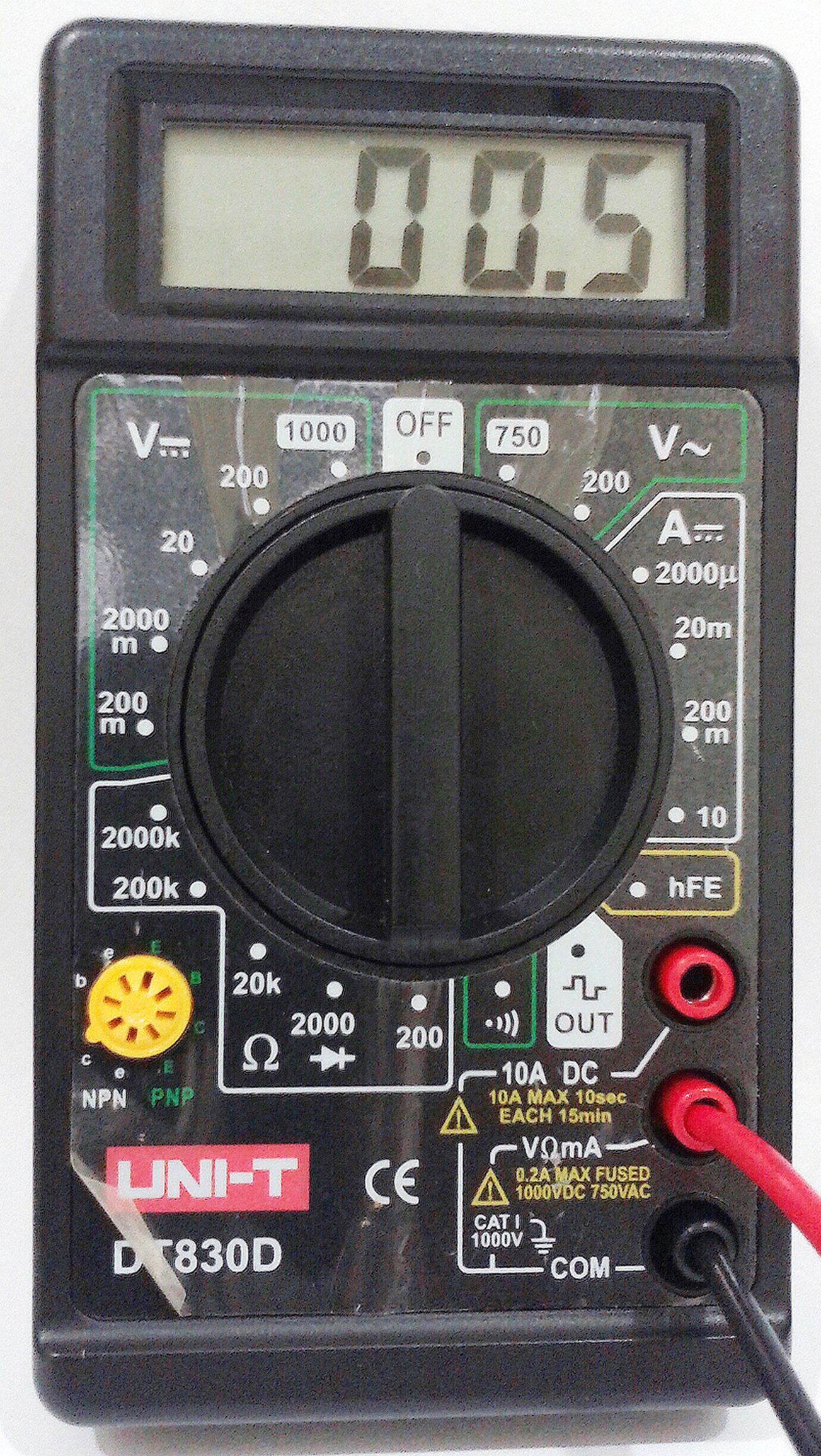

                    I need to figure out how to repair the leads that come with these meters. The ones I want to repair appear to have real 18AWG wire rated for 1000V, and it's even UL listed (E187208). The jacks on this one from Harbor Freight are slightly smaller than standard banana jacks, so standard leads don't fit.
                    This meter measures 0.9 ohms with the leads shorted, and low resistance readings vary. Sometimes it randomly adds about 5 ohms to the reading on the 200 ohm range. There might be a loose connection in the leads, but I can't figure out where one might be.
                          First, you need to make sure the connection inside the handles is solid (if it's not and if you tore the wires out before, you need to cut the handle close to where the probe needle is on the front and re-solder the wire to it again). Once it is, pour lots of glue in the handles so that the wire can't move inside. I usually do this with hot glue. It's not the best solution but it works for quite a while. When the glue starts to break or peel (takes a few months to a year of occasional use), I reheat it with hot air from my heat gun and it holds the wire perfectly again.
                          The second thing you have to know is that the dial on these cheaper meters is... well... cheap. Even if you have it on the 200 Ohm setting, it may not be snapped-on perfectly. You will find that if you move it around just a bit, you may get a good connection and low resistance. Also, with the stock Harbor Freight probes, my Centech meter measured 1.4 Ohms at the lowest. Removing them from the meter and jumpering the COM and Ohm/V/mA jacks makes the meter show close to 0.2 Ohms. So it's just the stock probes that are crap. The meter itself does okay.

                            how about a foto of the meter?
                              #74
                              Re: This is why you don't buy cheap multimeters.
                              You don't need two probes to make a shorted connection.
                              Put the black probe jack in COM and then put the black tip probe in V/ohm and note your resistance measurement. Then do the same for the red.
                              Also check the soldering quality of the pcb input jacks. As you can see on mine, it has stellar soldering from the "factory"...
                              https://www.badcaps.net/forum/attach...8&d=1275345583

                                #75

                                  #76
                                        They're in this thread.

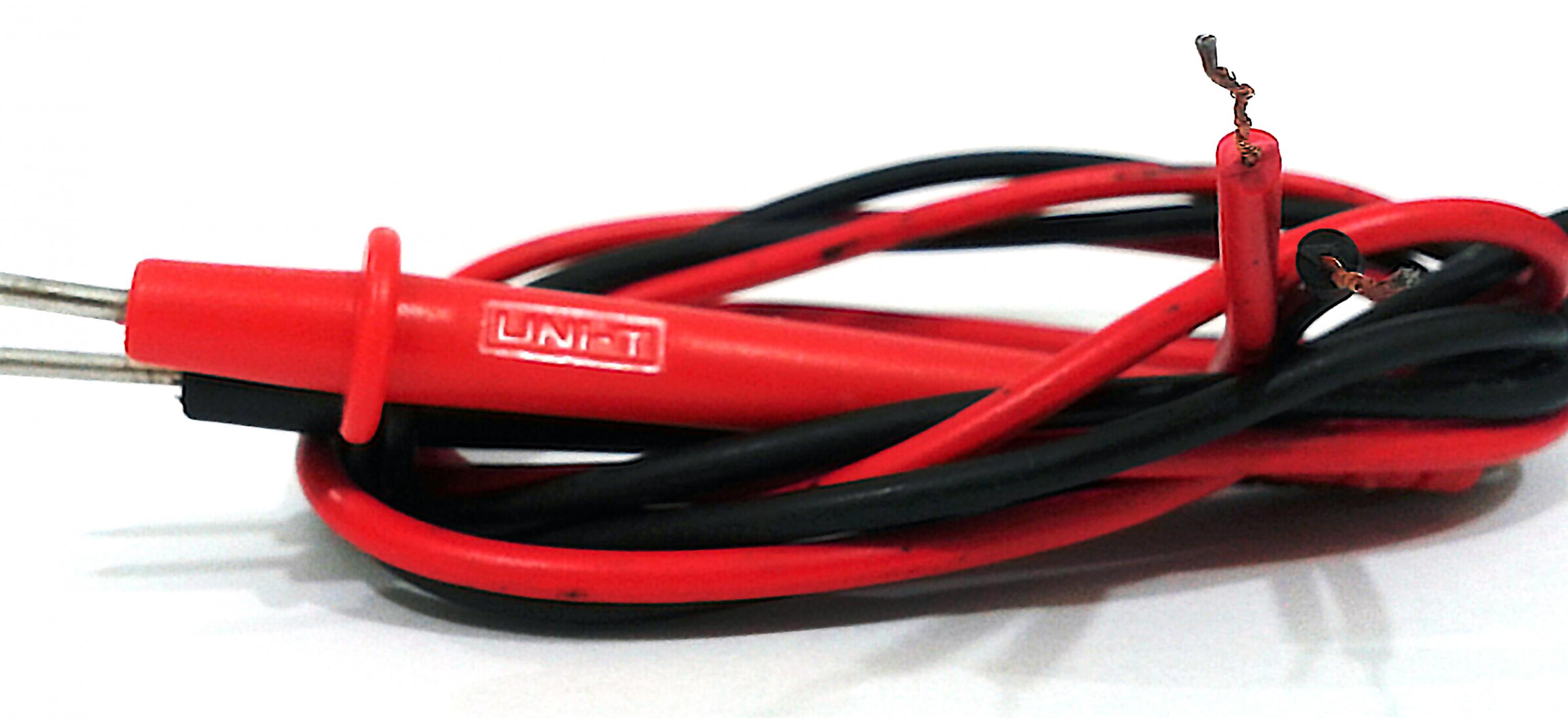

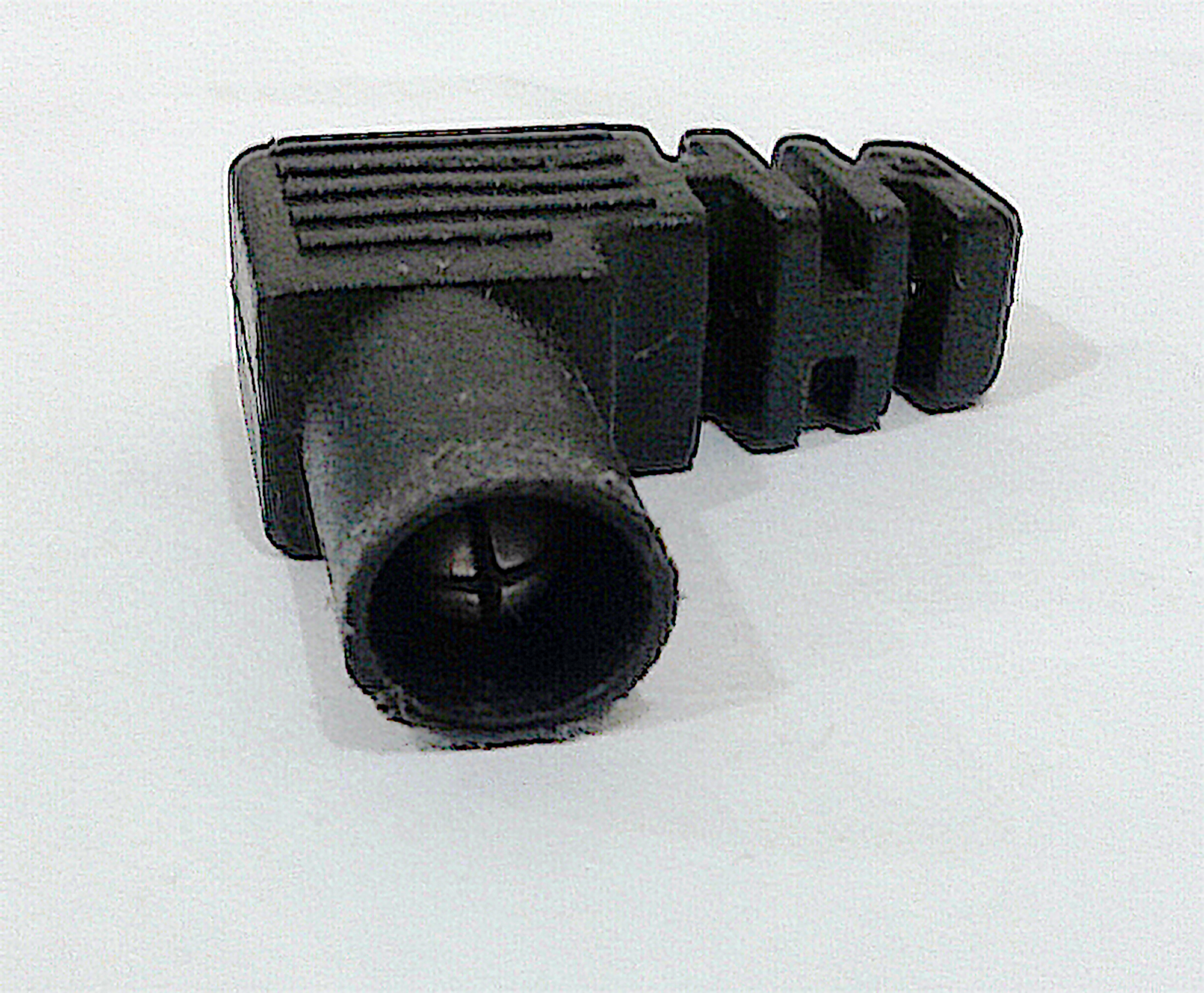

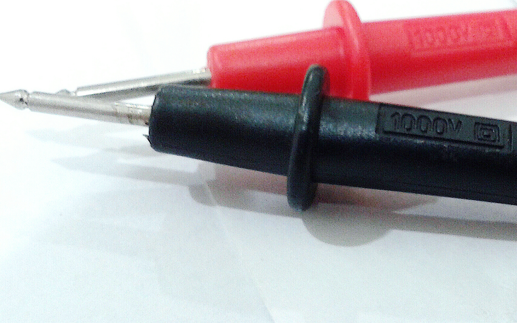

                                          Fixing UNI-T DT830D Leads
                                          I need to ask some opinions from experienced members here to repair the defective probes that come with these meter. I had done some minor repair like re-soldering battery block clips, remove the crack and bad solder joints and reworked some of the old insulation wire wraps. Please refer to this link from my previous post [https://www.badcaps.net/forum/showpo...&postcount=52]
                                          Finally it can boot up like normal again but now I need some ideas from members here to fix these defective leads appear to have a real 18AWG wire rated for 1000V [AWG_wires]. Then the loose connection at the end of the leads had been cut off so far [leads_connector]. So some soldering works need to be done to attach the probes back to the meter like the thumbnails [probes_cutoff] attached below. This meter also measures 0.5 Ohms with the leads shorted [meter_0.5Ohm].
                                          Questions:
                                          1. Should I remove the probes from the meter and replaced it with a decent set (shielded 4mm jacks). Where can I get a new 4mm shielded sockets?
                                          2. Any other ways to repair this kind of probes which always come with bad craftsmanship from the factories?
