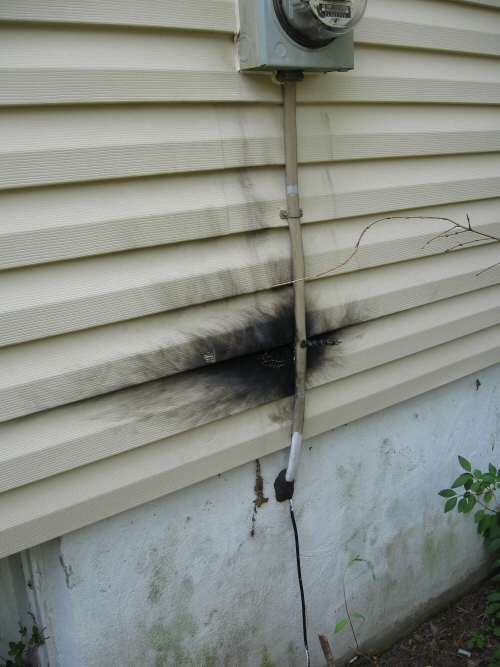

                Originally posted by kaboom
                Like this?
                At least the place didn't burn. A couple of years ago around these parts, a charter subcontractor managed to burn down a brand new $2.5 million house by drilling into the electrical panel from the outside. It took 6 fire departments to put it out! This is the best link I can find...
                http://www.ksdk.com/news/story.aspx?storyid=88193
                Somewhere else it said the guy worked for 'Sparx' Communications

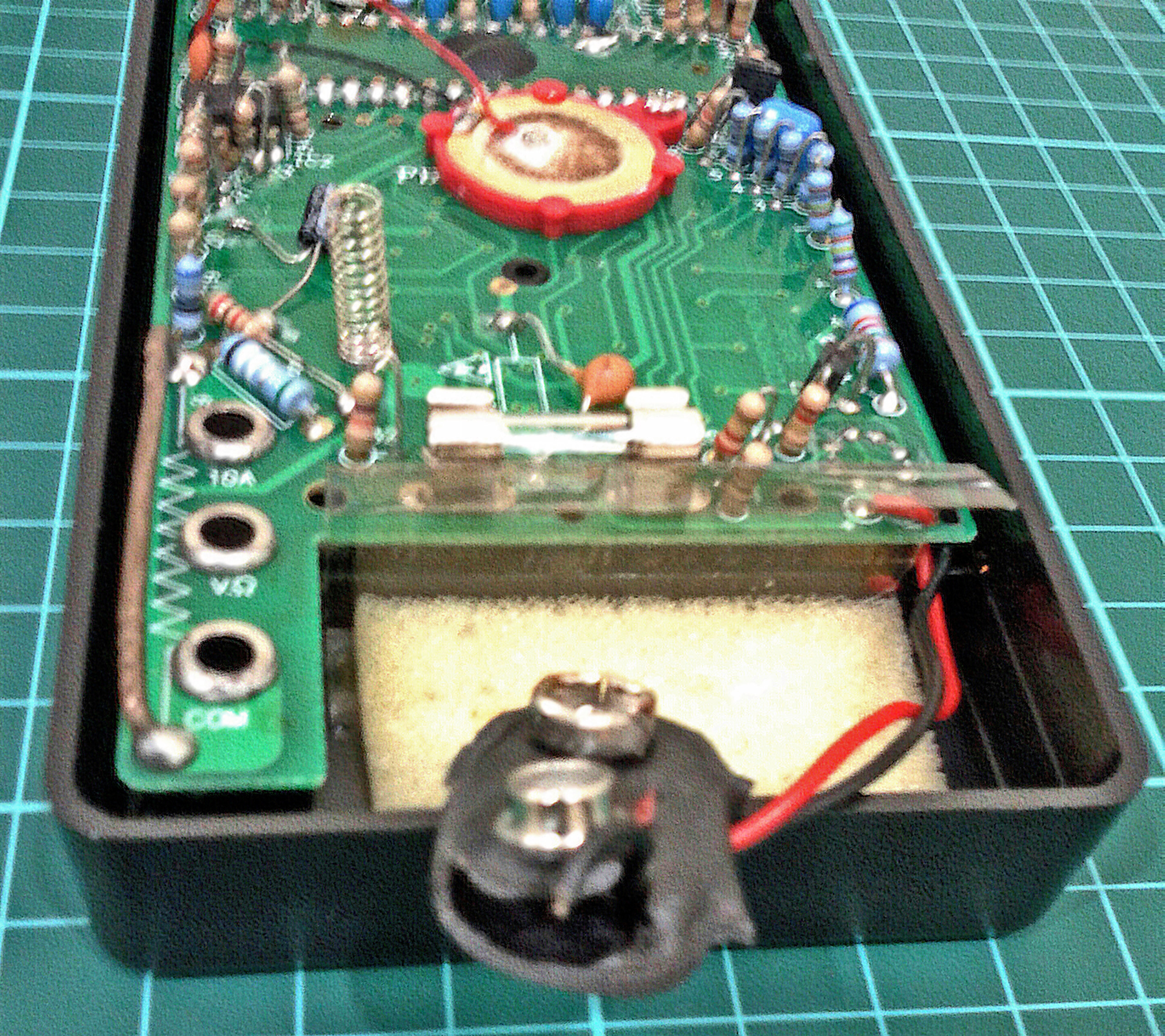

                  After playing a bit more with the probes on my 830D yesterday, I found something very interesting.
                  Up until this point, a short circuit on my 830D would show as 2-3 Ohms (and very rarely 1.8). I though this was just due to my 830D being very cheap - but it's not. Yesterday, I was trying out some spare connectors to see if they can fit in the multimeter plugs so that I could make my own high-current probes (since the original probe wires are obviously too underrated for that). After inserting one of the connectors in 10A jack of the multimeter plug, I selected the 200 Ohm scale and used the red probe (still plugged in its usual place) to see if my connector actually made connection with the multimeter - it did. Not only that, but my multimeter was reading 0.5 Ohms! I though, that can't be right, so I unplugged my black probe, inserted my own connector in the COM plug and measured the resistance again. But once more, the multimeter read 0.5 Ohms. At this point, I pretty much knew what was going on. I swapped the red probe for the black probe, then tested resistance again to my connector in the COM plug... yup, back to 2.2 Ohms.
                  So as it turns out, the wire for my black multimeter probe does actually have about 2 Ohms of resistance. - No wonder it heats up so badly. Also explains why in the past, my multimeter would drop so much voltage when I was trying to measure current. Now I know. Time for new probes.

                    Your original 830D probes are actually still in one piece? Wow. Mine died years ago, so they never had a chance to give me a false reading.
                      Like this?
                      Do doubt the double insulation on that drill saved the morons life.
                        Oh no, of course not. I did fix them (see page 1 or link below):
                        https://www.badcaps.net/forum/showpo...6&postcount=12

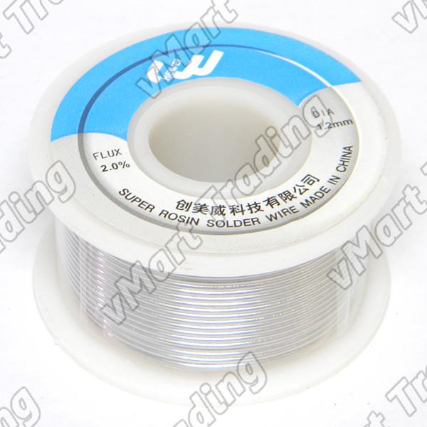

                                It does not depend on what PCB you have, it depends on what solder you use.
                                It's usually written in the specs or even on the roll of the solder...
                                Does this type of solder wire suitable for soldering on the UNI-T DT830D circuit board?
                                Specifications:
                                -Alloy Composition
                                : Sn63PB37 (63% Tin, 37% Lead)
                                -Melting Point
                                : 183 ~ 193°C
                                -Flux % In Core Wire
                                : 2.0%
                                Solder Name:
                                -KEWEI Sn63Pb37 Flux Core Solder Wire (0.8mm)
                                Country Of Origin:
                                -China

                                  that will do,
                                  but lead-free stuff would be better.

                                    Re: This is why you don't buy cheap multimeters.
                                    That solder is quite good, if it is what it says.
                                    If it's really 63/37 that means it's eutectic...solder will melt or turn to solid within a very narrow temperature range of about 1-2 degrees C around the 183c value.
                                    To solder you actually need to set the temperature of your iron higher, because when you put the iron on the copper on the pcb and you have the wire from the connector there as well, both will pull heat away from the iron tip and the temperature may drop below that 183c temperature and you won't solder reliably.
                                    You adjust the temperature to be hot enough to warm up everything in 2-3 seconds .
