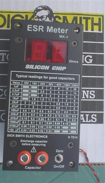

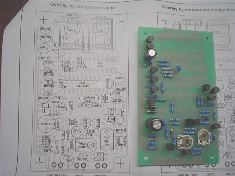

                  Re: EVB ESR Meter (Bob Parker Design)
                  Humm yeah that switch is a bit piddly.
                  I build the DS version....
                  Got it on sale for about $70 or was it 80 AU
                  (it was a bit cheaper, the below is probably why)
                  3 grips...
                  They forgot the silk screen overlay on the PCB
                  (which made it harder to assemble....but I am use to that)
                  They didn't drill two holes for one electro caps
                  Supplied open trimpots
                  Would have preferred closed units anyway it works
                  Not sure now if I got leads, think so
                  did get 2 resistors for calibration.
                  The switch on the DS unit mounts on the front panel
                  (its just a jiffy box case)
                  Your units look very slim compared to mine...
                  I suppose you could re box it willawake but then I guess it wouldn't look as nice
                  I will have to post some pics of the construction

                            re: Silicone Chip's ESR meter kit @ DSE (AUS)
                            Just picked mine up (thanks for the tip), shop assistant said the $79.95 -> $24.95 price drop reflected the low interest in this particular kit project, hence it was his belief that this was a product run out special
                            So folks... come get 'em while they're HOT!

                                  Yeah, it's the MKII I didn't need the extra Ohm meter feature, I managed to secure 1 of the last 2 in town
                                  Build report? pics? can do

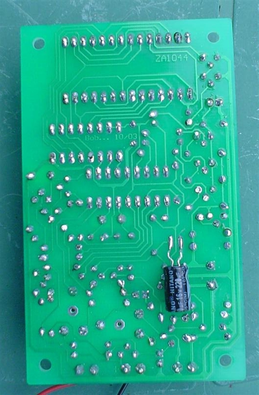

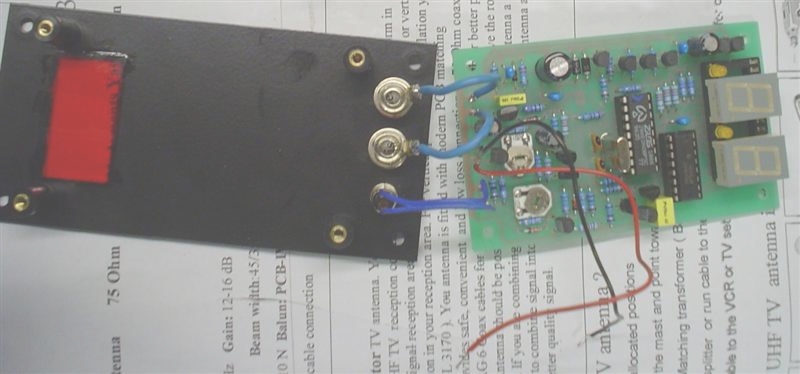

                                    good one mate
                                    Anyway a long time ago you said I should
                                    so here are a few construction pics
                                    I am not going to win any awards for mil spec construction I know but it works
                                    I haven't shown the battery setup in these photos
                                    Note the 2 points above. cap on back of PCB... no overlay
