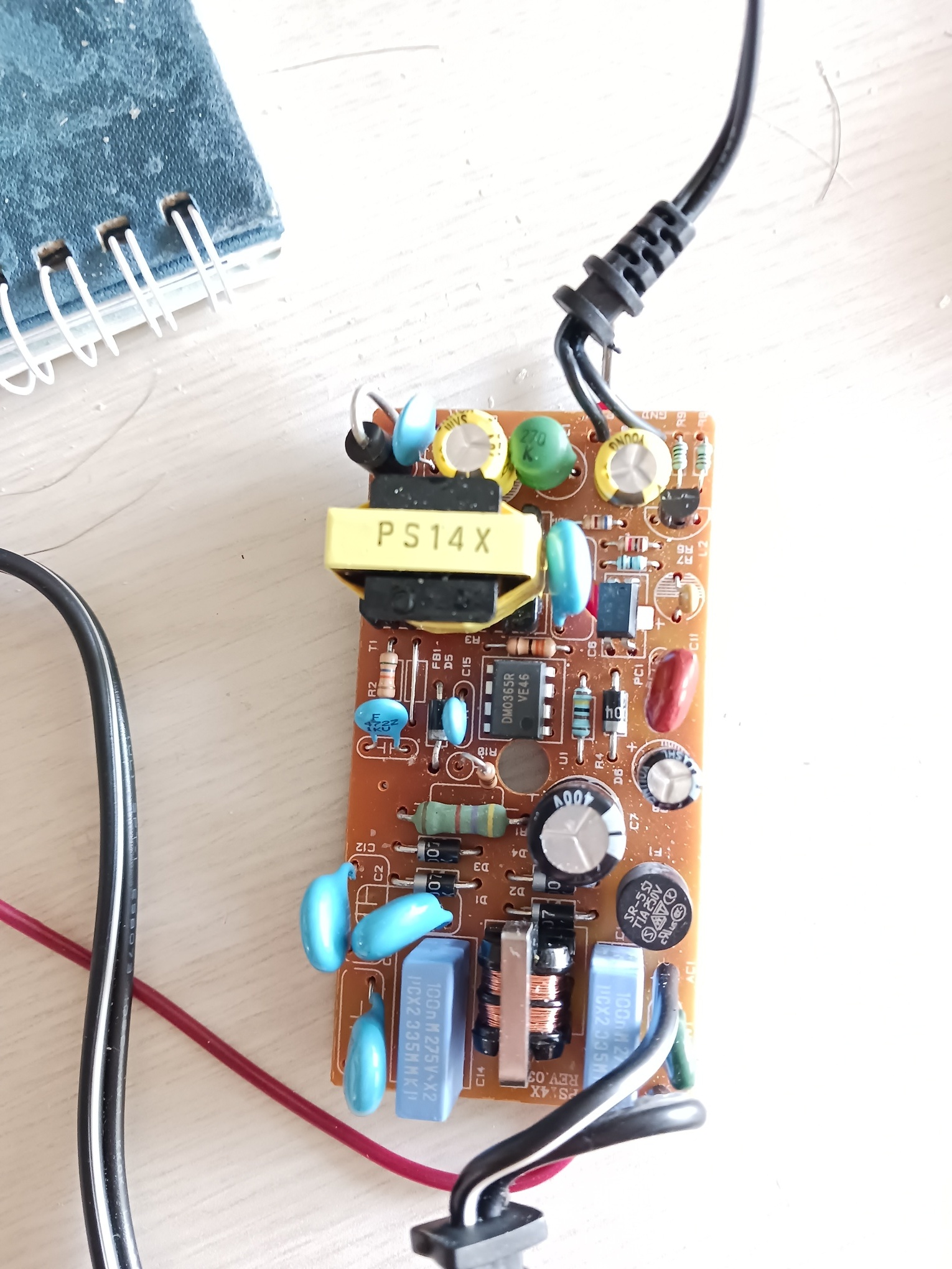

    How Can I test PWM DM0365R?
    Hello
    I have power adaptor(220V/input, 12V 1.2A/output) which has symptom of fluctuating output DC voltage between 11.5V-12.2V.
    So I opened its plastic case and when switched it on, I heard constant tik tik sound from inside its PCB.
    I measured DC voltage between negative and positive pin of the largest capacitor(400v 10uf) and it was measured contant 300V.
    I also measured ESR value of all capacitors and I noticed that one of capacitor(KMG 16v 470uf), which located in the secondary side, have high ESR value(10 ohm),So I replaced it with same specification NXH capacitor.
    In the vicinity of this capacitor(16v 470uf), There is ka431az regulator,I desoldered it and tested it by following below youtube guide.
    https://www.youtube.com/watch?v=_BYSsQ4ODEU
    I noticed that the result of diode test mode is not the same with youtube guide.So I purchased ka431az regulator which has the correct result of diode test mode, and replaced abnormal ka431az regulator with it.
    But It is still fluctuating output DC voltage between 11.5V-12.2V and I still heard constant tik tik sound.
    So I desoldered optocoupler and tested it with analogue multimeter by following below youtube tutorial and I also tested all of its diode with diode test mode, but It seems that there is no abnormality,
    https://www.youtube.com/shorts/mDwkd3PD4sQ

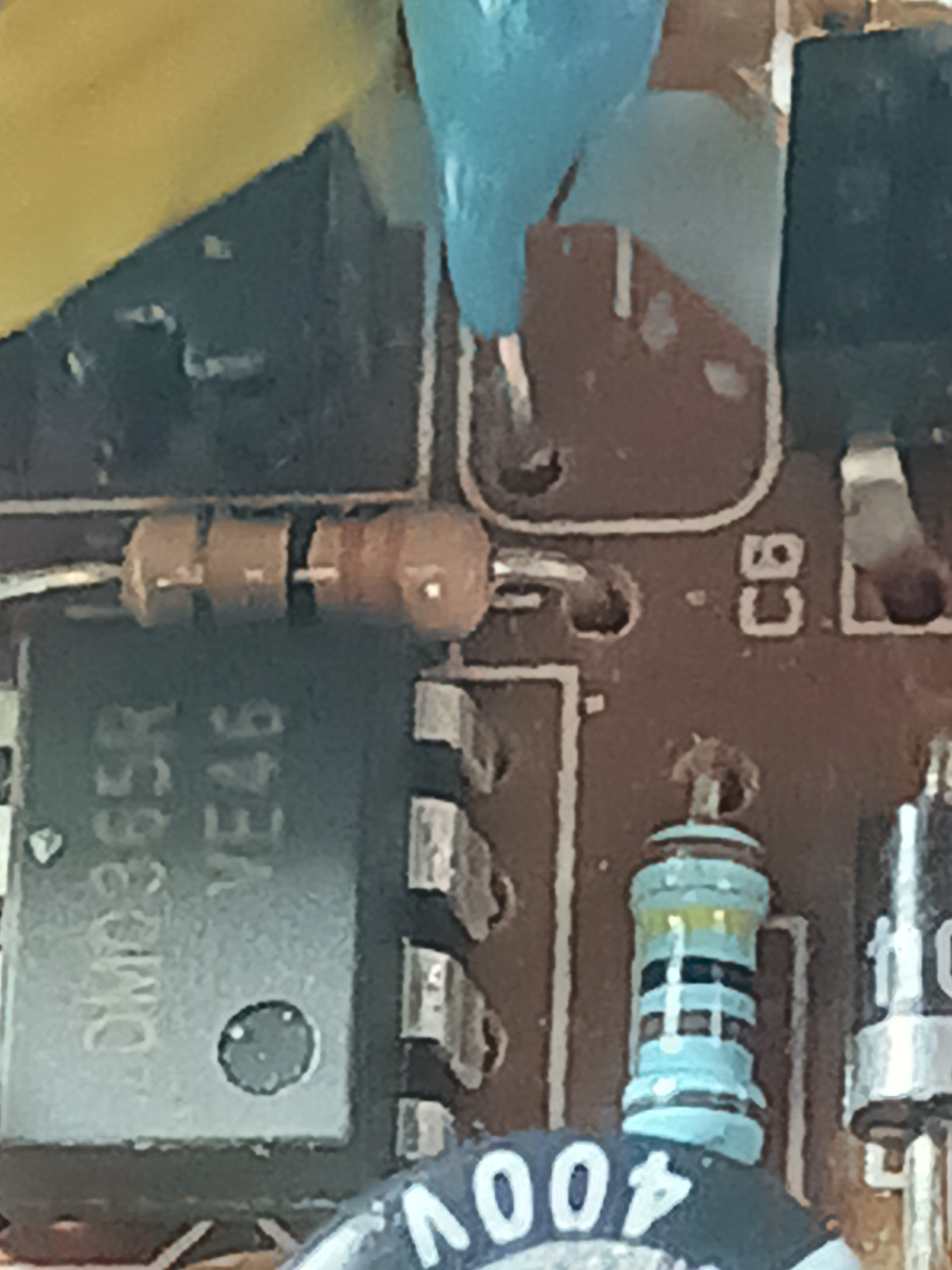

    I want to test PWM DM0365R which is located just above the largest capacitor(400v 10uf) But How can I test PWM DM0365R?

          I measured DC voltage between pin1(Ground) and pin2(Vcc) of PWM DM0365R and also measured DC voltage between pin1(Ground) and pin3(Vfb)
          It fluctuated between 10.6V and 0V, 0.22V and 0V like below dropbox links.
          https://www.dropbox.com/scl/fi/k0grn47uh7fgr2s11mj62/20250619_164149.mp4?rlkey=vhpgbut5sgc8jx2ppq2okaf4r&e=1&st=dd2b7vmu&dl=0
          https://www.dropbox.com/scl/fi/0vef5...=m7w4uz9a&dl=0

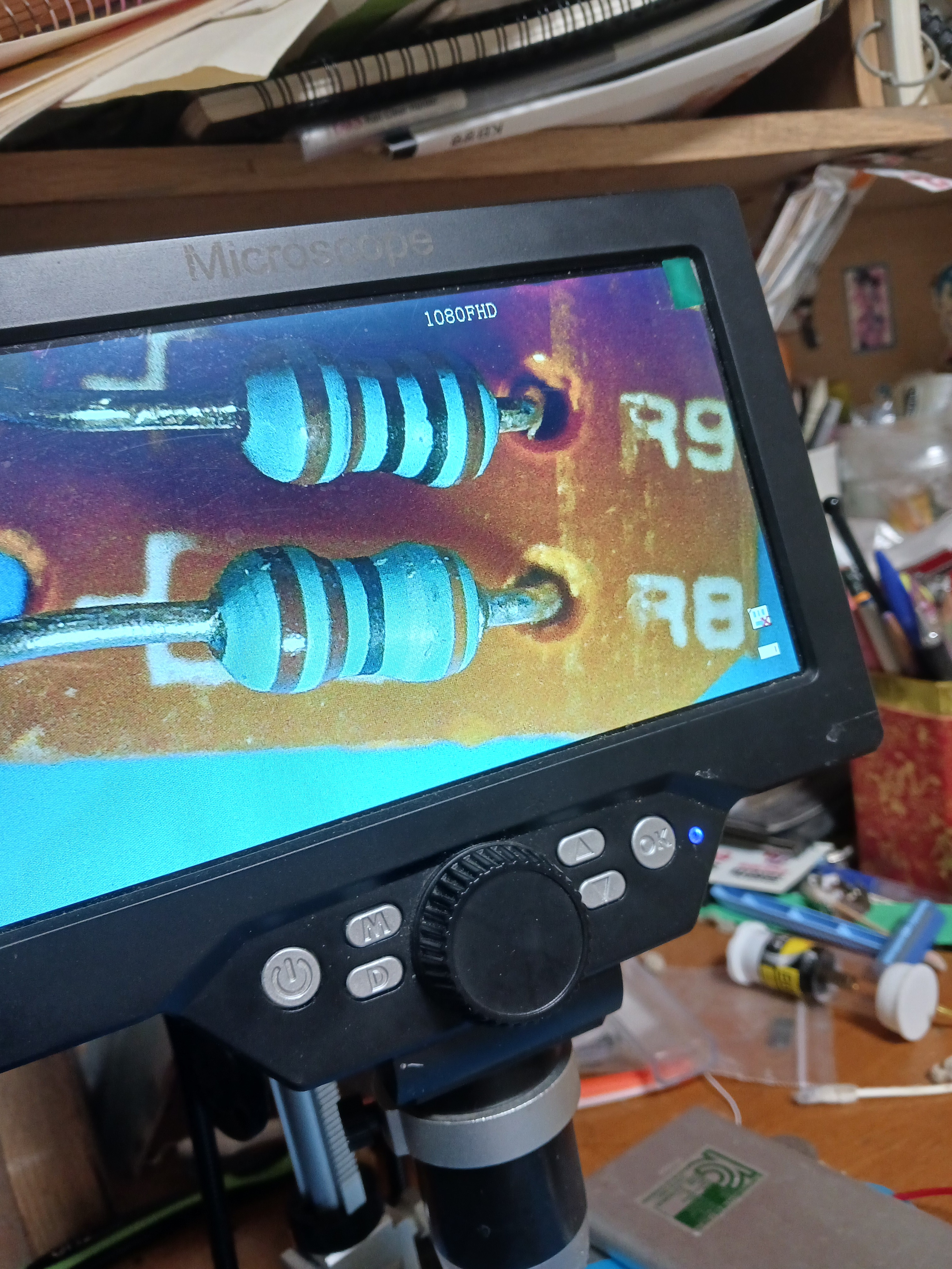

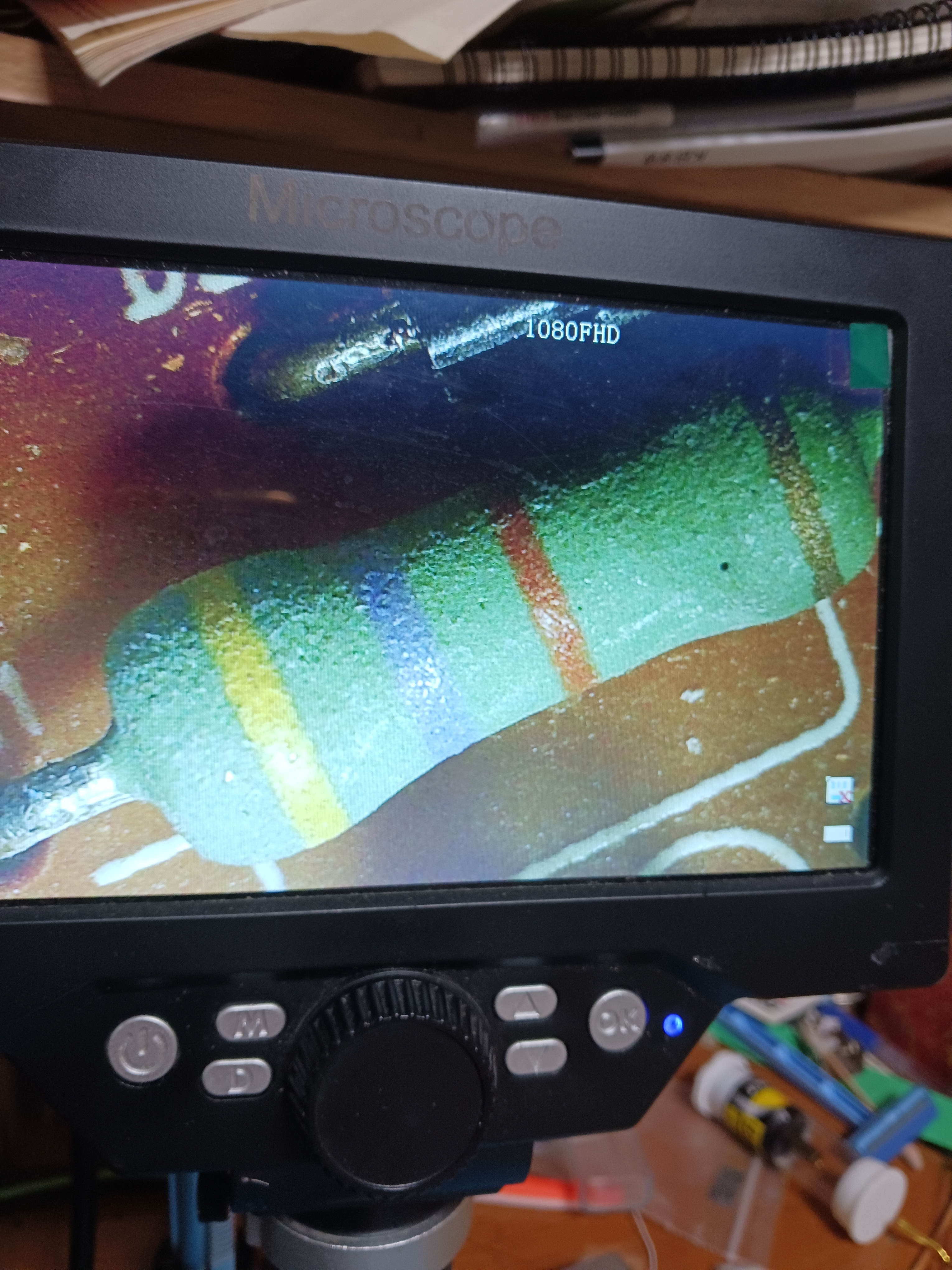

              I finally measured resistance of carbon resistor..
              resistance of R9 resistor is 0.99kohm and R8 is 3.904kohm
              Click image for larger version  Name:	20250617_080707.jpg Views:	0 Size:	2.76 MB ID:	3662685
              below carbon resistor is the biggest(1w) resistor in this PCB
              resistance is 47.12kohm
              Click image for larger version  Name:	20250617_080827.jpg Views:	0 Size:	3.57 MB ID:	3662687

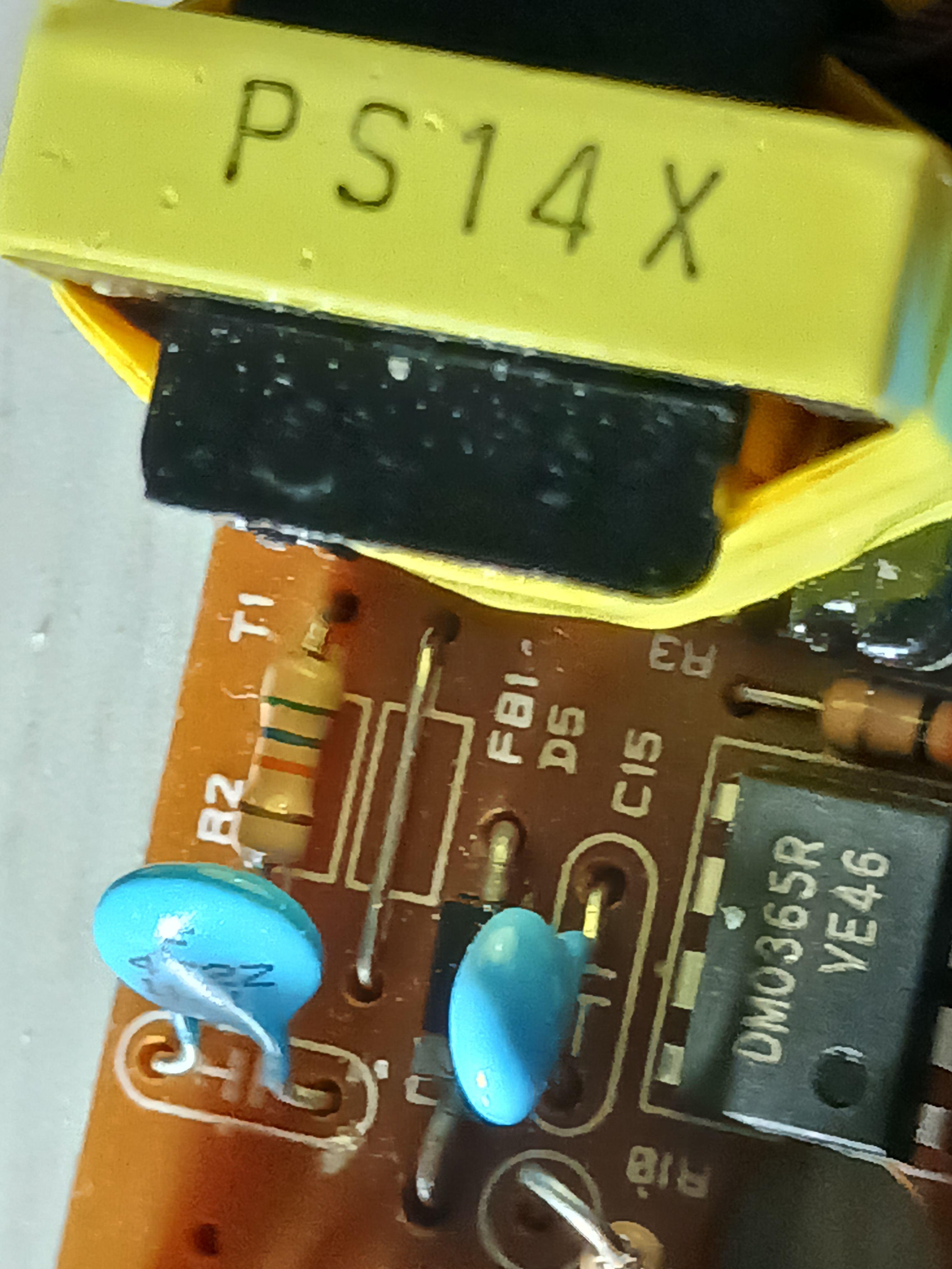

              R2 resistor is 55.06kohm and this resistor is directly connected to Vstr pin of PWM DM0365R

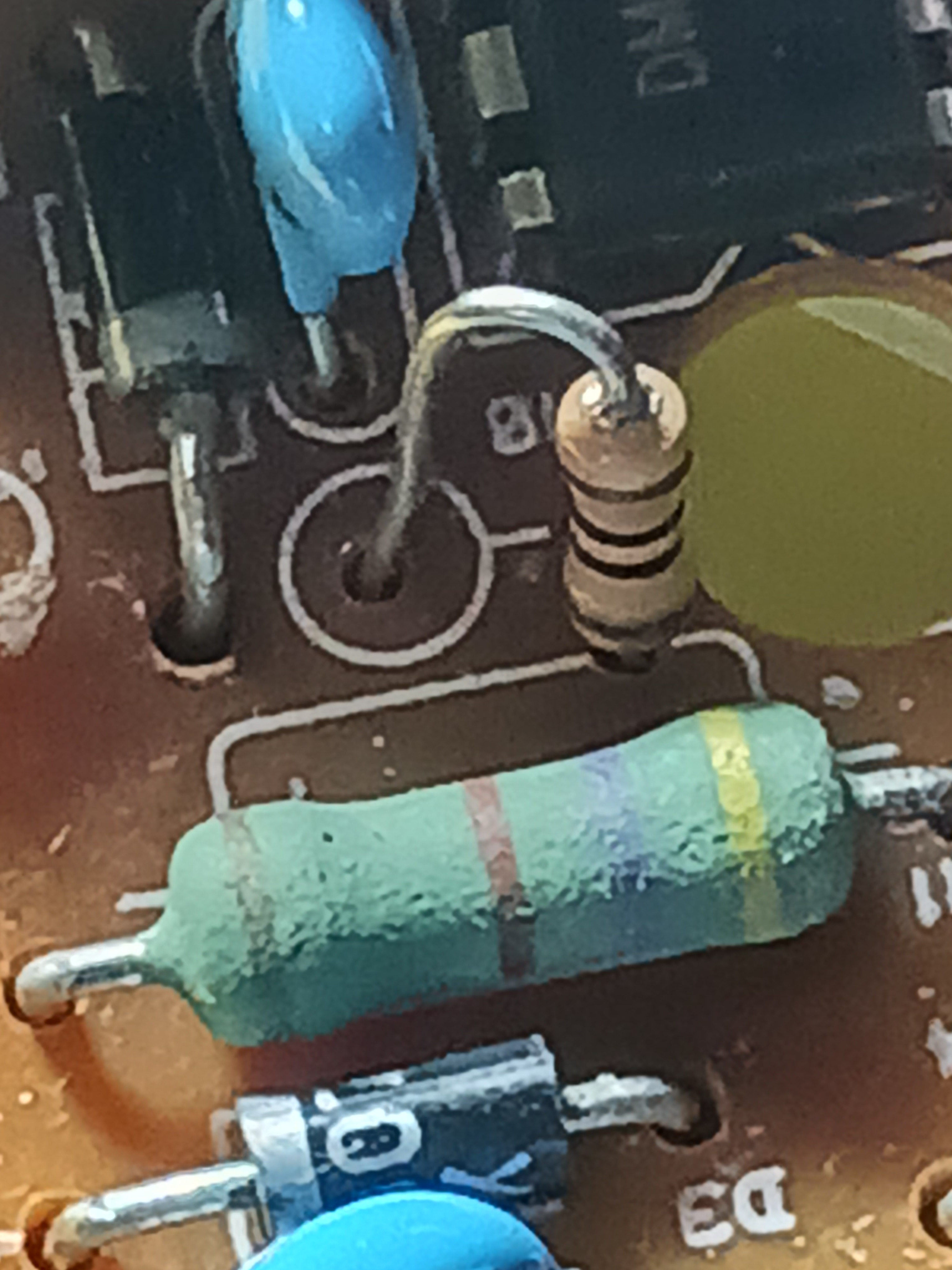

              Click image for larger version  Name:	20250619_214645.jpg Views:	0 Size:	1.27 MB ID:	3662689

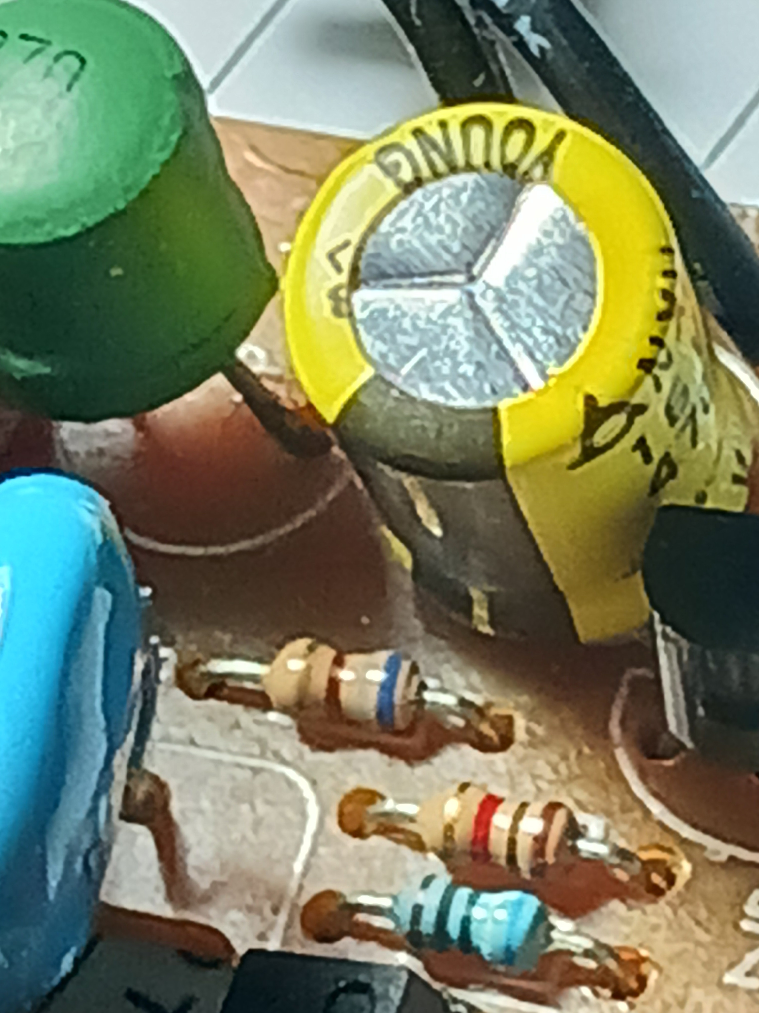

              From the top resistor,resistance is 675.2 ohm, 0.996kohm, 6.91kohm
              Click image for larger version  Name:	20250619_215555.jpg Views:	0 Size:	1.10 MB ID:	3662688
              biggest(1w) resistor is 47.12kohm and a resistor which stands vertically is 10.6 ohm
              Click image for larger version  Name:	20250619_215854.jpg Views:	0 Size:	1,010.3 KB ID:	3662699
              A resistor which placed in a row direction is 1.399kohm and other resistor which placed in a column direction is 33.7ohm.
              Click image for larger version  Name:	20250619_220405.jpg Views:	0 Size:	966.1 KB ID:	3662700
              • CapLeaker
                Leaking Member
                • Dec 2014
                • 8340
                You found your problem. VCC on pin 2 on the PWM appears then disappears. That shouldn’t be. Vcc need’s to be at least 12v for the PWM to work. If it is below a certain voltage, the PWM goes into UVLO. Read the spec sheet I posted earlier.
