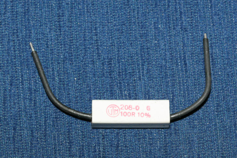

      Re: EVB ESR Meter (Bob Parker Design)
      here is the 100 ohm 5w resistor

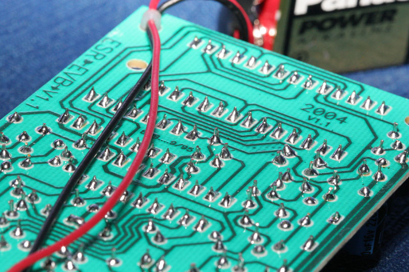

            the pcb is of quality manufacture and the soldering is fine also

              The caps are Nitai NP, Lelon REA 85oC and Jamicon TK
              Here is the microcontroller ZiLOG Z86E0412PSC 1866 running custom firmware and also the Kingbright GaAIA 7 segment led displays
              and the calibration pots
