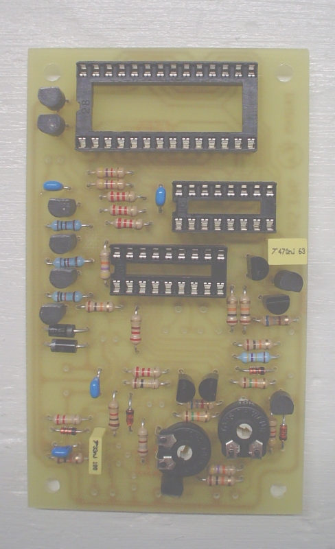

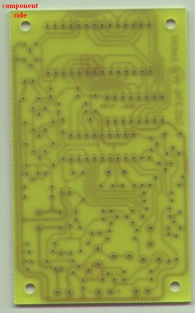

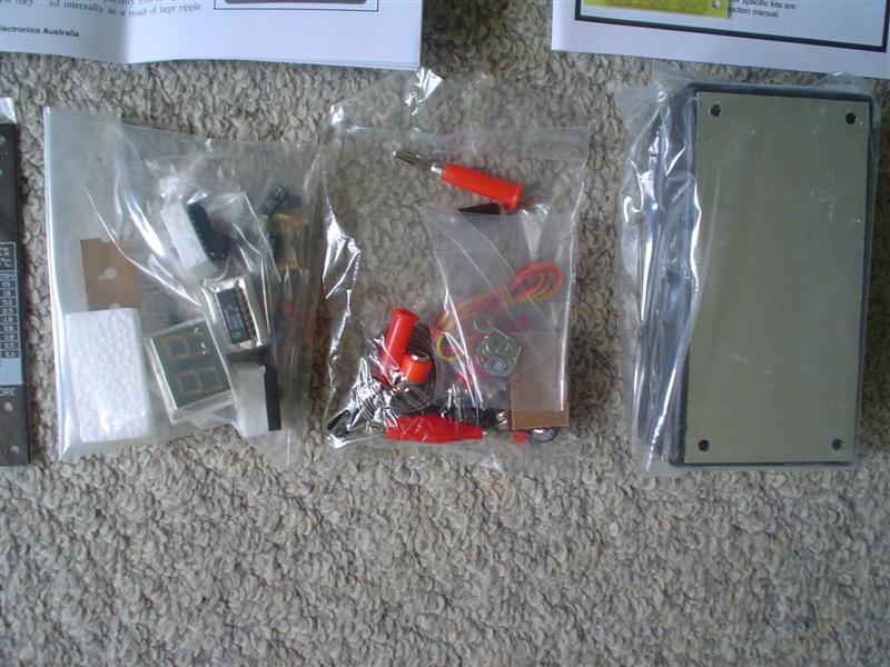

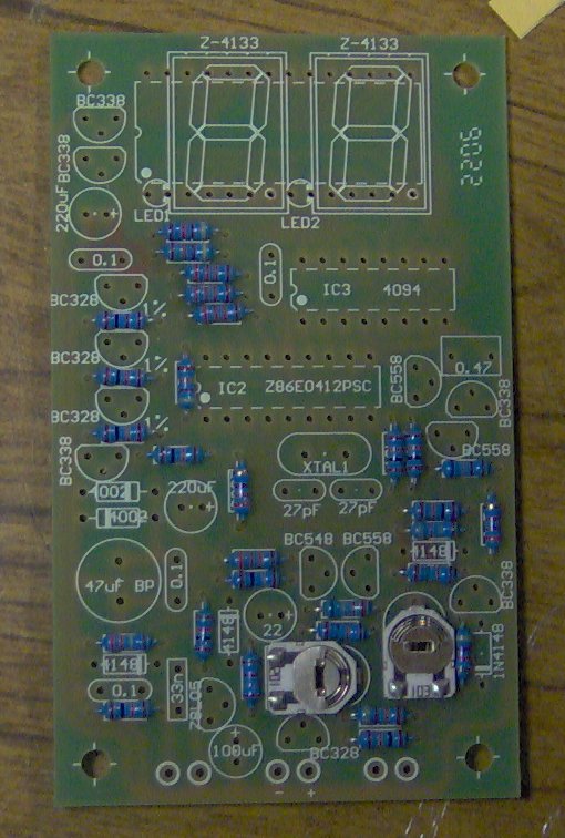

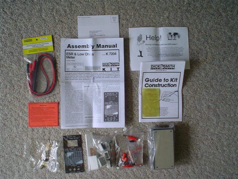

            Hi All
            Well was In DS and there was 1 of the Older
            MKI EA original production
            kits left so you guess it just could help myself.

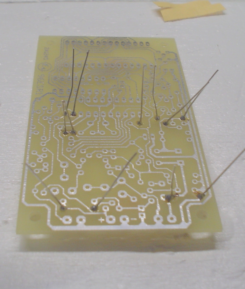

            So here a few pictures of what you get
            and some pcb close ups with no componets on it (YET)
            Again this does not have a silk screen over lay so you will have
            to be careful and double check what you put where.
            Think the Original design was 1996 if the PCB code is anything to go by.

            At this point it appears these kits may well be no longer be available.
            (seems due to lack of interest, not being a big seller)
            So your only hope maybe to buy the EVB production version now.

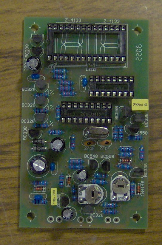

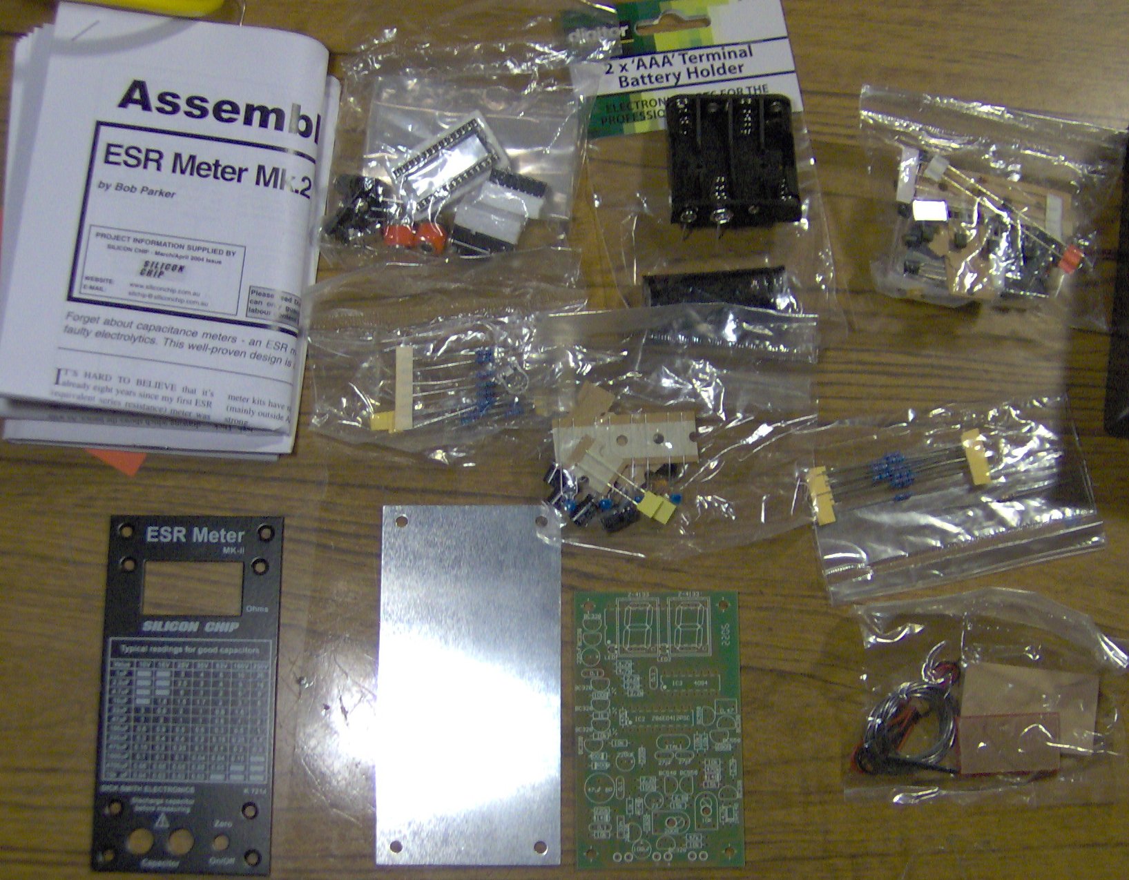

              I just got mine today! WOOT! Lots of little parts. I will show some assembly picks when I build it.

                      BTW with the MKII I build I had to put the 220 uF cap on the back of the PCB
                      Next To the two 1N4004's
                      Pads were there but no holes in the pcb I got.
                      Haven't started construction of MKI yet but will soon
                      Cheers

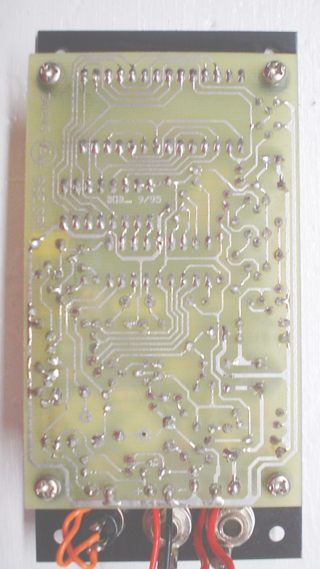

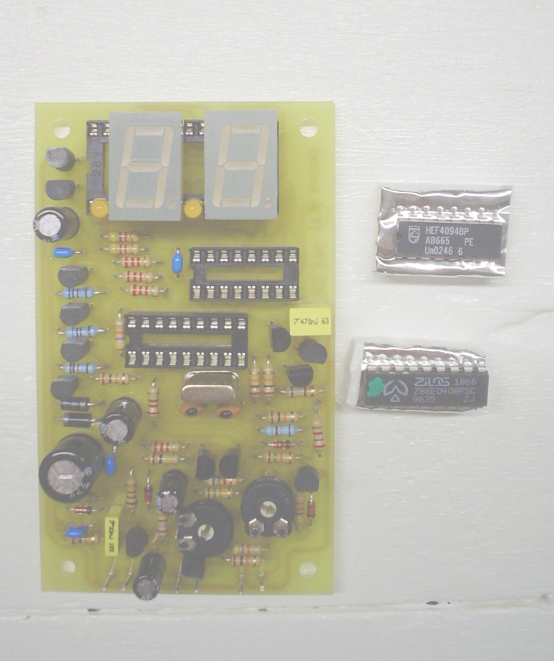

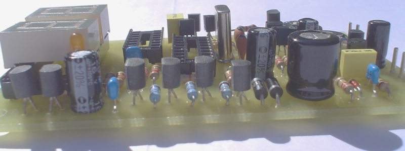

                        Hi all ok
                        Finished building the ESR Meter MKI EA Version So here are a few photos of the construction.
                        If you are building the Silicon Chip MKII Version see the photos of in my post way above.
                        Yes I made a few Boo Boo's so make sure you check your work...
                        It all working fine now
                        I highly recommend you have a Mag glass and or Jewelers loupe
                        First off I checked I had everything
                        DS forgot 1 resistor....(good thing I had one)
                        Then gave the PCB a good going over to make sure of no dags or broken tracks.
                        if you are not sure of a resistors value measure them
                        I next mounted Resistors (id start with the 1% ones) Diodes Sockets Transistors/Reg Capacitors LED's
                        IC's are left till last and thats after testing for +5V DC on correct pins of sockets.
                        These can be damaged by static so so take usual precautions with CMOS.
                        Check you work as you go along,
                        it really is very easy to make a mistake or create a solder bridge.
                        (why I scanned the PCB above, for reference)
                        A photo of both version is below too.
                        As the CMOS Cook Book says ...
                        Blame Your Self First and the IC's Last!
                        Good luck

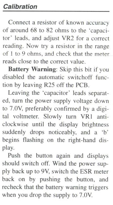

                          how did you calibrate it?
                          • starfury1
                            • May 2006
                            • 1256
                            #53
                            Re: EVB ESR Meter (Bob Parker Design)
                            Hi Willawake, All
                            It came with 2 resistors
                            (1% think they are suppose to be)
                            5R6 and 82R
                            You adjust VR2 from memory
                            (Bit of a procedure to it)

                              Further to willawakes.... question here the info from the manual.
                              Please also note:
                              The typical ESR values are different on each meter for value of capacitance, reflecting improve technology in making them from the blurb on the MKII manual.
                              So Testing and Calibration....this is much the same (if not exactly) for the MKII version.
                              For Calibrating, Battery low a DC PSU Variable would be ideal but if you haven't got one there are ways to do it without have to buy one.
                              Cheers all

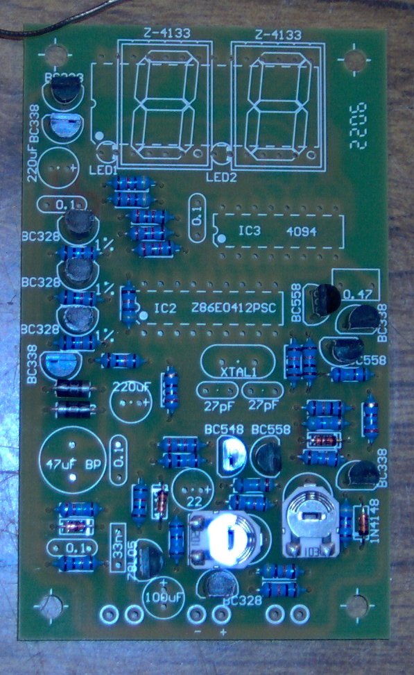

                                    #57

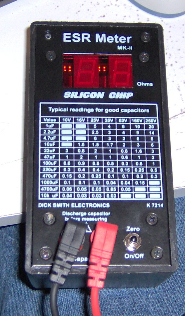

                                    I am now an owner of a WORKING ESR meter! WOOHOO!
                                    I started by making sure all the parts were there, and they were. I checked the board for bad/ missing traces, bridges, etc. I then began to install components, starting with the resistors. I found it easier to keep track by installing values that had multiples, then worked my way down to singles. I did the same for transistors
                                    When all the components were on the board, I just followed the testing procedures spelled out in the instructions. To my amazement, everything worked the first time!
                                    Calibration with the supplied resistors and instructions was fairly straight forward. This was the first device I have assembled from a kit, so I was pleased overall.
                                      Congratulation's mate
                                      WOW you got a silkscreened overlay should have make construction much easier for you so I am glad especially since this was your first kit I think you said.
                                      Yours might well have been an early production run since it appears to be 1 or 2% resistors
                                      The overlay on the PCB should help others who like me weren't lucky enough to get one.
                                      Cheers Mate, may it serve you well and save you lots of time

                                          The silkscreened overlay was one of the changes for the Mk2 version. If I understand correctly, you got the Mk1 so that wouldn't have had the silkscreen.
                                          Mine arrived a couple days ago and is now working. I spent a crazy amount of time trying to debug something that wasn't broken - the startup diagnostic just isn't as easy to use as the directions make it sound. I thought it was frozen at the "-" but it really wasn't. I also had problems with the meter turning off when I tried to zero it.
                                          My current problem is the probes. I figured out that the meter is working fine when I put pieces of wire or resistors directly into the banana plugs, but the probes produce wildly unstable readings making the meter unusable.
                                          I've decided to solder them directly to the board, but I'm trying to figure out how best to provide strain relief. I don't want the probes to get yanked off the PCB.
