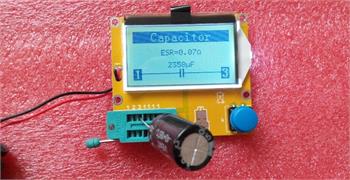

        Waait a second... Chinese ESR meter on eBay for $20?
        That meter looks like a clone of Karl-Heinz Kubbeler AVR Mega328 tester. "The accuracy of the ESR measurement is not very high by different reasons"
        More about it here http://www.eevblog.com/forum/testgea...ecker-project/
        I know the Anatek Blue ESR goes for ~$100 (kinda expensive), but it does in-circuit testing and uses higher test currents 50mA/150kHz and seems proven by many people.
        I was going to order one, unless Badcaps wants to make their own...

          the chinese / german one may be less accurate, but it is good enough for a good/bad test and it does other things.
          i dont believe in "in-circuit" testing because of parallel loads.
