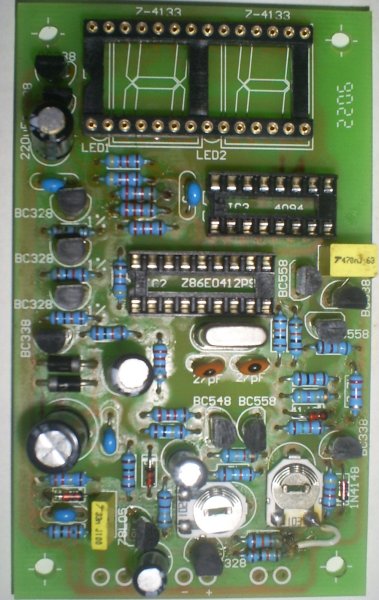

      Yes gdement you are right re the silkscreen being a mod for MKII according to info
      Sorry to hear of your drama's
      I have Both MKI MKII
      The MKII I bought first few months ago see pics on page 2 its is marked as the MKII version PCB (10/03)
      I think I got a dud cause it didn't have holes for the 220 uF Cap either
      (I had to mount it on the back)

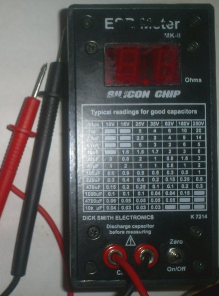

                        on the bananna jack issues.
                        i retension the plug(male) and apply deoxit.
                        radioshack discontinued the pens and i loaded up on them.
                        i find most of the inaccuracy reported in this unit is high contact resistance in test leads and jack/plug.
                        all 6 of mine have been excellent.
                        care must be taken during calibration though.

                            My meter is all closed up now and works fine. These little single-layer boards seem to give me trouble - I burned some of the pads and had to patch them with wire. I've only soldered on a little board like this once before, and that was on one of those generic Radio Shack PCB's you can buy for $1.79. It's been long enough since then that I was out of practice (not that I got much practice even then).
                            Kind of embarrassing to show all my mistakes, but maybe I hit some caveats that others may benefit from reading.
                            I'm disappointed with the flaws, but I always have to do something 2-3 times before I get it right. If I were to build one of these again it would come out better I'm sure.
                            I noticed about 3 or 4 ruined pads along the way, and repaired them with wire.
                            I used a machine pin socket on the 28-pin, but only because I happened to have one. I wanted to use machined 16 and 18-pin sockets for the IC's, but I didn't have the right sizes.
                            I used a HeathKit variable DC power supply which I recently bought from a Goodwill store (lucky find). It has a built in ammeter so that was convenient for the first test. Unfortunately, it also has a built in current limiter, and in my inexperience I had it set too low. My first attempts to start the meter showed no current draw and nonexistent IC voltages, so I started tracing the circuit to find the problem. There wasn't one - after I tried raising the limit it started right up. Voltages were fine, so I installed the chips.
                            At this point I didn't have the button connected yet, so I was holding the wires together to start the diagnostic. It didn't seem to work, so again I started tracing the circuit. Turns out the diagnostic won't run unless you hold the button on the FIRST try. After that it won't enter diag mode. Since I wasn't holding the wires together perfectly enough, it looked like the diagnostic wasn't running but I eventually realized it worked fine. I got the expected .8.8 result. I see no reason why the diagnostic shouldn't work on subsequent attempts to hold the button - that's one change I'd suggest if Mr. Parker ever decides to reprogram it.
                            Fast forward a bit, I was starting to play with the probes and noticed how hard it was to get a stable reading. The meter shut off whenever I tried to zero it, because the resistance was too high. The jacks were fine though, as the meter worked very well with items stuck into the jacks directly. I ended up soldering directly to the PCB, but I'm not sure that made much difference. I've found that I just have to squeeze the probes against each other pretty hard before zeroing them. When I measure a cap, I get good readings as long as I stab the probes into the solder with some pressure. That's understandable considering the fine measurements involved.
                            As far as strain relief (which I mentioned in my earlier post), I ended up not doing much about it. At first I tried tying the wires in a knot behind the panel, but there wasn't really enough room to squeeze that in. I accidentally wrapped one wire around the other when I soldered them, so they are somewhat crossed on each other anyhow. They seem to snag on each other more than the PCB, so I'm not worried unless the probes get yanked pretty hard.
                            My final error (last one, I promise) was with the red filter installation. I used superglue to install it, and it started to squeeze out on the top cover. I grabbed the first thing I could find to wipe up the mess before it dried, and that thing was alcohol. It wiped out the cover markings pretty easily, so I now have a "E--__ter". Oh well, it works just the same no matter how it looks. I've already diagnosed bad surface mount caps on a board that I otherwise would have only been able to guess about. Great tool.

                                    All is well! I tweaked the tension inthe plugs, wire brushed the plugs ans tips, and cleaned it all with brake cleaner. Worke perfect.
