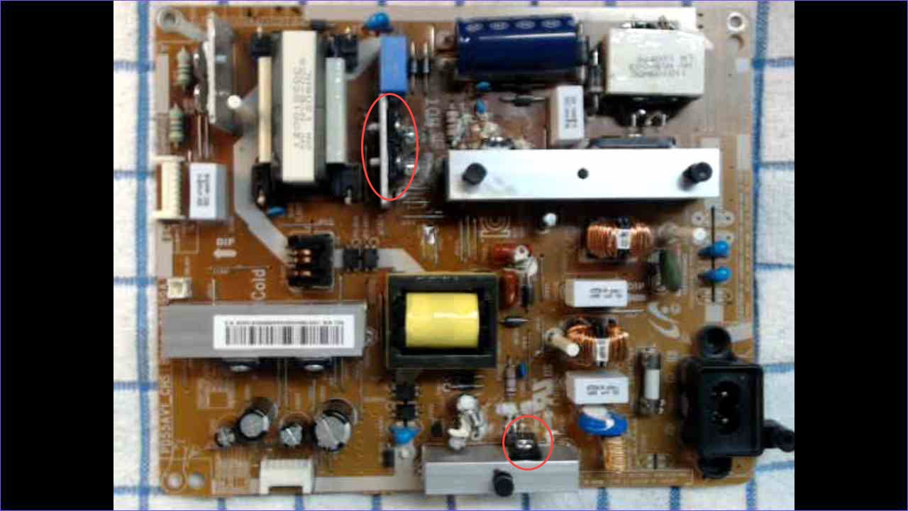

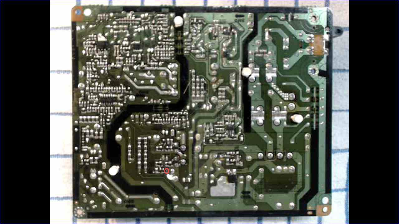

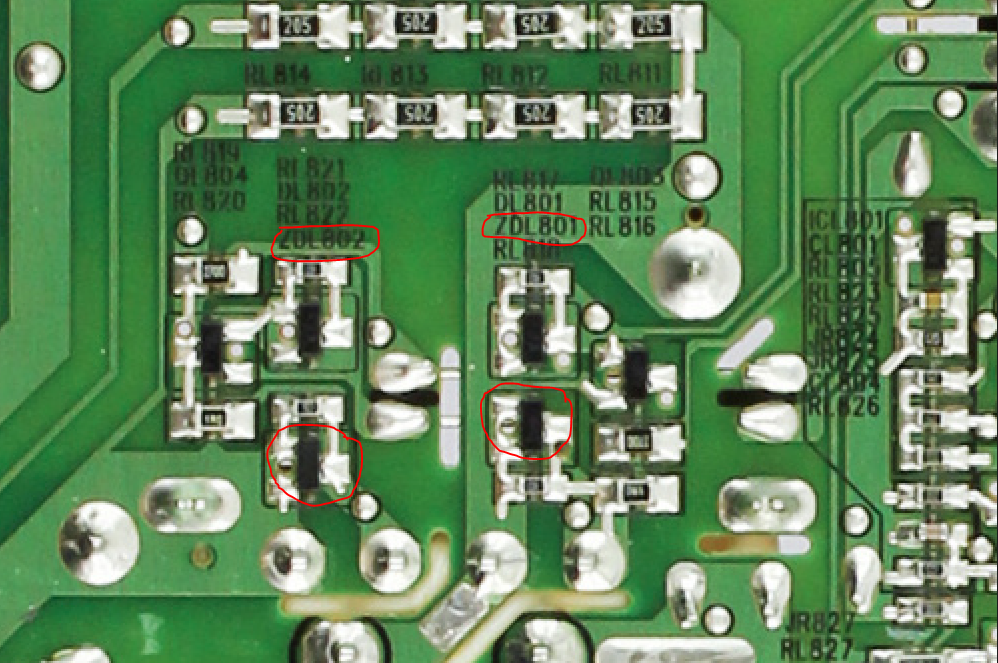

    I got in a Samsung UN55EH6000F with no power and blown fuse on the board (BN44-00499A) I found 3 bad mosfets and a blown resistor circled in the pictures. Now just putting power to the board and checking voltages I get what I need 13v then goes off and on over and over. I connected to TV and TV powers on with sound then off over and over again. I did not include pics of the TV since it is in the power board. So what would cause it to power on and off repeatedly? ?

    Re: Samsung UN55EH6000F Power issue
    Check all the diodes and touch up any solder joints that look odd.
        That looks like a gate drive resistor, I would check the zener diodes and the other resistors in that drive circuit.
        One of the components you have circled is the standby ic, was it replaced as well?
          Originally posted by CraigR
          Yep, went through all that before posting.
          At least a few still look cracked to me.
            Yes, it was replaced also.

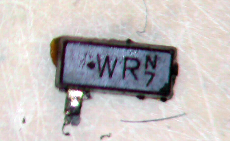

              I found this mosfet (2 legs gone now) with nothing going threw it compared to other one with same number. Anybody know how I can get a good number to get another? WR N7 not coming up with anything on google.
                What is the board location?
                  Looks to be an NPN. If it is sot-23
                  WR 2PD602R Si-npn GP, Sw, 60V, 500mA, 250mW, B=120..240, >160MHz SOT-23
                  If you have a component tester, just remove the other one and check it.
                    • CraigR
                      • Dec 2013
                      • 959
                      Might be 2SK322WR What is the board location?
                      ZDL802 so must be zener diode and not a mosfet? the N made me think N channel?
                        Bzx84c24-au
                        • R_J
                          • Jun 2012
                          • 9535
                          That looks correct, let me guess, they are in the gate circuit.
                            in the gate circuit
                            • CraigR
                              • Dec 2013
                              • 959
                              Yep. Thanks for the number! I will order some up and get back with how it goes.
