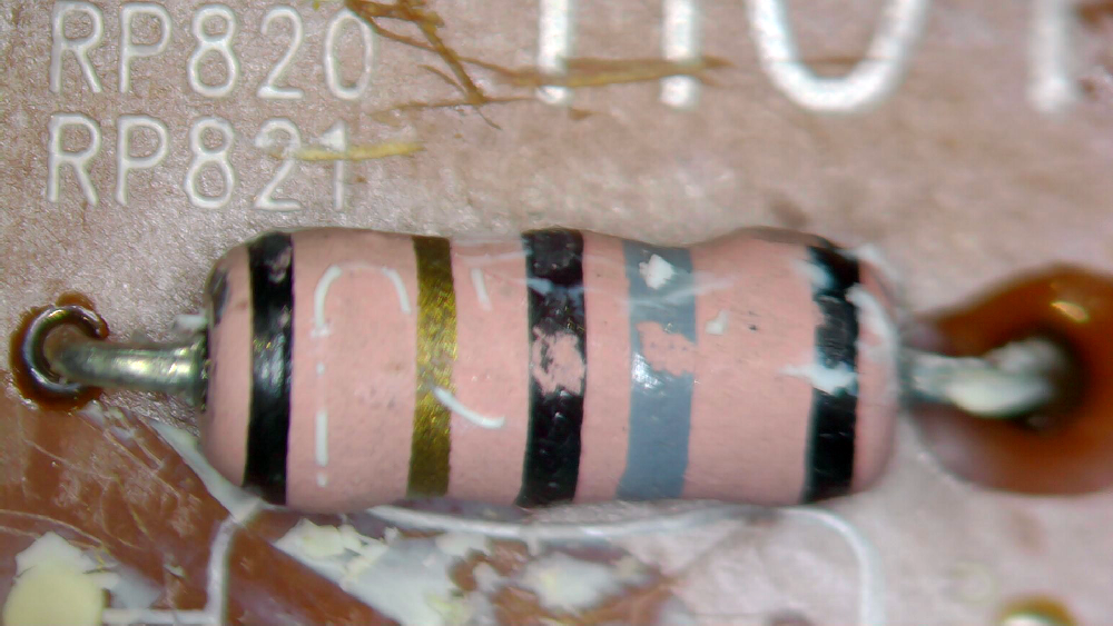

            I'm now just guessing at things and tested this resistor RP820 and out of circuit it's 0.11 but I can not find a chart online that the colors work with. Under the scope it looks black, gold, black, gray, black. but this comes as an error on the calculators.
                The resistor is ok. That is the source resistor for the pfc mosfet.
