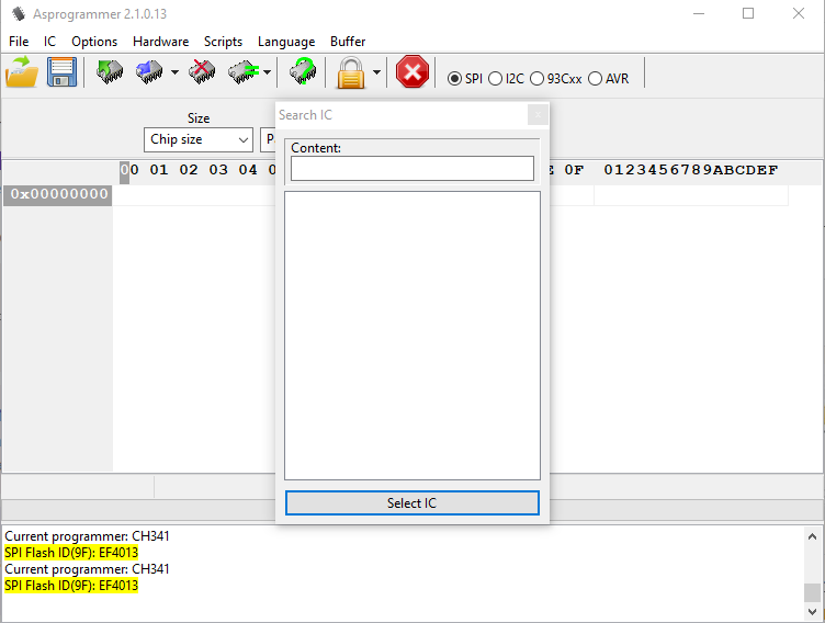

      asprogrammer tells me "access violation Press ok to ignore and risk data corruption.press Abort to kill the program." when i push detect ic button.
      Now even the original main has stopped working, do you have the file to reprogram it?

          I'm trying with Asprogrammer to detect my chip but the list is empty

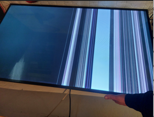

            The file I had saved after reading the 25Q80DV of the MU6120 is the same as the one you gave me,
            Now the TV looks like this with both boards
            • dani.m
              • Nov 2023
              • 12
              • italy
              #346

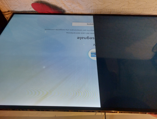

              Re: Samsung ue49mu6120
              Trying with the original board (MU6120) and detaching the upper flat I managed to get half the image right, if I detach the lower flat you can see the other half
