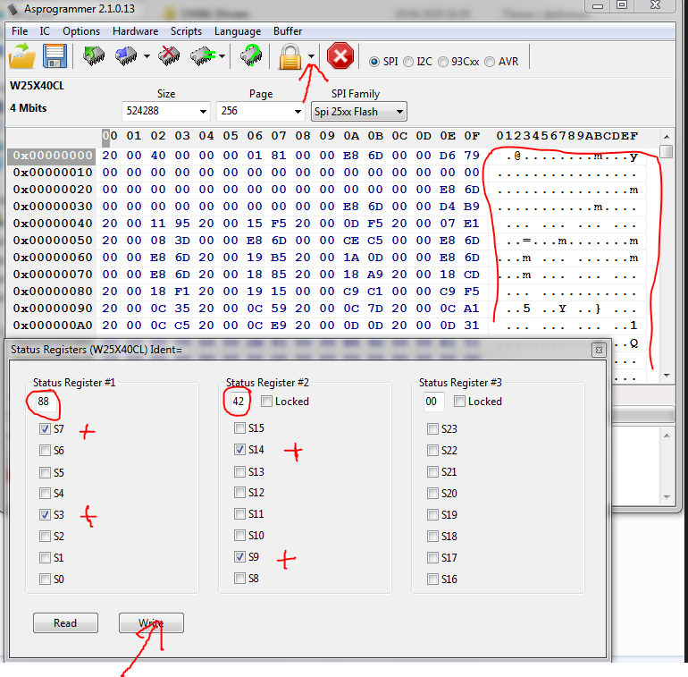

    caricando il file allegato cambia stato rimane con lo standby a ma non si accende sai dirmi perche' ?
    Was it his native dump, or after recording another dump that you found on the Internet, did you install and write status register 0x88, 0x42 after recording?

              ue40mu6400uxzt
              let's say Lotas the original file was the one nicknamed "dump" and it's the one you modified for me .... instead the second is a file that a user from my country sent me which returns the stanby led
              • lotas
                • Jan 2016
                • 4753
                • Russia
                #247
                Re: ue40mu6400uxzt
                If it was his native dump, then I fixed it for you and everything should work, if you messed up something with dumps and the software version does not match the eMMC software version, then the standby mode will appear, and the TV itself will not turn on, you installed after recording and wrote status register 0x88, 0x42?
                  sorry for my ignorance I don't know how to write the status register...... is it possible that every TV, even the same model, has different dumps? in the event that the 25q40 breaks and the original dump cannot be recovered, how to do it?

                    #249
                    Re: Samsung ue49mu6120
                    In these models of the "MU" series, it does not matter what diagonal, what model number, the software version is important here and it must match for SPI Flash and eMMC!
                    The Status Register must be installed and written after writing the dump, there are a lot of topics where I explained everything how to do it correctly, what program do you use when writing the dump?
                            hello lotas i can't write to the memory anymore ... it doesn't even work erase why ? it says "unprotect ? " but then it doesn't unlock it
                            • lotas
                              • Jan 2016
                              • 4753
                              • Russia
                              #254
                              Programming instructions with the AsProgrammer program.
                              In the program:
                              1. Click "Detect Chip" and select W25Q40CL and "Select IC".
                              2. Click "Unprotect".
                              3. Click "Clear IC" and "Yes".
                              4. Click "Open File" and select your corrected dump.
                              5. Press "Program IC" and "Yes".
                              6. Click "Verify IC".
                              7. Press the down arrow to the right of "Unprotect" and select "SREG Edit", put a check mark on SRP0, BP1, CMP, QE and press "Write" and "Yes"
                              7. Close the program. Ready.
                                thanks for the guide ....... I don't know why but I can only read and do nothing else ........ before it stopped working it didn't let me tick "QE"....
                                      thanks ..... solved with the first dump where I followed the programming step by step edited the file fi register except the QE which did not make me tick .... so I only ticked SRP0, BP1, CMP, ... .. and it worked...... thanks thanks thanks ....... you are number one !!!!
                                        however in the end I left the 25x40 chip instead of the 25q40......
                                        • lotas
                                          • Jan 2016
                                          • 4753
                                          • Russia
                                          #260
                                          25"Q"40 - has QE (Interface: Quad SPI)
