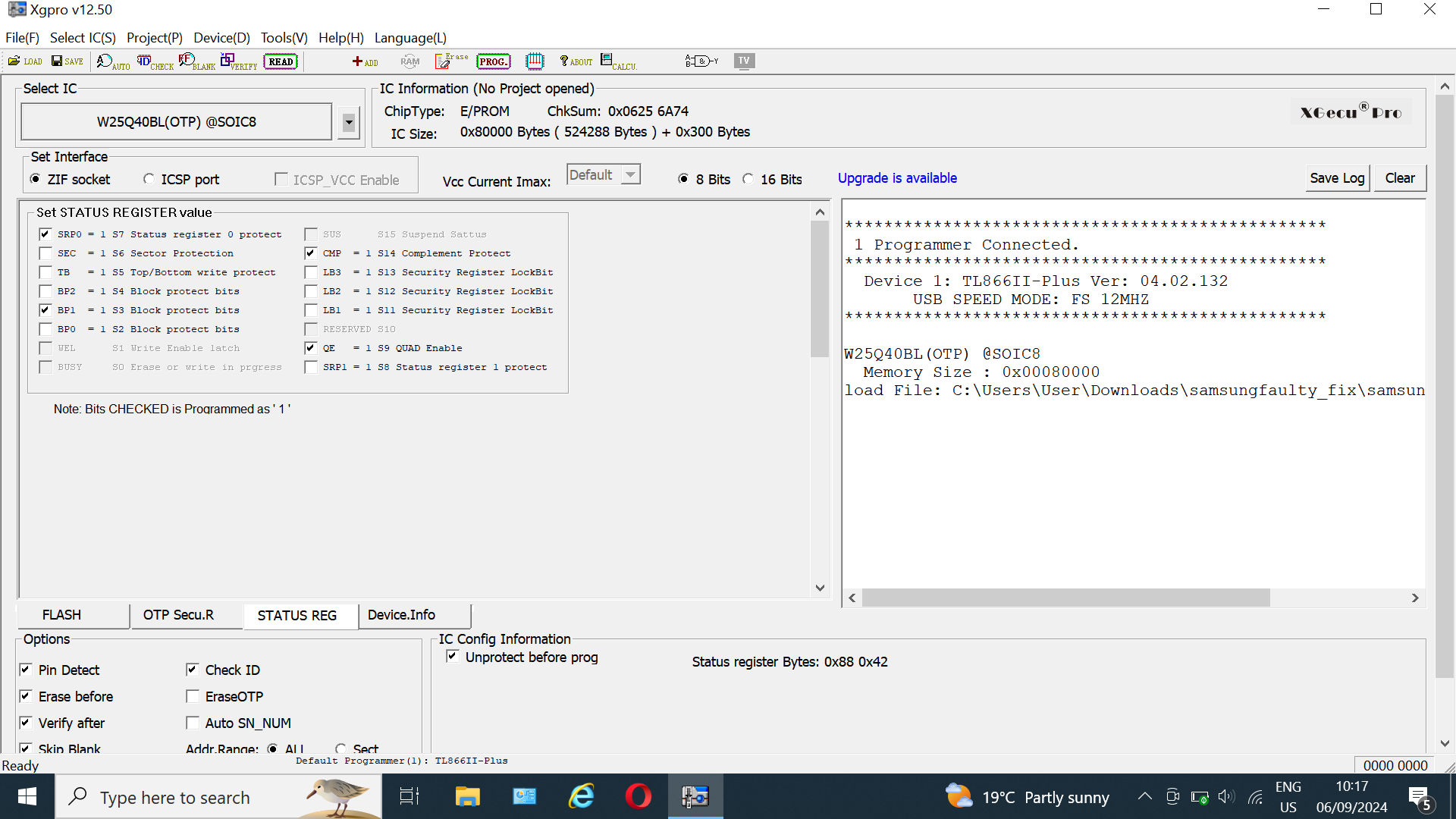

                              #554
                              Originally posted by jaypay15
                              I am not sure what to try next.
                              Write down in detail how you did everything, how you recorded it, what you set in the program, what program you used, and read and post the dump from the chip that you have already recorded...
                              • jaypay15
                                • Aug 2024
                                • 6
                                • uk
                                #555
                                I have just realised my mistake . I loaded the .rar file instead of the extracted one🙄. More haste less speed ,I will try again later.

                                  #556
                                  Sadly, the firmware file must have a .bin extension.
                                  • jaypay15
                                    • Aug 2024
                                    • 6
                                    • uk
                                    #557
                                    Success , Many thanks Lotas. I feel a bit of an idiot for not noticing my mistake. settings attached
                                    • lotas
                                      • Jan 2016
                                      • 4752
                                      • Russia
                                      #558
                                      Yes, they are set correctly and they need to be written to the chip, this is done after recording the dump.
                                      Status register: 1
                                      S7 (SRP0)
                                      S3 (BP1)
                                      Status register: 2
                                      S14 (CMP)
                                      S9 (QE)
