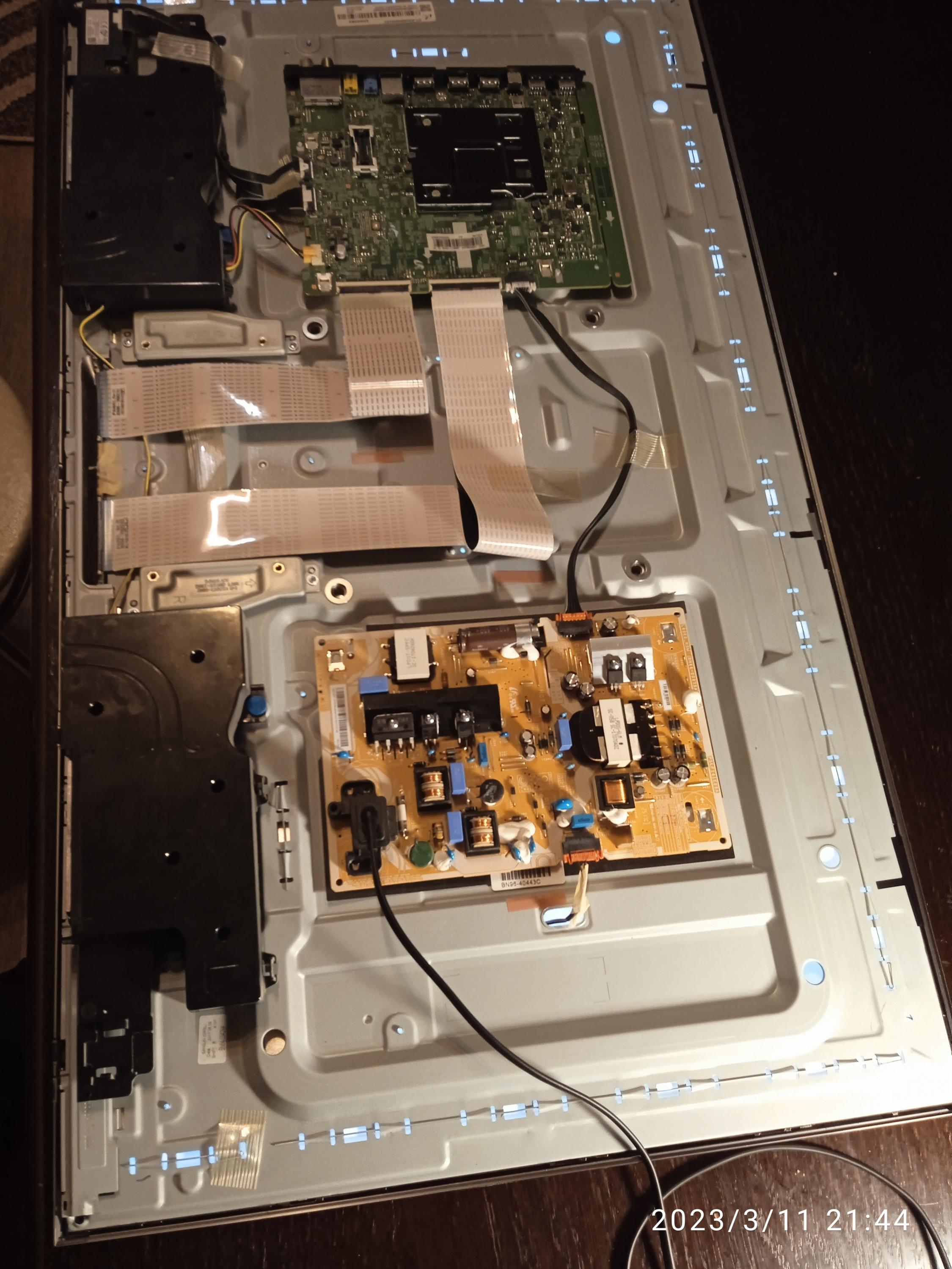

                #207
                Re: Samsung ue49mu6120
                the tv makes the logo and turns off and i thought it was a firmware problem

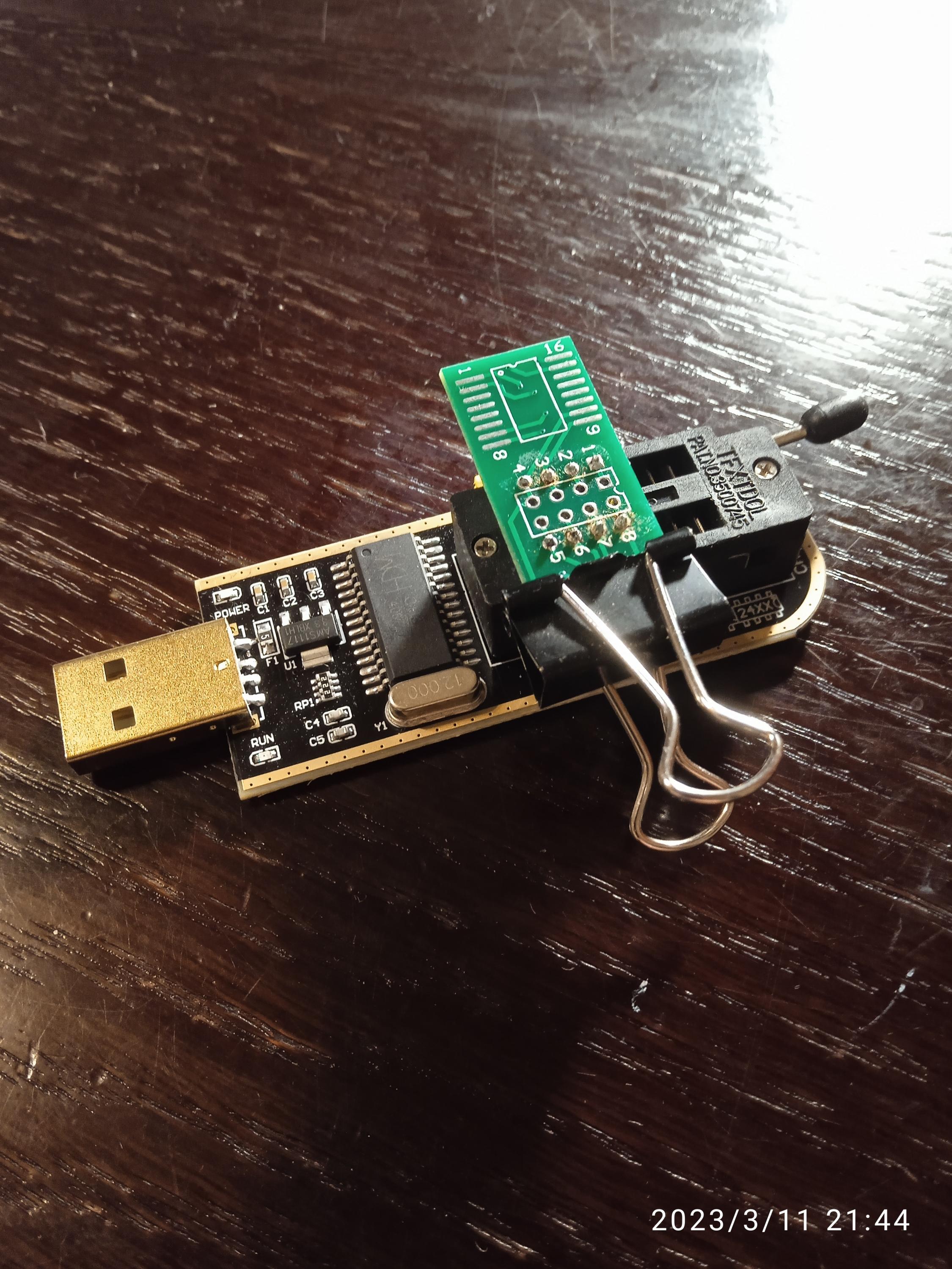

                  If the firmware in 25Q40 deteriorates, then the TV does not show signs of life at all, even the standby LED does not light up.

                            #213
                            Originally posted by Davi.p
                            it turns really off or it reboots? Does it stops and makes a led blinking? how are them?
                            how do i connect the tv to the current the samsung logo comes out and comes off and remains only with the backlight on it doesn't go off but if i press on the keys the led flashes as it normally does when you give a command

                              The problem may be in the T-con firmware (25Q80).

                                  You can't check such a dump, you need to look for a known working one, just for your panel.
                                  What is the exact model (number) of the panel?
                                  Post yours just in case.

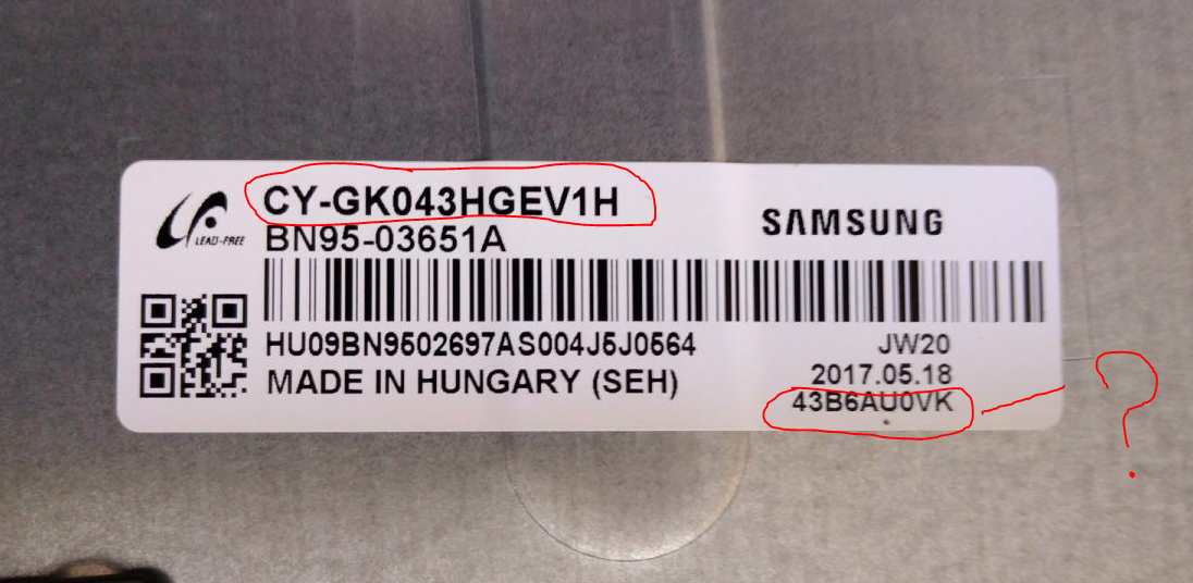

                                    CY-GK043HGEV1H this right?
                                    • lotas
                                      • Jan 2016
                                      • 4468
                                      • Russia
                                      #218
                                      Yes, and one more number is needed and put your dump 25q80 here.

                                        the additional number is 43B6AU0VK and I have attached the dump of 25q80
