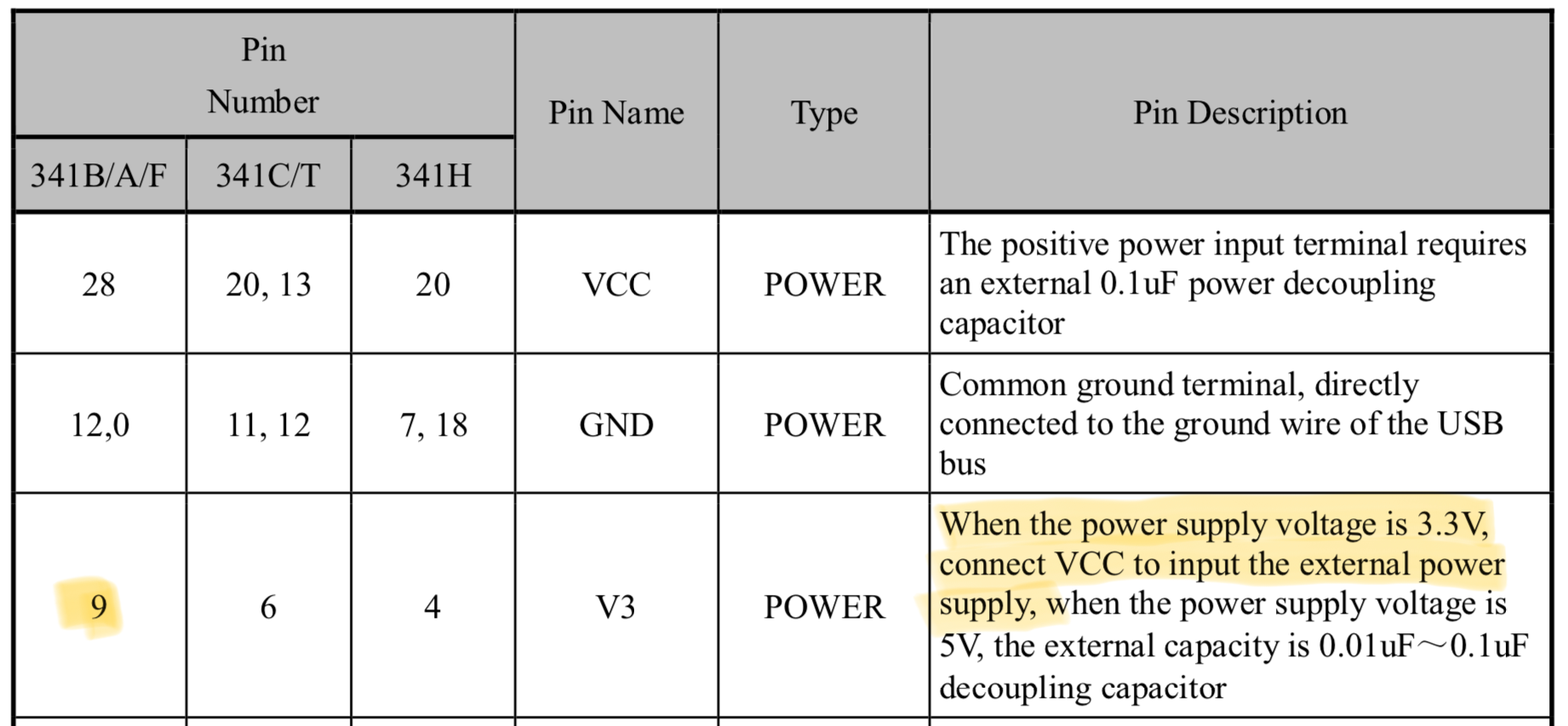

                            I noticed that pins 3 and 7 (WP and /HOLD) are tied directly to 3.3V on my CH341 Pro which is not recommended according to the extract from the datasheet below.

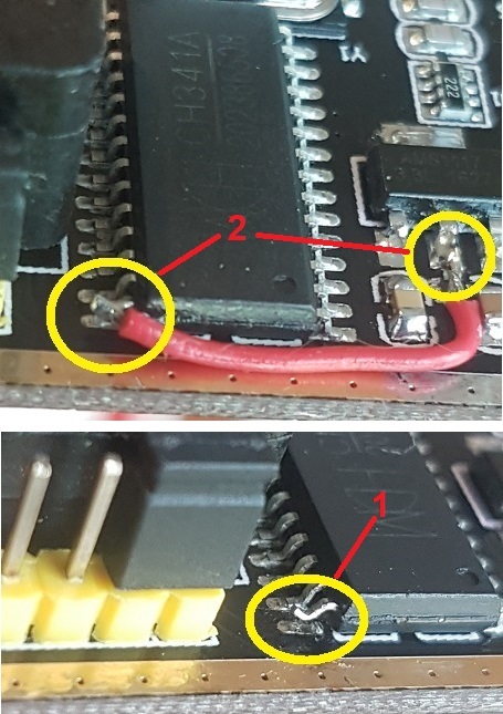

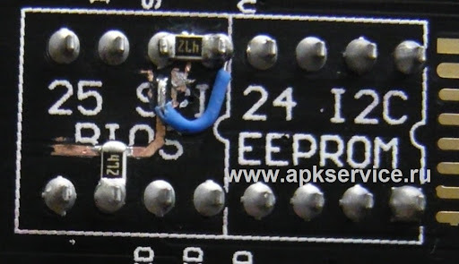

                              Yes, this programmer needs improvement, if it is black, then two improvements.

                                Thanks Iotas. It seems I have a CH341 β€œpro” with a CH341B IC that looks the same as the normal black programmer but with a different board layout from yours. It too is putting out 5V on the data lines. I’m surprised that this has not been designed out in newer programmers. I’ll need to remove the ZIF socket to see where the traces go on mine as they are very different.

                                  Mod 3.3V

                                    Thank you Iotas. I will make that mod. The CH341 datasheet says to connect pin 9 to VCC (3V) when it’s set to 3volts so I will give that a go. Thanks again for your kind assistance.
