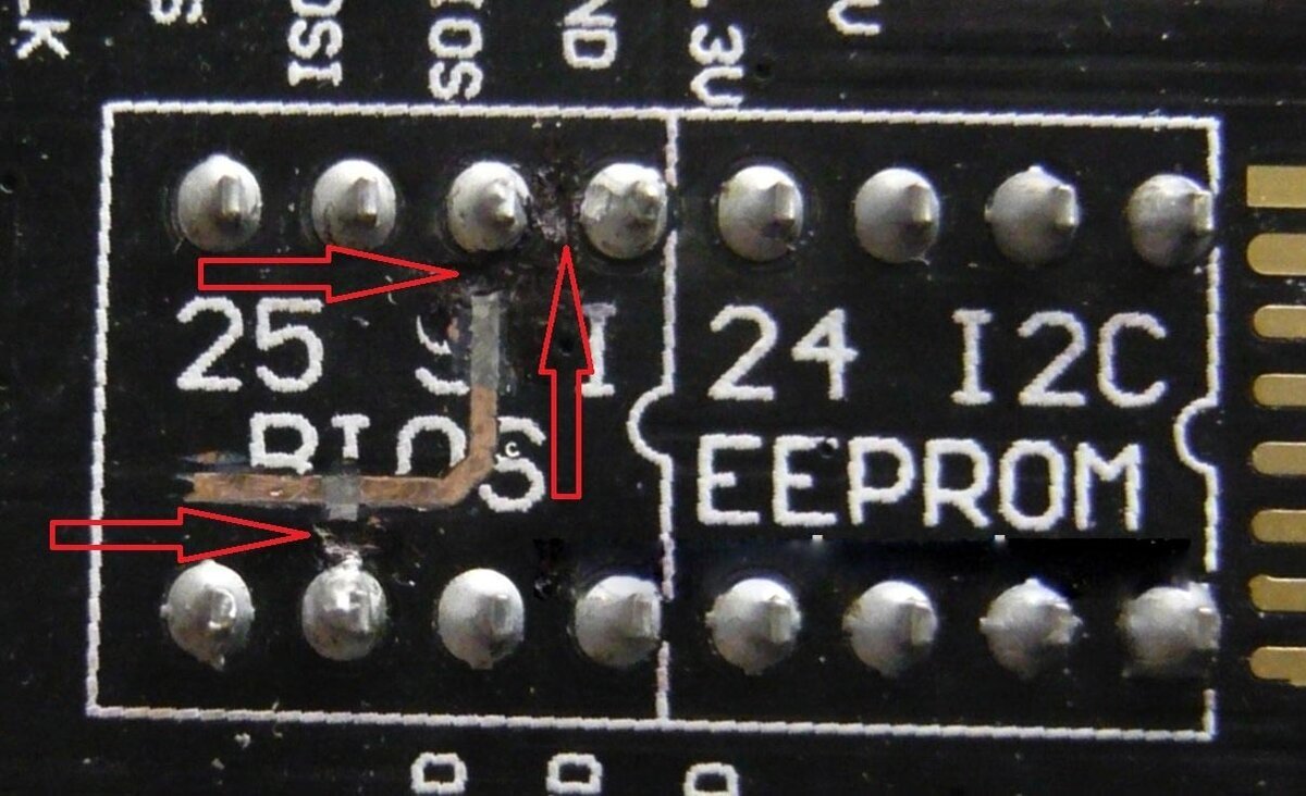

    Hi lotas I don't want to interfere in something that I don't understand but I'm being confounded because you saying in post 442 that you have to make a change on CH341A and I've seen on Youtube Sorin (Electronic repair school) prove that you don't need to make any change at all because there is no high ampere that can destroy any component.I would like to understand to learn and i see that you know what you are talking about . explain to me please

      Originally posted by lotas
      Open the datasheet on CH341A and look at 9 pin if you switch to 3v power supply. In the circuit for modification, there is no need to remove the capacitors, but replace them with tantalum of higher capacity.
      https://4pda.to/forum/index.php?show...st&p=125980884
      lotas i know you related to documents when you advice... but what i have no need to change at all.... the early version of this programmer as the diagram you posted yes nut now days no more in the market.... just the new version black one.
          Diah yes, I’m not forcing anyone here to remake this “programmer”, let everyone decide for themselves and do it at their own peril and risk, I don’t use it at all, I have more expensive programmers that I trust (UFPI, RT809F,H, Nand ProMan, TL866CS, TL866 II Plus, Xeltek SuperPro 3000U, 611S, Z3x easy jtag...)

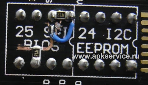

                  I have ordered the tantalum capacitors and the 4.7 Khom resistors.
                  In post n. 455 you refer to a link where however in the schematic I do not see the two 4.7 Khom resistors.
                  Please suggest what to do? I am not able to make up my own mind.

                    Yes, resistors must be placed in the gap between the tracks.

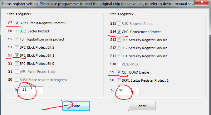

                          Status register 0x42 should be in the second, that is, 0x88, 0x42.

                                ok. Are tantalum capacitors 4.7 uf at 10 volts and 22 uf at 10 volts okay ?
                                Is the voltage at 10 volts okay?​
                                • lotas
                                  • Jan 2016
                                  • 4753
                                  • Russia
                                  #476
                                  Of course, the maximum usb voltage is 5v, just install the capacitors correctly (they have + and - polarities).

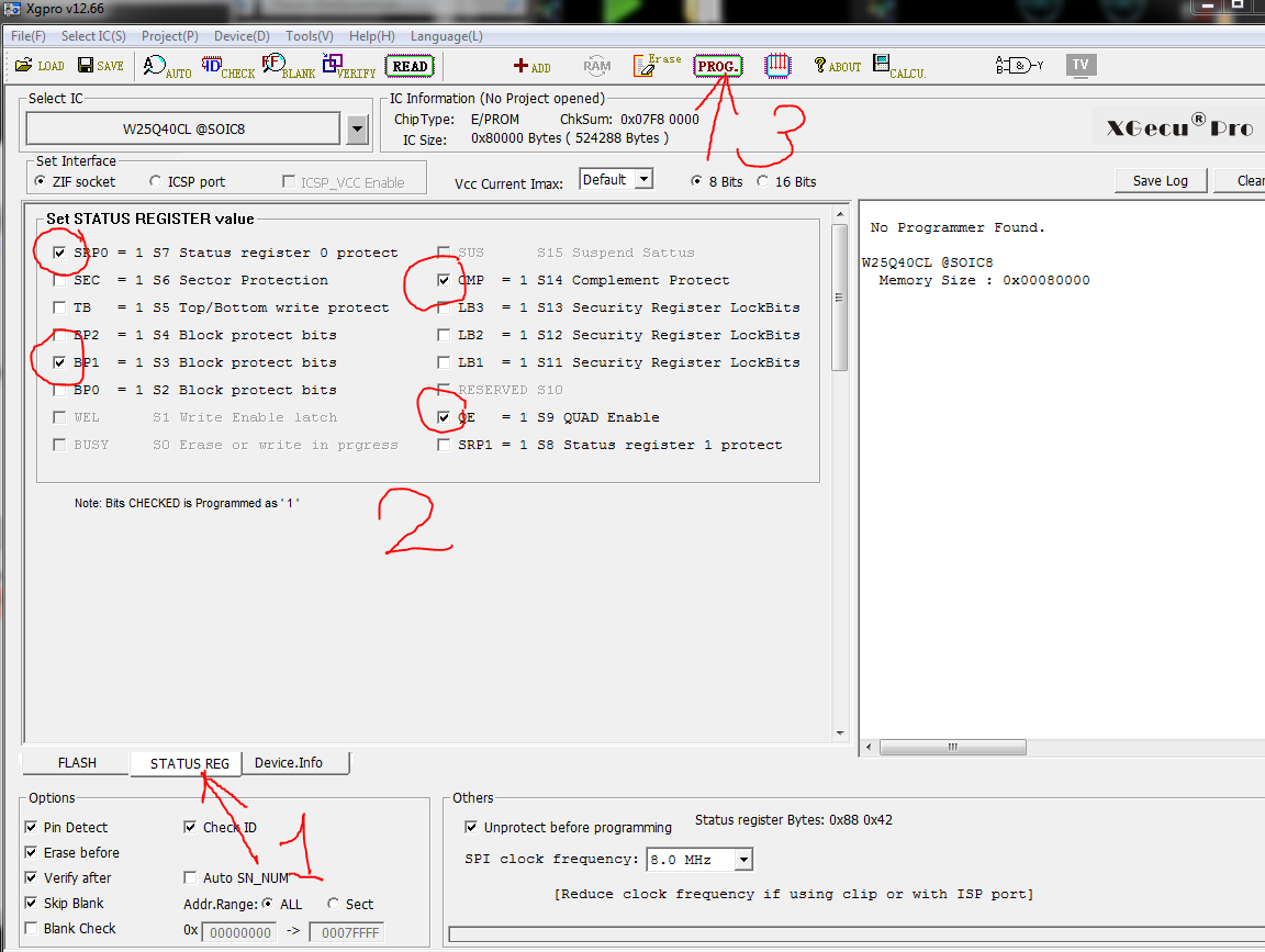

                                      iotas my goodfriend i want your help one more time and for xgecu how to put protect mode?
                                      • lotas
                                        • Jan 2016
                                        • 4753
                                        • Russia
                                        #479
                                        This dump is working, and the status register is like in the photo.
