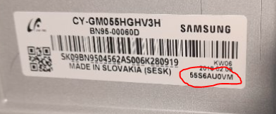

                        #331
                        Re: Samsung ue49mu6120
                        Hello, I would like to replace the main of a UE55MU6120KXZT with a MAIN of a UE55MU6199UXZG to have the SAT input as well, is it possible?thanks
                        • dani.m
                          • Nov 2023
                          • 12
                          • italy
                          #332
                          If needed, the panel codes are CY-GM055HGHV3H
                          SK09BN9504562AS004JBX0938 JW48
                          2017.11.29 55S6AUVM
                          I already have the CH341A pen and I have already saved the various files
                          • lotas
                            • Jan 2016
                            • 4753
                            • Russia
                            #333
                            If their panels are different, then you will probably have to transfer dump 25Q80 from the original board to the new one.

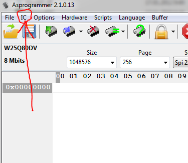

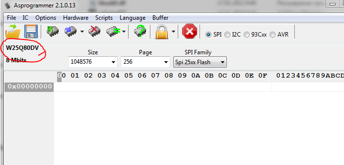

                                  • dani.m
                                    • Nov 2023
                                    • 12
                                    • italy
                                    #337
                                    I can't enter service mode, because the screen is unusable with the UE55MU6199 board
                                    the file in the 25q80DV I should have written it in the right way, the only doubt is the list of chips present in neoprogrammer that gives me available a 25q80"BV"and not DV as in my board
                                    • lotas
                                      • Jan 2016
                                      • 4753
                                      • Russia
                                      #338
                                      Download the AsProgrammer program, your flash is there.
                                      • dani.m
                                        • Nov 2023
                                        • 12
                                        • italy
                                        #339
                                        Excuse my ignorance,but I can't find the "detect" button in asprogrammer
                                        • lotas
                                          • Jan 2016
                                          • 4753
                                          • Russia
                                          #340
                                          “detect” what, where? What are you writing about, what button?
                                          1. - IC.
                                          2. - SPI.
                                          3.- WINBOND.
                                          4. - W25Q80DV.
