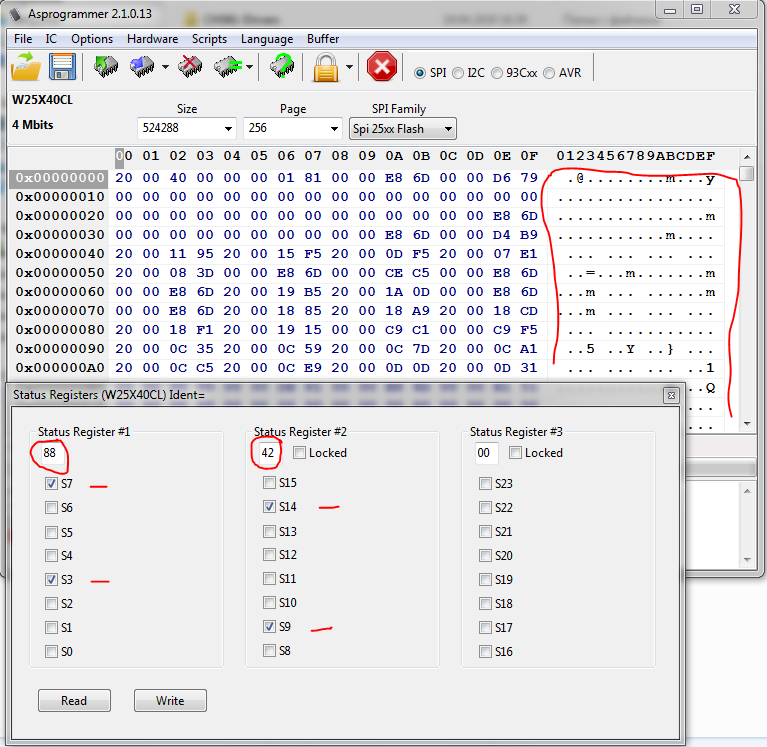

                                  Re: Samsung ue49mu6120
                                  Yes, write this corrected dump to the same chip, use this instruction when writing.
                                  https://www.badcaps.net/forum/showpo...3&postcount=29

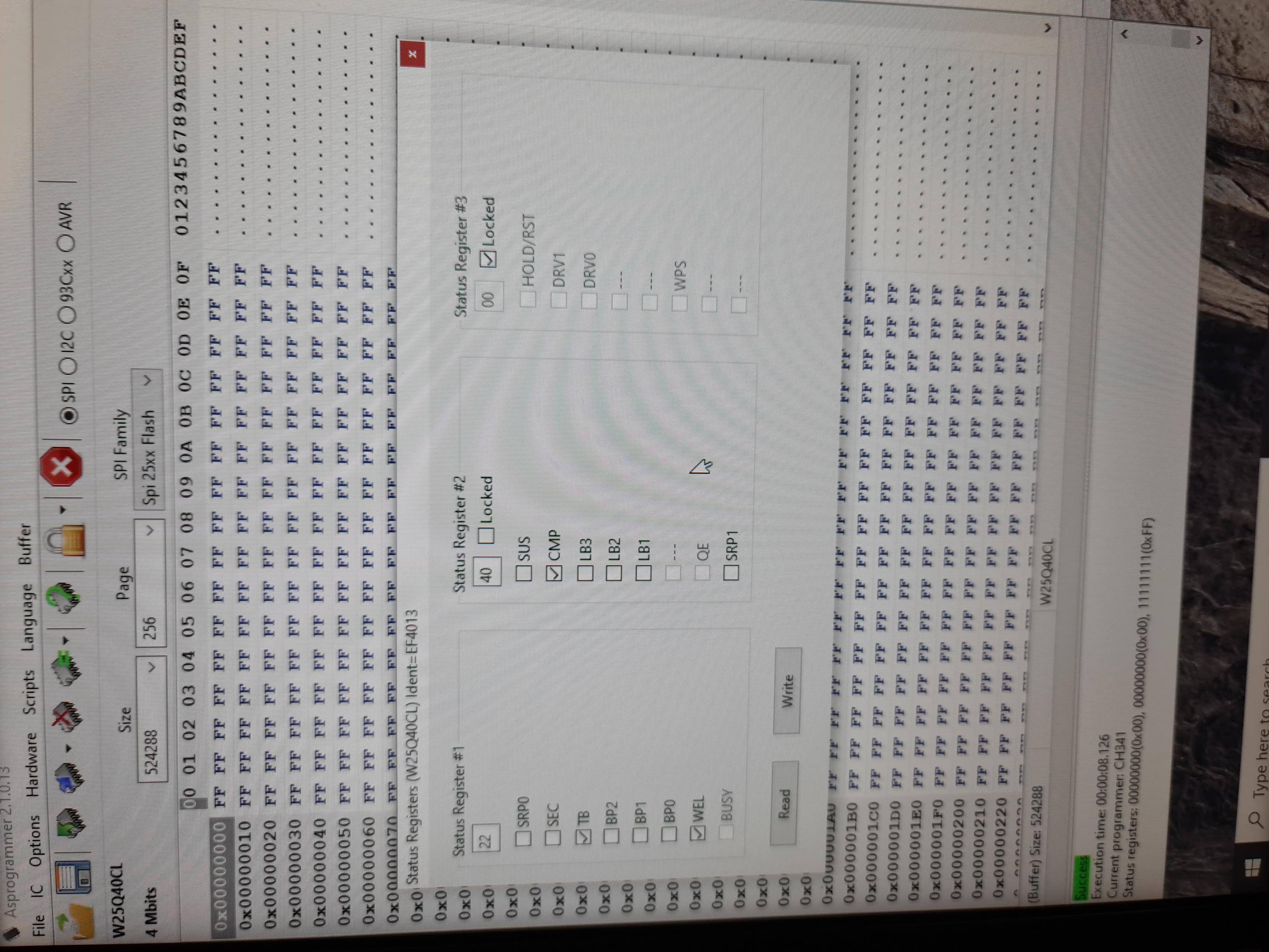

                                    Hi i have got to the stage Seger edition check mark s7 s3 s14 s9 not on the register
                                    • lotas
                                      • Jan 2016
                                      • 4787
                                      • Russia
                                      Hello, why do you have an empty dump (FF FF FF ...), you should have this.
                                      • Marty-Club
                                        • Aug 2019
                                        • 23
                                        • United Kingdom
                                        Hi I'm still getting the same on the status register no s7 etc
                                        The program you added fixed chip 7zip or winrar
                                        Rgs Martin
