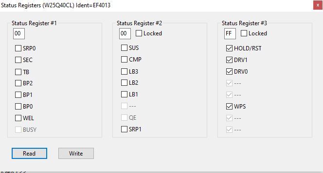

                  #508
                  Thank you,
                  but in my Asprogrammer, the bit QE is not enabled! (see attached)
                  • Muflo58
                    • Jul 2024
                    • 6
                    • Italia
                    #509
                    The version is 2.1.0.13
                    • lotas
                      • Jan 2016
                      • 4752
                      • Russia
                      #510
                      Originally posted by Muflo58
                      Thank you,
                      You need to install the program "NeoProgrammer V2.2.0.10".
                      • Muflo58
                        • Jul 2024
                        • 6
                        • Italia
                        #511
                        Thank, it works now.
