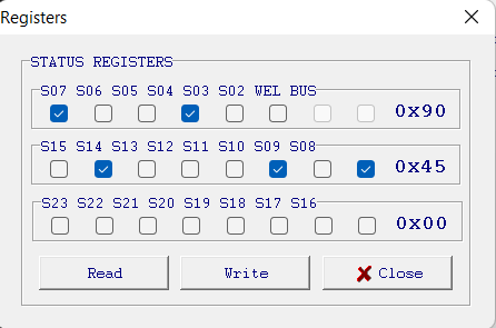

          I've got a problem with the IC1604. I see that I've got the first bits but there is a problem with a SREG. Whn I'm trying to prtect 0x88 and 0x42 there is no such a posibility. It's suck on 0x90 and 0x45 and when i'm trying to write it nothing changes. I can change the batch, but can't do anything with SREG. When I'm trying to unprotect blank chip it's stuck on 0x90 and 0x45. Can i do anything with that? Thanks

            Look for another spi flash, your dump is working.
            ...These checkboxes can be removed from 0x90 and 0x45 and click on Write?

              Yes and i can't overwrite it. It's still on 0x90 and 0x45. I'm gonna try to change the chip. Thanks

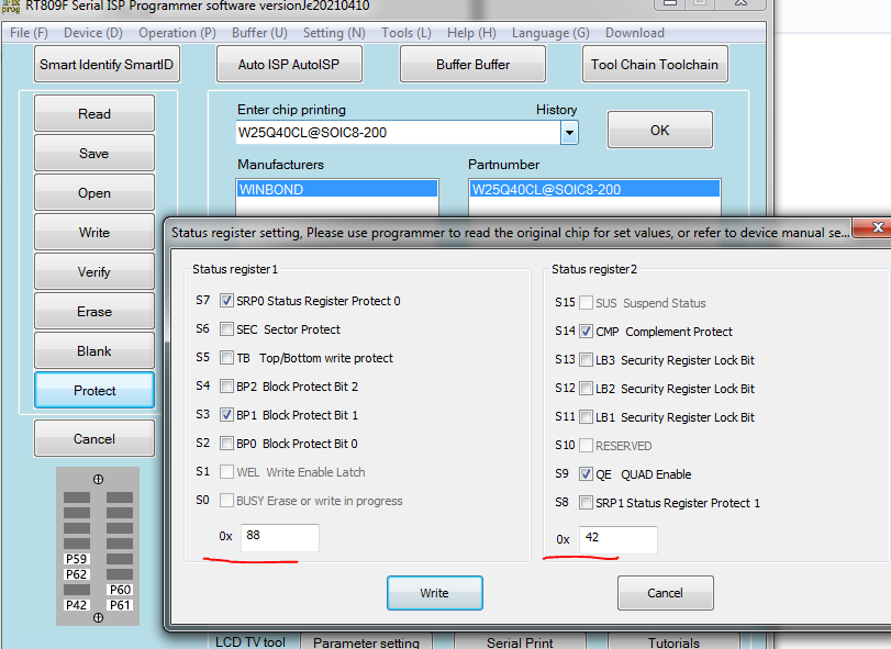

                        Did you set and write the correct "status register" (0x88, 0x42) after writing the corrected dump? Most likely, he (dump) again flew off after applying voltage to the board.

                          #172
                          Re: Samsung ue49mu6120
                          Sorry but I don't know how to do it (0x88, 0x42), I have a RT809H programmer.
                          Could you help me do it?
                          thank you

                            After writing my dump and Verify, click on "Protect" and check the boxes as in the photo and click "Write".
