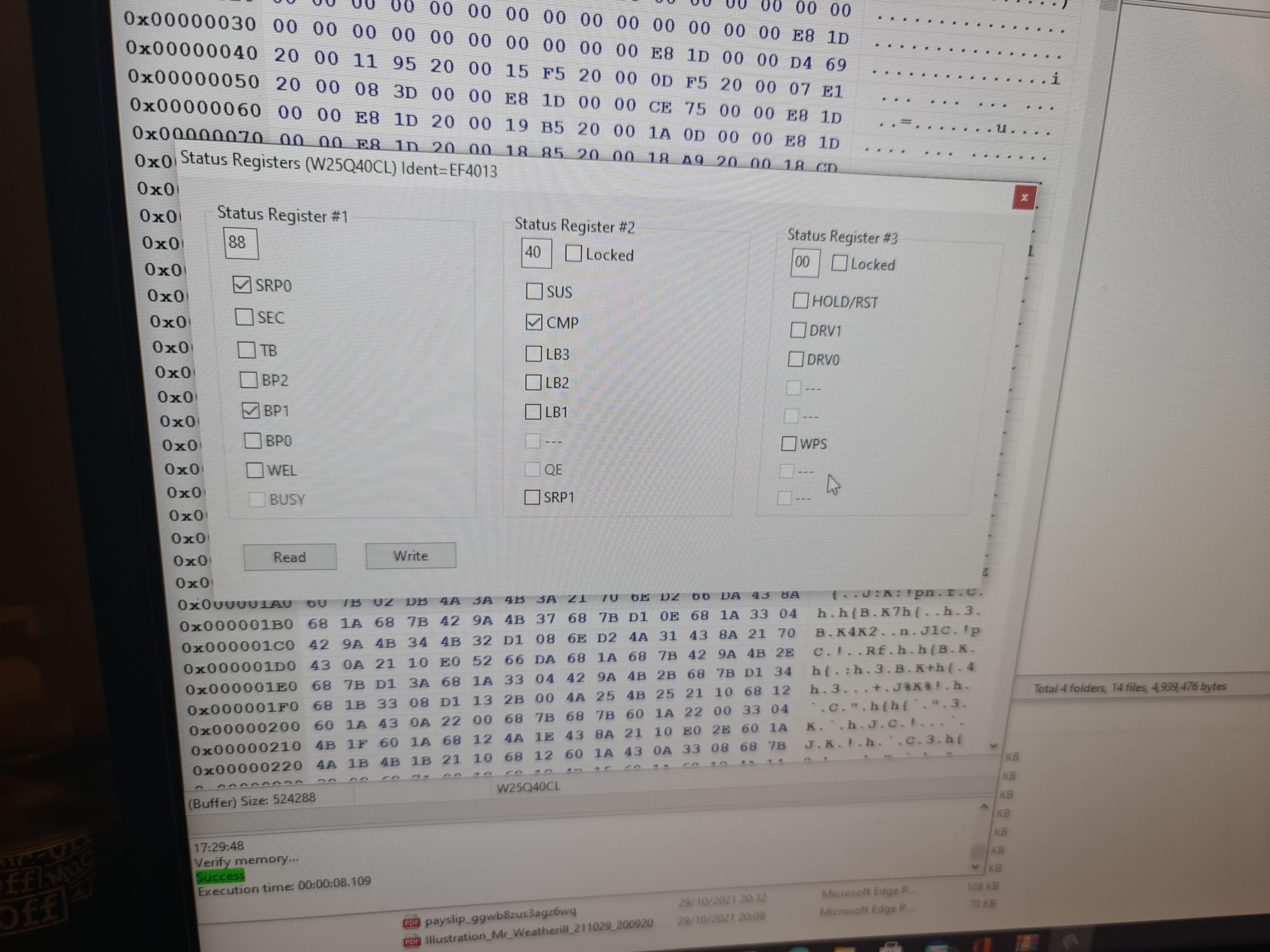

    Hello, do this. You should have it, then click Write.

      hi QE will not let me tick it, even when iv unlocked it...

        Hi lotas the Qe will not let me tick, everything else in the description is working...

          Try hitting "read" first.

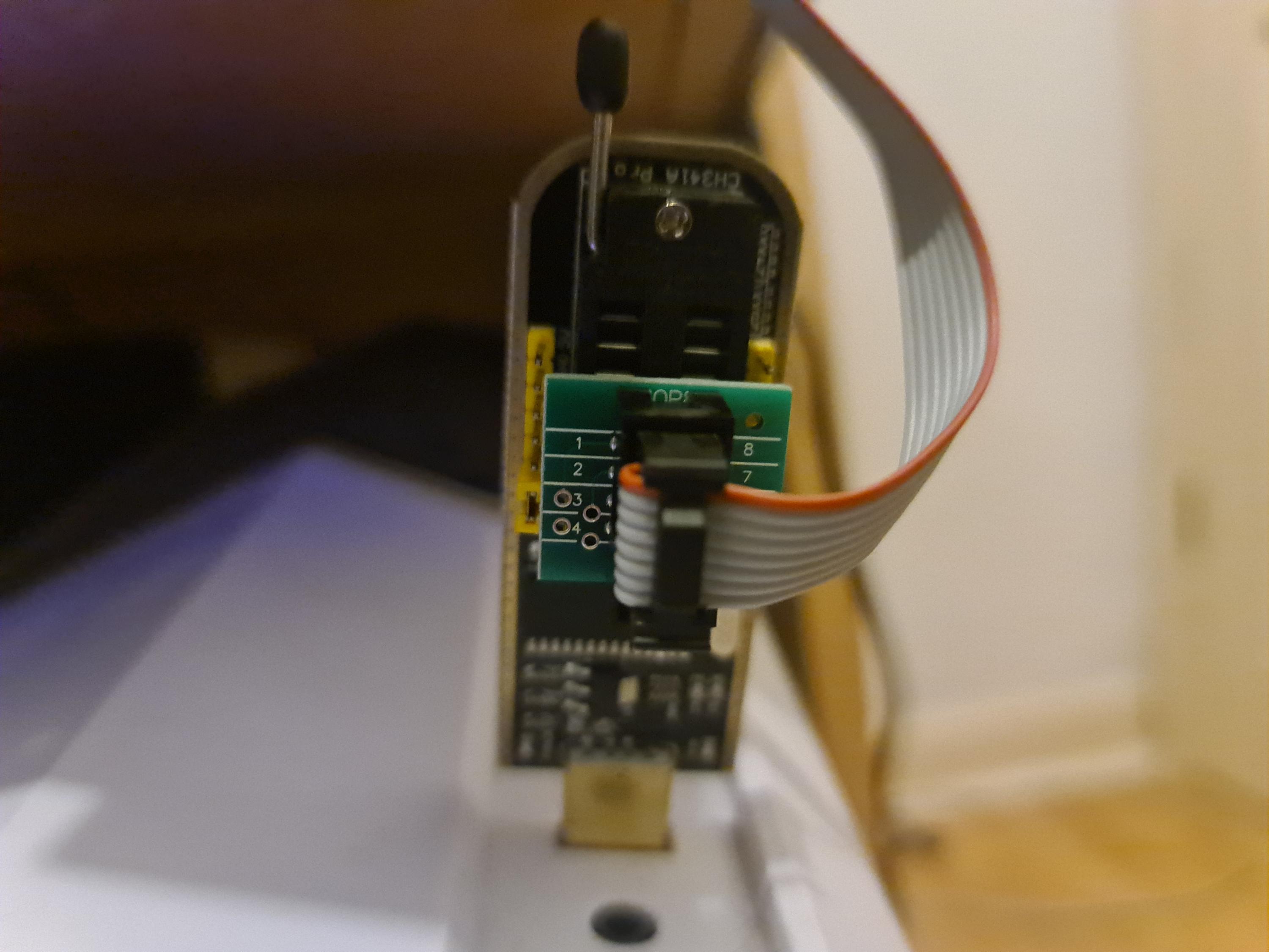

            Hi lotas this is my chip reader,
            Just looked on eBay I can get ue55ue6120 main board, I'm not sure if it's compatible...

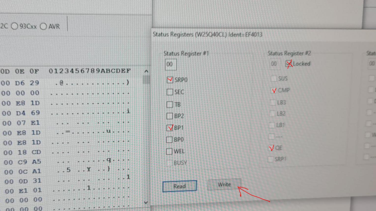

              Try "NeoProgrammer V2.2.0.10"

                Hi That did'nt work
                im guessing QE has to be ticked

                    Hi that program let me select qe, pressed write yes,
                    Nothing come up in the log,
                    Is that normal, usaly tell you if it's confirm write on the log...

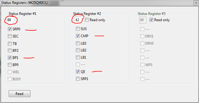

                        ry everything from the beginning in stages with a new program, as I described the instructions.

                          Do you program with a clothespin?
                          Programming must be removed from the 25q40 board and programmed through the adapter and then soldered back.

                              If you uncheck SRP0 can you check QE?

                                QE is not active for some reason in the program, I already wrote that the CH341A programmer itself needs to be modified.

                                  f you do not activate the QE protection, then when installing and turning on the TV, the "header" at the beginning of the dump will be deleted again.

                                    yes i was using the clip, i need to unsolder the chip use in the programer
                                      Yes, that's better!

                                        Hi ok i will unsolder the chip use the programmer see how it goes, fingers crossed
                                        can you buy the chips Winbond 25Q40CL.. ..
