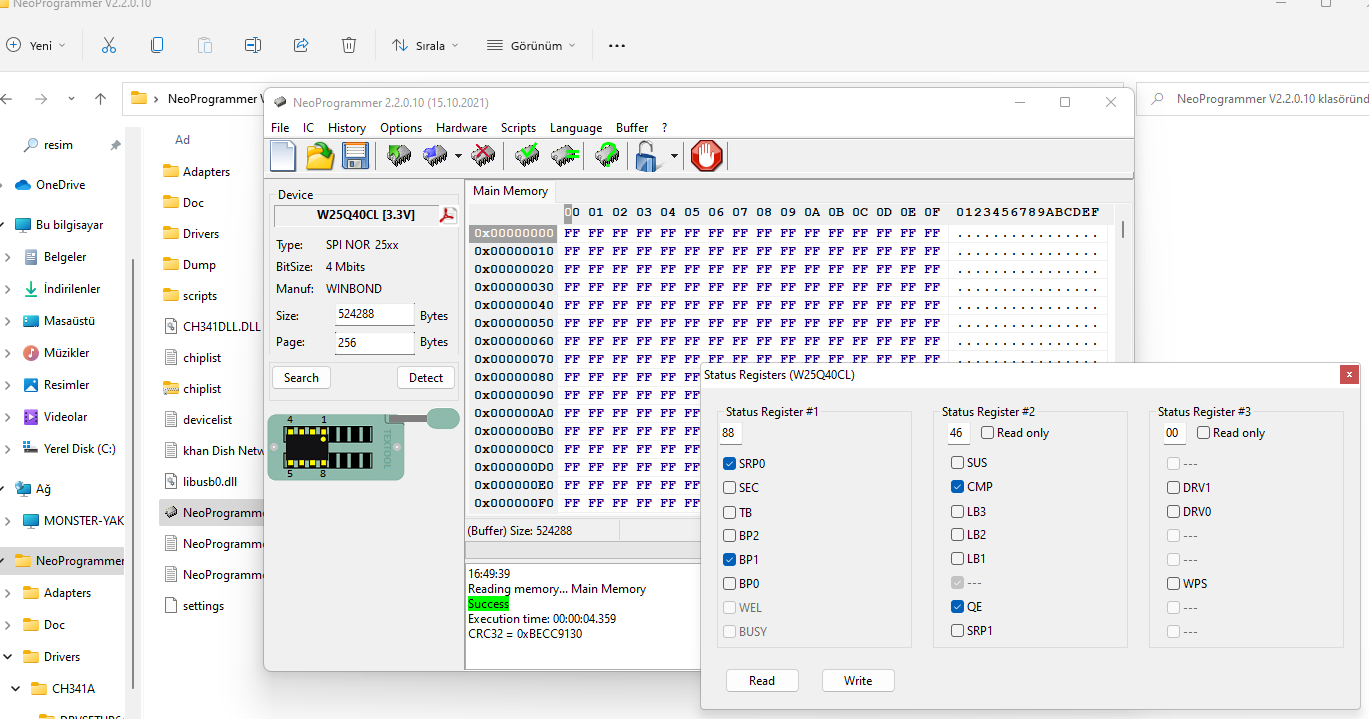

      I'm sorry, but it still didn't work. 44 is not. Could it be another problem? For example, could my chip or programmer be faulty?

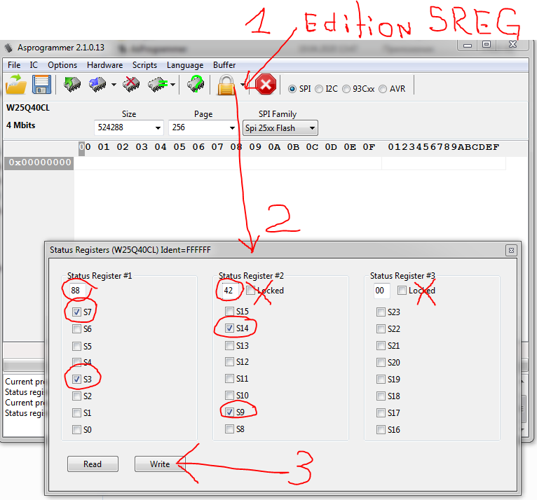

        Why do you need "Reading" ?, why an empty window ?, You are doing everything wrong.
        I will repeat again:
        1 The chip must be erased from the beginning.
        2 Then flash with my dump - fix.
        3 Then go to "Edition SREG" set the values 88, 42 and click "Record".

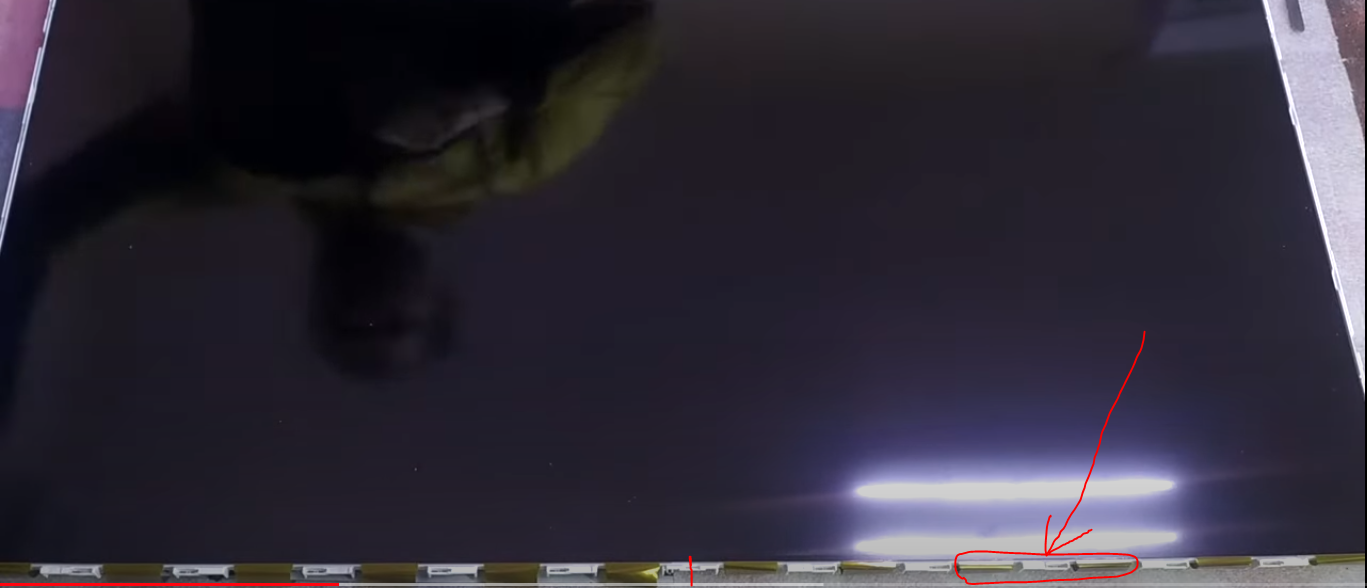

          First thank you so much for your help. I got new chip today 25q32a model. The problem was old chip. Tv works but now there is a scratch on the screen. How can you help me with this? Thanks.

            Congratulations, why did they install the 25Q32 chip (32 mega bits (4 megabytes)? At the expense of the strip on the screen, see the cables at the bottom of the screen did not accidentally damage when disassembled, removed the back cover.

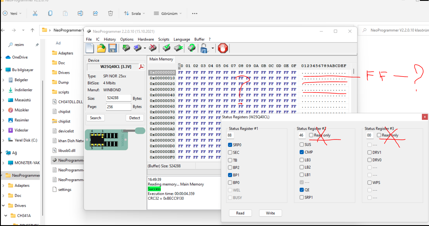

                Hi, i have the same problems. The TV does not turn on, but when I disconnect the power supply, the leds are on. No Standby LED. Lots of FF in the Hex file.
                TV is an UE49MU6179UXZG
                Mainboard BN41-02568B
                Many thanks

                    The TV ist starting
                    Only i cant edit the SREG, it was impossiblle to set the Register to 88.
                    Its fix on 00.
                    But i know now thats the tv is working
                      Its fix on 00.
                      Then do a factory reset through the service menu.

                        Re: Samsung ue49mu6120
                        can try the tape method for the line, might work: https://www.youtube.com/watch?v=N6nVJja2WxA
                            the line could be due to a bad component on the panel driver board, check the little ceramic caps for shorts, also check the resistors close to the line, make sure they are ok in tolerance and have good solder joints.

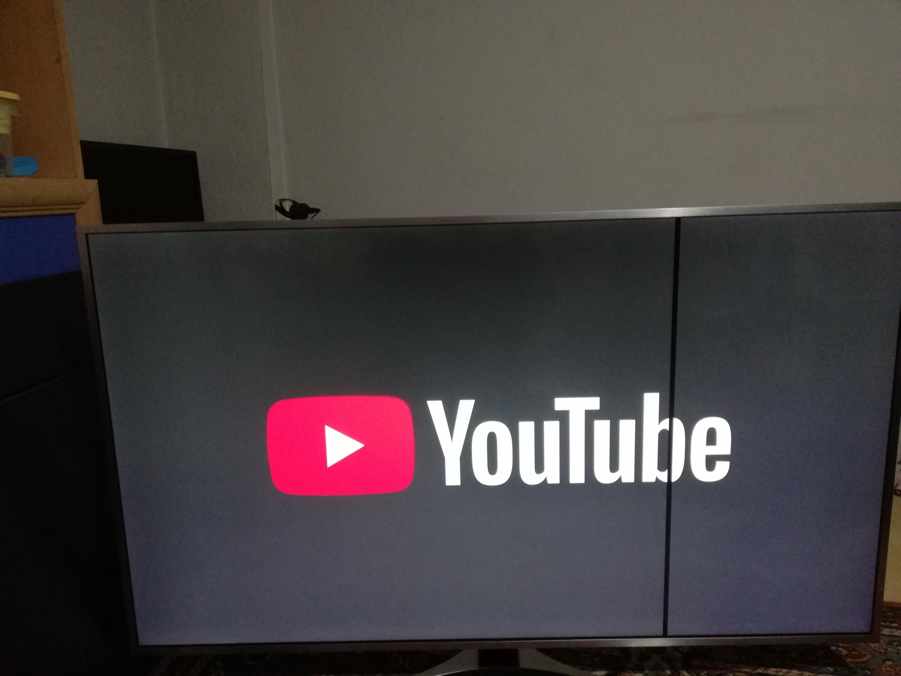

                              Read it Lotus post #104, his chip is fixed, NOW he has a problem with a vertical line.

                                      With someone else's dump, the TV will not fully start, since each dupm has its own identifier (keys), if you have already erased and written someone else's dump to spi flash without saving your own, it will be difficult to restore, you need to rewrite the entire dumps set on this motherboard (not when not use clothespin).
                                      Your dump has already been overwritten by another dump.
