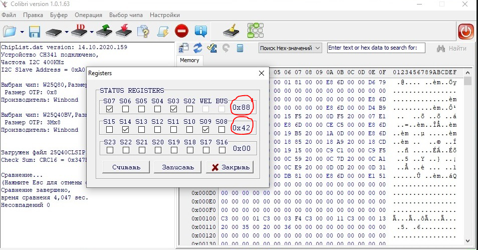

            I have a Samsung UE49MU6120KXZT that seems to have same problem depicted in previous posts.. TV seems dead, any response to any stimulus, when cpu board is disconnected, backlight goes on and power supply to the cpu board seems ok.
            I read previous posts and learn about fixing of the memory chip ic1604.
            It worth to try if this is the problem so I got a Xgecu programmer and dumped the memory down.
            Could you kindly help me to verify and try fix the memory content?
            Please find attached the bin file of the memory.
            Thankyou in advance!!!

              #66
              Re: Samsung ue49mu6120
              Try.
              • iu3ohw
                • Sep 2022
                • 3
                • italy
                #67
                Hello Lotas, thankyou for your response..
                Only Yesterday I had the chance to try your bin.
                Unfotunately is not working.
                I tried 2 time to program the EEprom, verification after programming succeded, but after soldering on the board, and turn on by the switch in the rear of the TV (I have no remote) Is not working.
                Desoldering and verifying the rom content I find the content is different. Actually the memory range between 0x000000 and 0x000FFF is filled with 0xFF
                I can't see what is the cause of this behavior.. maybe a cpu malfunction?
                Do you have another suggestion on how could I figure out this problem?
                Thankyou for your support,
                regards

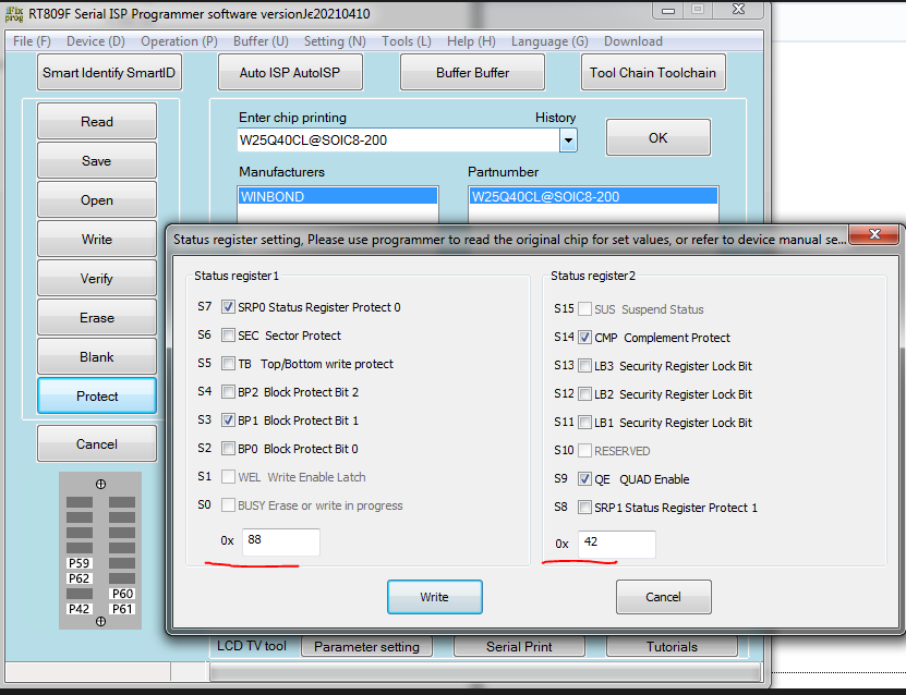

                  This will be the case, you need to set status register 0x88 and 0x42 after writing 25Q40, read this topic first, I wrote here in detail.

                              Rather, after applying voltage, the firmware again flew off, you need to set the status of the register 0x88 and 0x42 after writing 25Q40.

                                from colibri log
                                Selected device: W25Q40BV,Capacity: 512Kx8
                                Manufacturer: Winbond
                                JEDEC ID(9F) = 0xEF4013
                                RES ID(AB) = 0x001212
                                REMS ID(90) = 0x00EF12
                                Status Register1 = 0x88
                                Status Register2 = 0x42
                                Reading...
                                (Press Esc to cancel operation)
                                Reading completed,
                                reading time 3,96 sec.
                                Check Sum: CRC16 = 0xA314, CRC32 = 0x67F4FB33
                                Reading...
                                Reading completed,
                                reading time 3,97 sec.
                                status is ok ?

                                  #76
                                  Yes, now install on the board.

                                    still K.O.
                                    log from RT809H is ok
                                    035: Chip pins contact is detected OK.
                                    036: Chip ID verification OK.
                                    037: UniqueID:0x25DE706748646757
                                    038: Start writing chip......
                                    039: Auto erasing...
                                    040: Erase successful£¬Elapsed time£º0.686 seconds¡£
                                    041: Start writing...
                                    042: Write successful£¬Elapsed time£º1.045 seconds¡£
                                    043: Auto verifying...
                                    044: Verification successful£¬Elapsed time£º0.196 seconds¡£
                                    045: Status Register-1 : 0x88 , Status Register-2 : 0x42 .
                                    046: Elapsed time: 1.282 seconds£¬average speed of 408960 bytes/sec.
                                    047: >------------------------------------OK---------------------------------------<
