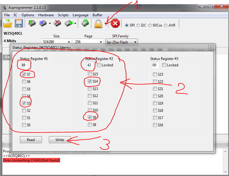

                  Hello, I have the same problems. The TV does not turn on, but when I disconnect the power supply, the leds are on. I reset the windbond 25Q40CLSIP chip. There are lots of FFs. Can you help me too.
                  TV : SAMSUNG UE49MU7400UXTK
                  MOTHERBOARD MODEL: BN41-02568B
                  CHIP : WINDBON 25Q40CLSIP

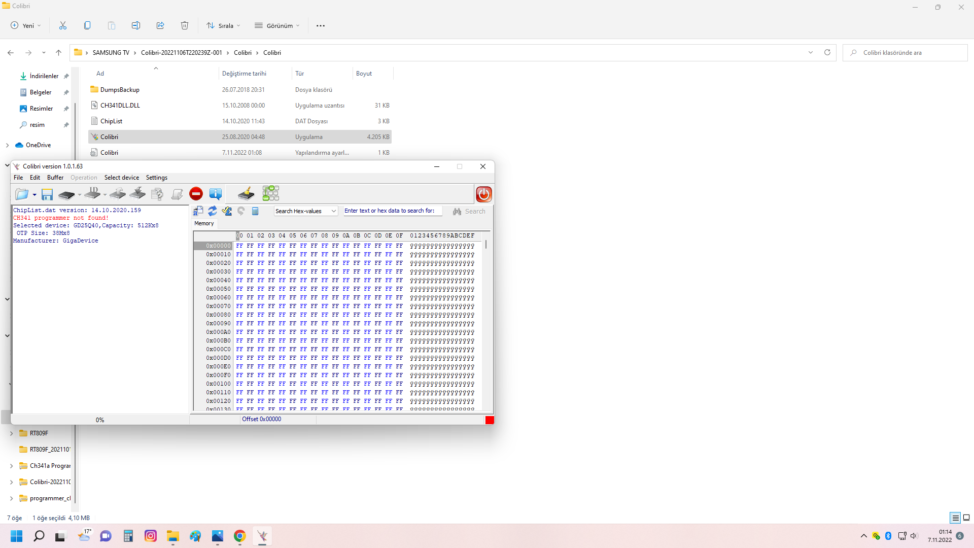

                            Re: Samsung ue49mu6120
                            It isn't happening. I cannot find the 25Q40CLSIP file. Do you have ready file?

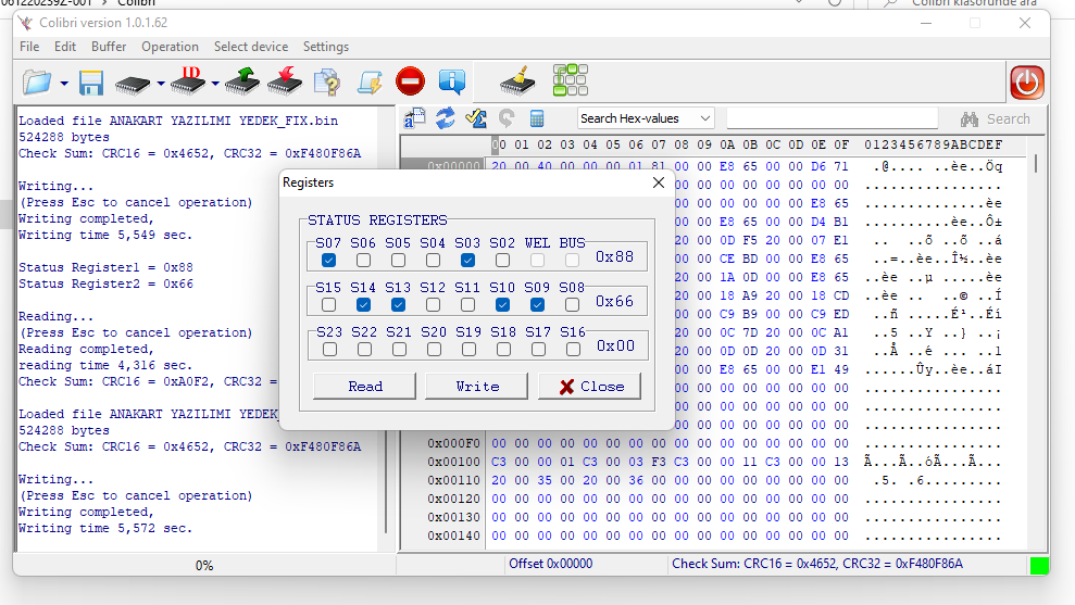

                              I make the settings you say and write to the chip. Then I check, part of it was deleted. Why do you think this happens? Is there a problem with me or the chip?

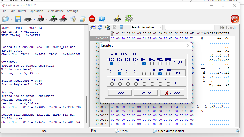

                                #95
                                First you need to write my Dump, then set status register 0x88 and 0x42 and write it to Spi flash.

                                  #96

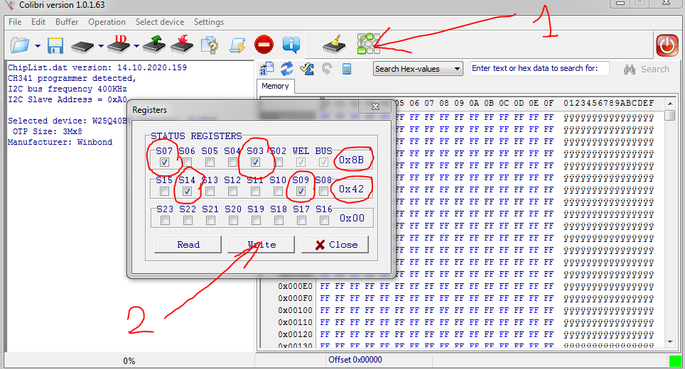

                                  I break the status register and make it 88x42. but it gets corrupted again, it becomes 88x66. Why can't I? TV still not working.:ah:

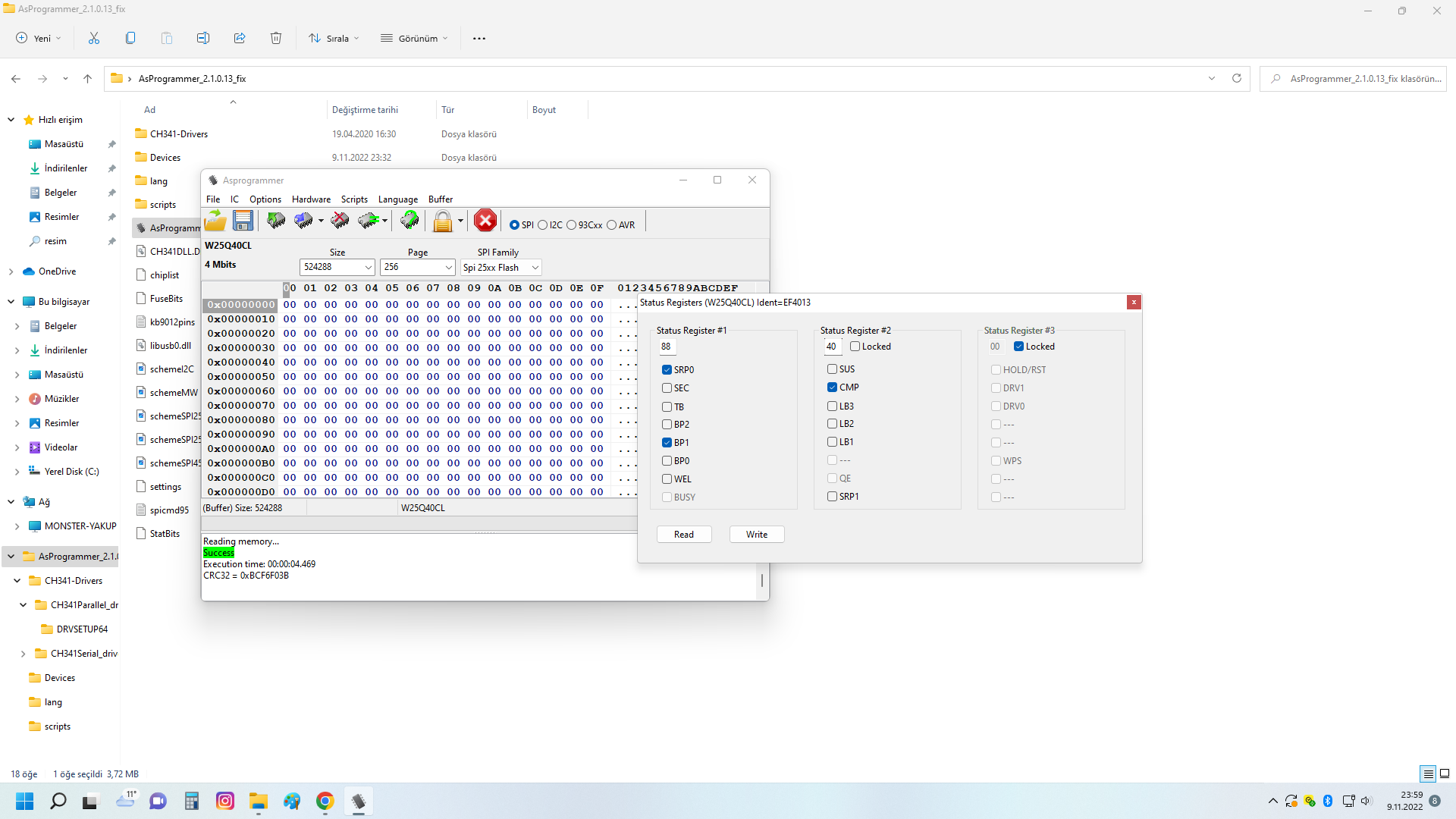

                                    #97
                                    I don't know how you install everything there, but the CH341A programmer itself without modifications can record poorly, try this version, just set the correct manufacturer not GigaDevice, but Winbond.

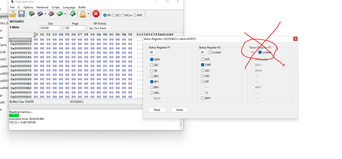

                                      #98
                                      Ok. now i can't select status register 2

                                        #99
                                        On "3" - SR. there should be no checkmark, completely erase the chip, write a dump, set SR 88.42 and press "write".

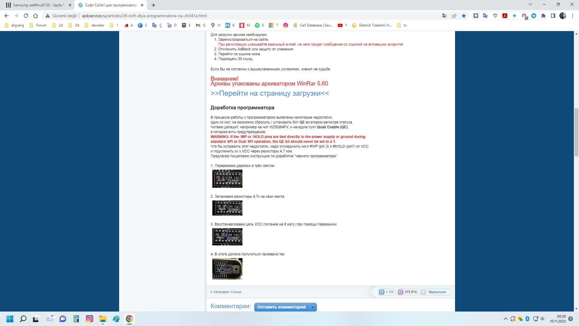

                                          #100
                                          I did what you said. but QE is not selected. I found this page. Could this be the reason? Is it because of the programmer?
