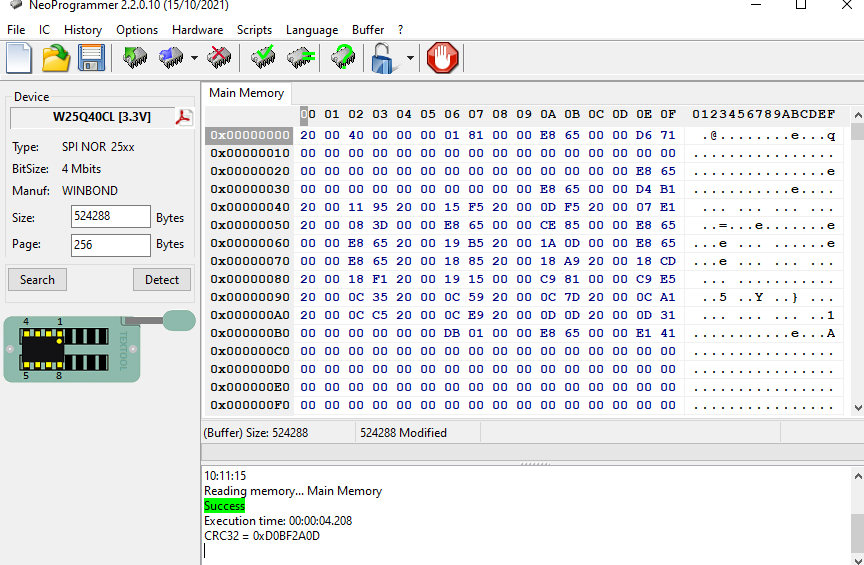

Hi, my TV has the correct voltages on the power supply but not from the red LED and it doesn't turn on, I dumped the winbond W25Q80 chip, same problem?

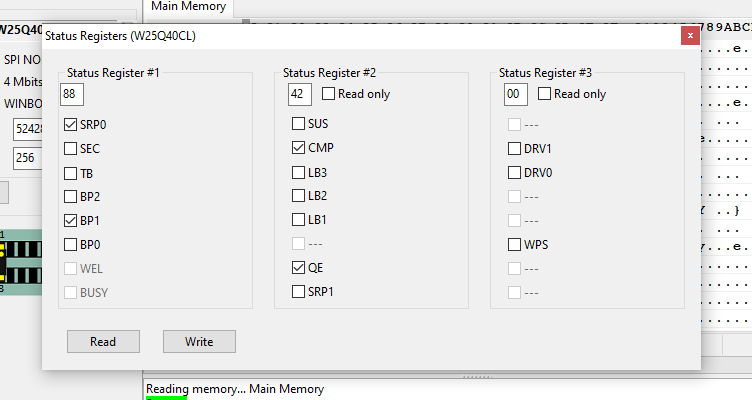

Most likely, your firmware has crashed again when you turn on the TV (you can check your dump again, the header in the dump will be erased, some FF ..., you need to set and write the status register 0x88 and 0x42 after writing the corrected dump, read this thread above, I described there.
It is necessary to read and write with the flash soldered, otherwise there may be errors when reading and writing.
yes, I set the registry correctly after writing your dump, I don't think it is altered, I try to unsolder it and read it again and I tell you
I don't use clips, but solder directly on the adapter pcb which I then insert into the programmer
Does it pass the test after recording without errors? To avoid errors, you need to program outside the board.
The bin file is written correctly, I just unsoldered and read to verify

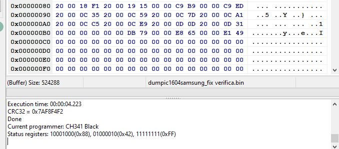

UPDATE:
I compared the read file with the one you sent me and there were slight differences, I completely erased the chip and rewrote it, so is the register correct??
